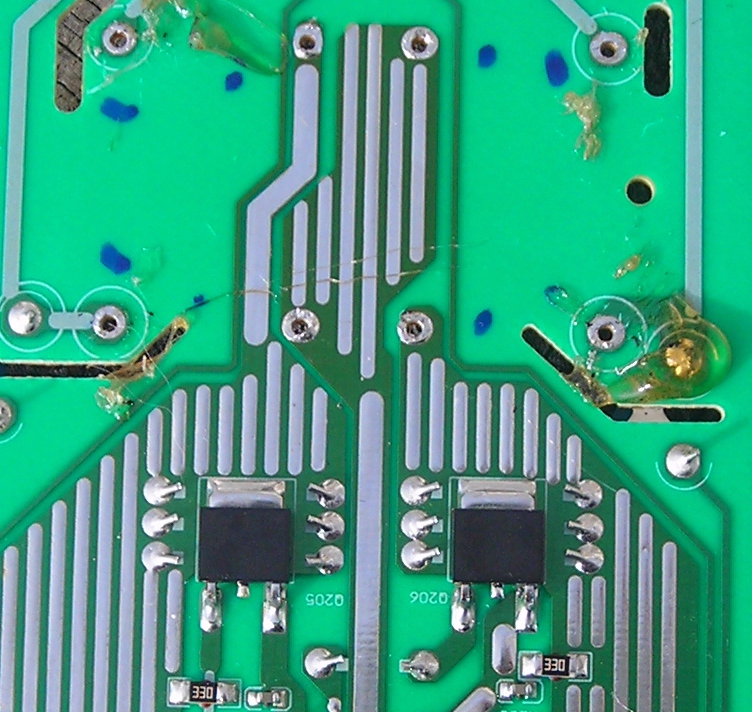

    Hi..I have several power boards from Viewsonic Monitors IE Delta DAC-19M010 and Delta DAC-19M009 boards ....and everytime I work on a board I end up with bad Power Mosfets that supply the Inverter Transformer....
    Now the mosfets are AP9973GH ( Advanced Power Electronics) or SSM9973GH (Silicon Standard Corp)
    When I go to an electronic supplier here ..they draw a blank which makes me think that I need some cross reference to other manufacturers numbers for the identical Mosfet...
    Can anybody please help me here..I have tried Digikey's website but find it difficult to cross reference....They are a surface Drain Source voltage mounted 60V / Gate Source Voltage +/- 20V / Continuous Drain Current @ 10V = 14A...Maybe somebody has had the same problem and can provide me with some alternatives...
    I have attached a jpg of the two Mosfets and one can see that the Inverter has been removed..Many Thanks Ron

    ebay
    http://www.ebay.com/sch/i.html?_trks...p9973&_sacat=0
    $1.40 each if you buy 10 + 2.99 shipping.

      Thankyou ..Looking at the auction listings its misleading to whether they actually ship to New Zealand ????Strange....
      But thanks for your help and I have asked them about the shipping ...Cheers Ron
