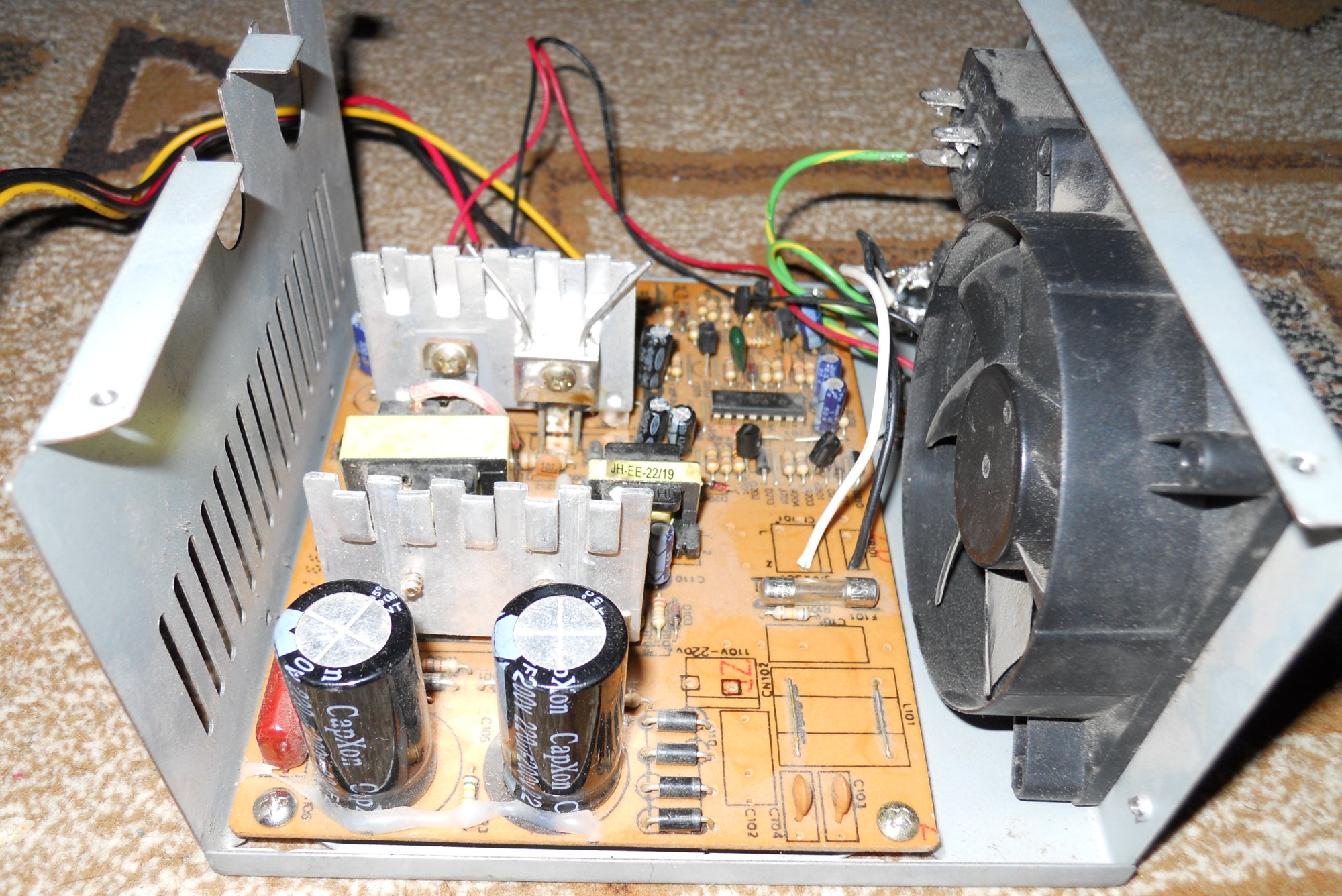

    Well, here we are again. I stumbled upon this little gem at my grandparents' place. I managed to blow it up last year IIRC and pulled some parts from it, but fortunately i remembered that i took good pics, and was able to decipher the values of the missing resistors and caps. What blew was one of the switching transistors, shorted B-E. I happened to have a pair of 13009s on hand, and hey presto, it lives again.
    This is as anemic as they get.
    • 220uF CapXon input caps,
    • no input filtering except 2 Y caps,
    • no NTC,
    • ridiculously small heatsinks,
    • no pi filters,
    • small output inductor,
    • and small output caps.
    On the secondary side we get
    • a 10A diode on 5v,
    • diodes-on-a-bracket (2x 3A) for 12v,
    • -5v and -12v get a pair of 1A diodes each.
    Output caps:
    • 1x 1000u 16v Jun Fu for 12v,
    • 2x 1000uF 10v Jun Fu for 5v,
    • 1x 330u 16v Jun Fu for -12v,
    • 1x 330u 10v Jun Fu for -5v.
    Label claims 200W, but there's no power distribution table, let alone amp ratings! In theory the rectifier ratings add up to 156W, but i'd say it's gonna do 100W on a good day. Given this, it's pretty amazing it survived upwards of 10 years, and no caps are bloated. All secondary caps are either Jun Fu or Fulltec. Well, i'm gonna turn this pile of turd into... wait and see. Certainly, it's going to be miles away from where it currently is.

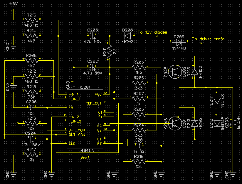

    I lifted the schematic of the controller and power sections. As you can see, the only rail in the feedback loop is the 5v rail, the others (including 12v) are left to cross regulation. There's also a discrete powergood circuit and (i suppose) overvoltage protection, but i don't really care about that so i haven't bothered to trace it. I've attached a couple more schematics with comparator-based protection and powergood circuits, so you can see how the blocks fit together.
    Certainly, there is no overpower protection (and it seems no short circuit protection either, but i'm not too keen to test it), so things are likely to get crispy if you push it too far.
    This being an AT PSU, there is no 3.3v, and no 5vsb. So watch closely how the TL494 derives its power - it comes from the 12v rail, before the inductor. So the 494 sees the peak voltage coming from the transformer, which in this case is 24v. This is important to note, as if you want to do a radical modification involving rewinding the transformer, you absolutely must have a separate winding that delivers 30v peak at most, at maximum line voltage, or you will blow the 494.
    As for how the thing actually starts up, since the 494 is on the secondary side and there's no auxiliary supply to power it, look closely in the primary and you'll find it.
    More to come, including a clever way of varying the output voltage, which allows more flexibility than modifying the feedback divider of the error amp on pin 1.

    My guess is the 220k resistor turns on the first transistor (provides pulse from mains rectified input), providing an initial pulse to the transformer, this charges up the 330u and the converter starts switching which then keeps the converter running.

      Re: AT PSU mod - take two!
      There's a typo in your post - not sure which 330u you're talking about, maybe you wanted to say the 47u for the controller Vcc. That's it mostly, with another little detail - this wouldn't have been possible in a half bridge without the configuration of the driver transformer.
      In all half bridge supplies with bipolar power devices, it has a winding that is in series with the main transformer primary. What happens is when the first transistor turns on, there is a current going thru the driver transformer as well. Since only one transistor is on, a few us later the driver transformer saturates, its magnetic field collapses, which cuts base drive from the first transistor and switches on the other one. So the supply enters a self-oscillation mode, at a fairly low frequency (since there is very little base drive coming from the 220k resistor).
      This is what causes the characteristic buzz when an AT supply is in protection mode. Even at this low frequency, the voltage produced is enough to keep the TL494 running, so if a protection was triggered, it will not resume normal operation until it is unplugged and the primary caps have drained.

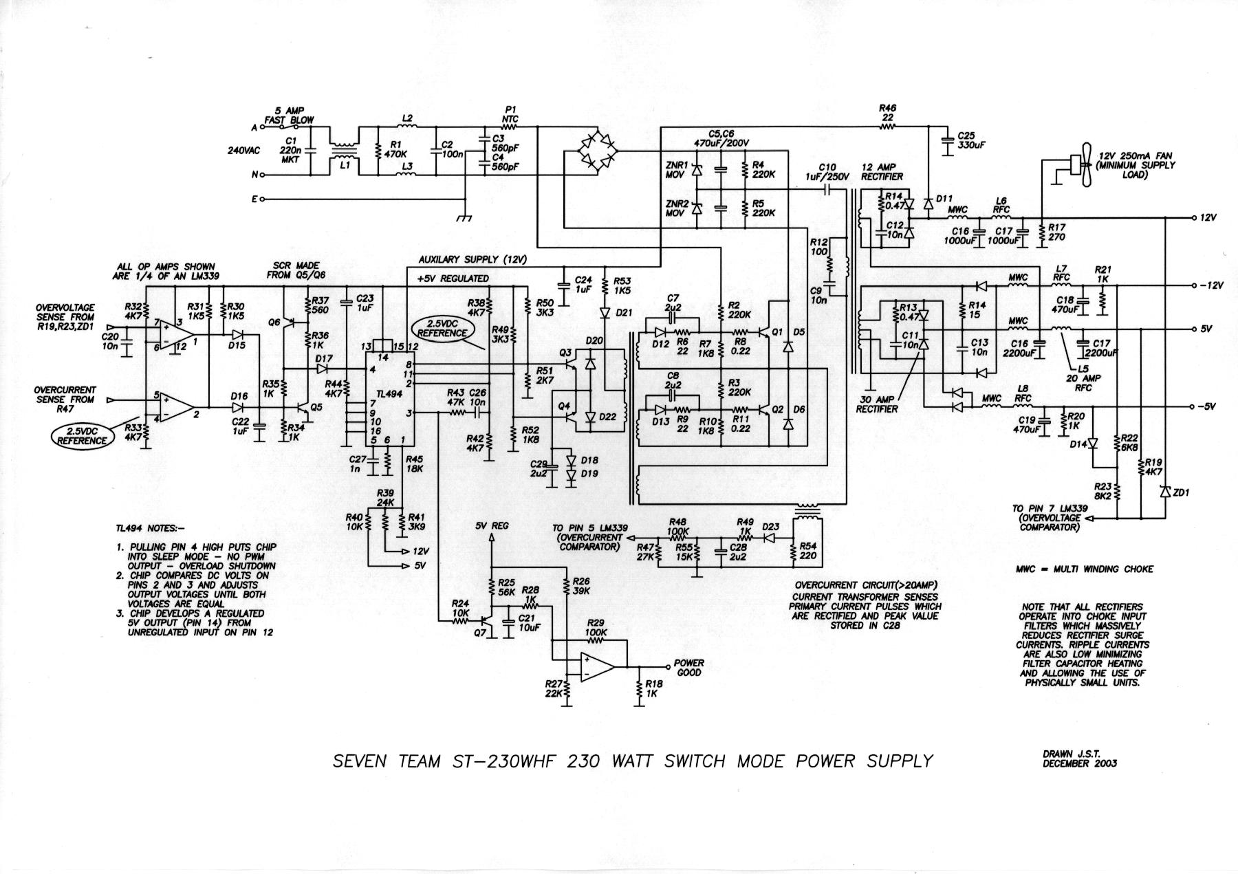

        I was looking at the Seventeam schematic, but the operation is very similar. Interestingly, many cheap self-resonant CFLs use a different way of starting by using a diac to provide a pulse to one transistor, which then pulses the opposite one (through the transformer), and the oscillation begins. I imagine they could do this, but it ends up cheaper to use the driver transformer's saturation properties.
        Re Seventeam schematic: What's the point of the 220k from the emittter of the top transistor to the collector of the bottom one?
        Like the fake safety Y-caps, too.

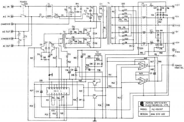

                They could be primary side controlled for low loads, e.g. by UC3842. I think I have an old ~60W AT PSU somewhere, maybe I should open it (not sure if it went in the bin though.)
                    tom and Th3 called it. The start-up comes with the 220K turning on the first transistor, the main transformer current going through a winding on the base drive transformer creating positive feedback ("proportional drive") and the magnetic field flipping at core saturation, turning off the first while turning on the second transistor, self-oscillating until the TL494 and driver transistors have the Vcc to be able to take control, switching at a much higher frequency than the natural self-oscillating frequency. Besides the buzz Th3 pointed out during power limit protection, you may also see interesting stuff when turning off the P/S (the P/S "tries" to turn on during the I/P 'lytic voltage bleed-off, resulting in significant voltage pulse or train of pulses on the +5V - a Mitac ATX supply I saw would actually have a >6V pulse on the +5V).

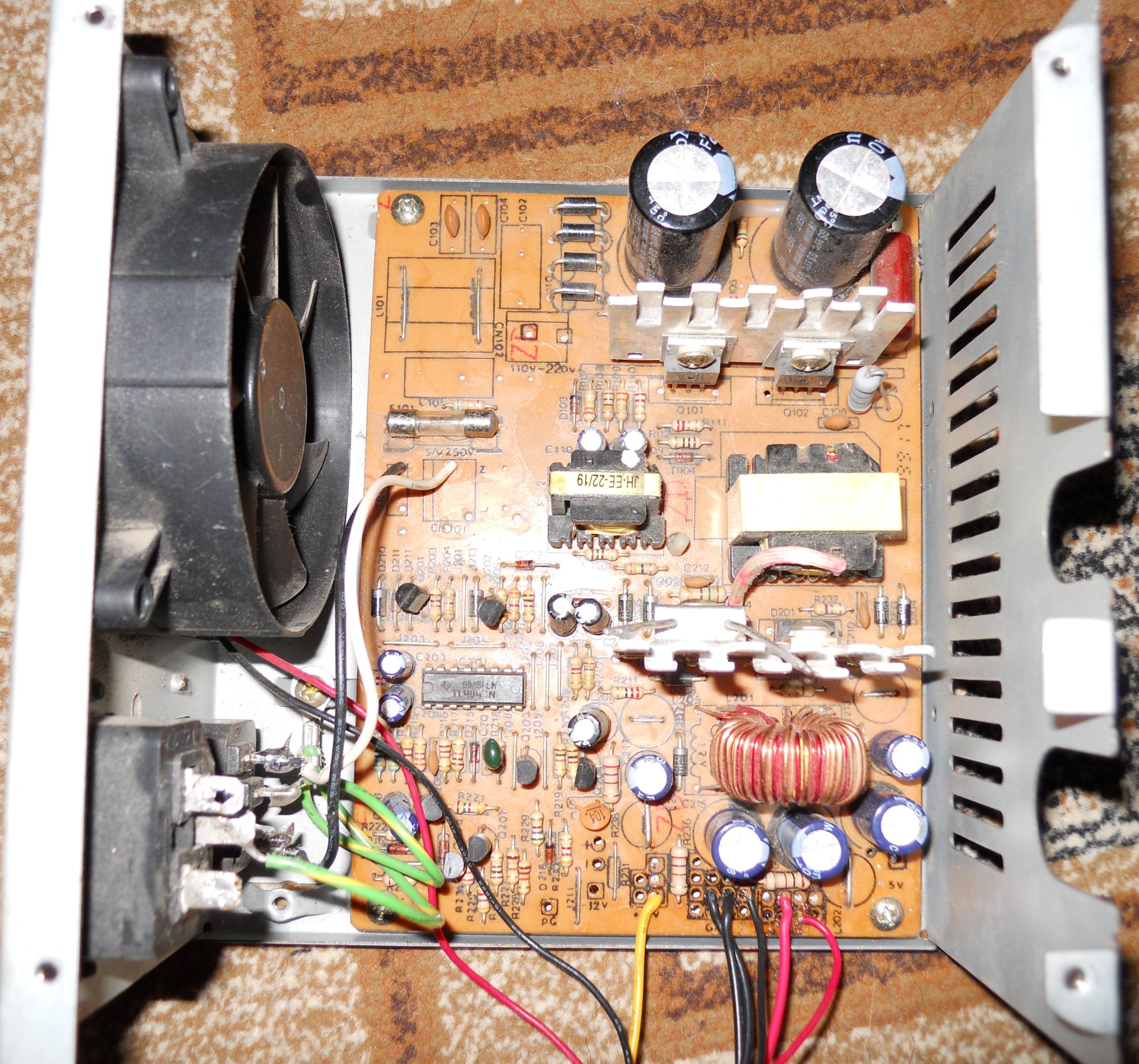

                                Well, i'm back home, and with more details about this PSU (i brought it home with me).
                                The common output inductor is wound on a T90-26 toroid as far as it seems, and it has the following values: ~8uH on 5v and -5v, ~28uH on 12v and -12v. My meter isn't very accurate in the 100uH range, so take those numbers as +/-5%. I noted the number of turns somewhere, but forgot and i'm too lazy to count them again. It's 10 turns for 5v/-5v and 24 turns for 12v/-12v IIRC. You know the deal - the common inductor also acts as a transformer, so to ensure group regulation, the turns ratio of the windings must be equal to the voltages ratio, and you can see that in the above numbers.
                                To be noted is that on a common core, putting two windings in parallel will NOT decrease the inductance by the parallel inductor formula (same as for parallel resistors, 1/Ltotal = 1/L2 + 1/L3 + ... + 1/Ln), it will remain the same, only with higher current capability. Practically all computer PSUs use multiple paralleled windings on 5v, and the good ones do it on 12v too.
                                Putting windings in series WILL increase the inductance as per the formula (Ltotal = L1+L2+...), while maximum current capability remains the same it would be for the thinnest wire of the series windings (in theory). In practice maximum current decreases because of the added resistance of the wire which causes higher copper loss.
                                What i will do now is move the feedback on the 12v rail and recalculate the compensation components and see what i get, to check if the formulas i am using are correct. Best to start off with some assurance before i get into the crazy mods.
