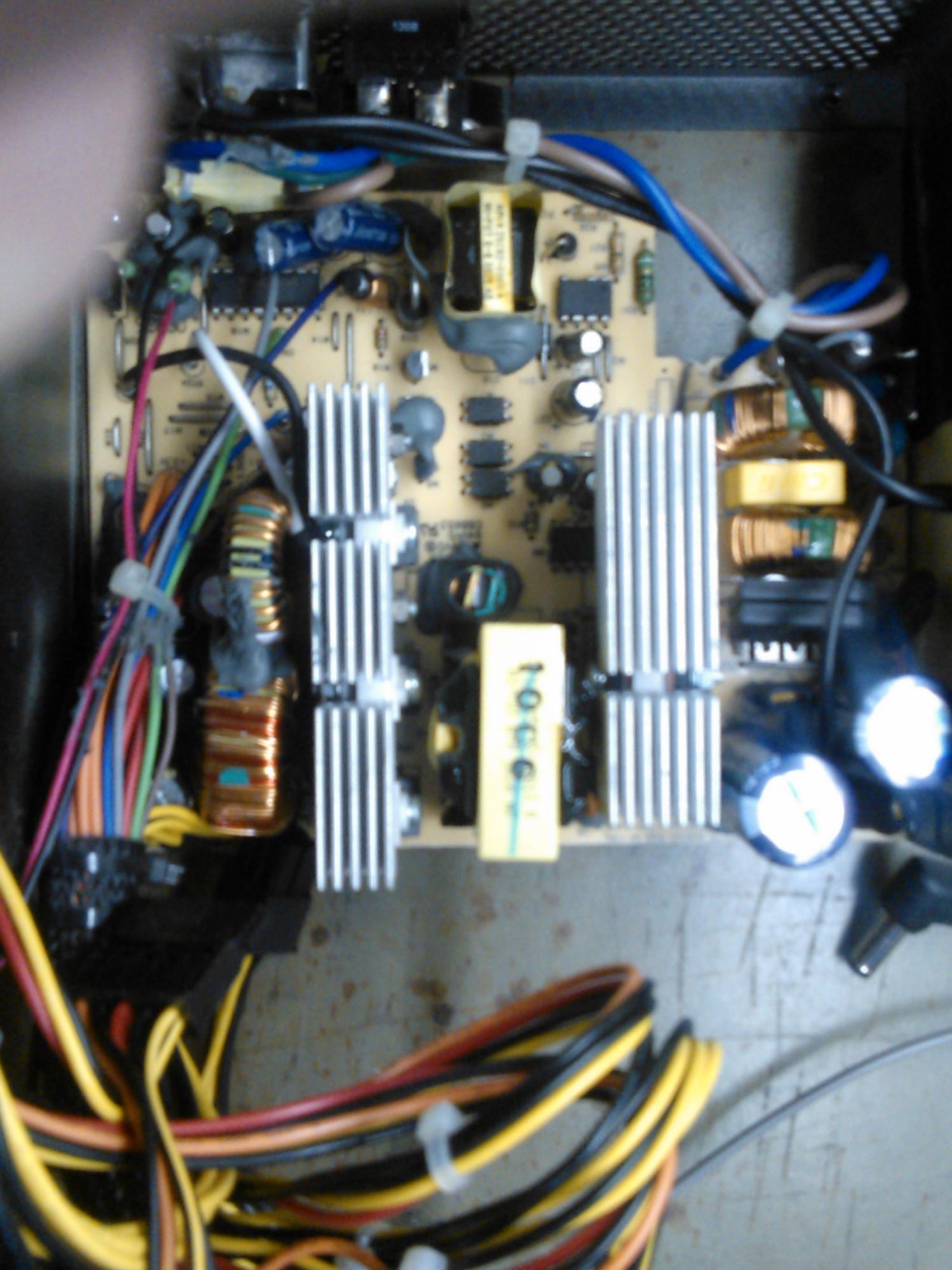

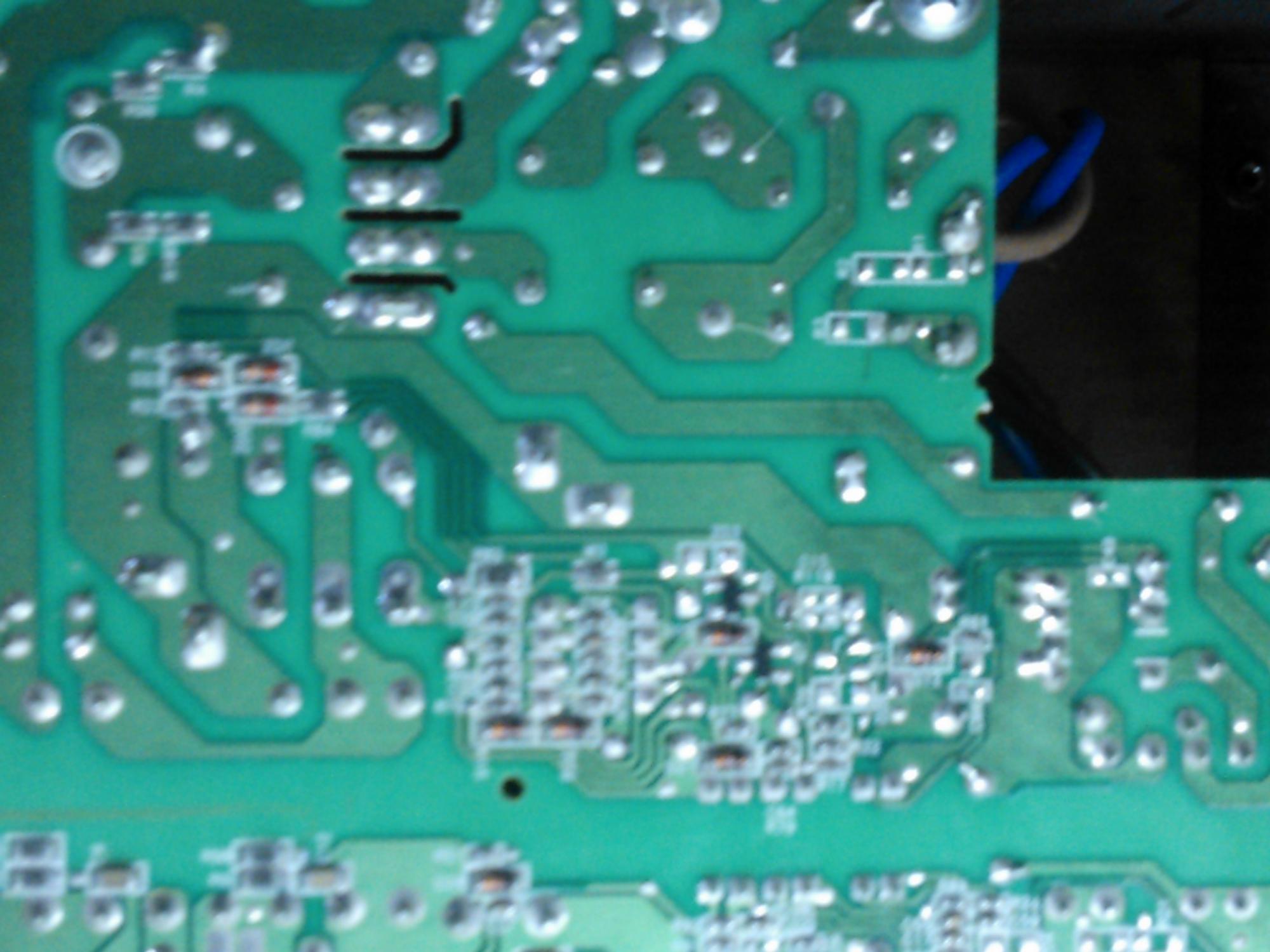

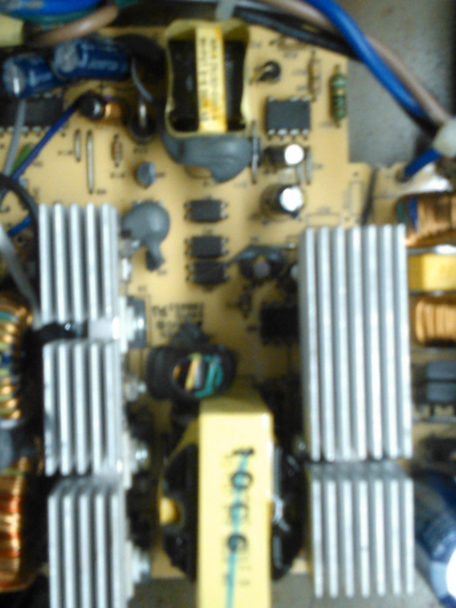

    among a bunch of other psus ( photos of them later ) , I´ve got this.
    It gives 5VSB ok, but won´t power up. Secondary rectifiers seem to be ok, the least being about 47ohm between their legs. I believe that to be the minimum load resistor in the circuit.
    I´m still tracing the circuit, but it seems the feed to the UC3843B pin 7 is low ( 3.2V, when from the datasheet it should be around 12-14VB. ) . There are two tiny caps near it that I can try changing.
    The pictures I have are bad, will try to get a better camera.
    Thanks for your insight.

    Yes, go ahead and replace those little caps, they often fail, and the PSU won't turn on.
