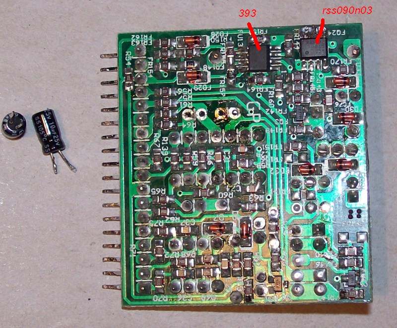

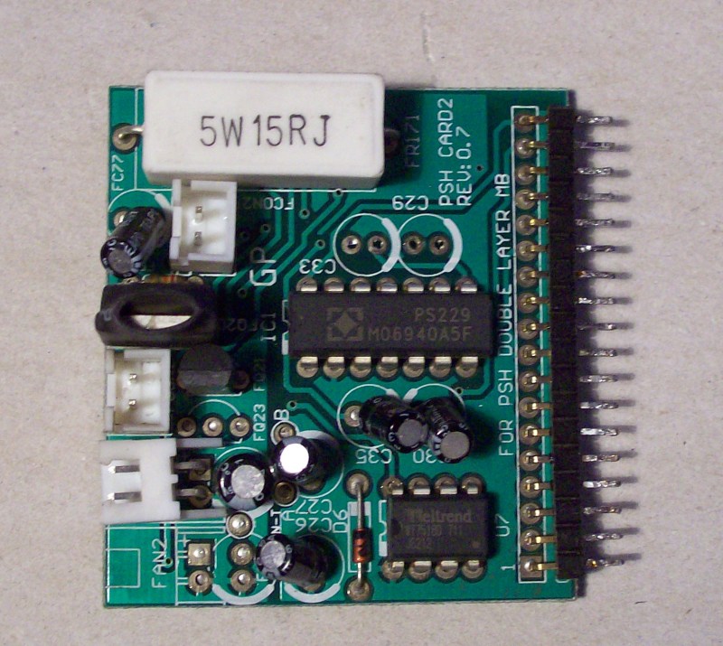

    I'm going to dissasamble this unit and rework the soldering. The controll board has a lm393, ps229 and a weltrend supervisor chips. I hope it's not one of these giving some trouble. It could be some of the tiny capacitors on this board...

      I checked the diodes for each voltage rails, changed the filter capacitors. The problem remains. I was playing around with the control board. "Unpluged" the 5 volt protection functions and the unit won't start up. Small capacitors measure ok. I guess that part works fine, but I'm not entirely sure how all the protections work. The problem is with the 5V regulation.

          There is only one 15Ohm 5W resistor on the 12V rail. It's the one on the supervisor pcb. The rest on the secondary are smd resistors. I wired the standy to the 5V voltage input on the ps299 and the symptom remains. All voltages are fine except 5V. The problem may be somewhere else.

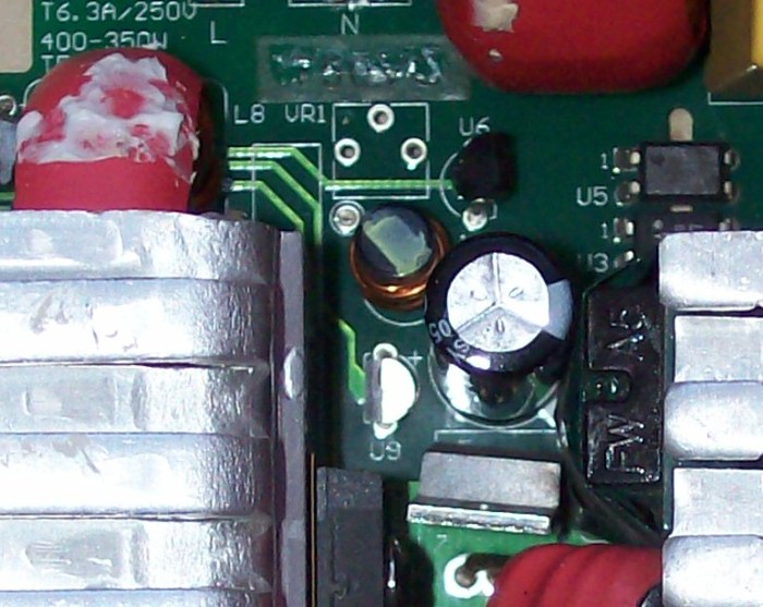

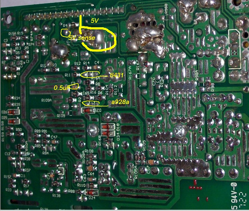

            I figured that the C2 ceramic capacitor was shorted so I changed it to a 0.5 uF. Now 5 volt is 0.1 higher... but still something like 4.2V without load. Still regulation is screwed up so I'm tracking back things.
            Btw should I install the missing vr1 trimmer, if so what value?

              I still haven't solved this 5V problem. I've been lectured by some pros that it's something with the feedback and that missing vr1 pot isn't important. There may be a faulty component on the primary...

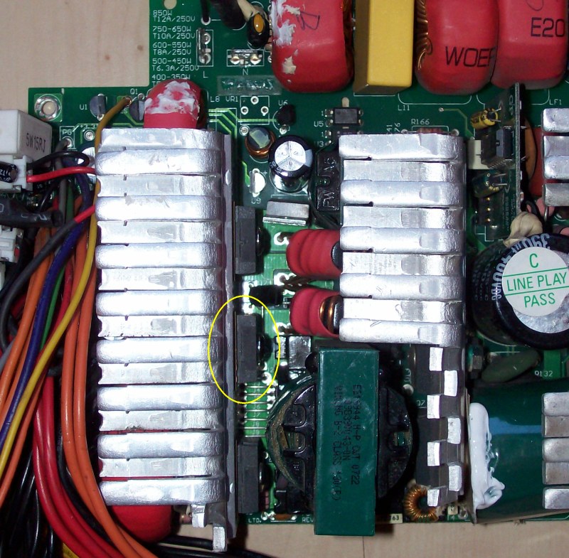

                        I had much trouble fixing this problem on that CWT PSH. As far as I remeber it was something trivial. A bad smd resistor somewhere in the secondary.
                        There is no schematic for this psu platform yet. The 5V diodes are in the middle on the third heatsink.
