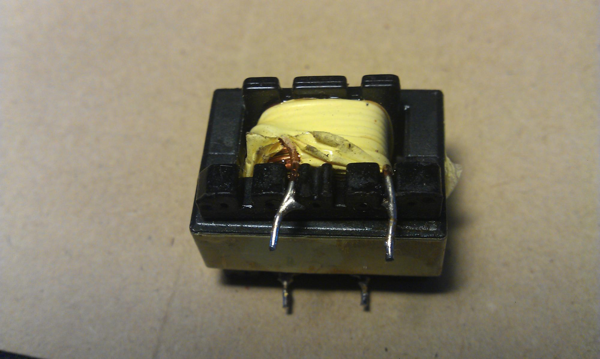

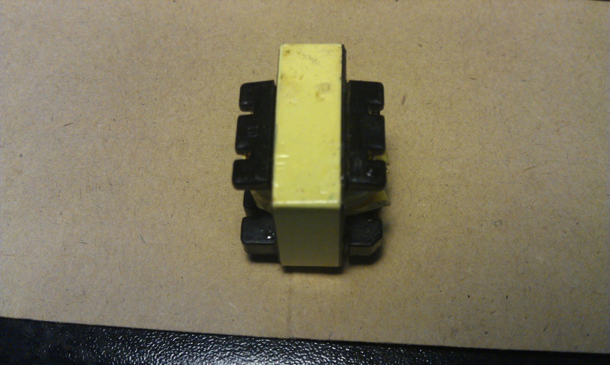

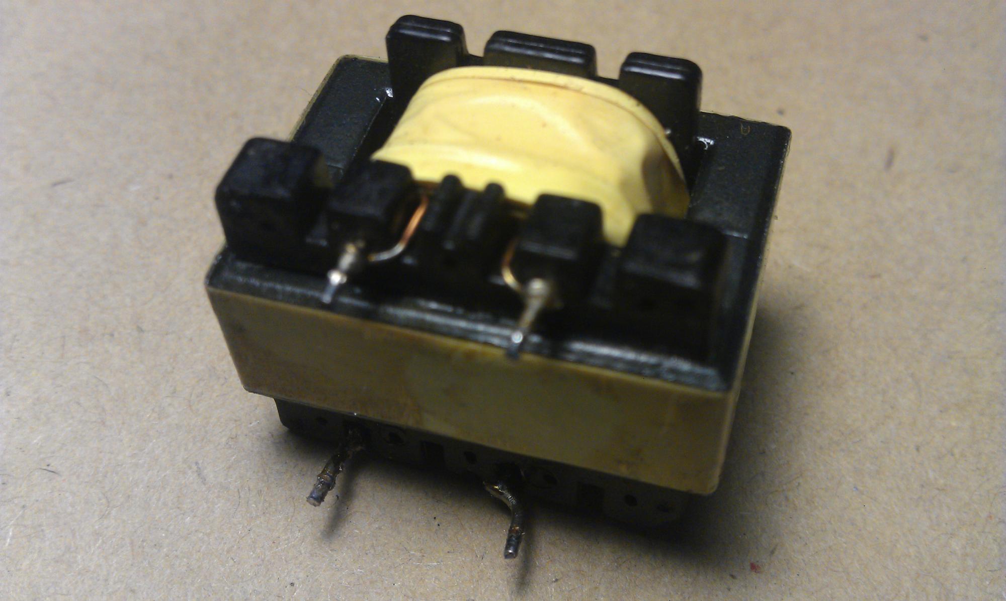

    Took out the transformer, have resistance on the fine wire coil and OL on the heavy wire coil, I'll change it if i can find out a part number for it, no markings on the unit whatever, how do I find out what to replace it with??

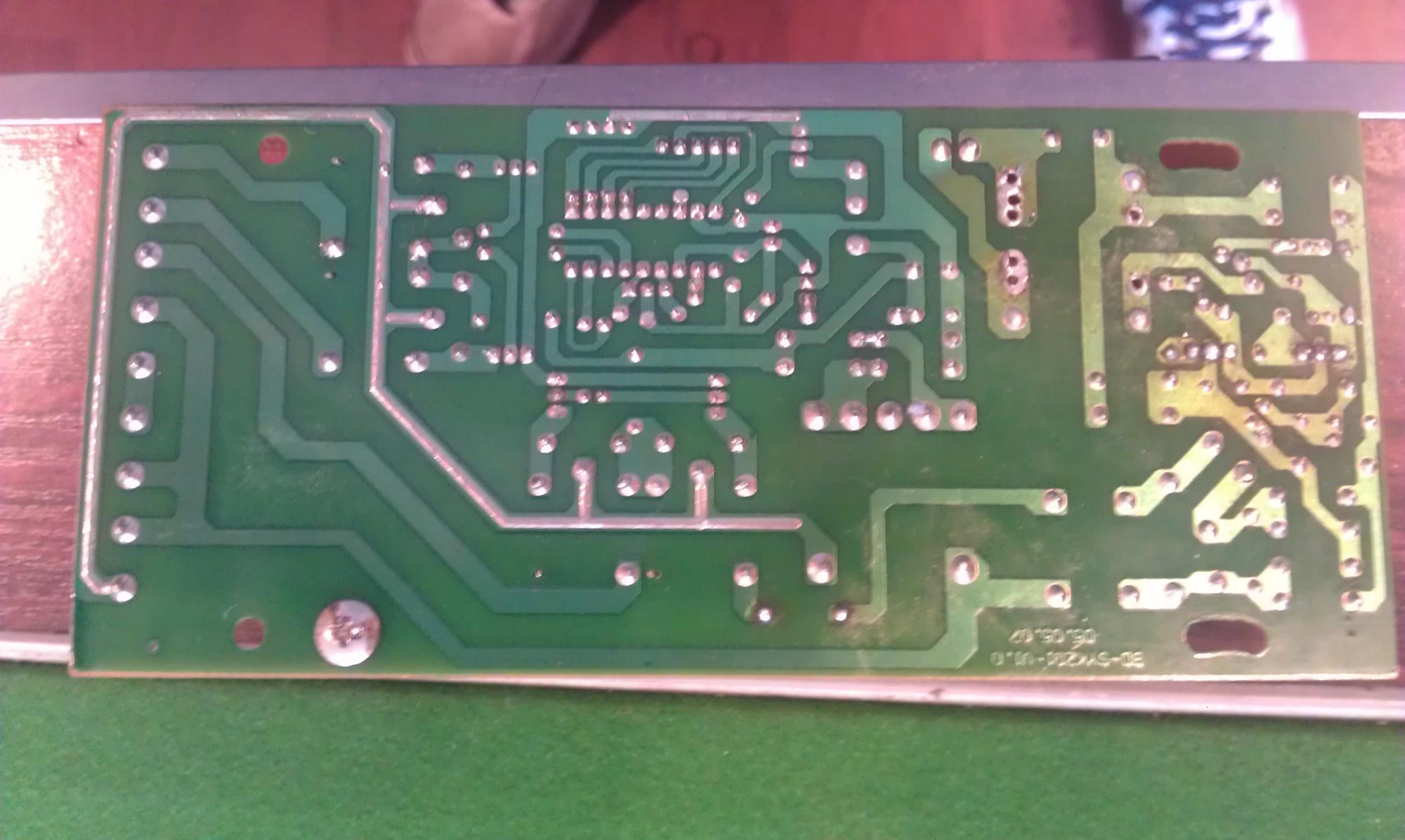

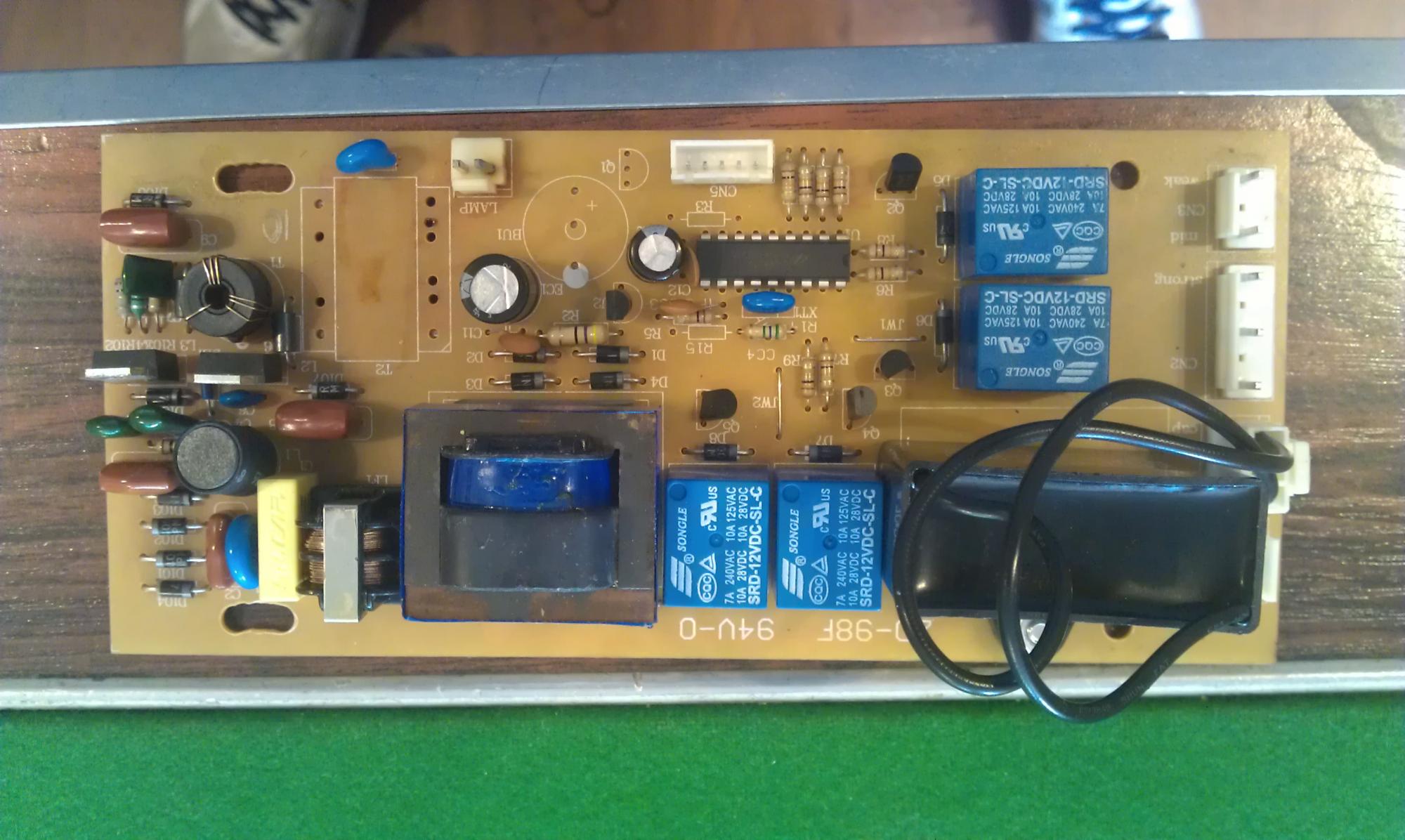

                    Re: cookerhood PCB Powerpoint ch581

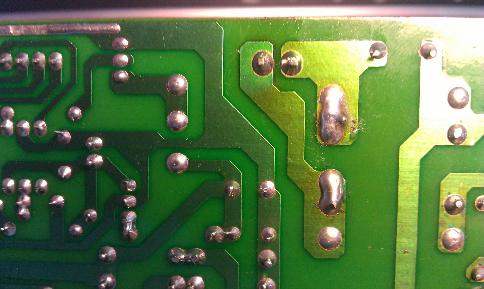

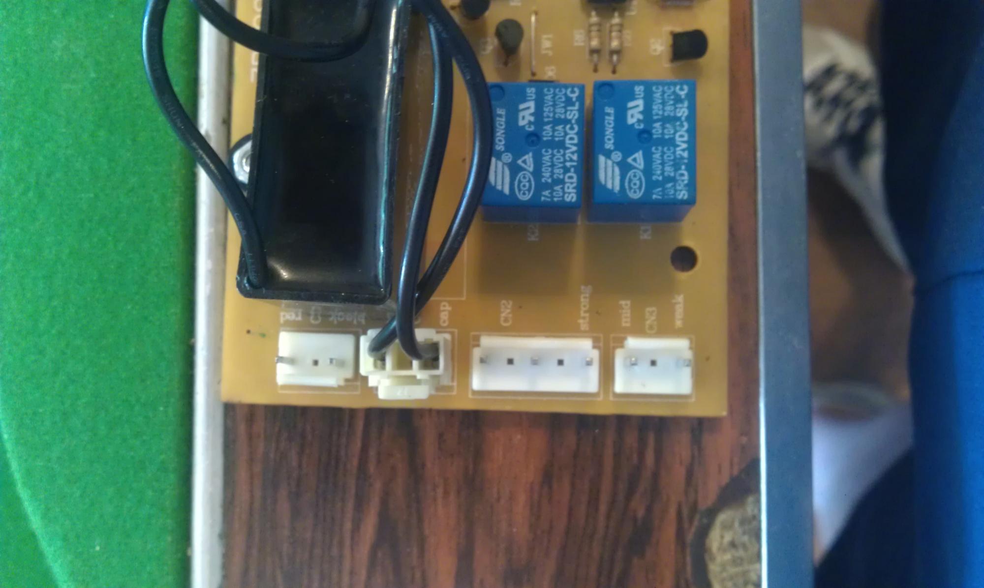

                    I think it's AC, have a look at the photos you may have a better idea that me.

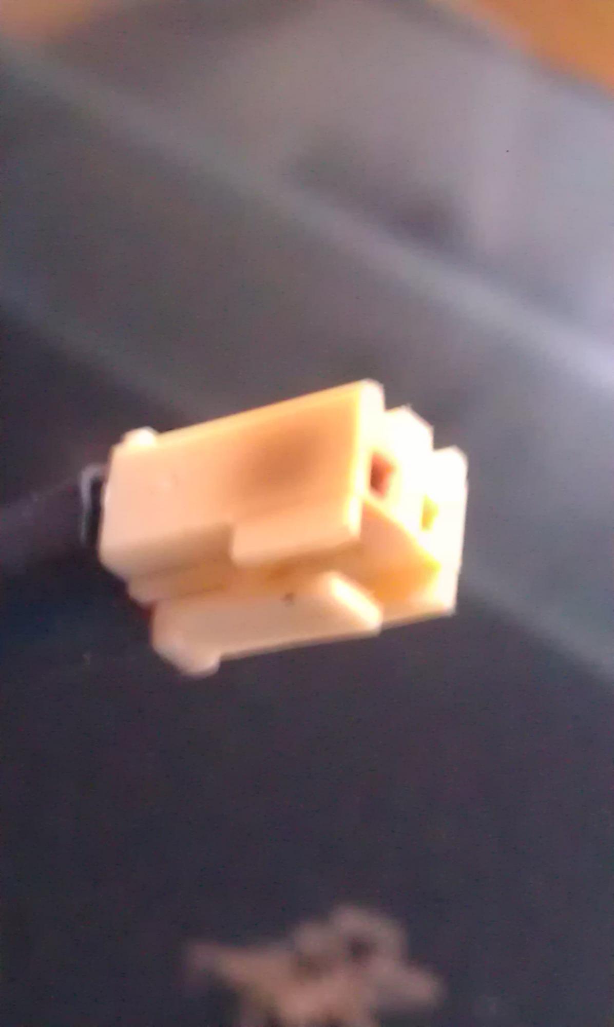

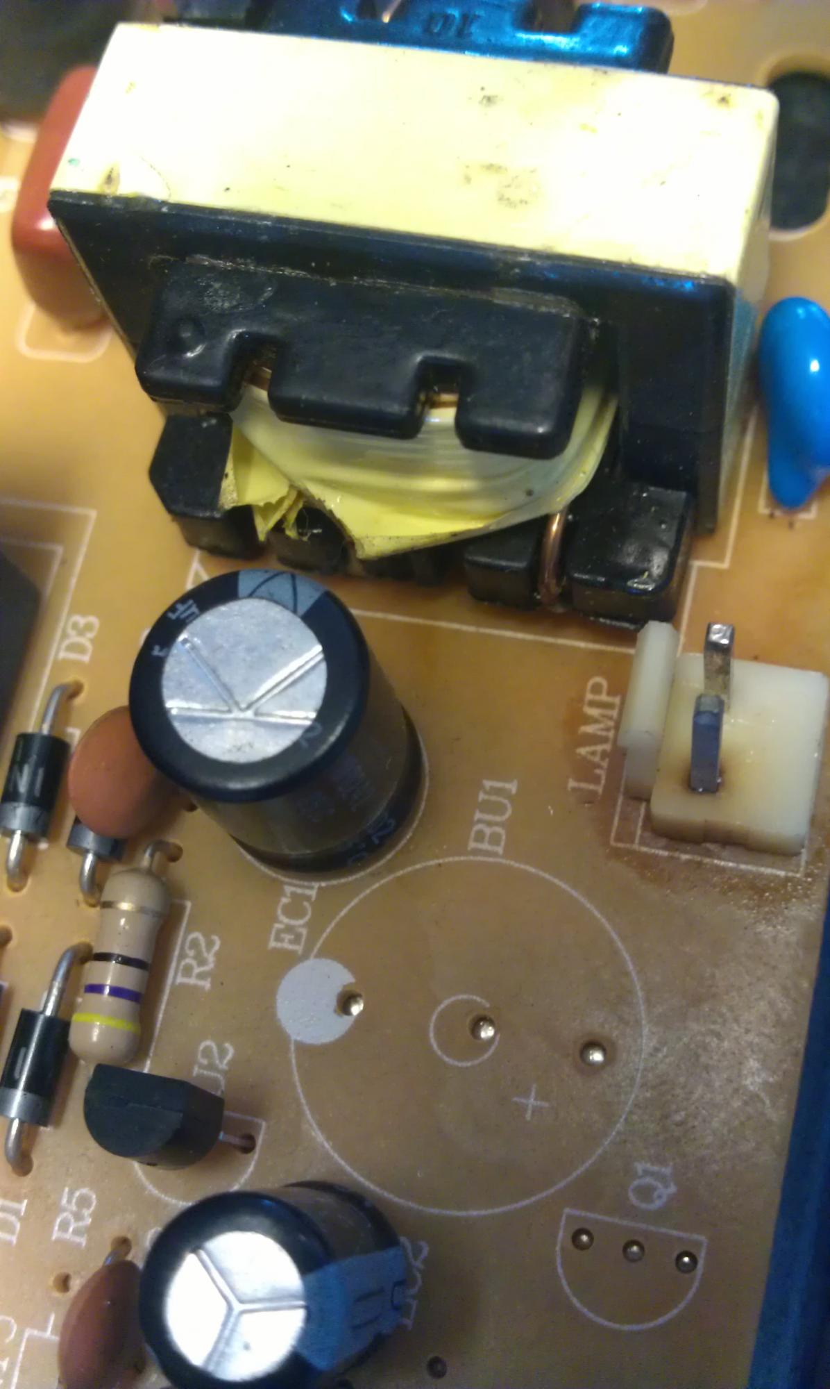

                      Looks like DC. What's that black package on the board? Also, the connector looks a little discoloured... check for cold joints on it.

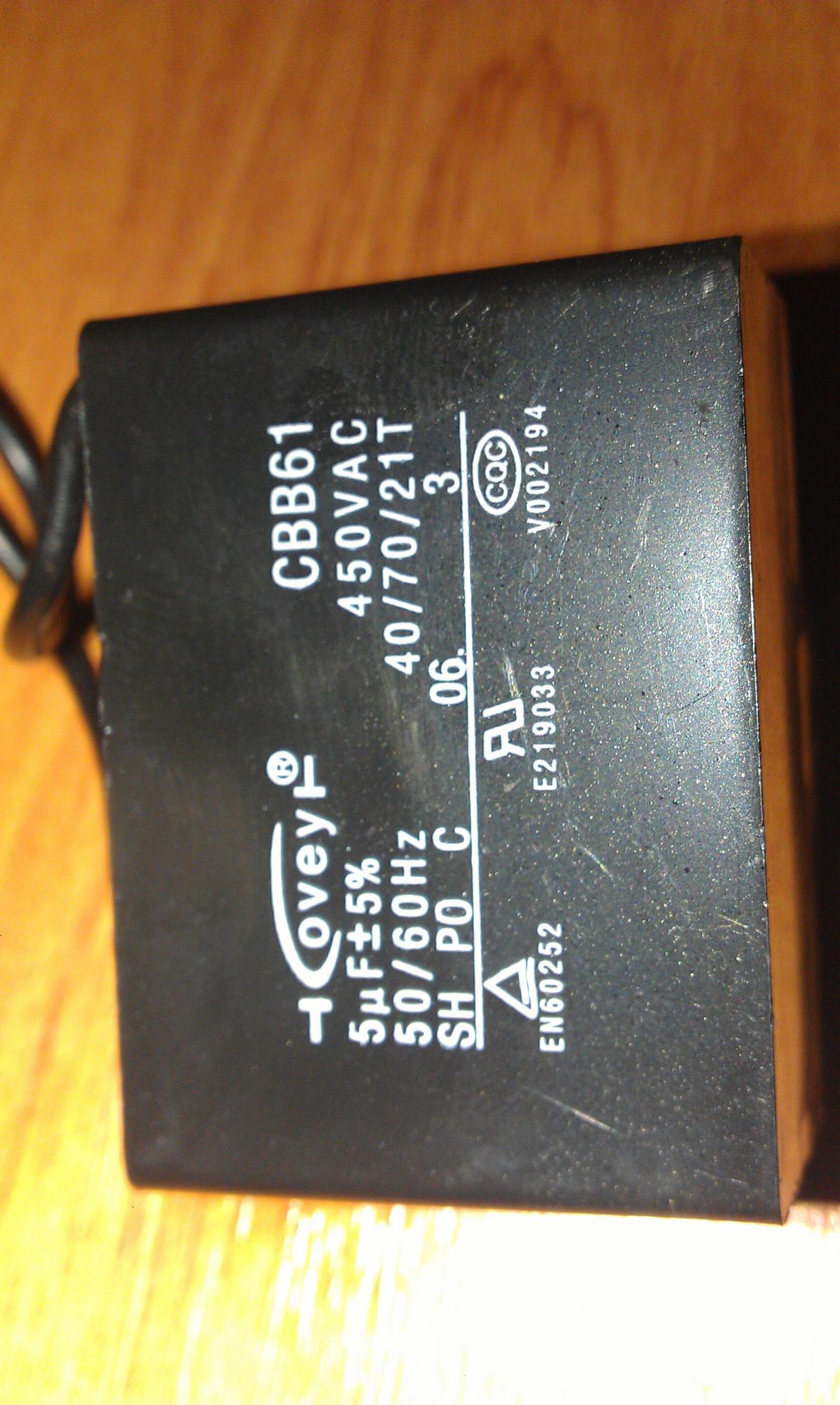

                        All the solder joints look good, The output pins to the lights look like the got hot before whatever eventually blew. This is a pic of the black box on the board, I think its a capacitor.
                          Interesting... maybe a motor start/run cap?
                          It looks more like a normal AC transformer, in which case have you checked fuses? It could be simply o/c on one winding which is difficult to repair...
                            The black box in post #12 is a 5uF 450Volt capacitor. Common for small motors to use it. I have seen a lot of failure in ceiling 'paddle' fans, causing them to run slow even on high speed.
                            The transformer in the second post is bad. Large diameter windings, if good, should have very little resistance. OL on your meter means it's an open circuit.
                            Also, replace that discolored lamp harness connector. A bad connection will only heat up, causing more resistance, causing more heat. (thermal runaway). I have seen a lot of pin-socket failures for those 12v 50W MR-16 lamps.
                            Most manufacturers in the US have stopped using them in recessed lights and track lights due to problems with the electronic transformers and sockets. Most of the MR-16 family fixtures now use the GU-10 twist lock bases at line voltage (120)to the lamps.

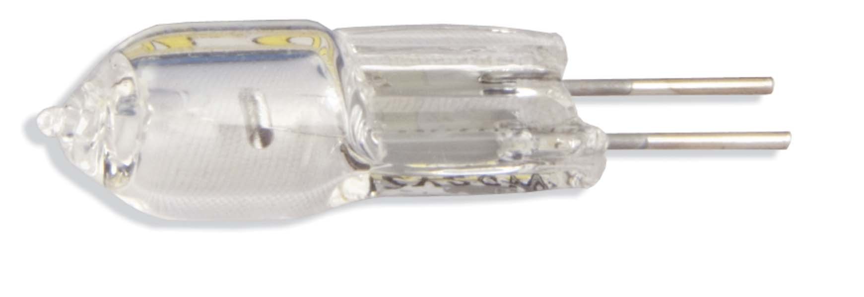

                                These are the bulbs
