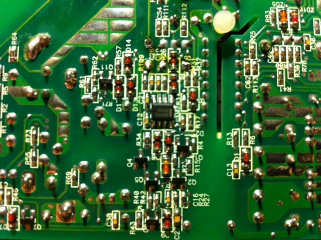

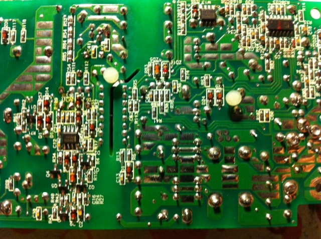

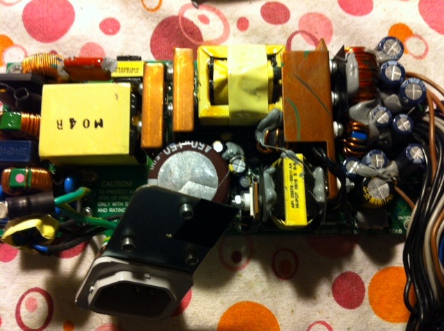

I have said power supply that has had all bad caps replaced and or checked with ESR meter to ltec specs. The power supply powers on fully both on standby and when jumpered. However, when jumpered the readings on the pinout that should be 5v or 12v read 5.5 and 13volts. I have 3 power supplies all identical that have this same problem. I've checked these values with a calibrated meter as well so I know it's not my equipment. Any ideas as to what would cause an increase in these voltages?

Is the power supply connected to any kind of load? If it isn't, the regulator may not be able to control the voltages. If not, you can probably load the main O/Ps - traditionally, +5V, +3.3V and +12V - to 5%-10% of the ratings and see whether you really have a problem. Getting the right value and power rating resistors could be interesting, of course.PeteS in CA

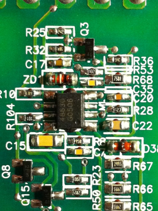

I've worked on several of these and never have the voltages been this high when jumpered without a load on them, which is why I thought this was odd. 5 and 24 Voltages show on the correct pin outs other than the fact that they are closer to 5.5-5.6v and 13v. This does have a the 4863G chip and TOP245YN. Let me know if you need different vantage points on the power supply.Comment

Where is the 4863? Out of frame?veritas odium paritComment

This has the WT7515 chip, yes? If so, and the supply is working, then everything is okay. The 7515 would not allow it to go out of spec like that. Try measuring on the board, directly at the junction points for the output leads, instead of at the connector.

I finally got them all working. I setup the connector so I could measure the voltage on the iMac motherboard in real time while it was in use. The voltages were all correct once their was a load on the power supply.Comment
