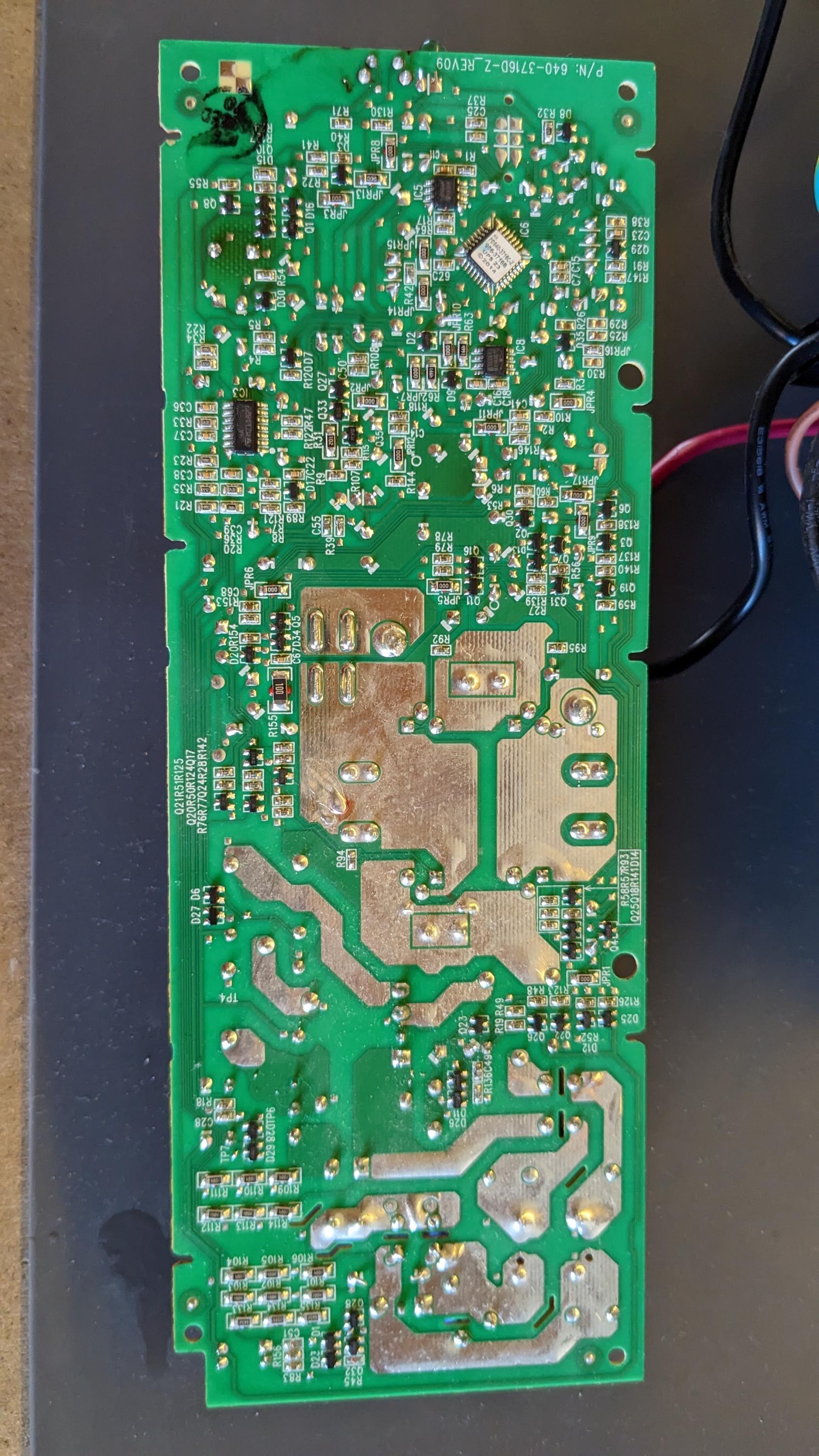

          #124
          Re: APC UPS units - troubleshooting
          Thank your for your response.
          I attach some pictures I've taken.
          I hope the pictures are sufficiently clear.

            #125
            most of these cheap units usually don't power on correctly without working accumulator(s) connected
            also do full recap, had this recently and it's same cheaped-out crap as all them chinese, several caps were beyond death (interestingly, it was quite baked around the buzzer, which seemed to got hot buzzing constantly)

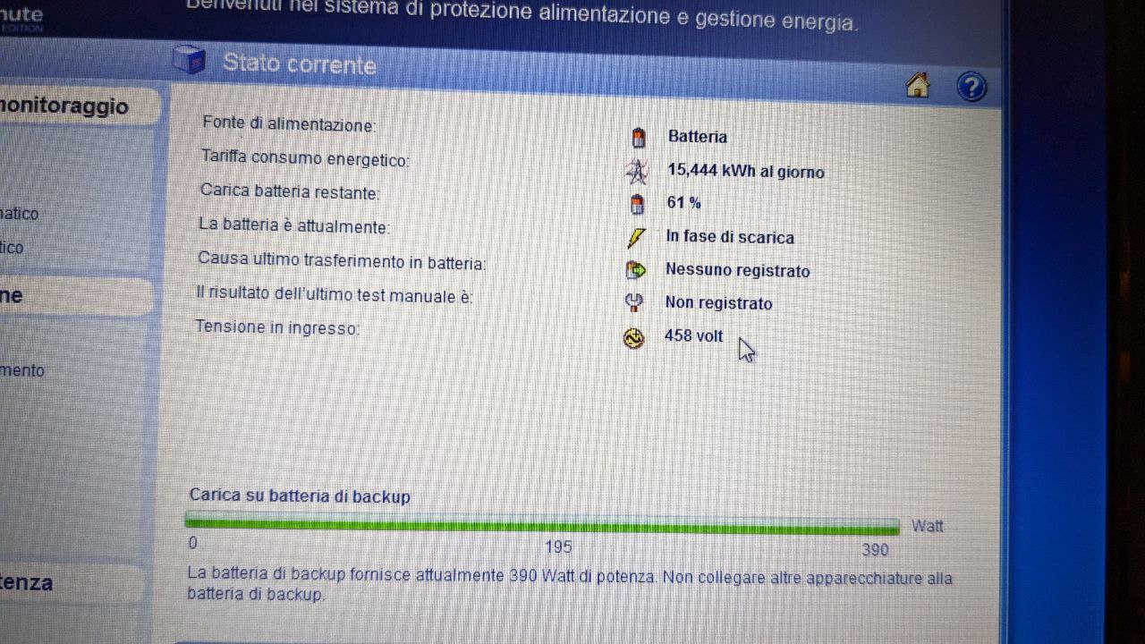

              #126
              Hi, I received the new battery and I did some tests.
              The output of the UPS stays on only for one second (same as powered with the bench power suppy)
              I noticed in the PowerChute software that the UPS is overloaded, and the input voltage is totally wrong (458V).
              And here's the warning that says that the UPS is overloaded
              Any ideas on what components I could test?
              I checked the resistors that form the resistive divider that is supposed to measure the input voltage, and they seem okay.
              Then I will check the relays and larger capacitors.

                #127
                I've now checked that soldering side of yours, it's also baked under the buzzer so the caps nearby will be toast as well
                suggest either measuring them first, or doing full recap right away, having those caps dead could give ya plethora of different problems, which may include the behaviour you describe
                other than that, check current sensing, R155 looks like it may be a current shunt?
                not sure if service manuals/schematics are already available for these boards, it's still fairly "new"

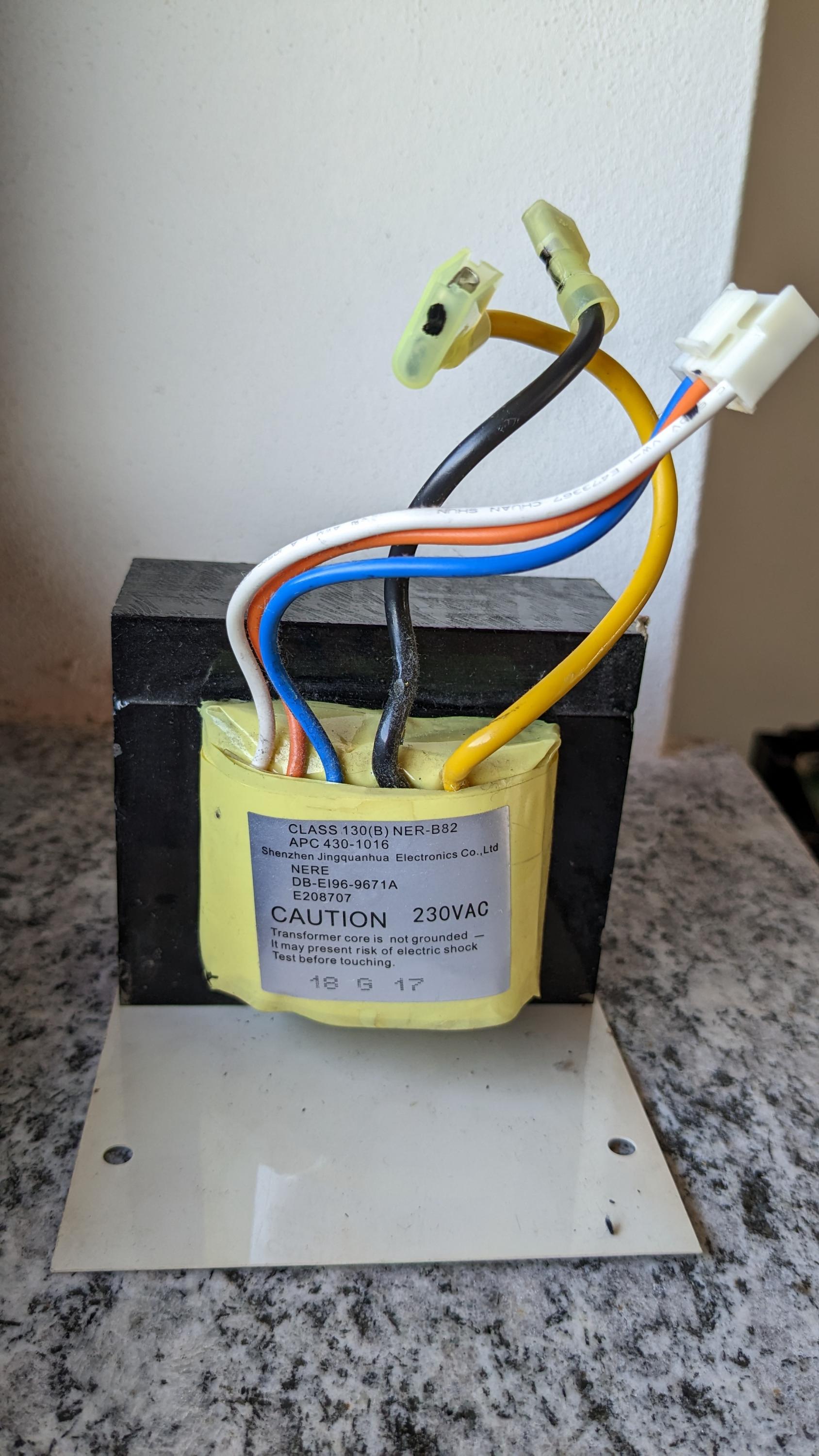

                  #128
                  Hi, thanks for your response.
                  I noticed that the buzzer gets very hot, so I desoldered it.
                  You're right, I found a bad 22uF cap near the buzzer.
                  I measured R155 and is about 10 ohm, is a value a bit high for a shunt.
                  I think the current is measured through the CT1 transformer, the model is "460-0102C-Z LEI-8 ID30" but I can't find the datasheet.

                    #129
                    dammit looks like me response was not sent
                    transformers rarely go bad and pretty much always are custom part, it's more likely some of them SMD components under it went bad, I'd say start with those diodes and resistors near the divider, around TP6 and 7?
