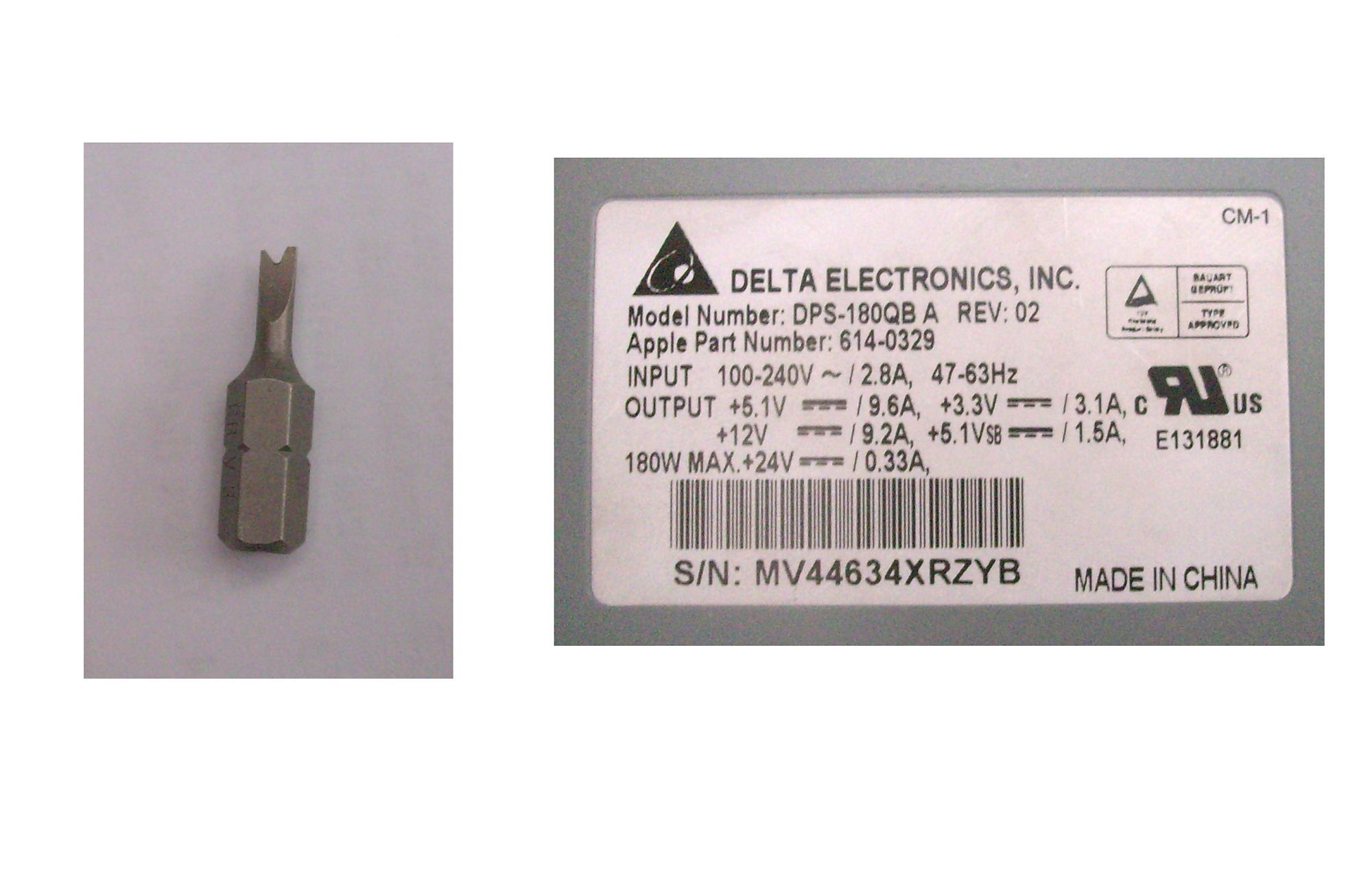

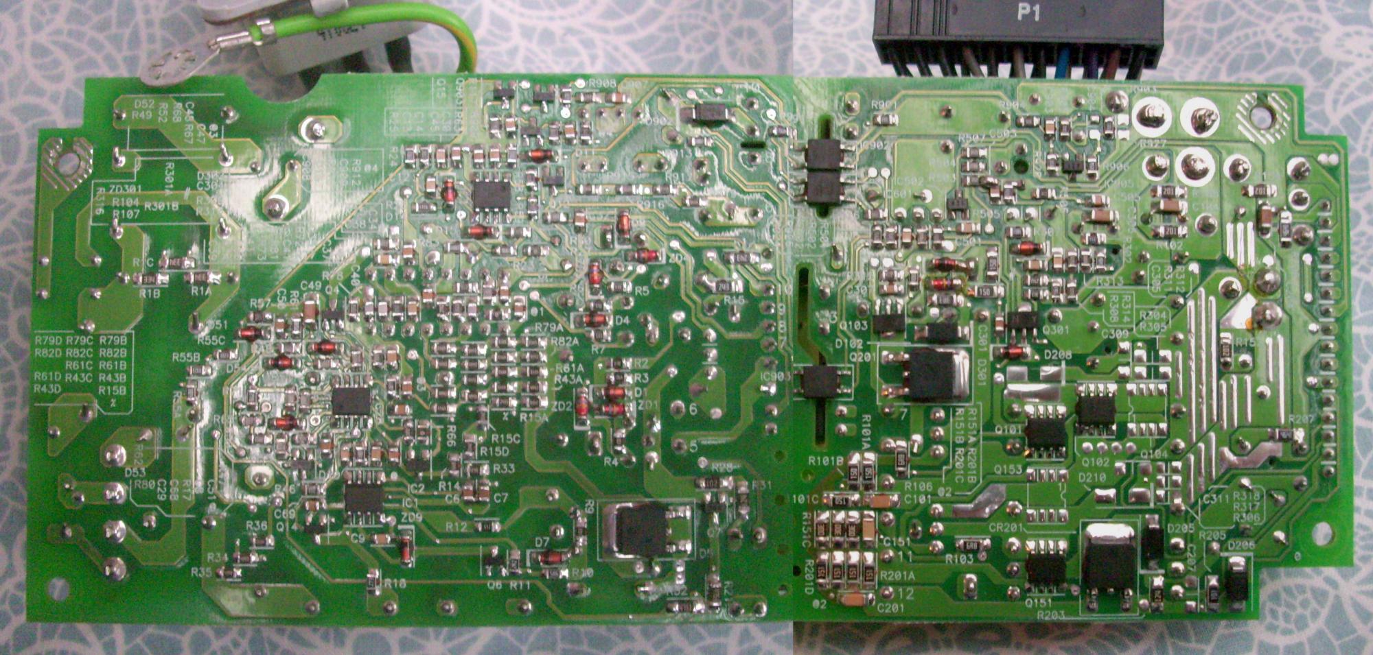

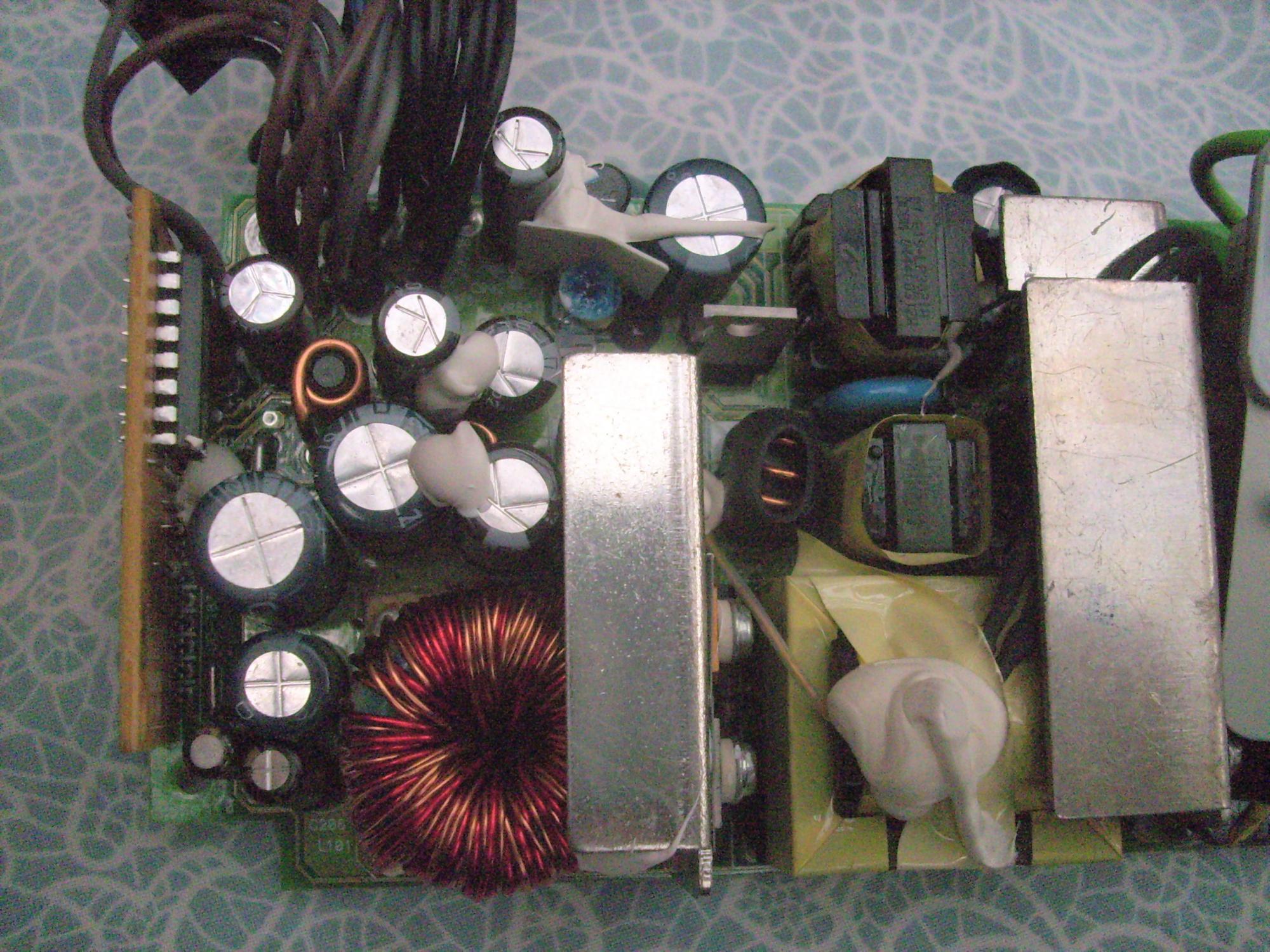

Suggestion now is that it MAY be the power supply causing problems. I have not checked output voltages under varying conditions yet but I have managed to pull the covers apart and looked inside - no apparent 'bad caps' on the board but I suppose that one or more may have dried out and show no signs ?
Main problem is that the supply does not look anything like the 'usual' ones shown on the www for capacitor kits - not A,B,C,DD or EE. I have posted pics for your perusal - have you seen one like this before ?
Any suggestions would be appreciated - should I try logging voltages under different fail conditions to try and get a clue on what is wrong as a first step in fault finding ?
