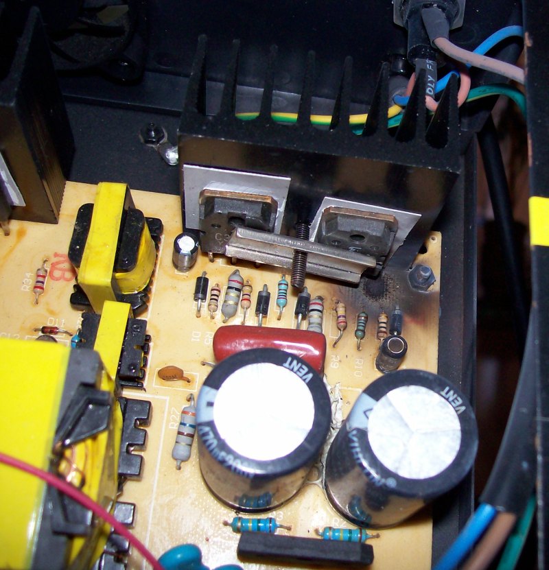

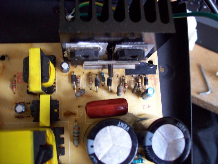

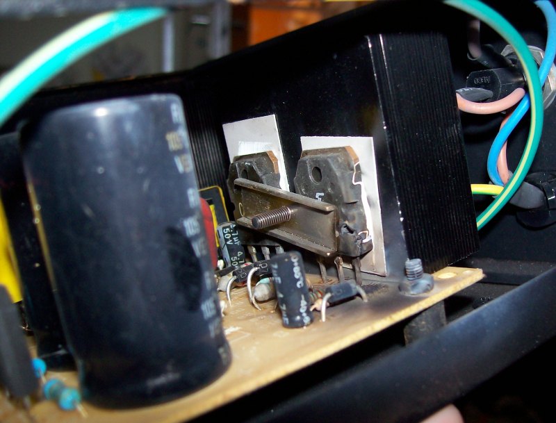

    This thing was charging some accus when it just simply shut down. I changed the fuse and turned it back up and then it blew. On the primary one of the c3306 got a hole on it, the other next to it got shorted. Also the pcb got a nasty burn and two resistors and one diode got open. Secondary has two 30 amp schottky-they are fine, controller is a 494, filter caps are United.. everywhere. The box has a 12V fan, which turns on if there is like more then 7A of load.
    I measured and tested everything. Had to change the transistors and diodes, both 2 ohm resitors and fuse and put some insulation tape on the pcb. Turned it on and it's working all day today so I guess it's going to be fine I don't know what caused it to blow up. It wasn't even overloaded.

    United caps are crap. While they may not be what caused your problem, I advice that you change them anyways.
    Also, make sure to change the 50v, 4.7uF caps near the transistors on the primary. If the diodes you changed were the snubber diodes that are in parallel with the transistors, make sure you used ones that were rated for at least 1000V reverse voltage and are of the fast/quick recovery type.

      Re: 13.8V HW1200R-20A repair
      Last one for me for tonight...
      That's a good 'ol half bridge.
      The two switchers are bad. The two freewheelers, two 'back-bias' caps (4.7u/50V) and 4148s, and the resistors associated with each switcher also have to go.
      Sometimes, the freewheelers are OK, but the other "small components" take a beating when the switchers go. I had one supply go and one of the 3.9K resistors in the base ckt went open and a 2.7 ohm resistor exploded, leaving a mess behind. You *must* clean all carbon, etc down to bare PCB material if possible. Otherwise, the leakage may 'surprise' you.
        I cleaned the pcb til the glass fiber. Only one of the the 4.7uf caps got replaced, it measured something like 5uf so I left it alone...
        The primary caps are ok, the ones on the secondary are in range too. The worst esr was 0.076, the one next to the output filter coil. Maybe I'll replace them sometime. This powers supply is 4 years old.
        I replaced the diodes with the same type, some ultrafast type, I don't remember the numbers and it's not visible.
        On a side note, the assembly of this box is a bit unfriendly. The screws are some non standard, probably to prevent users from opening it up. They have these notches on their sides.
          The 4.7uF caps are part of the circuit that drives the primary transistors and they should always be replaced as a set. Mismatching them can lower the efficiency of the PSU and cause the primary transistors to heat up more than they normally should.
          Also, while their capacitance may measure the same, the ESR on one of them could be too high.

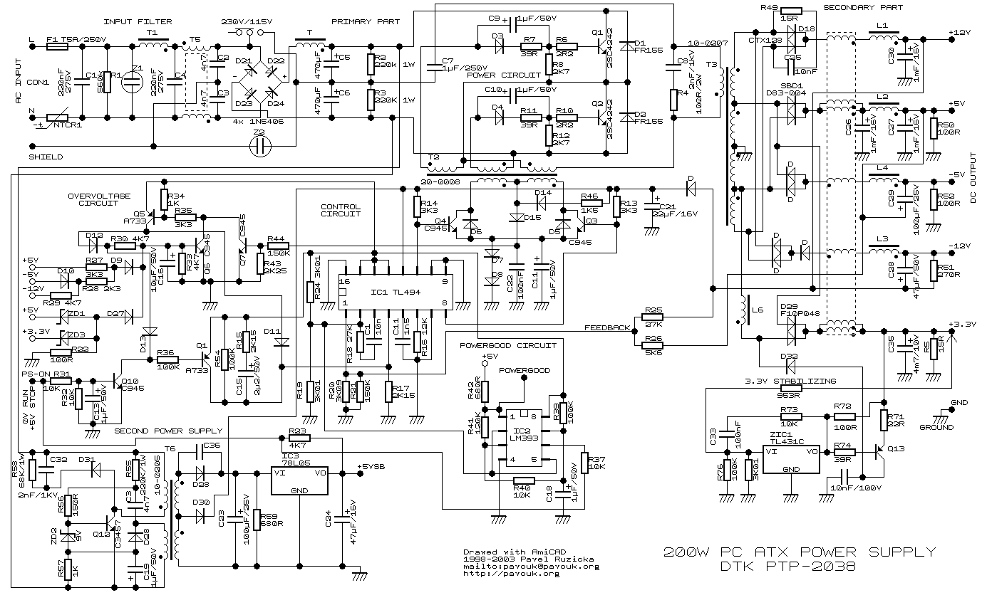

                    Mechdave,
                    I have just fixed my HW1200, it was a bit of a mission but sounds like you might have similar problems. My output voltage varied around 6 volts. I replaced all the caps apart from the two large ones in the main 340V dc supply to no avail. Finally I checked the supply voltage to the 494 (pin 12) which should be greater than 7 volts - it was not hence the reg output could not get up to 5 V either (pin 14). Turned out Q3 (S8050s NPN) had gone leaky dragging down the 494 supply. I replaced Q3 and Q4 with a couple of BC337s and away it went.
                    Hope this helps
