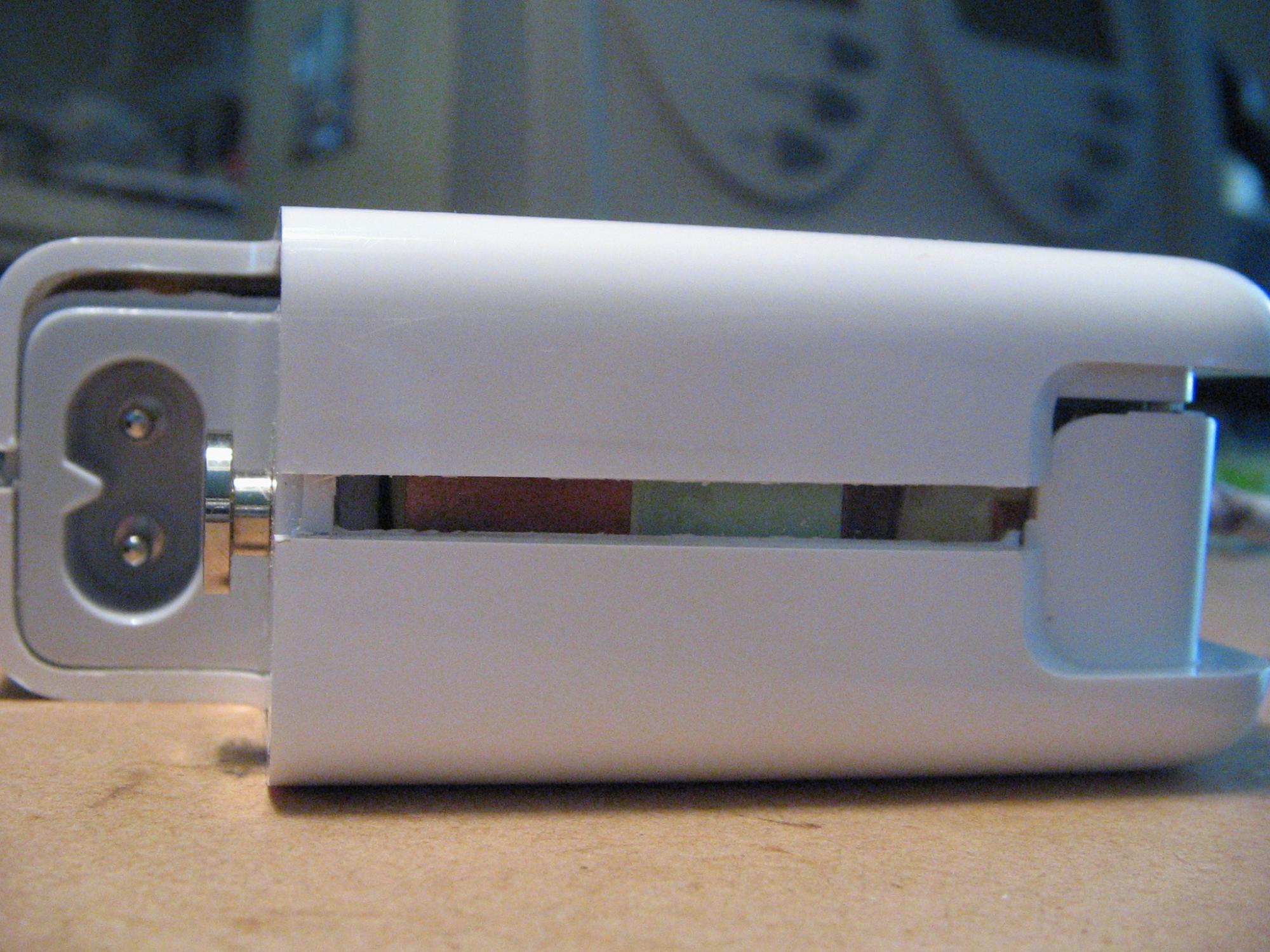

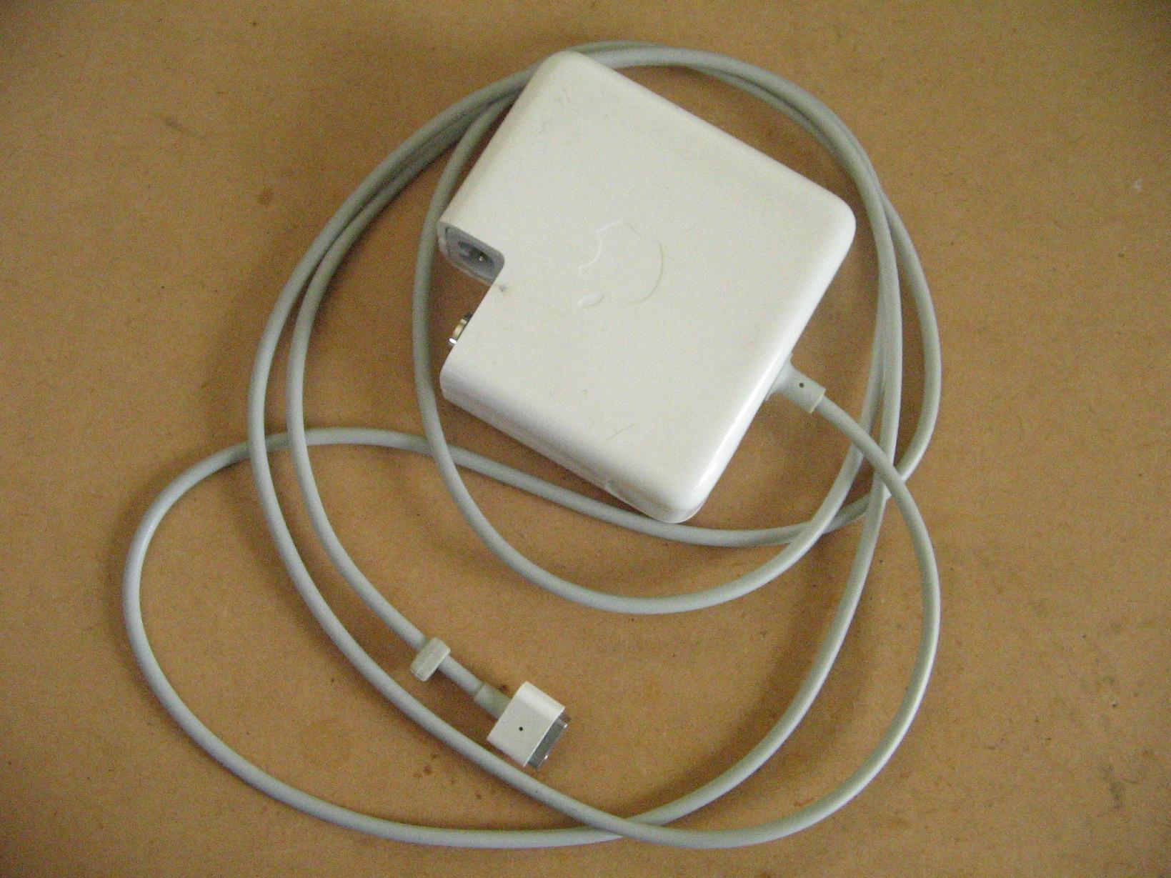

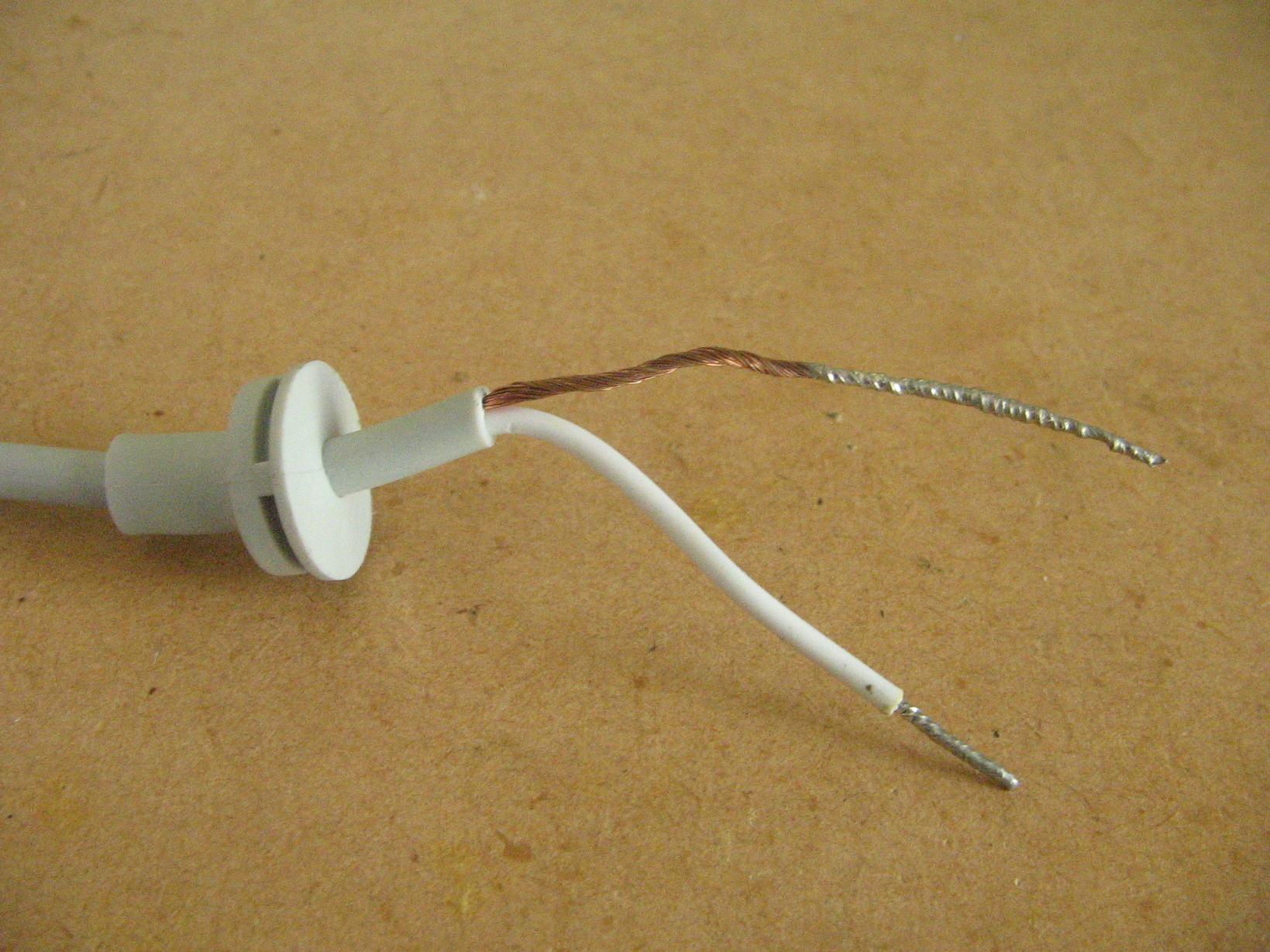

    I was given one of these to fix - and you guessed it - the cord is broken (surprise, surprise!)
    Looks like you can get the cords on eBay, although considering the way these adapters are glued shut I fail to see how they could be a standard spare part from Apple, in which case I suspect the authenticity of them.
    Anyone bought a Magsafe replacement cord from eBay? Does it work? I expect they do, since the feedback history on the sellers show people who bought them to be happy.

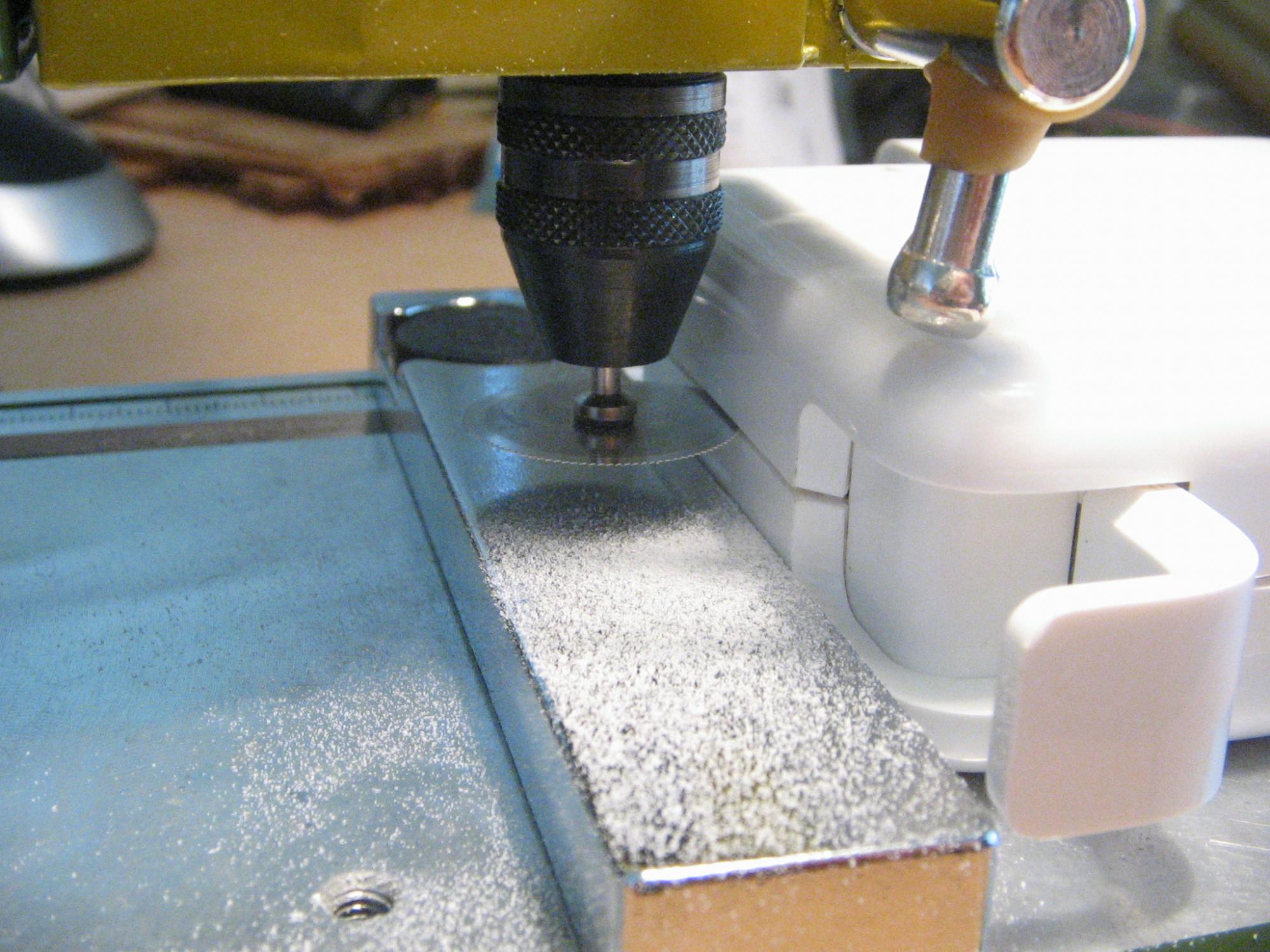

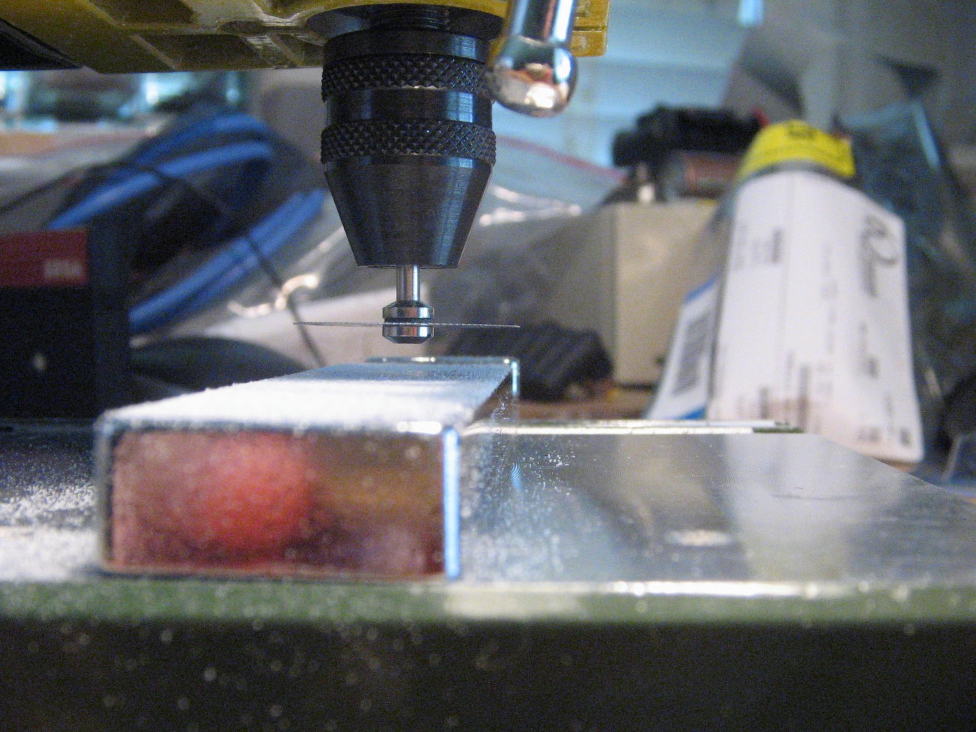

    In any case, that all matters not if I can't get the thing opened without damage anyway, so I decided to work on that first.
    Now, most people seem to open these with a hammer and chisel or some other horrible method causing gross disfigurement (shocking for an Apple product, of course!) so I figured I'd try something different.
    See the attached photos for how I opened the case. (some force was still needed to open, but it was a lot less than otherwise, and tool marks were kept to a minimum)
    Reassembly could be done with more glue (but in better locations) or just duct tape etc which would allow for future repairs without a big fuss when opening it again.

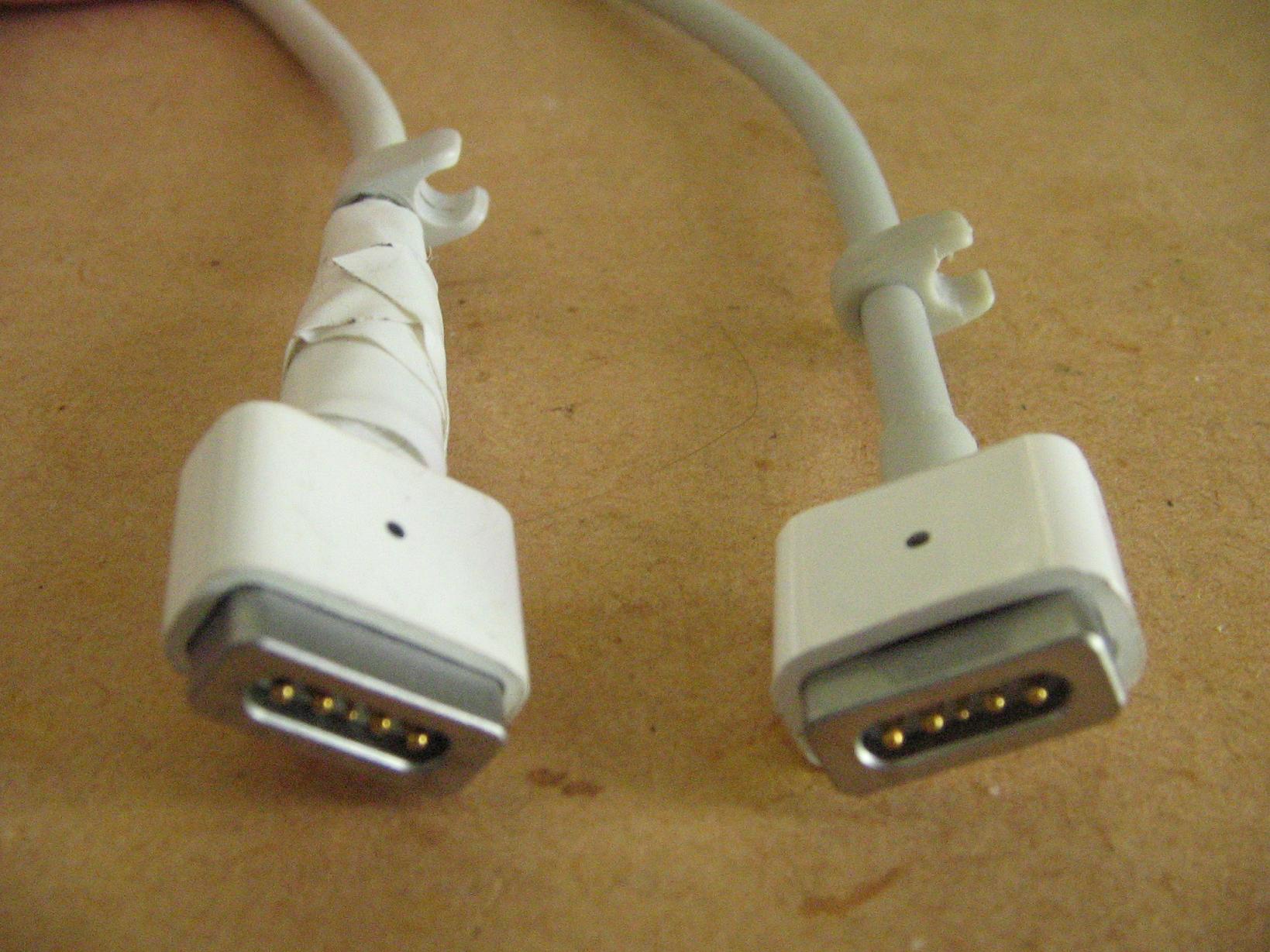

    Re: Apple Magsafe 85 watt power adapter - cord replacement
    Well, I received the replacement cord from eBay today. It looks very similar to the original but a bit cheaper. The cable is also not as flexible as the Apple one, but maybe that's a good thing.
    I will do the replacement soon and post on how it goes. Should be fairly simple. At least Apple appear to use decent capacitors in this thing!

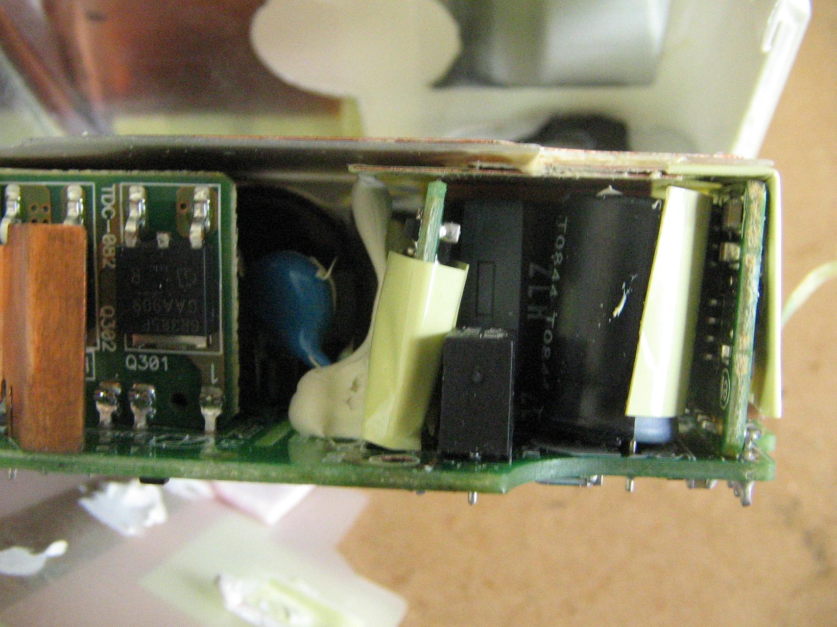

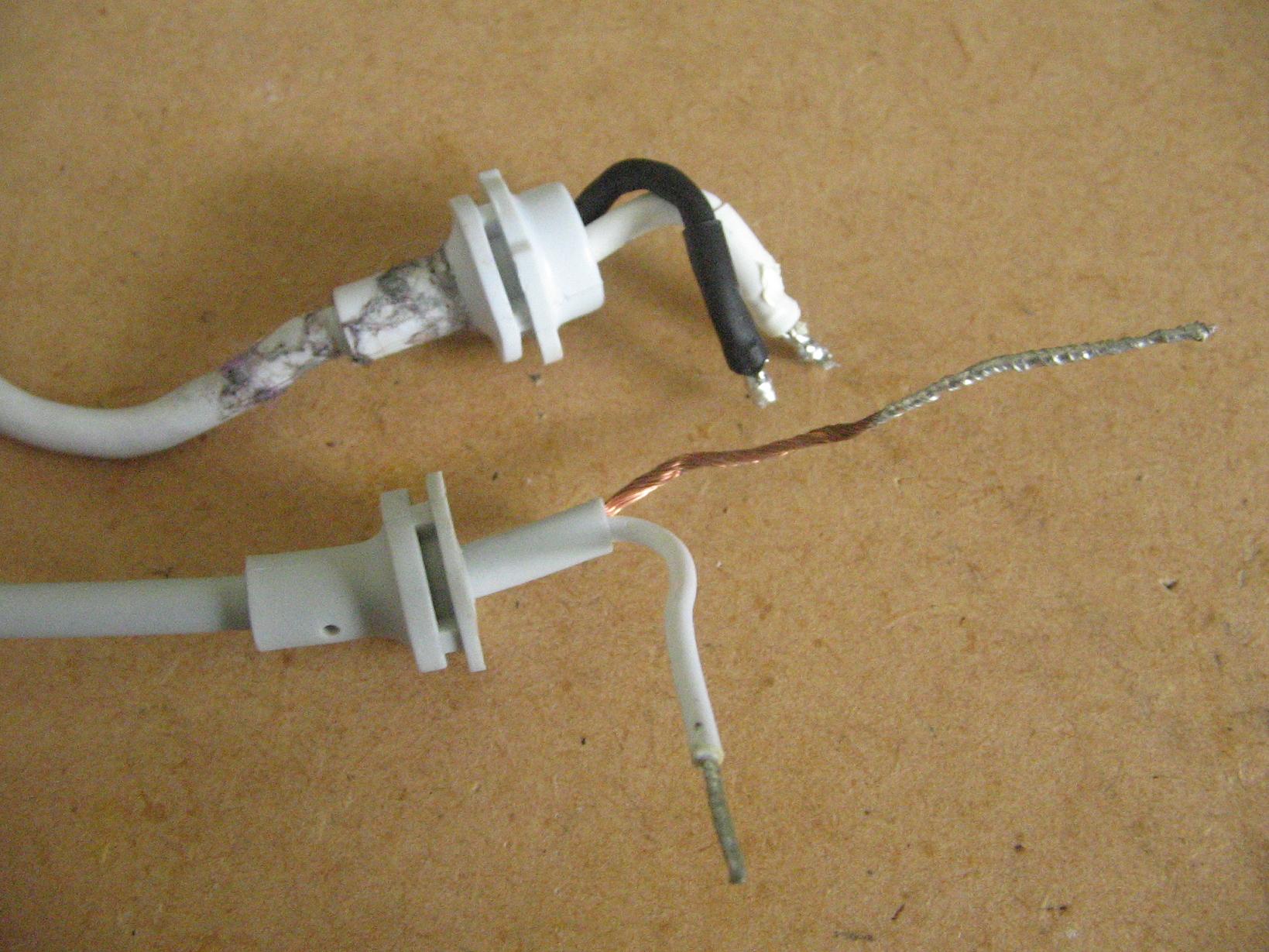

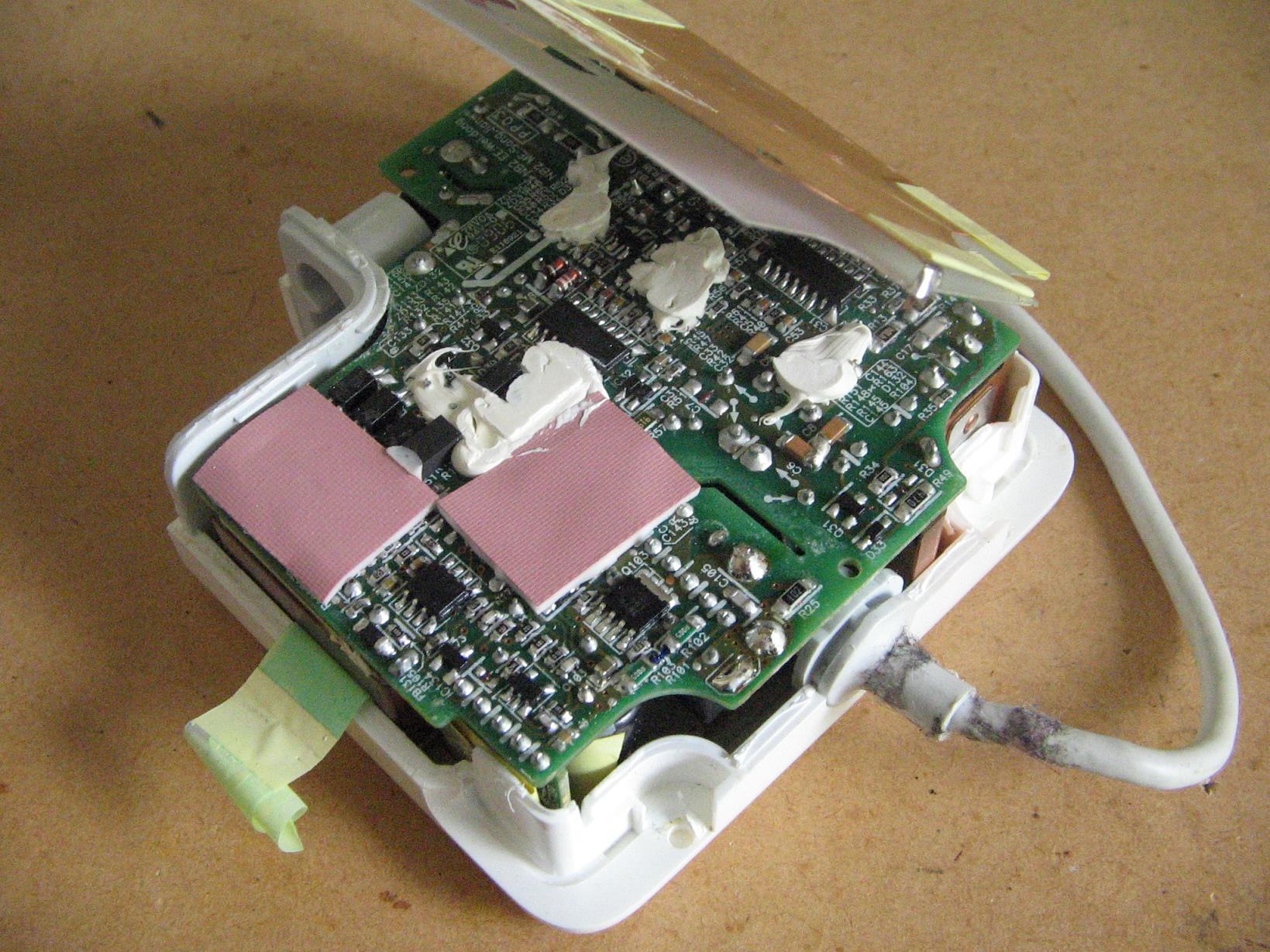

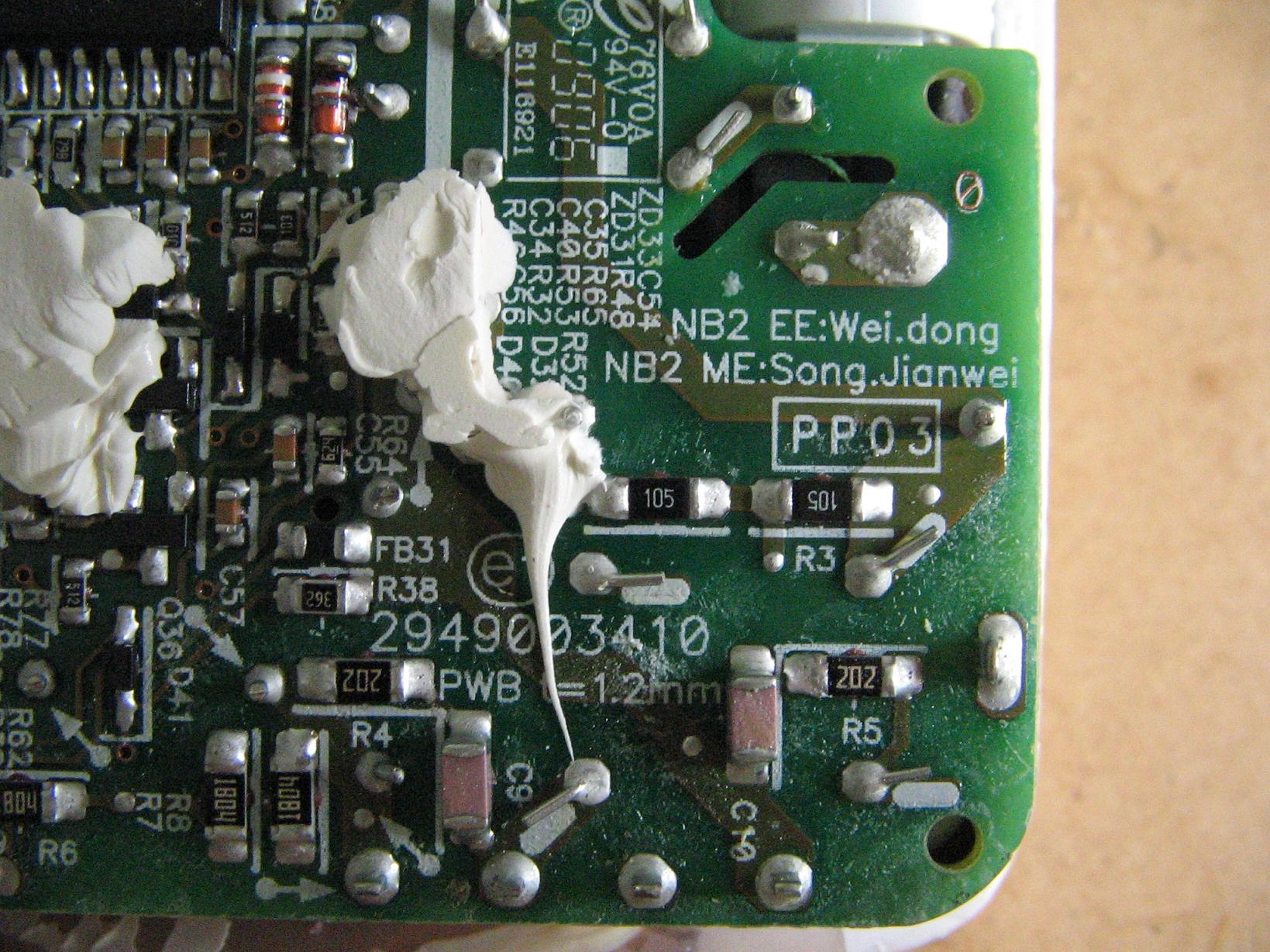

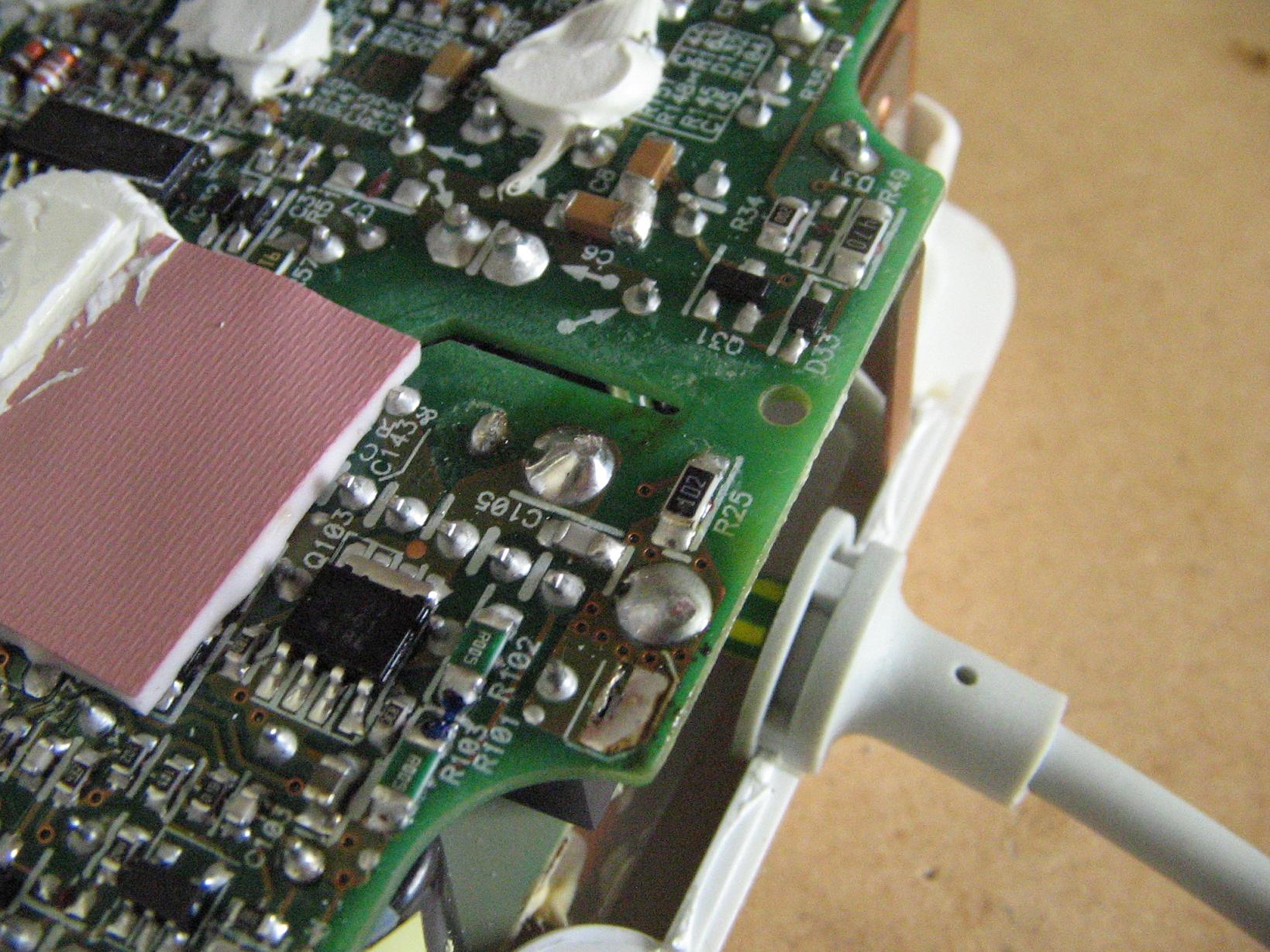

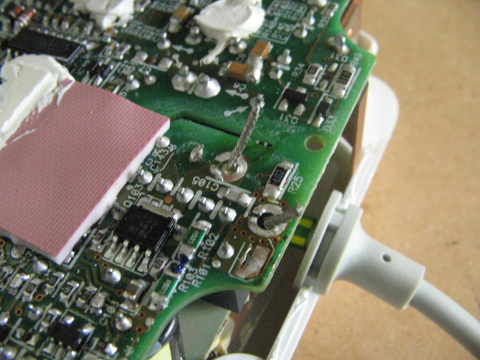

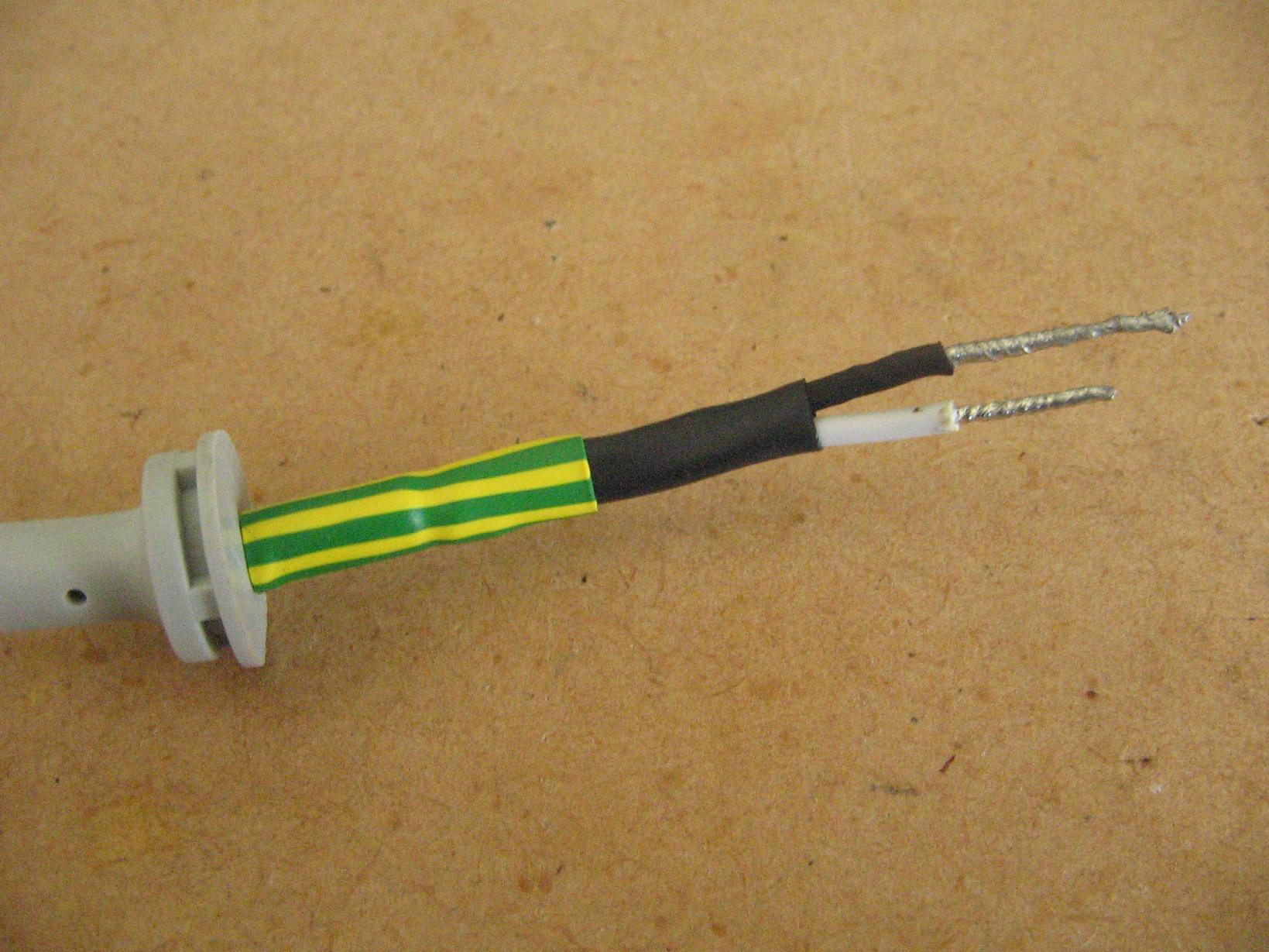

          New cord installed today, all seems to be working OK.
          Took some photos showing the installation and some closeup of the adapter board.
          Didn't open it further. Capacitors all seem to be Rubycon ZLH which is nice though.
          New cord was a bit lax on the insulation though, needed a liberal dose of heatshrink.
          Adapter was taped back together after testing on the laptop, hence no photos (but I'm sure you can imagine it!)
            Looks like you did a nice clean job of that!
