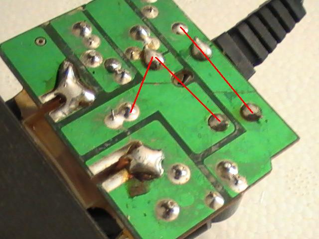

    Can anyone maybe help me in repairing this little Brick Power adapters PCB. I was actually going to replace a bad cap on it but missed a screw and ended up breaking the PCB in 3 pieces.
    It looks pretty simple and I was thinking since I am pretty good with the soldering iron I could maybe solder some wires to the exposed connections on the back.
    its for my speakers, and output is 15v and 3A (about 45 watts?)
    repairable? I have already used super glue and glued it back the best I could.
    sorry for the crappy images, my camera is no good

    A few millimeters around the cracks, scrape the green stuff off to expose the copper layer. Then use plenty of flux and cover it. Next, add solder to the mix. Done. You can also use a few pieces of wire or resistor terminals or something, if the solder doesn't want to bridge across the cracks by itself.
    But if you used enough flux and if your iron is hot enough, you should be able to do without wire. Beware - the opposite is also true - if the iron is too hot then the solder will tend to stick to the iron not the board. Then again, that is a single sided power board with large traces so it's fairly difficult to damage with a soldering iron, so feel free to experiment till you get it right. Use a multimeter with a buzzer to check continuity.

      Lol..thanks for showing me the trick, I am good but not that good, .. could you please maybe show me how to do it with the wires if I fail to do it the flux way? its broken in 3 different pieces(as you can see from the first pic) and i have never seen such a pcb, i dont se any lines that connect, all the green stuff. so not sure which terminals and points should I connect. they are all in the green lol. so a bit confused if i was to do with the wire method, which terminals would i bridge.

        The light green is copper underneath, the dark green is the spacing between the traces. So basically, scrape of the soldermask (the green above the copper layer) around the cracks as Th3_uN1Qu3 suggested and follow his instructions and it should work.

          Maybe you need your eyes checked... because this PCB is about as simple as they get. The traces (well, they're more like "lands" on this one) are connected by the components on the other side, duh.
          Anyway, here's how you would do it if you wanted to just use wire.

              oh and by the way just one more question, I'm not sure if you guys noticed, but the pcb is broken from this part aswell. so is there any other joints i need to make here?

                I got that already covered in my drawing.

                  Yey. The adapter is fixed! I managed to scrape off a little to expose the copper and then applied flux and then some solder and tada! it formed the bridge!. Just for good mesure I also used some wire across the terminals. Just to be sure The noise is still there on my speakers, but I think its because of the 6700uF 25V cap(?) I think its there to filter the electricity and since its a bit bulged, its not doing its job properly,(?) I'll replace it and see from there
