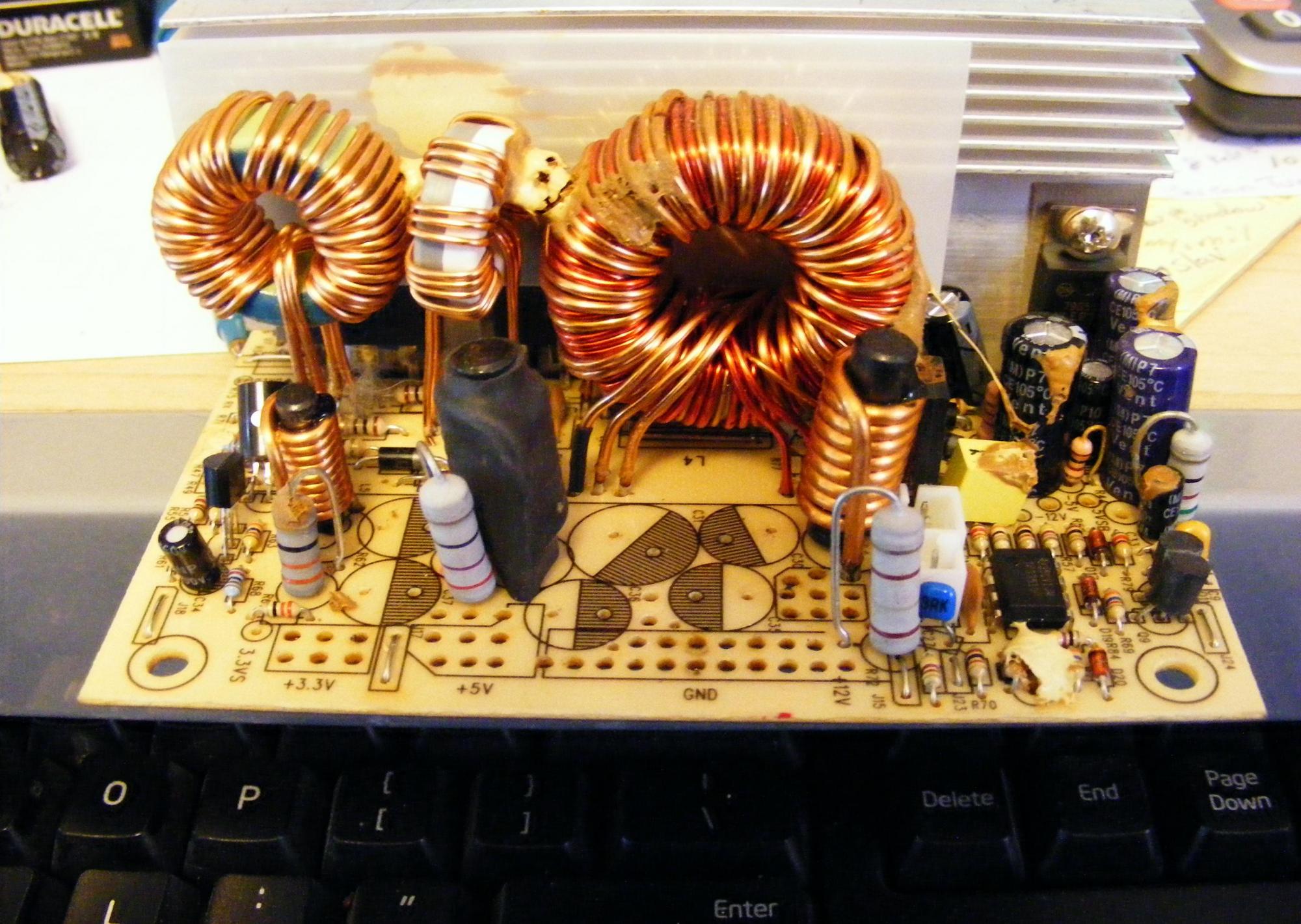

    Hello everyone im new to your board, and need alittle assistance. I had some bad caps in my Antec SL400 and went out and bought a solder remover, as I was de-soldering, DUH I forgot to get pictures of my board and took all the bad caps out without taking a picture of where they go?, can someone please assist me with a picture of the caps and or a site witch would tell me were I place the new caps at. Again thank you all for your help and assistance, Lesson Learned.

      ok the model: SL400 Smartpower Rev on the board itself is D04
      I pulled caps;
      C30, C31, C32, C35, C36, and C37 all are the large caps
      cap 4700uF10v 30.35mm length, 10.21mm Dia
      two caps 2200uF16v 30.39mm length, 10.22mm Dia
      cap 3300uF6.3v 24.65mm length 10.23mm Dia
      two caps 3300uF10v 24.84mm length, 10.19mm Dia

        If you have only pulled the OP filter caps it will be easier.
        That doesn't change much from model-model plus you can figure some of it out by tracing circuits with a DMM.
        The 2x2200uF/16v are obviously from the +12v rail.
        I -might- have an SL[something] I can look at tomorrow for the normal layout.
        I would be surprised if someone else here doesn't have one around to look at as well.

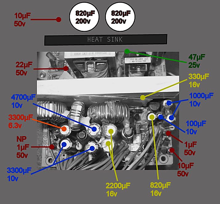

                  This thread:
                  https://www.badcaps.net/forum/showthread.php?t=8385
                  Has a PSU that is probably closer to yours and has lots of photos.
                  Perhaps you can snag enough puzzle pieces to figure out where the caps go by process of elimiation.
                  Is the layout like yours?

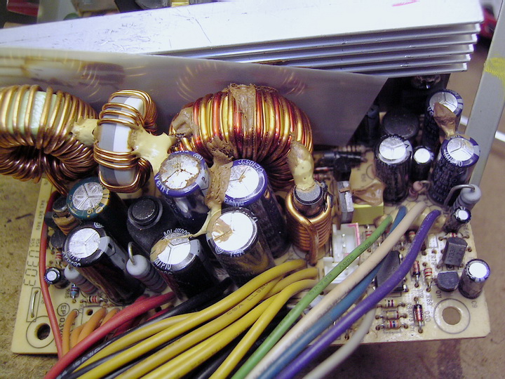

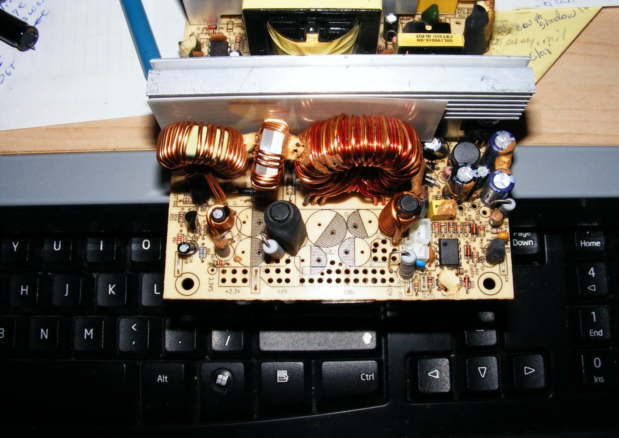

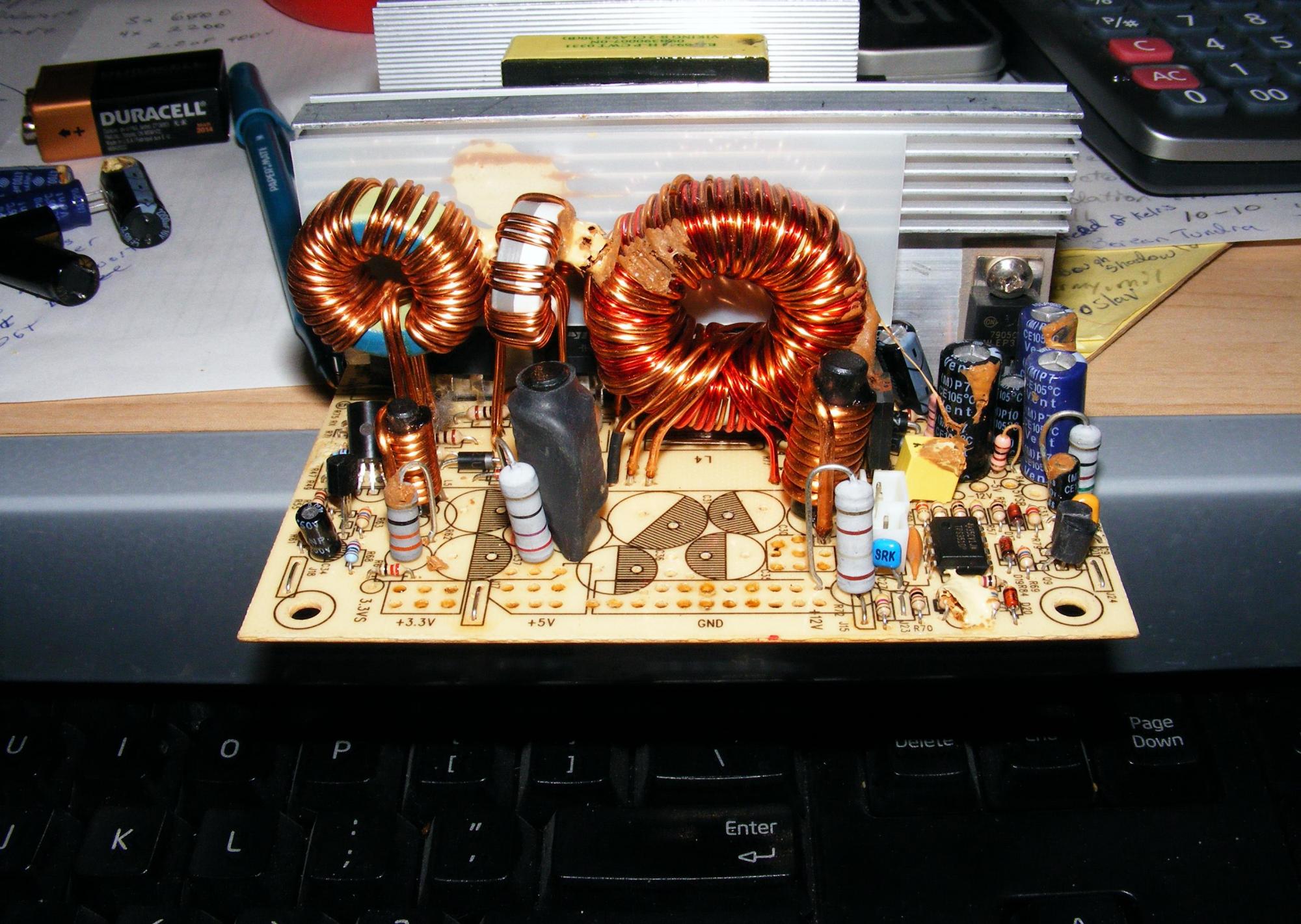

                    yes that is as close as you come to the board, I went ahead and pulled the wiring off so now i can totally recap and rewire the enitre board, going to take some pics so I can show you
                    • Zorro57
                      • May 2011
                      • 8
                      Re: alittle help please SL400

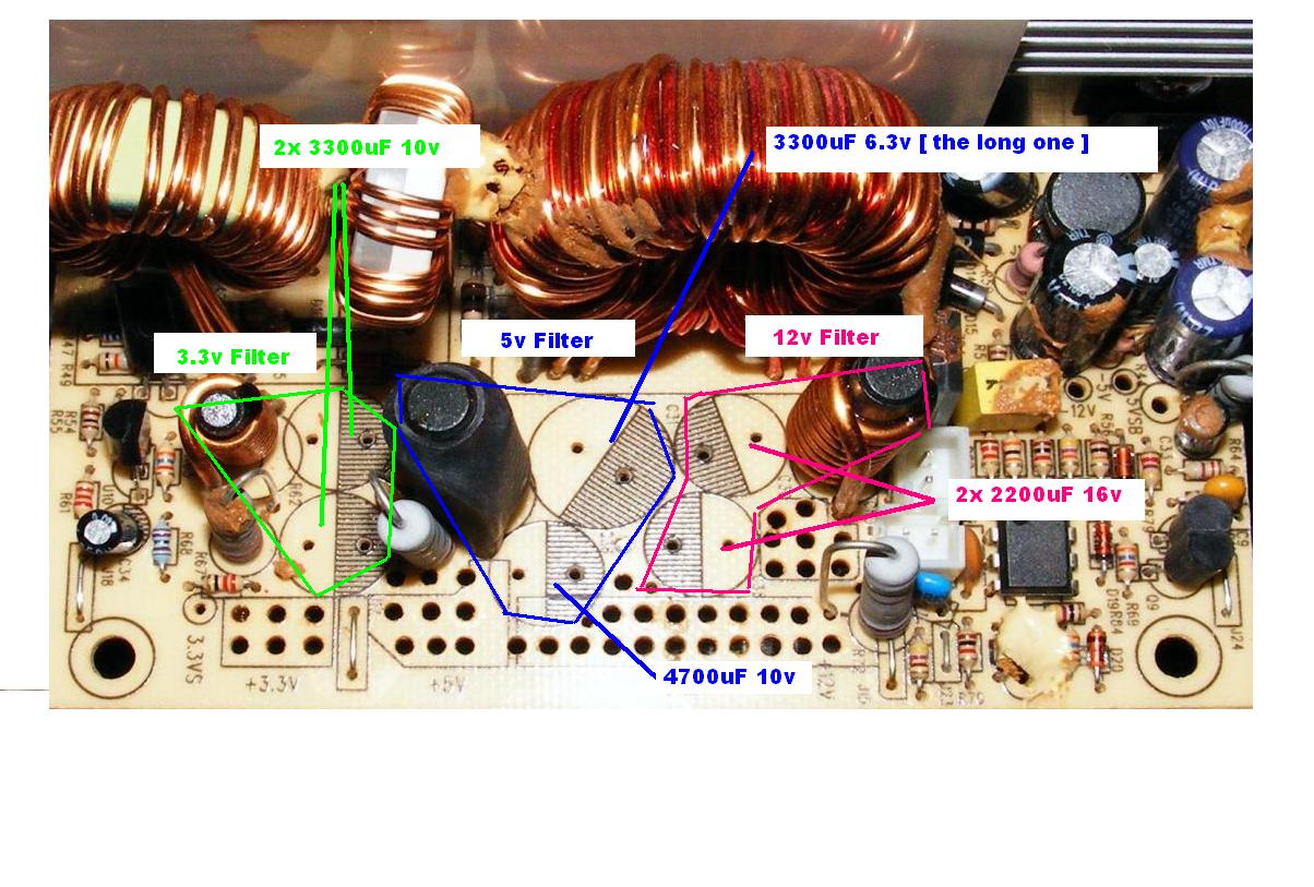

                      im submitting these photos to show you what I have then I found an old pic of a Antec SL400
                        Here is my guess then but it's a guess, check with DMM to be sure.
                        The two 16v are obviously the +12v caps.
                        The long one's location can be seen.
                        The two to the left are the same size.
                        And PSU's of that age favored the +5v rail.
                        So here's where I -think- they go.
                          thank you so much, I guess was almost right, I had the 3300 in the wrong spot
