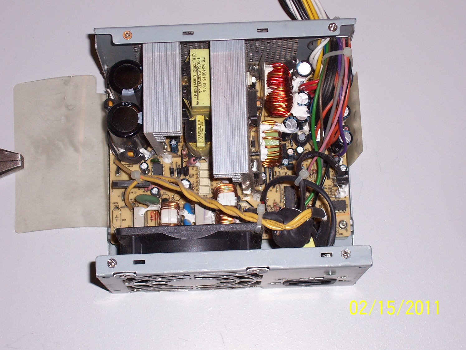

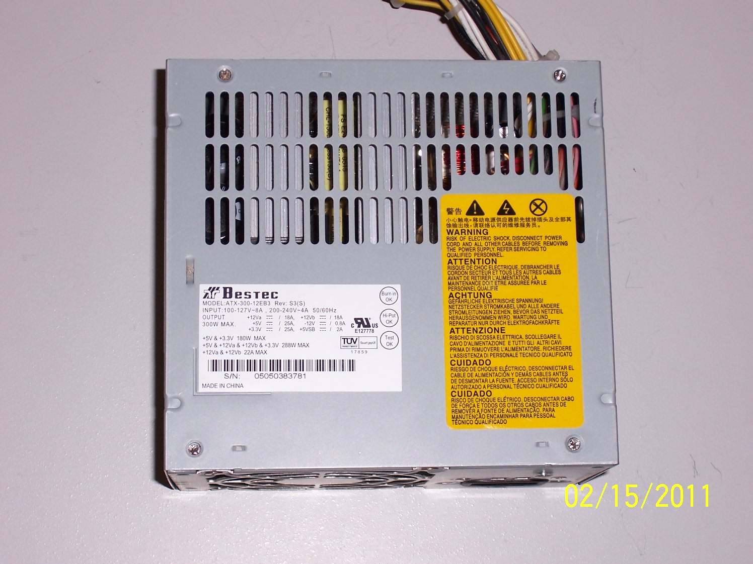

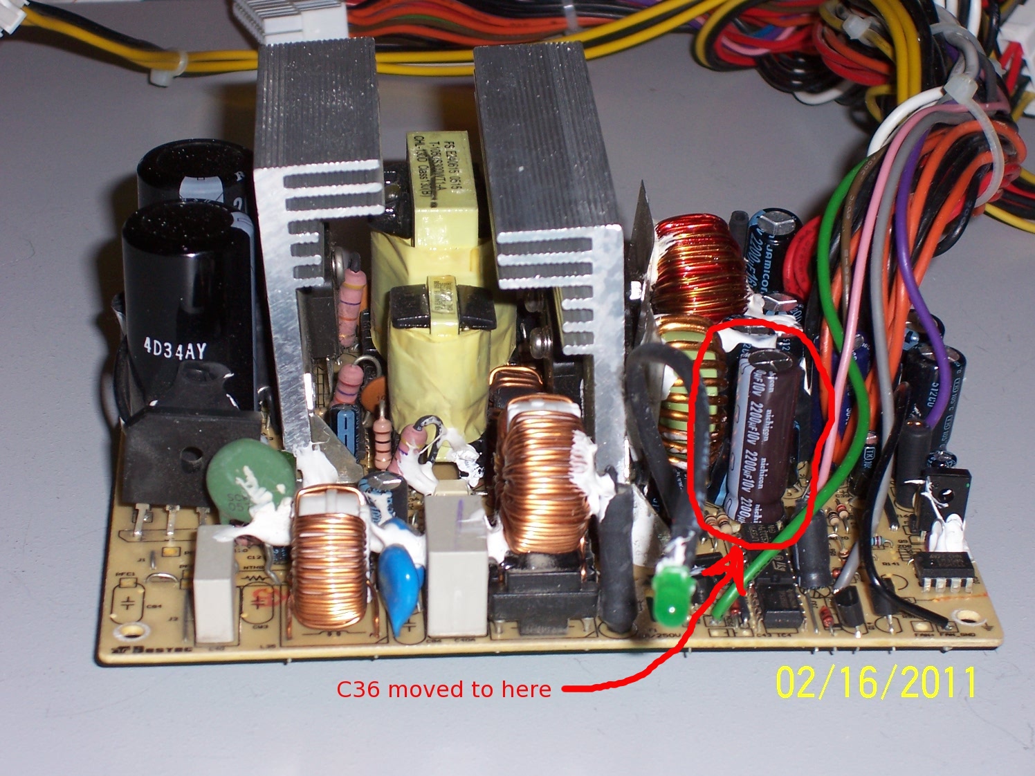

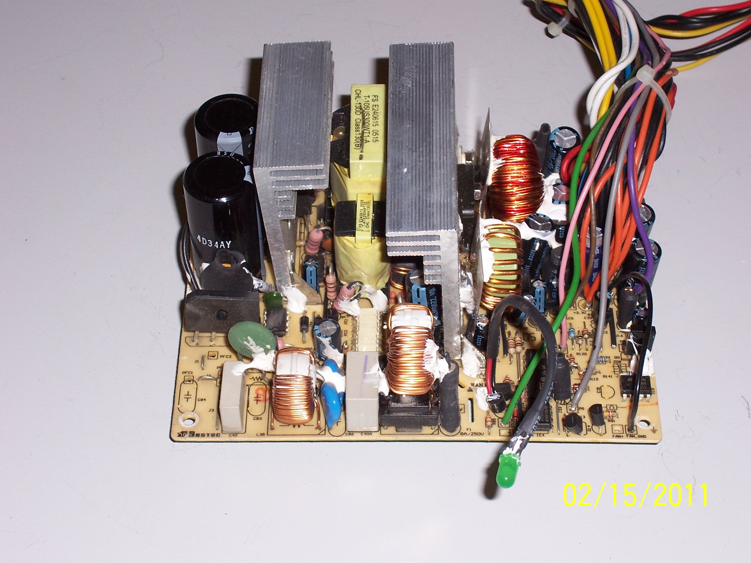

Bestec....the next generation
  • everell
    replied
    Re: Bestec....the next generation
    On the down side, capacitor C36 was bulging on this power supply. C36 is in the same location as in most of the Bestec models. C36 is the input filter for a pi filter on the 5vsb line. Therefore with time it gives the same 5vsb problems as earlier models. My solution is simple. Move C36. First remove capacitor C36 from its present location. Drill two new holes on the other side of the heat sink. See photo showing new location. Then solder a new capacitor in the new location for C36.
    Leave a comment:
  • everell
    started a topic Bestec....the next generation
    Bestec....the next generation
    To begin, this is the Bestec ATX-300-12EB3. In general appearance it looks much like the Bestec ATX-250 12Z, but is oriented toward the 12 volt processors. It has two 12 volt outputs each rated for 18 amps, and a 5 volt output rated for 25 amps. It uses the same 5vsb chip as the 12Z, the A6351 chip, therefore preventing the 5vsb overvoltage problem in the early 12E model. It also has four optoisolators, one of which is the crowbar circuit for added protection. When something causes the power supply to shut down, the crowbar circuit prevents you from turning the computer off then back on. You have to unplug it from the wall to release the crowbar. This prevents people from thinking the problem went away by using a simple restart.
    From the pictures you can see two shunts used for the two 12 volt overcurrent protection circuits. Something new added since the 12Z.
  • прямо
    Viper22A 5VSB circuit
    by прямо
    So I have a cheap non working ATX PSU that I was learning to repair a decade ago. At the time, it blew the main fuse, bridger rectifier, NTC, and primary 9A 900V MOSFET. Replaced all except the MOSFET. 5VSB came back online. Then I poked around in it so much, measuring components one by one to a point I accidentally made the 5VSB circuit primary side went bang. Blown the AP8022 (Viper22A) PWM chip, along with a low resistance resistor and the PC817 opto isolator. I replaced them all.
    In the process of poking around, I also lost a zener diode that stabilize the voltage coming from...
    01-13-2024, 07:05 PM
  • kotel studios
    FSP300-60GTF - no 5VSB, PS_ON; 5VSB carnage
    by kotel studios
    Finally replaced all of the shorted 4148's and resistors and an blown tl431 on my FSP300-60GTF after 5VSB going crazy and destroying it self. Those components also made the secondary transistors appear shorted (while in reality they weren't).
    Powered it on through my dim bulb tester and they (bulbs) only flash once meaning primary caps are getting charged, but that's it. No 5VSB, PS_ON voltages.
    I am sure I have replaced the components correctly and that there weren't any shorted/blown traces left.
    Any ideas where to go next?
    02-23-2025, 11:47 AM
  • gabri2211
    external hd Seagate, broken down the +12 volt and USB 3.0 SATA board
    by gabri2211
    Hi to all 😎
    I'm looking for any useful information to repair this interface (I have attached the image).
    On this board I read E3215-1215A_4D.
    This is the small plate inside the HD enclosure that allows to connect a 12 volt power supply, interface the disk with a USB 3.0 socket and is connected to the HD with the SATA connector.
    If any of you have found a burnt or short-circuited component in a circuit like mine​, if you have useful diagrams for the repair, or even better a description for the tests at the test points, I would be very grateful.
    in particular...
    11-12-2024, 08:08 PM
  • mrcliem
    CM V700 no +5vsb, ICE2QR4765 low VCC in... Need guidance please...
    by mrcliem
    Hello...
    I got my self a dead CM V700 PSU, with nothing on +5vsb
    I have tried to fix it for the past 2 week, and I'm stuck... so i guess i post it here to get some pointer before i scrap it..
    As you can see in photo, the psu still pretty clean, no visible damage or bulging cap.. when i got it, it still has CM seal on it
    The +5vsb system use ICE2QR4765, I have trace and measure the voltage on ICE2QR4765 and the only voltage reading i got is in VCC 4.8v, Drain 310v and FB 3v.
    I have read the datasheet and and still can not...
    06-29-2023, 08:18 AM
    Using a 5 volt @ 12 amp switching power supply and two USB doctor volt / amp meter to three IPads on one power supply
    by sam_sam_sam
    I have been wanting to do this project for some time using a Mean-well switching power supply that I bought at least ten of them that were originally in a device that was abandoned for some reason they were listed new but removed from equipment that was never used
    I do not understand Mean-well the capacitor next to the voltage reference ic chip was a brand that is known for failure over time the other capacitors are brand name needless to say it got replaced before I even powered it on for the first time
    I used a four USB outlet and electrical plate that is made for...
    08-03-2024, 07:54 PM
