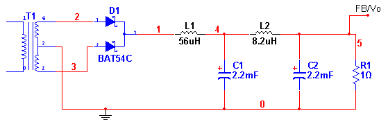

      Re: Young Year ATX-50A - poor 12v regulation
      Like this? Ignore the inductor values, they were just defaults in this quick diagram.
        Yup, it was exactly like that. I found a place to fit the extra capacitor too.

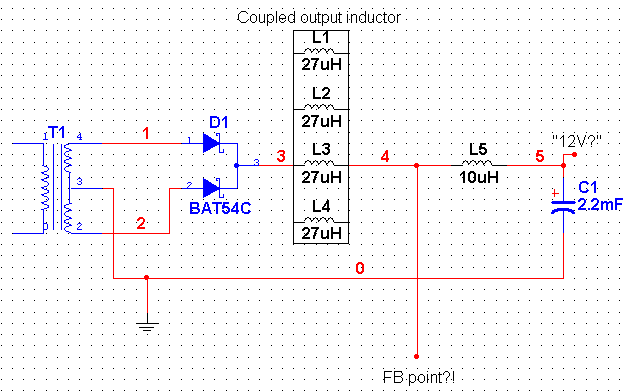

          A lot of PSUs don't have full pi filters. Especially older ones.
          Moving the FB point to the other side of L5 [in kaboom's drawing] would be enough I think.
          [That and put in some real caps.]
            I know, but in this case the pi filter coil was basically doing nothing except dropping voltage.
            If i were to not install a proper pi filter that would be the case. However what i did is moved the existing cap (well, moved the trace) to before the pi filter coil, so the feedback point was left where it was and now gets the correct signal. Then i added an extra cap to form a full pi filter. I just used a Su'scon i got from another of those junkers, looks good, tests good, works good.

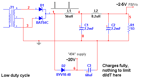

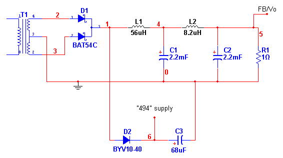

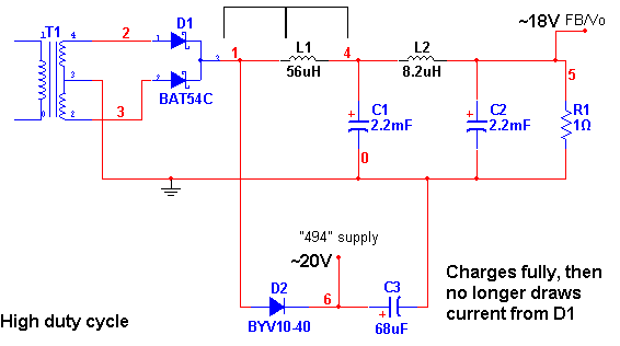

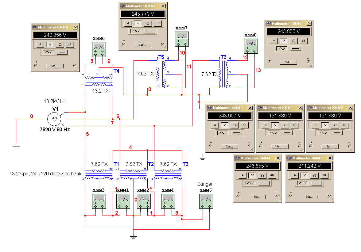

                          I'll start with a single output example.
                          L1 is the output inductor, L2 is the PI choke.
                          The output inductor limits the reflected dI/dT reflected back to the primary. More importantly, it integrates the constant amplitude, variable pulse-width from the rectifier. A nice easy way to have the 'main' output regulated and adjustable while having an 'aux' supply of fixed voltage. "494" supply in this case.
                          Those "fridges" that use a Peltier junction use this trick. When there is no demand for cooling, duty cycle is way down. The LED inside is also fed from the 494 supply, before the output inductor. About 22V here, regardless of where the main output sits. That all works out. Even though the pulse width is narrow at this point, the amplitude is as high as at full output. So it IS possible to have two different voltages.
                          So the 494 supply point's voltage is determined only by the input voltage and transformer ratio. It's the duty cycle that make it possible for the output voltage to be less.
                          A typical AT supply, with the '494 powered as in the diagram, will have the 494-supply sitting between 20 and 28V. Then how is it possible for a 12V output to exist? Our hero, the output inductor makes it possible! By integrating the duty cycle. And it saves the primary switches, as the cap-charging-current when C1 recharges doesn't happen in only a few degrees, thanks again to L1.

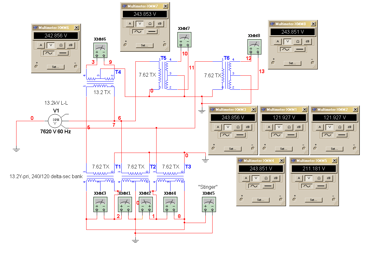

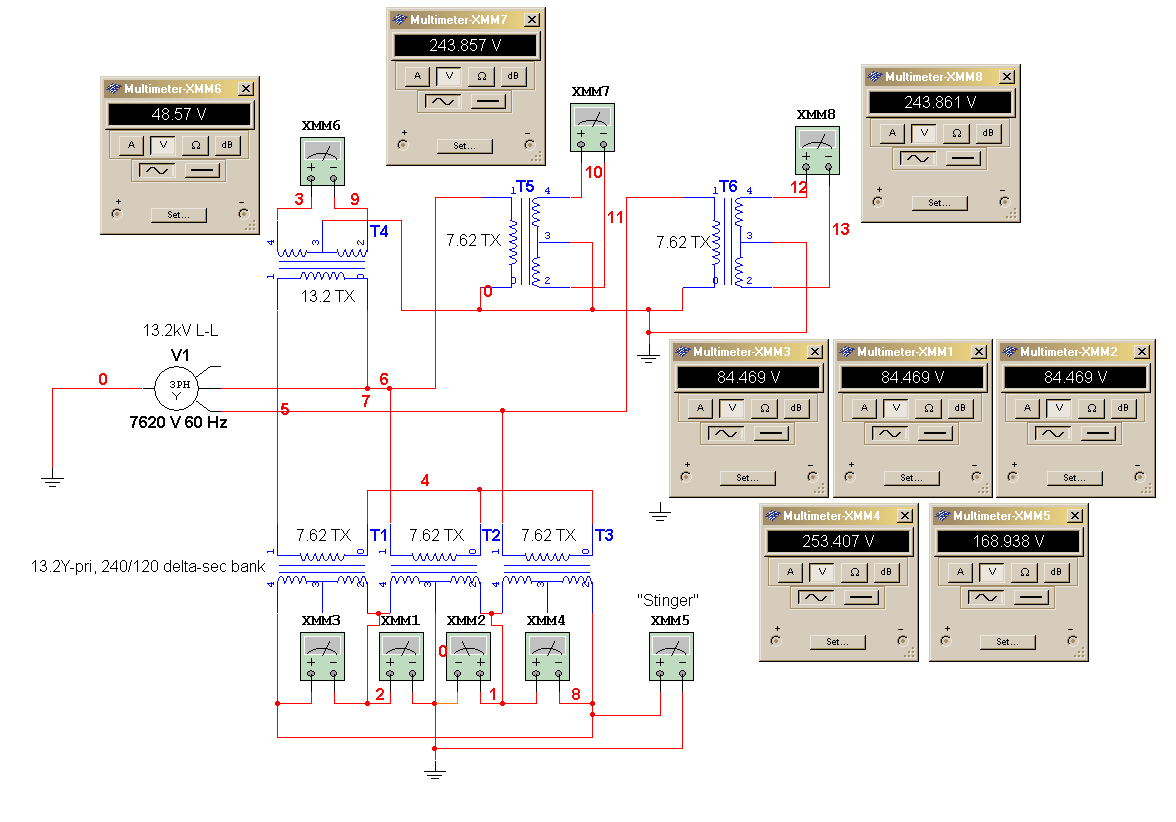

                          Bonez, the reason those output inductors are coupled in a computer PS has to do with cross regulation. It helps 'equalize' the current and balance voltages when the rails have different loads. Having individual output inductors would waste space and the balancing would not happen, as individual toroids would not be coupled.
                          It's really bad news if there are ever shorted turns in those coupled inductors. Think of shorted turns in an autotransformer, or better yet, closing the 'bypass' cutout across a pole-mounted voltage regulator before setting it to 'neutral.' The number of turns on that output inductor varies by the ratio of the different output voltages. So if the 5V output has 10 turns, the 12V output must have 24 turns! Otherwise, the transformer action of the inductor, at this point, will try to 'force' the voltages up or down. In other words, if the 12V winding had 30 turns and the 5V winding had 8, the output inductor itself would try to buck the 5V output down to 3.2! There are pulses here and some coupling occurs, even with the DC bias. And it would get much hotter as well. Even more if there are shorted turns.
                          Have a look at my "15 houses and a supermarket" distribution network. In the first, all is well and normal. Then, we lose a source phase. In the third, the neutral point of the bank with the delta secondary has been grounded. While the line voltages now 'appear' normal, the poor delta bank is smoking and shaking away, vainly 'refeeding' the lines. Hence the 'fourth cutout' on these dinosaurs, if/when any are even built anymore. A relic from the past, with 480Y/277 and 208Y/120 services ubiquitous now.
                          Not too different, in principal at least, from the coupled output inductor with the incorrect ratios- from shorted turns or bad design.
                          Hope the diagrams help,
                          -Paul

                            a field change in one of the windings forces the currents in all other windings to change as well. So when 5v is loaded, 12v will track it, and vice versa
                            Now, with the advent of small, efficient DC-DC converters group regulation has started to become less common, but it's still found in all older power supplies.
                            You got it! I hear ya on the DC-DC converters. Those huge power supplies are primarily 12V output units, capable of 30-70A total. Some of that capacity is used directly for the 12V output, through one or more current sense shunts. The buck converters for 3.3 and 5 get 12V in from the main supply.
                            -Paul

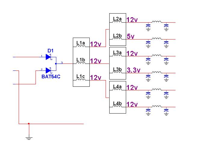

                                  This is what makes building a split output SMPS way easier than i thought - same transformer winding and coupled inductor. If one rail is loaded, the other goes down with it - since they come from the same place, duh.
                                  @ PCBONEZ: I think that's Multisim. I'm more partial to LTSpice.
                                      Don't laugh too hard okay...
                                      Has anyone ever tried something like this?
                                      [Yeah I didn't finish but there's enough to see what I'm asking.]
