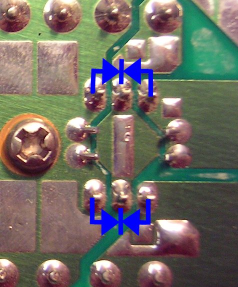

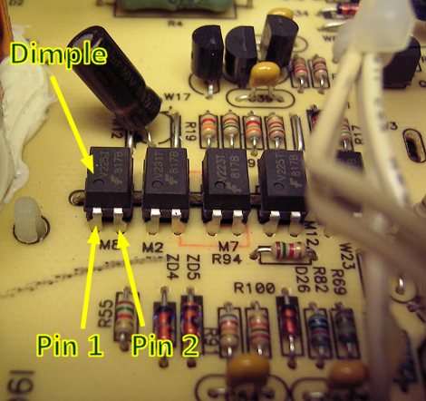

          >>Soldering to Pin2 would be next to the square solder pad. (?)<<
          Pin 1 on *most* IC's and such devices is *usually* indicated by a square solder pad.
          It is also *usually* indicated by a dot or dimple on the device itself.
          (see pic 1)
          Pin 2 of M8 is the round pad next to Pin 1 (the square pad on M8). You just tested it yesterday. (see pic 2)

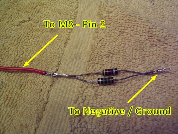

          The 2.4v on DB pin 5 has me concerned as it may not be low enough to fully turn on the opto. The 1.5v is the IC trying to start up and check the voltages.
          I need you to solder the 2 resistors in that package together in parallel. (see pic 3)
          This makes the resistance 1/2 of 1kΩ or 500Ω. That should provide a low enough resistance path to enable the opto fully.
          Rerun the prior test and repost the voltages.

            Re: Suspect Bad PS Apple AcBel API 1PC36
            Pin 5 jumpered ... 1.0v - 1.6v
            unjumpered .... 5.56v

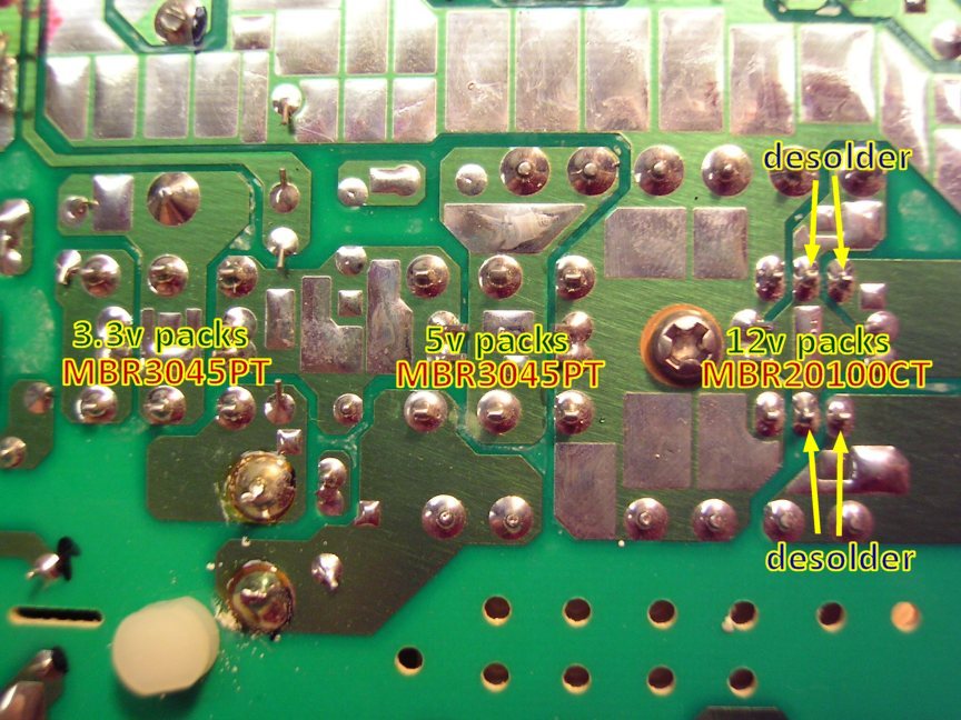

                                Did you ever get the solder-wick? The next test will require unsoldering some leads so the items can be tested "out of circuit", but not off the board.
                                I suspect one of the 12v dual-Schottky diode packs to be leaky.
                                    Here we go. See the pics as to what these devices are and where to unsolder two legs of each. Wiggle the leads around slightly to make sure you don't have contact to the foil traces. You can use the continuity test on the meter to be sure.
                                    Then test them as individual diodes (4).
                                    They should all give the same readings.
                                    The odd ball will likely be the bad one.
                                      Took me a bit to figure out the testing but think I got it. The picture shows the 12vShottky and hoping my diagraming isn't too hard to follow.
                                      I number the connections 1, 2, 3 across the 'top' and 4, 5, 6 across the 'bottom' as viewed from the pictures
                                      Tested 1 to 2 and 4 to 5, both read 159
                                      Tested 1 to 3 and 4 to 6, both read 0
                                        Seems like the 0 readings indicate you still have contact with the foil.
                                        Should have 8 readings. 4 diodes X 2 readings for each.
                                        Start with black on center pins (cathode) and red (anode) on outer. Then reverse the leads to red on center and black on outer.
                                        The desoldered pins should be "loose" in the hole and you should just be touching the pin(s) with the probe on those. Push them a bit to see if they wiggle and the reading changes.

                                          Actually, unsolder the remaining two pins. If everything is good, the first 4 readings should match and the second 4 should read infinite (open).
                                          0 = zero ohms, as if the meter leads are touched together
                                          Infinite would be as if the leads were not touched together. The meter should not register anything.
