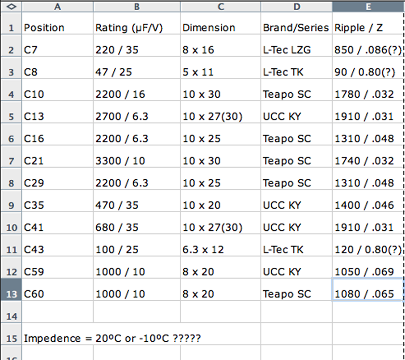

      Well you're a champ Toasty .... thank you! Some fish giving going on on one hand but feel like I'm working for it on the other.
      Seems an answer always produces questions. I've 'finished' as best I can. The L-Tec data sheets confused me, they're laid out differently than the Teapo and UCC data sheets. So I'm not real confident of the values I came up with for the L-Tec's.
      Then, when I was getting the UCC caps done I noticed the different values depending on a temperature/impedance value. I believe all my values came from the 20ÂșC column - so either they're all wrong or 'mostly' right.
      Thank you for the series correction on C43.

        So if my ripple and Z values are correct, then do I match those values when shopping for replacements? (Still am concerned w the L-Tec ripple and Z numbers)
        Which brands are most respected?
        I've seen here (in a mobo thread) that using a replacement with a higher V rating can be ok, is it true for PS's?
        I've also read that larger diameter caps are ok as long as there is room physically??

          All that info is in here.......
          Z = impedance = ESR as I said before (post 19).
          Equal or better with ESR and Ripple.
          ESR - lower is better: 0.02mΩ is better than 0.04mΩ
          Ripple - higher is better: 1500mA is better than 1200mA
          Voltage - one "step" up is considered acceptable: 2.5v->4v->6.3v->10v->16v->25v->35v->50v->63v

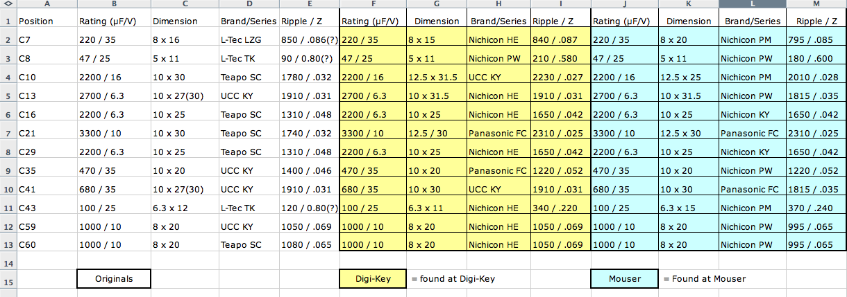

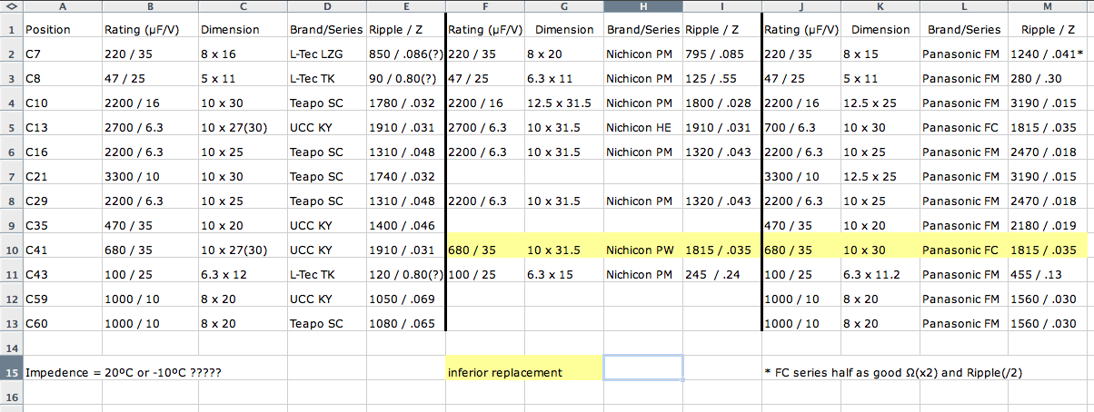

            Before I do any ordering ... wonder if you'd take a quick look at my selections. You didn't list the Panasonic FM series but it was listed elsewhere in the forum ... thinking there could be a reason you didn't list it.
            I see that C21 is hard to come by in a 10mm and agree a 12.5 could be 'wedged' in. Also, C10 is drawn on the board much bigger than 10mm - any reason to upsize it?
            Thanks for all your help & (patience)!!!
            EDIT: From my spreadsheet it looks like I may as well order all Panasonic if I can.

              Re: Suspect Bad PS Apple AcBel API 1PC36
              FM's are okay, but you run the risk of overkill on a PSU when it comes to ESR. Ripple handling IMO can never be too much, but too low an ESR can toss the balance off on the filtering as designed.
              School's still out on that, and I've not had a bad experience with that either. But, there is caution in the rumblings about the forums regarding others who ran into a higher ripple when using "ultra-grade" caps.
              That's why I did not give the FM's as a choice. FC is lower than the HE in one line, and equal to the PW in the other (you'll notice that they closely follow each other in the sheets {makes one wonder... } ). In both cases, sticking with the KY originals is likely a better choice.

                Also, very nice job on the charting and cap worksheet. Good to see you're getting the hang of it.

                    #29
                    C10 is okay at 12.5mm.
                    C21 - you'll need to "adjust" the coil next to it to get a good fit.
                    C8 - 47/25 - KZE ; Specs on DK don't match your sheet for PW {180/600} looks like it was HE.
                    KZE is 250/300 and 2Âą cheaper
                    C35 - 470/35 - KZE and 12Âą cheaper --> FC is below original spec
                    C21 - 3300/10 - KZE too ...and it's 20Âą cheaper ...sensing a pattern yet ?
