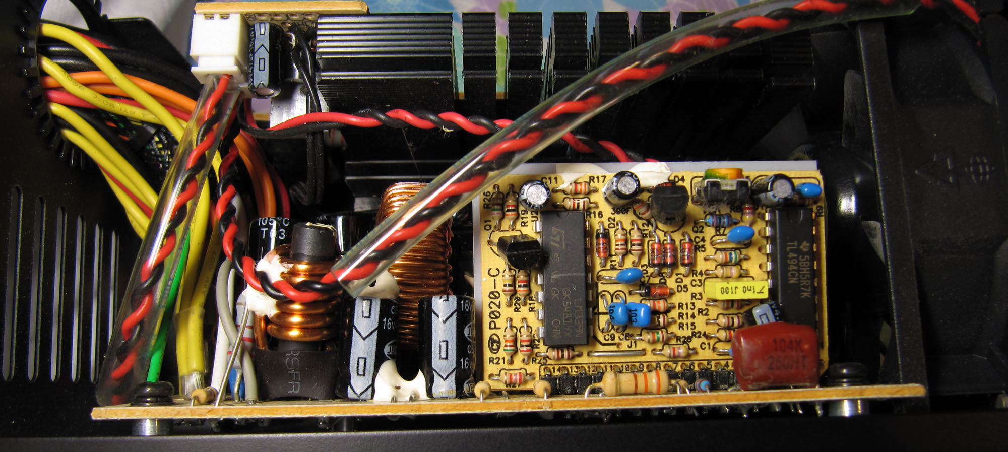

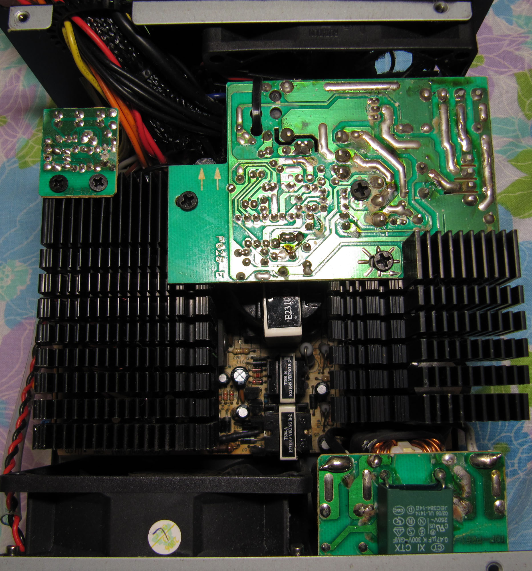

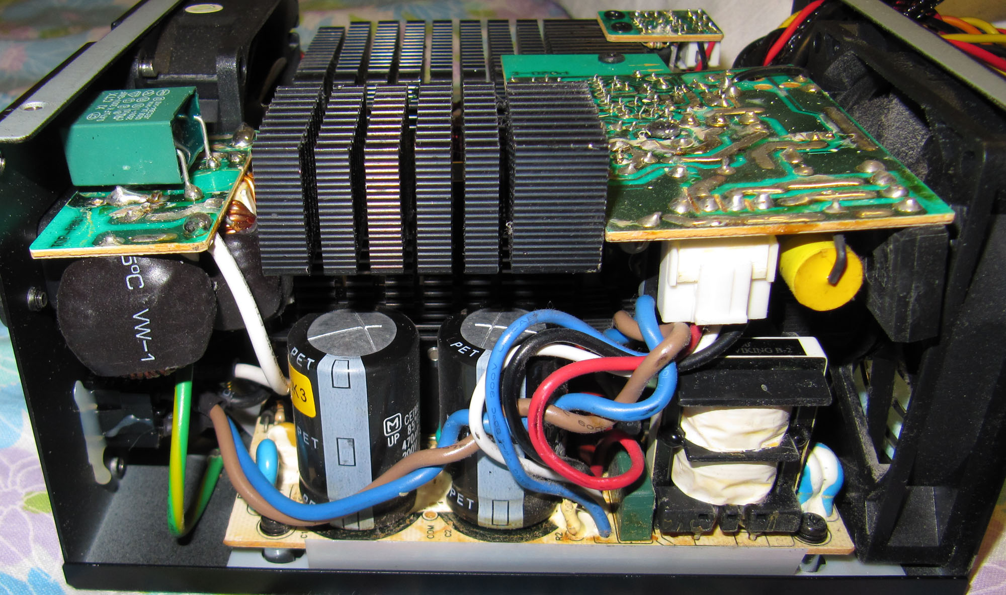

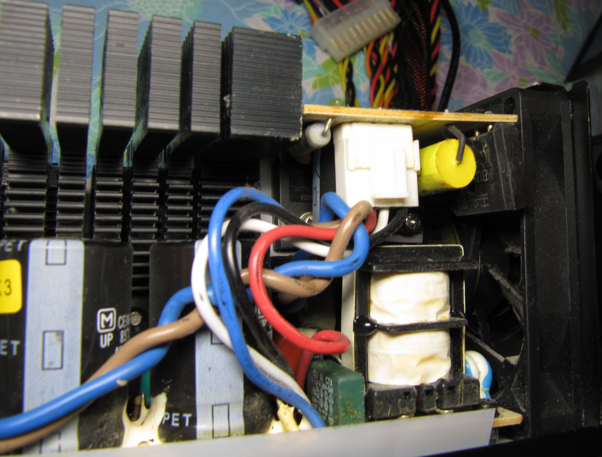

    A girl said her computer did not power up any more. It turned out to be the psu, so I got it.
    It's a Tagan TG330-U01.
    No 5vsb, full of bulging caps...
    What do you think?

    It's a topower all right. Hard to say. I would try to get it working again, but thats me.

      Looks like older design half bridge with 494 pwm chip for driver. Big heat sinks, in its favor. But heat sinks so big it looks like they might be impeding the air flow. If you have the time, it looks like an interesting project. How could you improve it? Can you trace the circuitry and provide us some diagrams. All kinds of possibilities. If I were going to fix it up, I think I would cut a hole in the back and add a second fan to push air in same direction as the other. Does it have the two transistor 5vsb circuit, or a pwm chip for the 5vsb circuit? It has components on top of the pc board, so probably does not have many surface mount components. That will make it easier to work on.

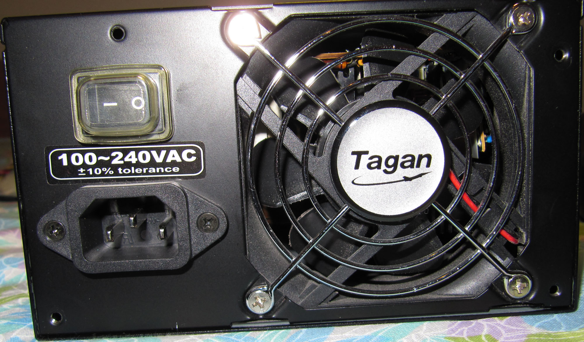

        It already has 2 fans. If you see the label of the psu they are advertising how silent it is, so I think that we have the reason it failed. Nearly every cap on it is Jenpo and nearly every cap on it is bulged!
        So, if I decide to engage with it I will recap and fanmod it so that it is staying less quiet but cooler.

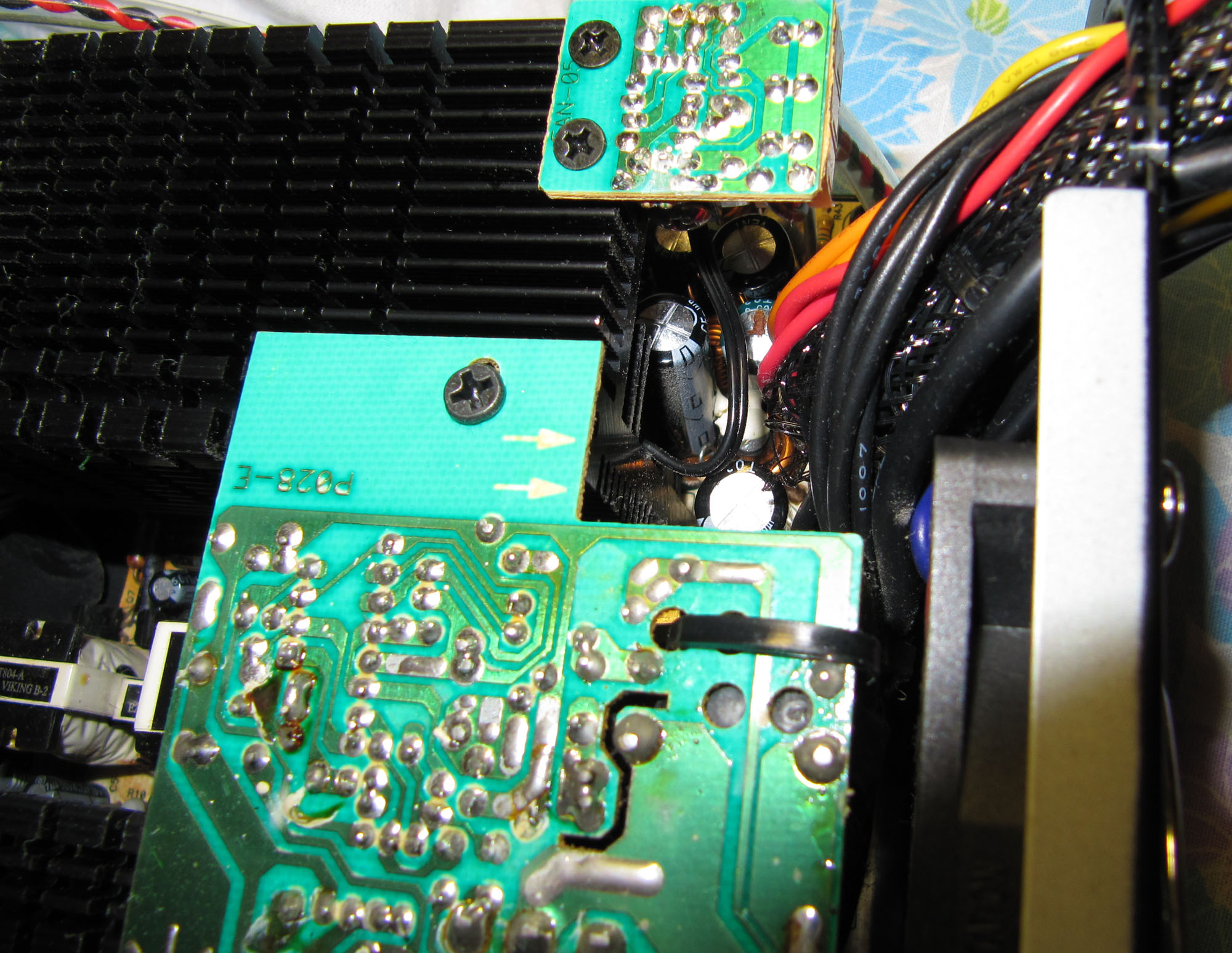

            Re: Tagan TG330-U01 Worth recapping?

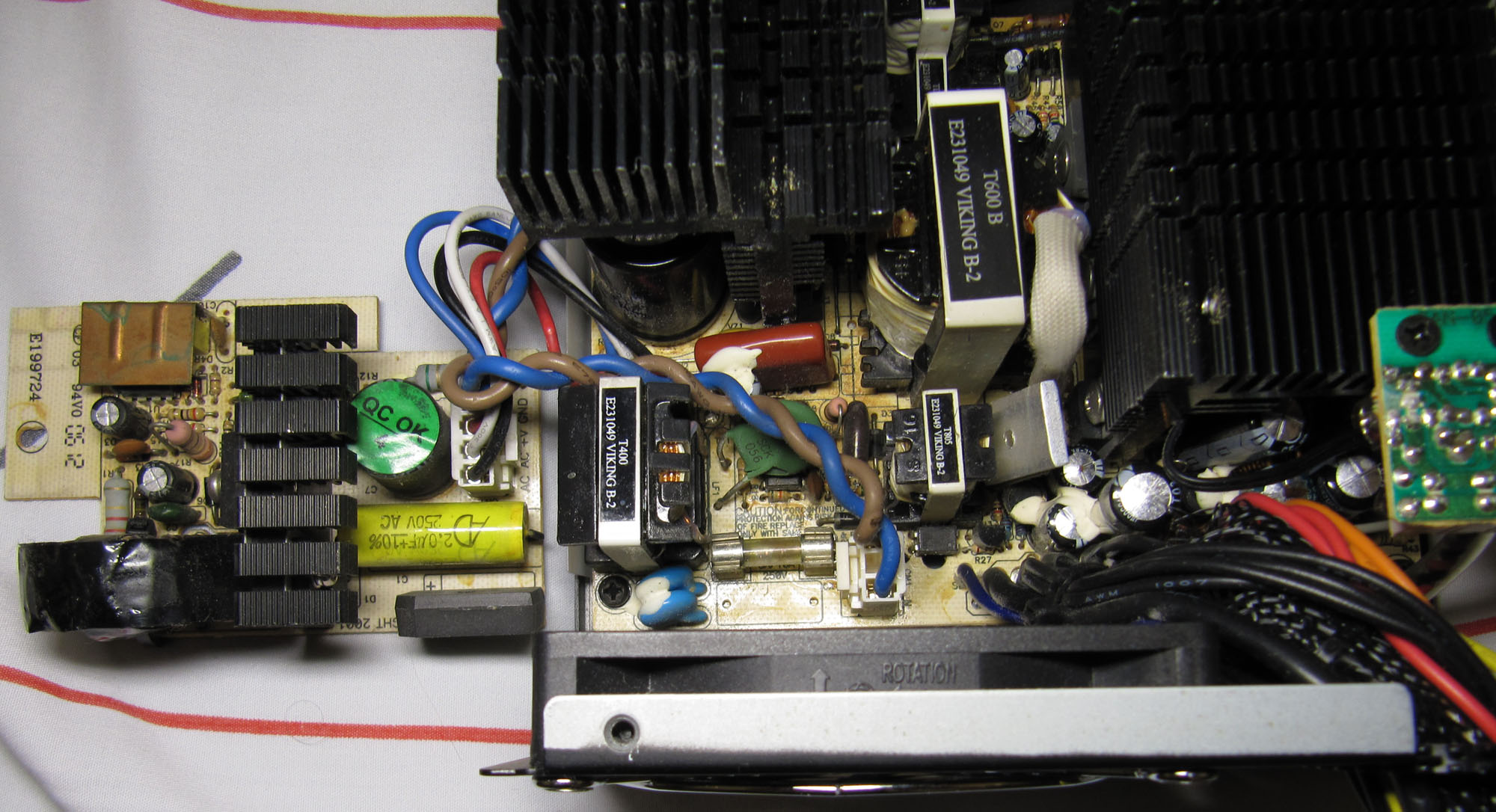

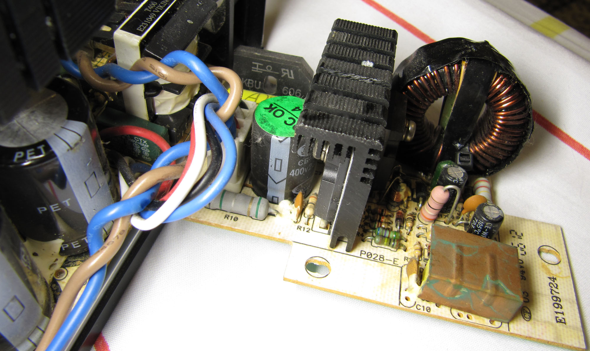

            The extra board seems to be Active PFC.
            Maybe the problem lies there.
              It's possible.
              Check if the primary high voltage caps are charging up (be careful!). If not, then you've found the problem, or part of it anyways.
              The PSU seems decent. I think it's worth recapping if you can get it working.

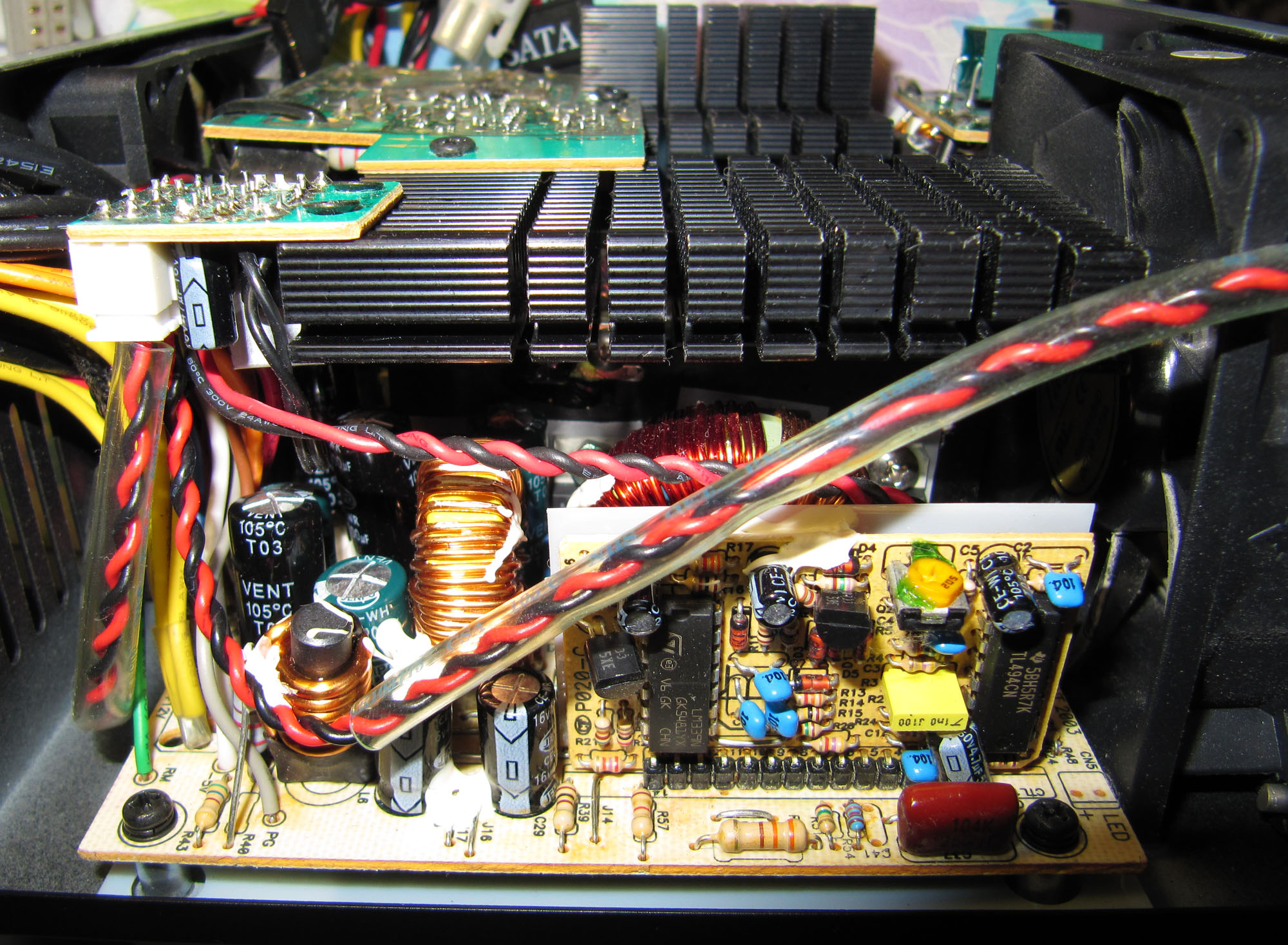

                Thank you for your answer momaka.

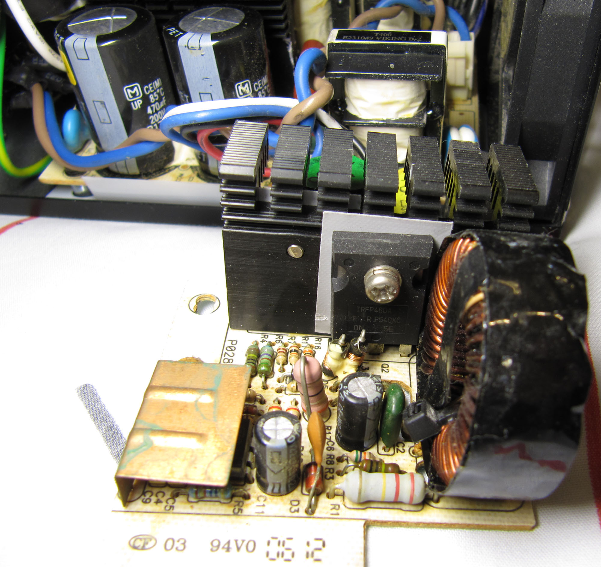

                PFC Board Part list:
                KBU608 bridge rectifier
                L6562N PFC Controller
                2x IRFP460A Power Mosfet
                UF1006CT 10A Rectifier
                There is also a Jenpo 400V 22uF cap that is completely dried. The esr meter showed 0uF and infinite esr.

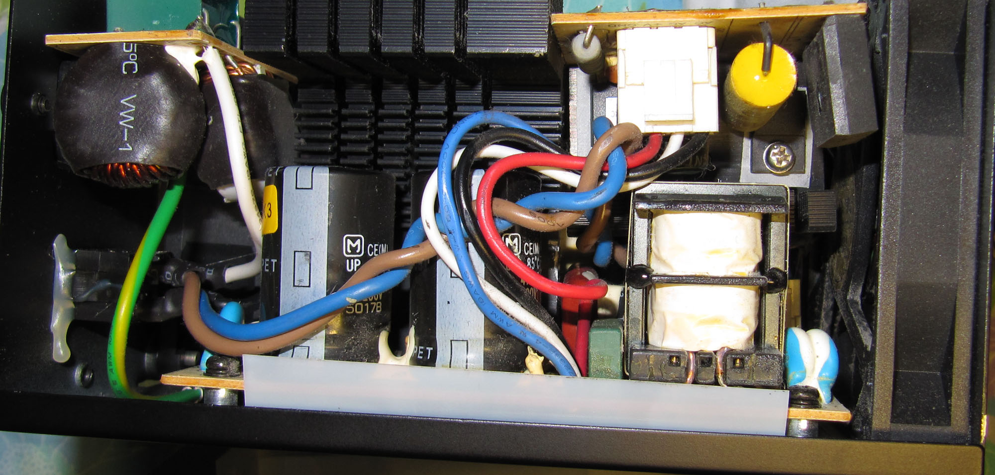

                The primary caps are 2x Panasonic 200V 470uF UP 85°C and are both dead!!! One of them shows 2.5uF...
                The fuse is blown and the NTC thermistor is missing a piece of it.
                It is definitely worth repairing. But I am afraid it will be a very difficult project..

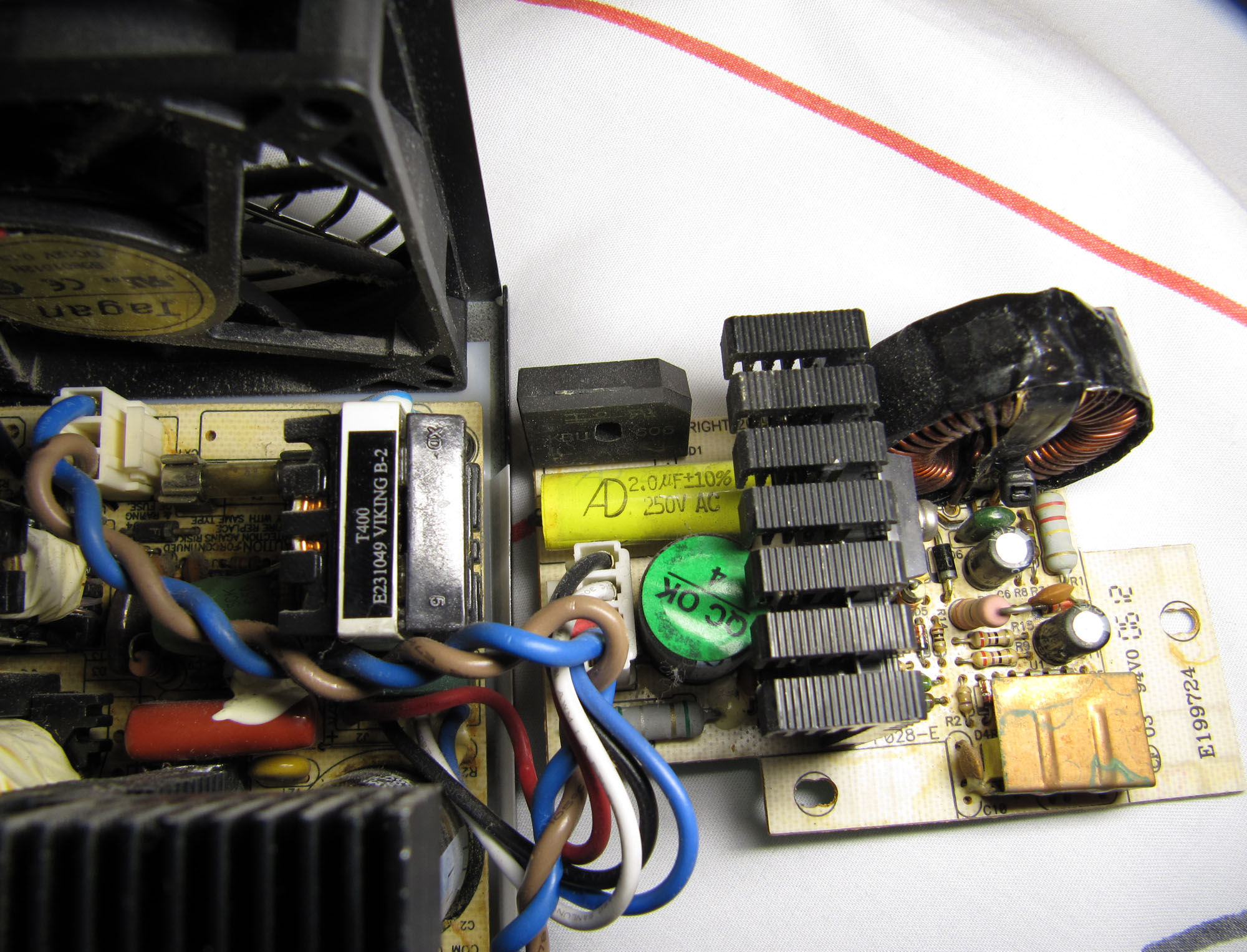

                  Not necessarily.
                  Before you even attempt the repair it, do this first: disconnect the PFC board and check resistance between the positive and negative of the primary capacitors on the main PSU board. If you get a short circuit, then this could indeed be a more difficult project. If not, test PFC diode and PFC transistors. If they test okay, put some new primary caps (preferably junk ones, in case PFC misbehaves), a fuse, and a thermistor, then try powering it again. Judging by the dead fuse, though, PFC is probably shot.
                  Personally I wouldn't even bother to troubleshoot the PFC board. If you ask me, just gut the PFC altogether and wire the PSU like a normal non-PFC PSU (i.e., same as cheap PSUs). Well you might have to keep the PFC board and rewire it since there is no spot for a bridge rectifier on the main PSU board (let me know if you need help with that). Actually, that would be pretty easy to do - all it needs is a few components removed and some jumper wire added here and there (now I sound like one of those cheap PSU manufacturers, don't I? ).

                    Blown fuse??? That is why your 5vsb is dead.
                    Need to put that ohmmeter on the two FETs. If one or both are shorted, you probably have a short in the booster coil. From your pictures, the coil looks like it has a burned area. Do you see any signs of burning on the coil, or is it just my imagination and the way I am looking at it?
                    If the coil is bad, the psu will continue to blow fuses and FETs in the APFC circuit until you do something about the coil. If you have a ring tester, it will tell you if the coil is shorted. If you have access to an inductance meter, the coil should read 500 uHy to 1000 uHy.

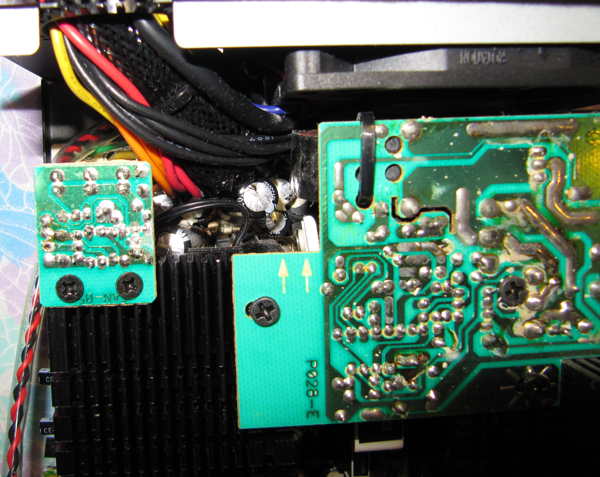

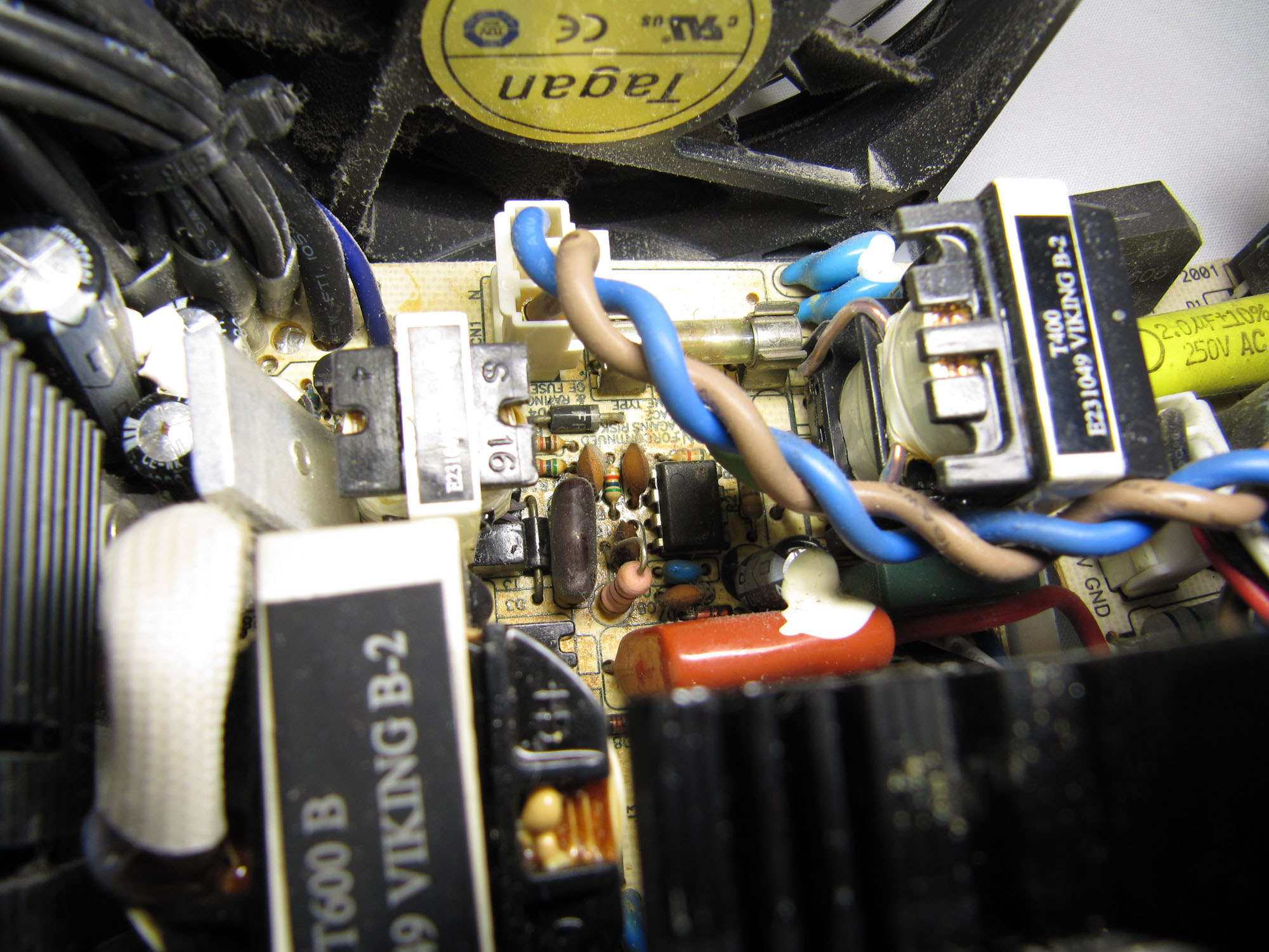

                      I don't have access to an inductance meter.
                      The good news: The pfc board is connected with 4 cables to the psu, where the bridge rectifier normally would be, so I can remove those cables and place a bridge rectifier there. This will help testing the psu.
                      Now the bad news: I do get a short from the main transistors of the power supply
                      They are 2x 2SC2625

                        It looks like it is a half bridge unit. Try replacing the primary caps, remove the pfc board, replace the primary switchers with some cheap 13007's or 13009's from a cheap psu and see if it fires up.

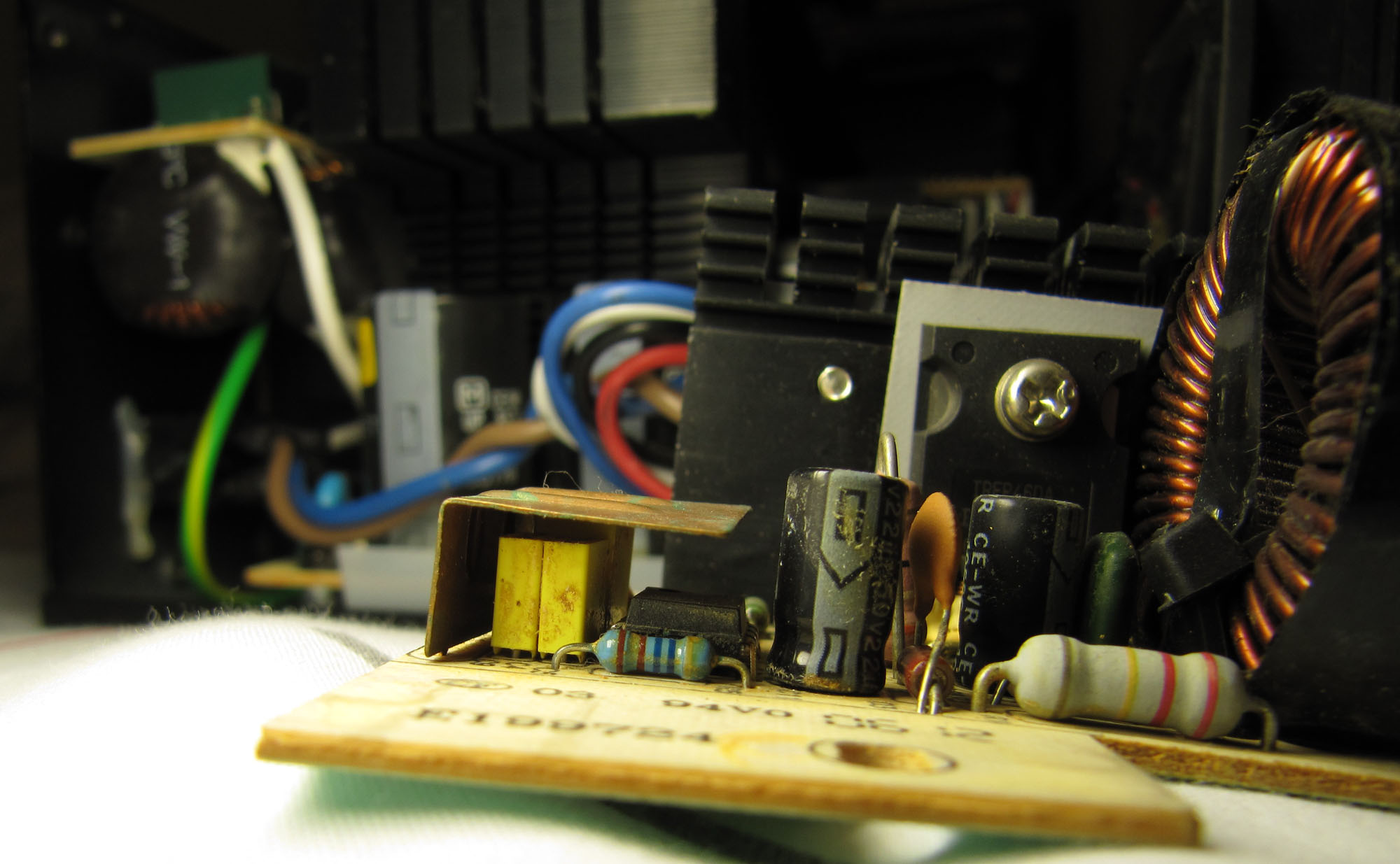

                                    Part list of main pcb:
                                    K2645 @5vsb
                                    TL3842 pwm controller for 5vsb
                                    2x 2SC2625 shorted
                                    AMC34063AM I don't know what this is for...maybe -5v or -12v?
                                    secondary:
                                    SB10100 @5vsb
                                    L7905CV @ -5v
                                    2X SBL3040PT @ 5V
                                    SB2040CT & P80NE03L-06 power mosfet @ 3.3V
                                    2X F12C20 @ 12V

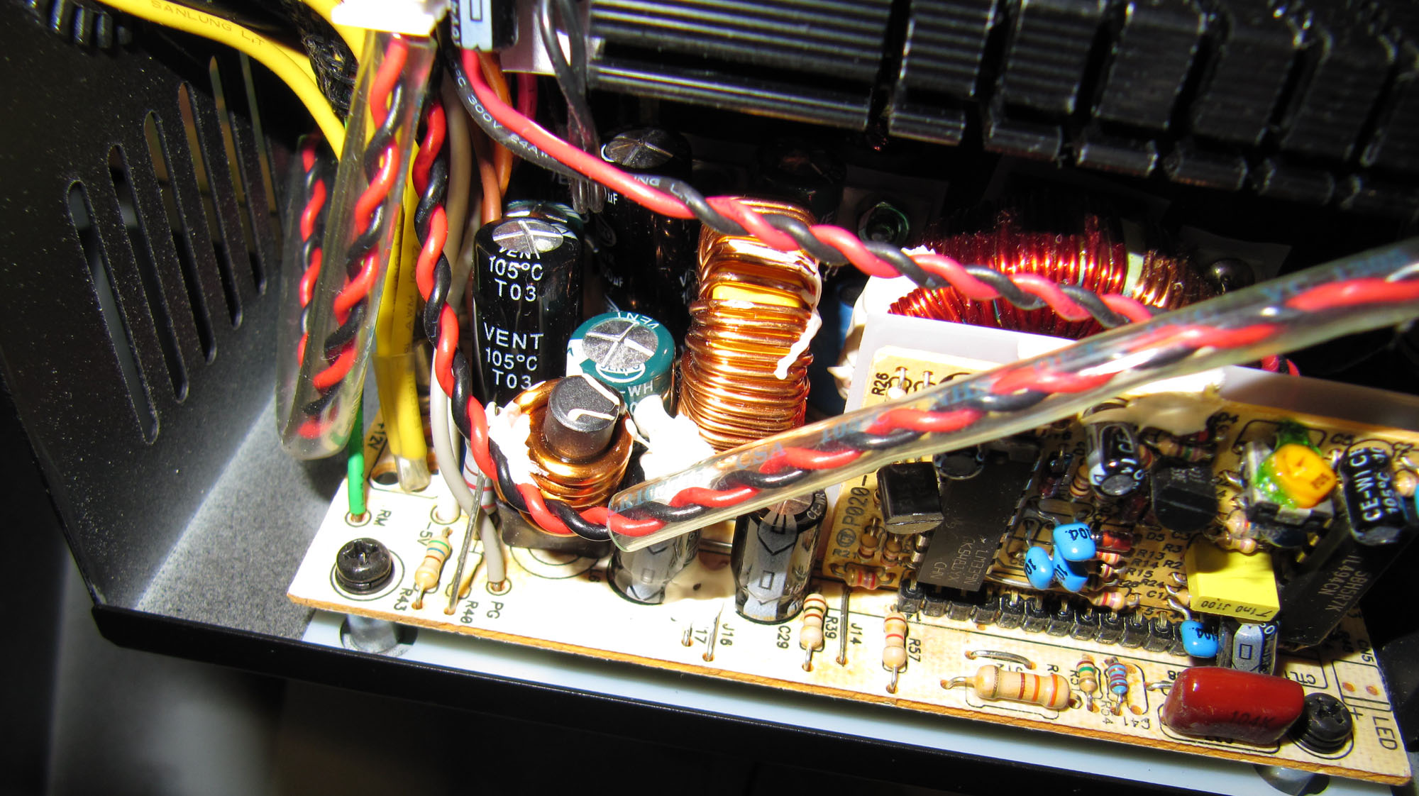

                                    daughterboard:
                                    TL494CN main pwm controller
                                    LM339N voltage comparator for OVP
                                    fan controller:
                                    UTC D882
                                    Something is very wrong with that power supply. I took out the Panasonic 200V 470uF UP 85°C caps and I tested them again with the ESR/Capacity meter. They are indeed completely dried up. What can I say? If a psu manages to kill Pannies, then maybe it gets too hot, or the active pfc raises the voltage too much.
                                    It's not easy to find replacement caps that fit in that psu. They should be 25mm diameter. And quite expensive of course..
                                    Another problem would be the shorted 2SC2625s, a common problem with that psu as they say: https://www.badcaps.net/forum/showth...2SC2625&page=2
                                    Even the small caps on that psu have failed.. It needs a full recap and this is possible only if heatsinks are removed...
                                    Because of all the above, and the Finnish Safety Authority report about that power supply I decided it's not worth fixing.
                                    Thank you all for your help anyway!
