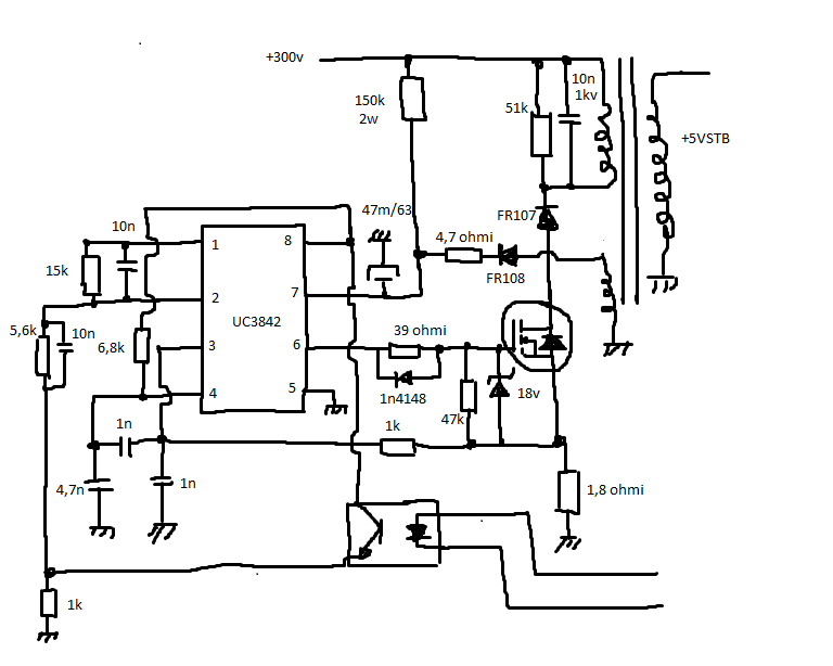

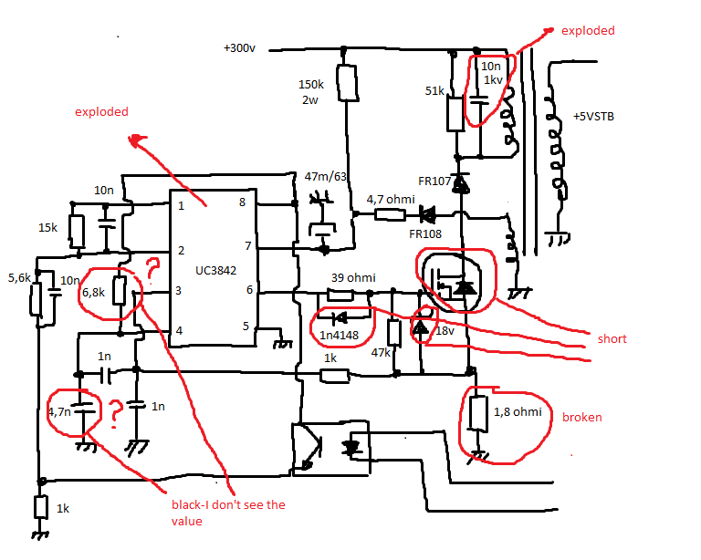

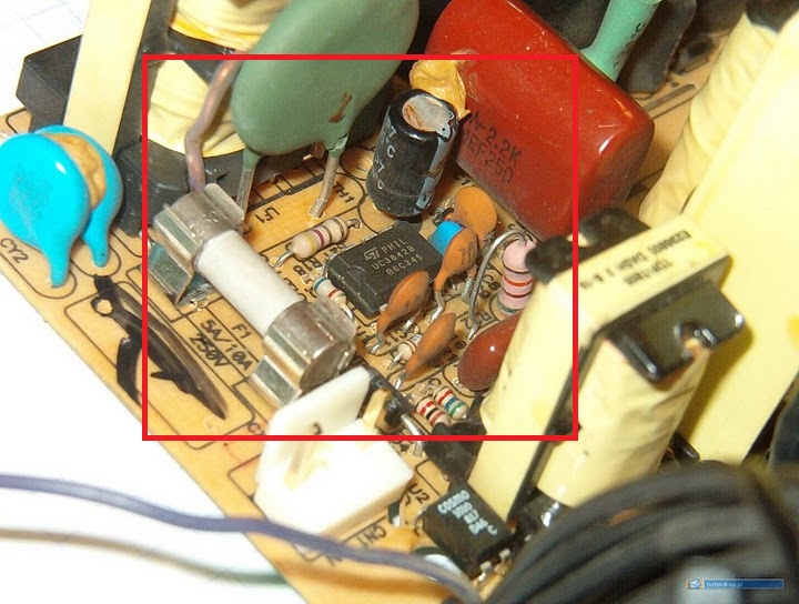

    I have BTQ P5-420W-S1.3.

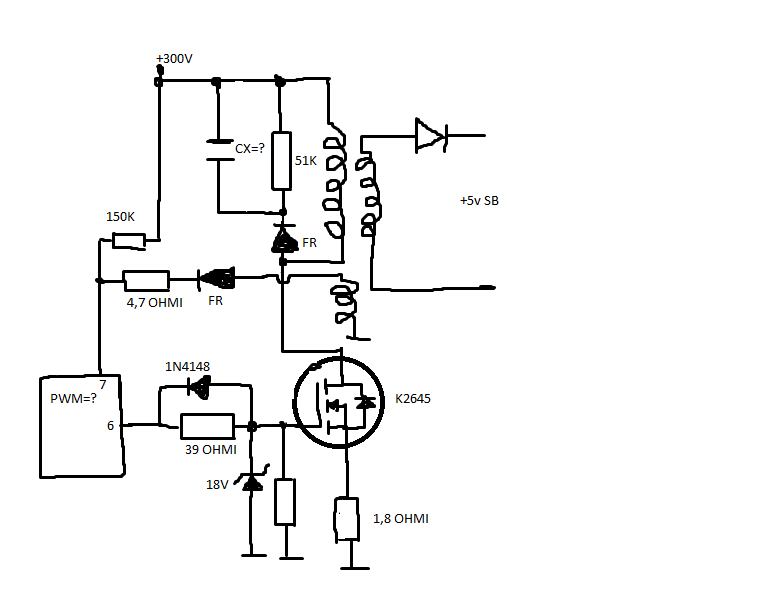

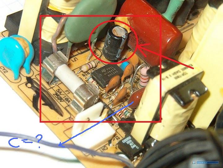

    PWM controller (8 pins) for +5vSB it"s exploded. What IC work?
    What is the value of CX (exploded)?.
    ps. Sorry for my bad english.

    Re: BE QUIET! BQT P5-420-S1.3 troubleshooting

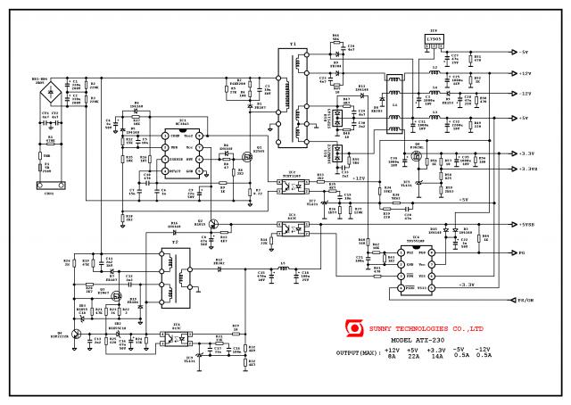

    I thought the circuit wasn't 5VSB part, that could be main switching part.
    the PWM chip might be UC3842/UC3843.
    see the reference circuit attached.
      With uc3842 or uc3843 or uc3844 +5vsb is not standing.
      Variable between 4v and 4,5v (pulsate).
        I mean, the PWM chip (might be UC384x) and the transistor in your circuit drawing in #1 post are parts of main switching, not 5VSB circuit.
        the 5VSB circuit wasn't use the PWM chip UC384x, it could be 2 transistors circuit.
        and your 5VSB problem seem to be badcaps symptom.
          No. 5VSB is witch ic pwm and n-mosfet.
          Power circuit is witch TL494 and 2 transistors.
          The caps it"s good.

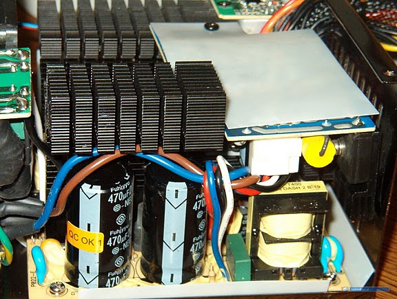

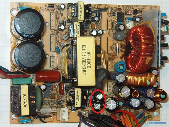

            may be your PSU is using Fuhjiyuu caps, like this one (images from google).
            Fuhjiyuu are known crap caps, check your PSU caps.

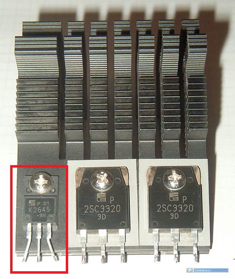

              Ok, I was wrong.
              the PWM is UC3842 with 2SK2645.

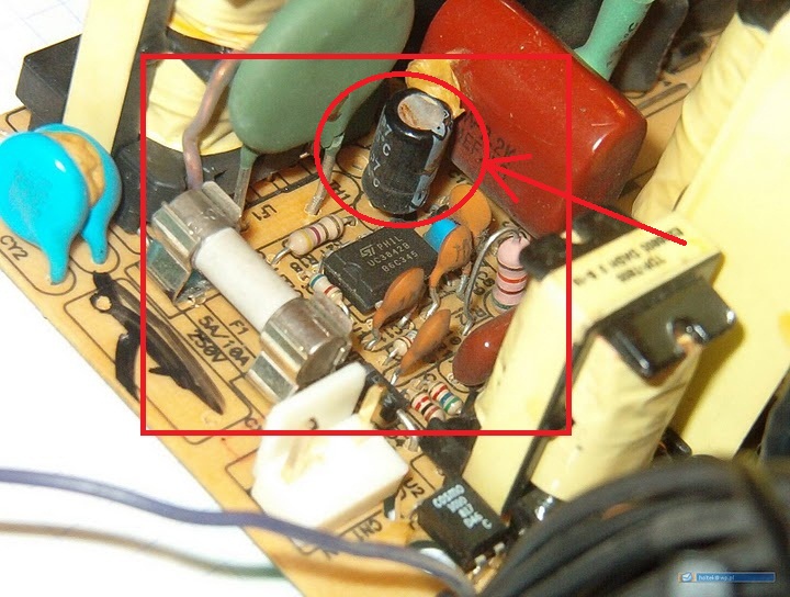

              Firstly, please try to change both 5VSB caps. I guess they're bad.

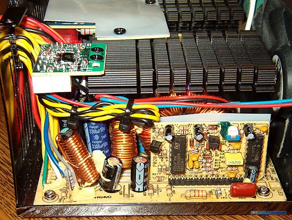

                and this one.
                  URAAA! That"s it!
                  I change the caps. And the value for cx?
                  • POM_MJ
                    • Aug 2009
                    • 228
                    CX is used in soft-clamp circuit, I guess it value is 0.01uF/1KV.
                          Don"t work.
                          POM-MJ, please, what is wrong?
                            I would check all components in the circuit, include TL431 on secondary side.
                            may be some resistors were burnt.
                            Did you have change 5VSB capacitors?
                            I thought the PWM exploded due to heavy work because of leakage capacitors on secondary side.
                            if you post details of your PSU pictures, would help much.
                              I change all capacitors, tl431, 1N4148, DZ18V, MOSFET,optocuplor and resistors (all,all).
                              Maybe the value(s) of component(s) isn"t correct(s). Were blacks.
                                your PSU is now "+5vsb is not standing ,variable between 4v and 4,5v (pulsate)", right?
                                Which component(s) were burnt into black?
                                  In this moment with the values of electrical diagram:
                                  U(v) pin 7 - 11-12v valiable
                                  U(v) +5vsb - 2v but the electric current through mosfet is too big.
                                  The frequency of uc3844 is 190khz.
                                    The 5vsb transformer could be burnt (wires short).
                                    try to replace with a known good one for test.
                                        Are you replace PWM chip with UC3844 ?
                                        I thought it's caused the problem.
                                        UC3844 has 50% duty cycle max., UC3842 has 100% duty cycle max.
