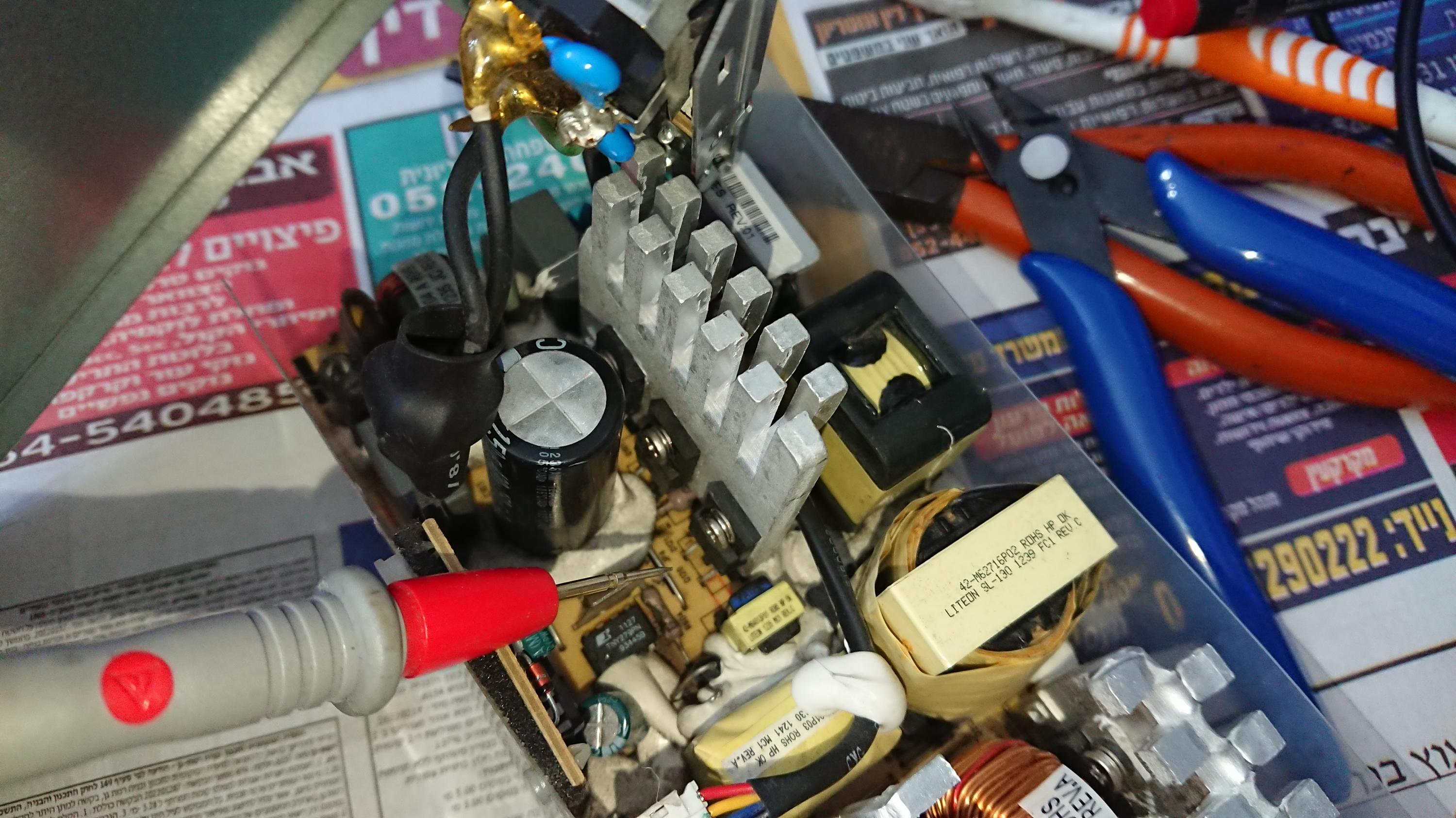

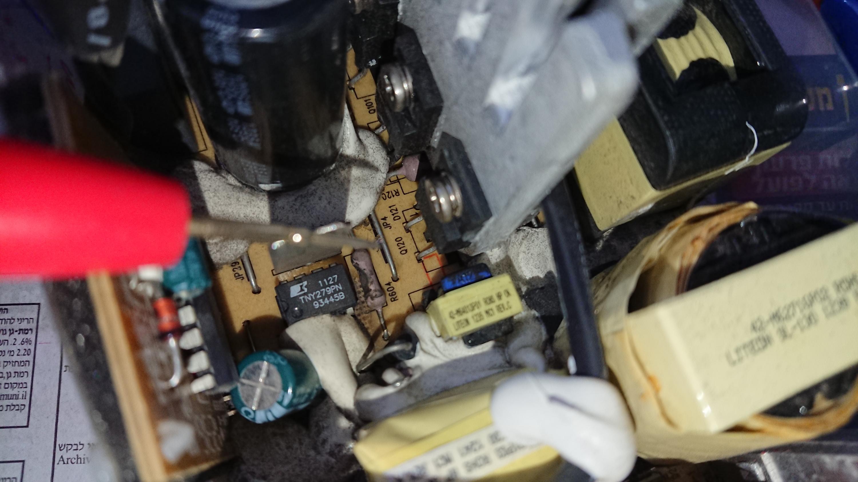

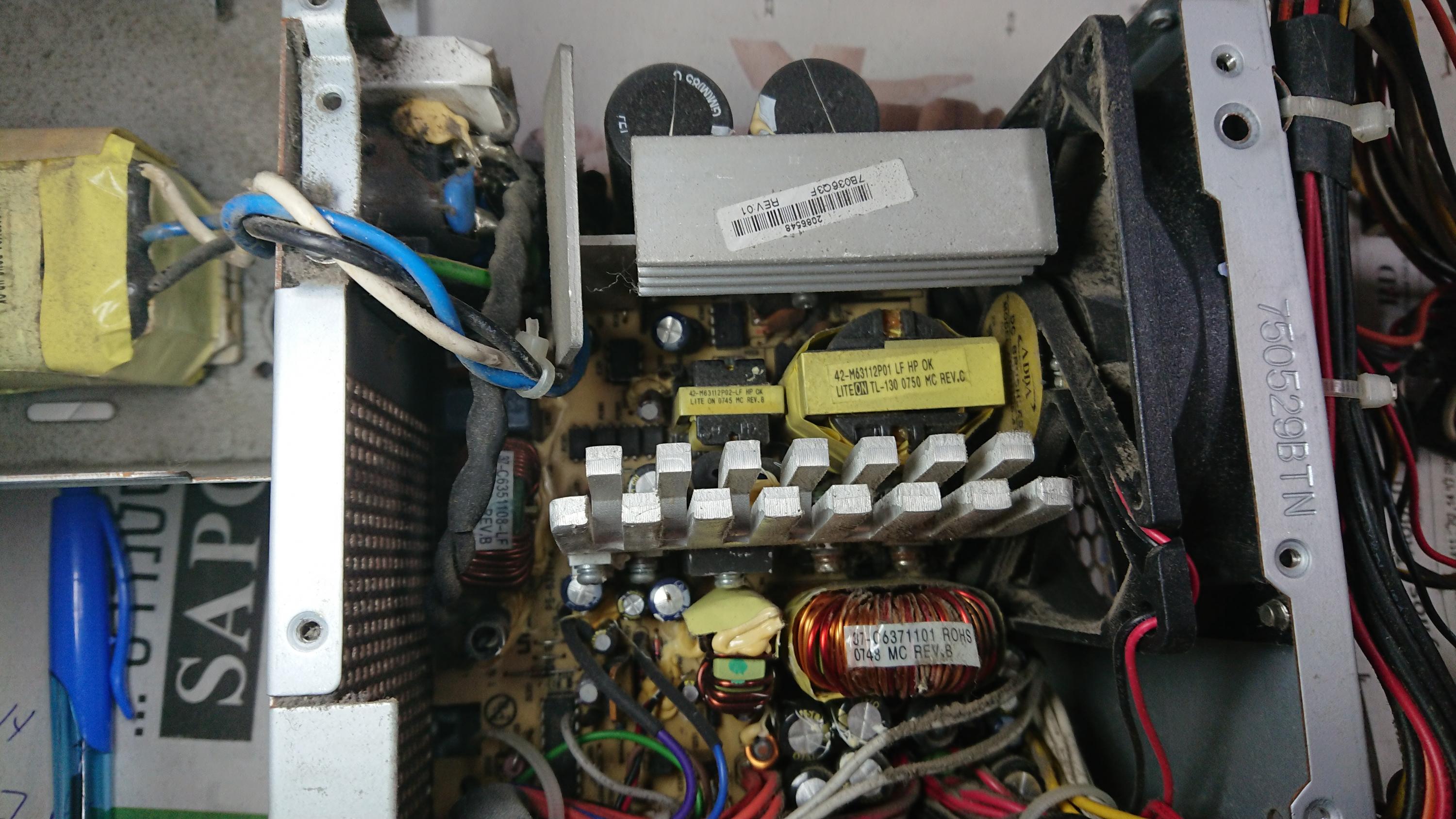

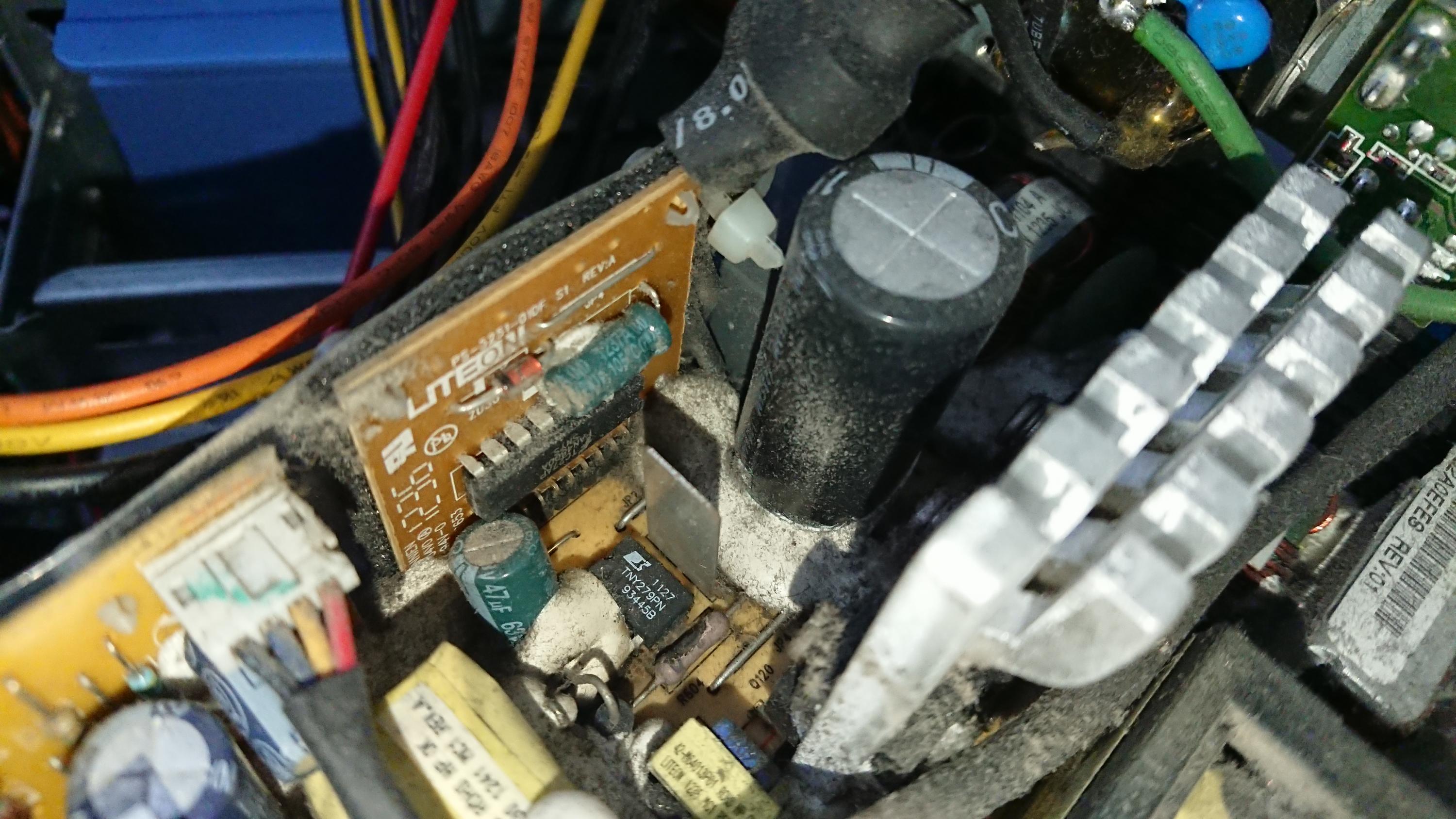

    Hi everyone,
    I have dell 7010 DT ( SFF) with bad PSU
    THERE'S NO 5V standby\ litting LED near the power input ( I'm assuming it's the same circuit? &#128578
    I'm neither too professional \ have zero clue in SMPS, I'm somewhere in between, that's where and why I'm need your help please 🙏 🙂
    By a kinda quick search here's the conclusions for now ;
    the main fuse IS OK ( there's continuity, so I'm guessing that it's not too hard to repair ? 🤔 🙂
    THERE'S NO visible bulged capacitors
    THERE'S NO 5V standby \ litting LED near the power input

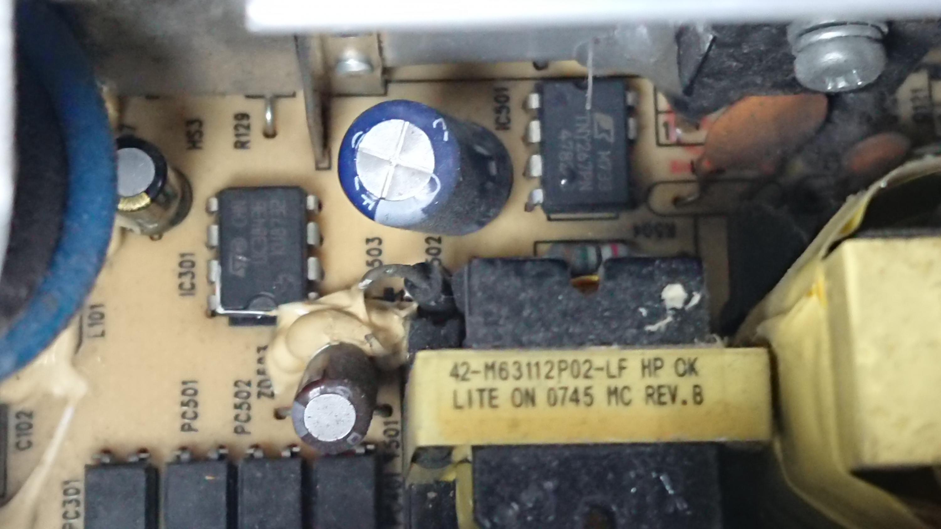

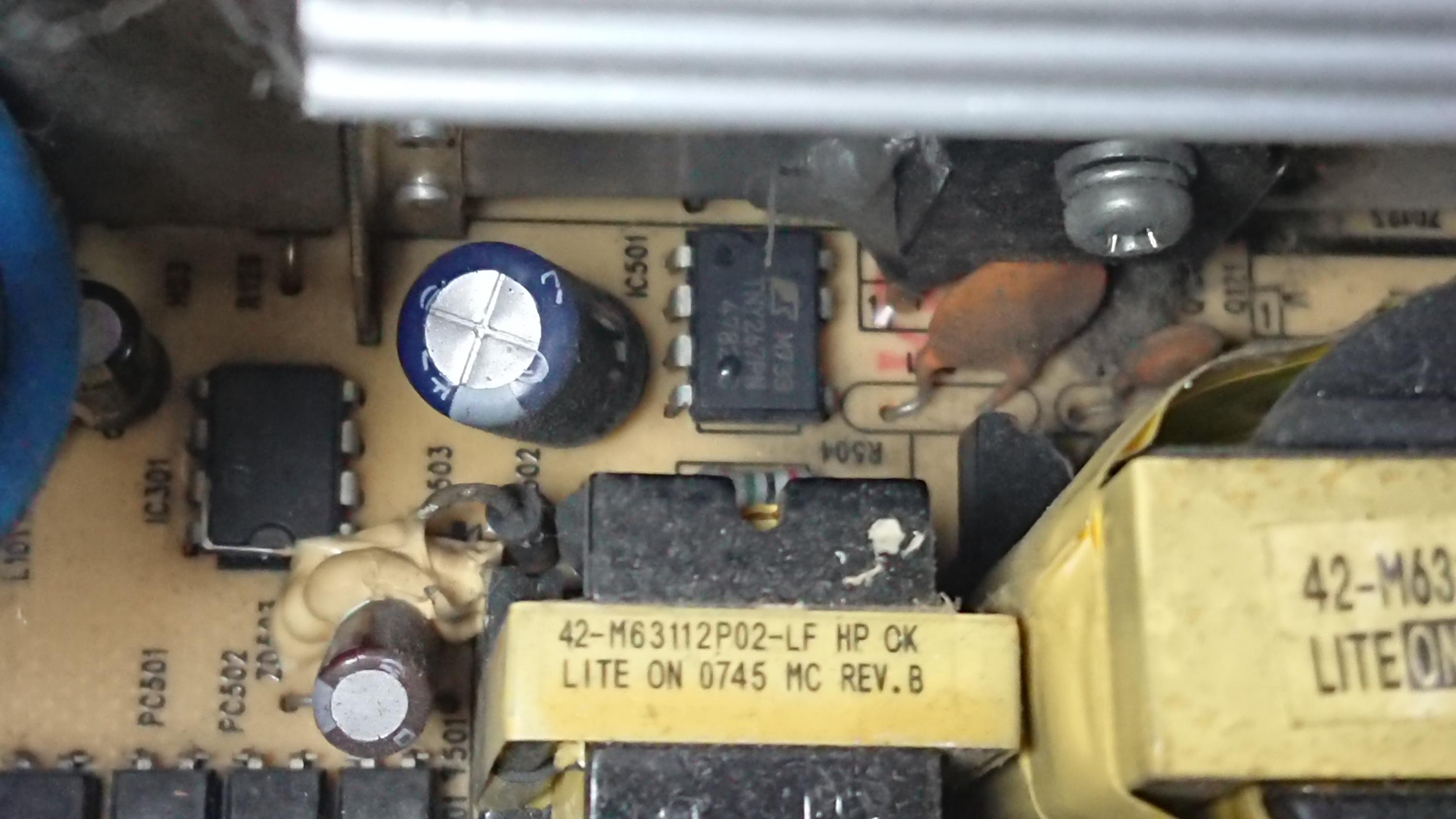

    For now, from a quick random culprit search, the only thing ive found is R604 ( fusible resistor between the primary & secondary PS sides? &#129300 it looks like it was kinda explode..
    The question is, how to test with DMM nearby components, and which ones from the surroundings you think might be bad toi because of that?
    And how to tell its value & get a replacement?

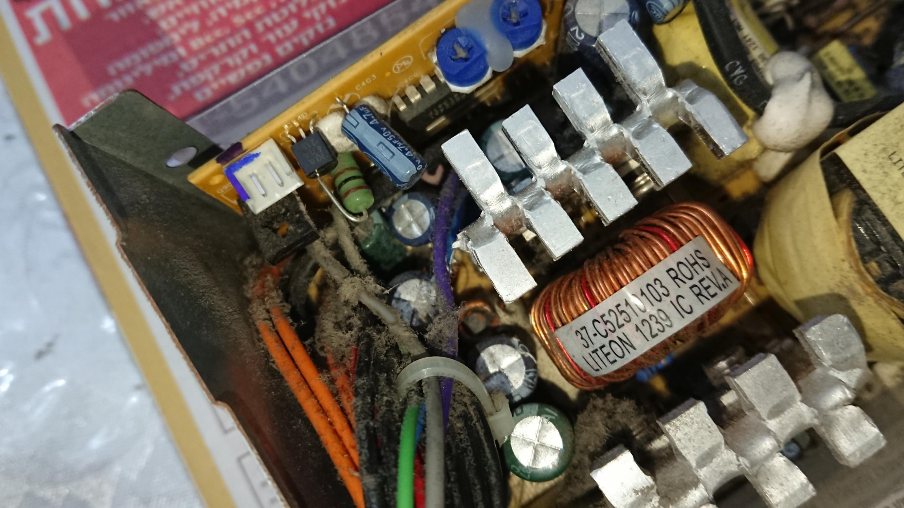

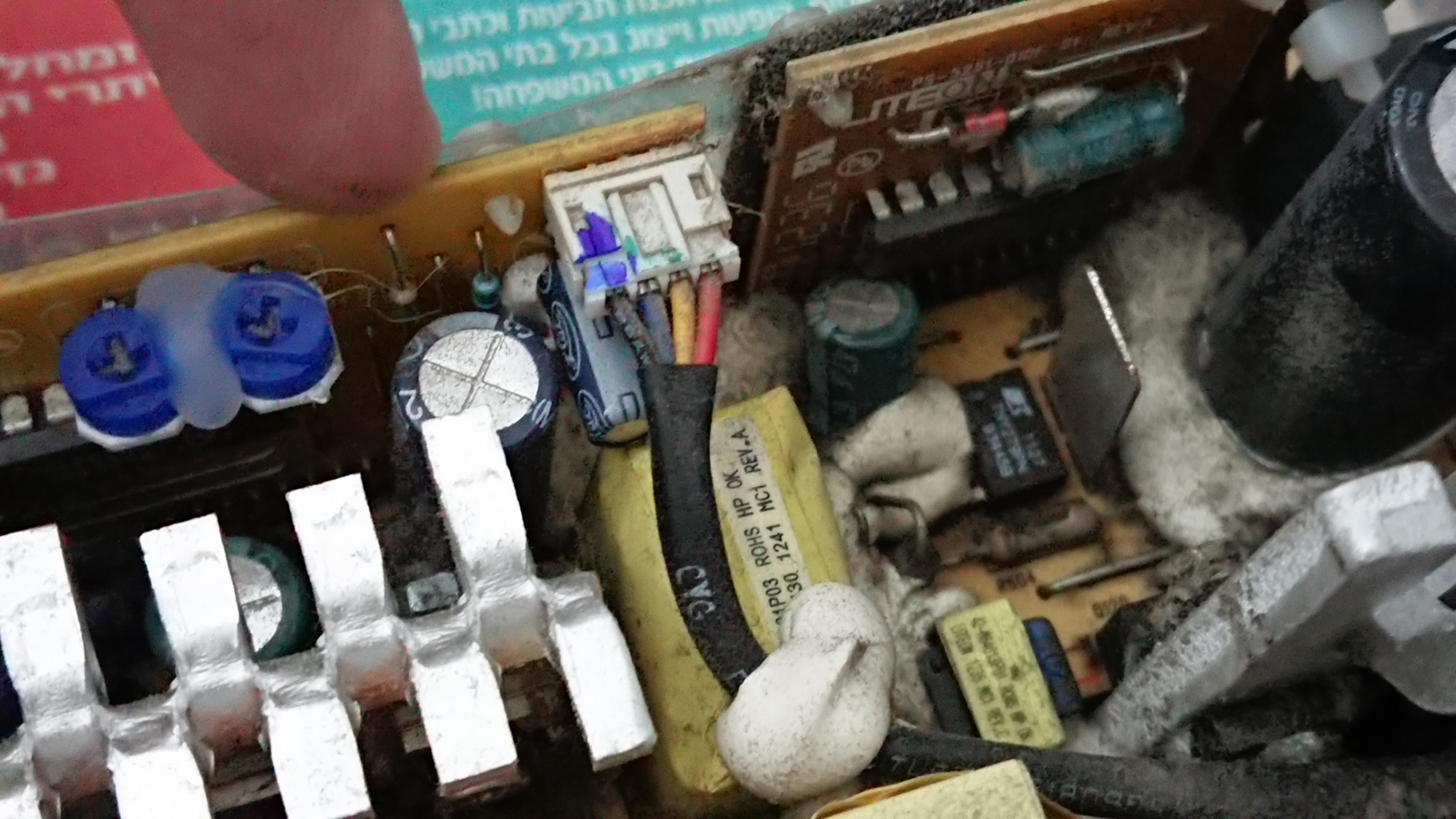

    ** not sure if it might be related \ help for diagnosing, but the PSU was kinda dusty, not too bad, but had some more dusty points, is there a chance that all the other components are fine and that the R604 gone just because of spot overheating?
    Which more tests& components i have and able to test with a DMM?
    Any help would be highly appreciated 🙏 thanks!
    I've attached some pictures of the PSU and the R604, let me know what else to take photo of, if needed

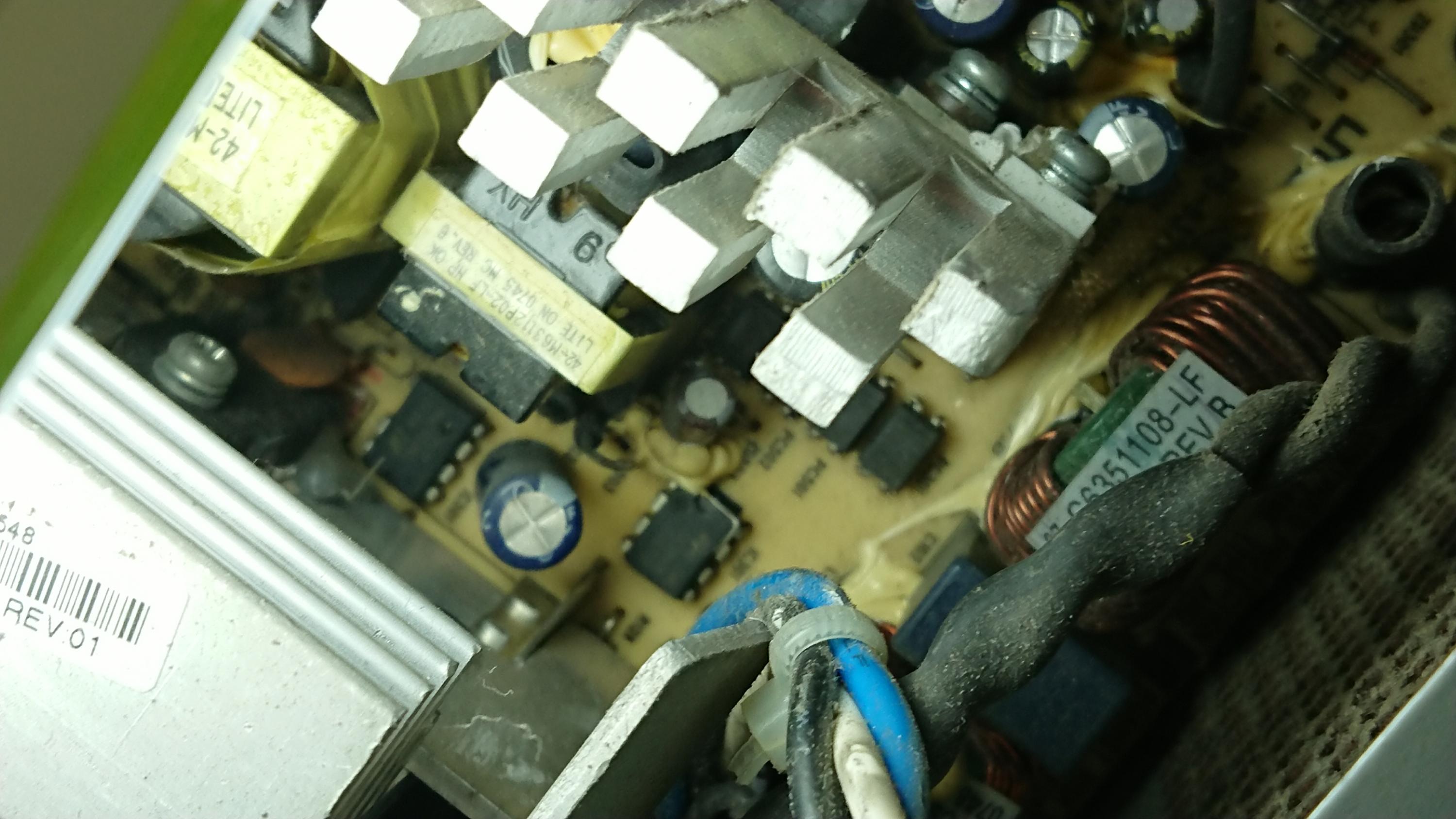

    the TNY279 has exploded and taken r604 with it

      Oh, now that you said that, I've looked closely and it's
      have cracks😢
      What can cause this? Or its just aging \ MTBF?
      Can i scrap replacements from another random ATX PSU?

        TNY do have a reputation for just dying,
        but you need to check the output diode isnt shorted.
        if you can salvage parts - why not.

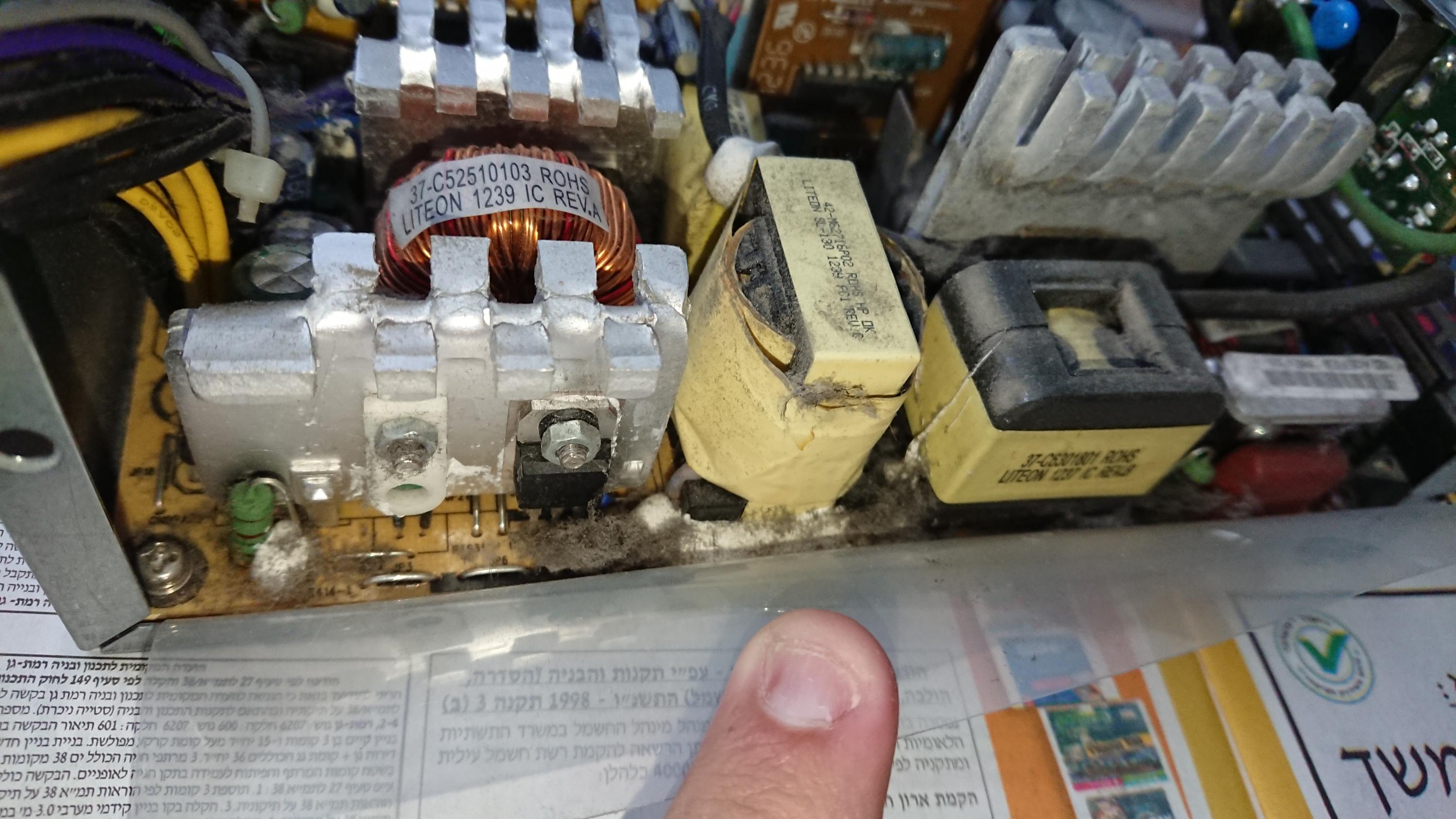

          That diode is one of the heatsink attached components or those that on the other side? ( kinda giant (&#128513SMD diodes?
          And just for future understanding and learning what's that TNY279 IC does? Is that the mosfet driver?

                  but there are a couple of those with a design error - post a picture of the inside

                    Unfortunately Tny26x and Tny27x are not compatible. They have different pinouts

                      If I'm understanding the circuit right, the TNY IC is on the same area of the psu
