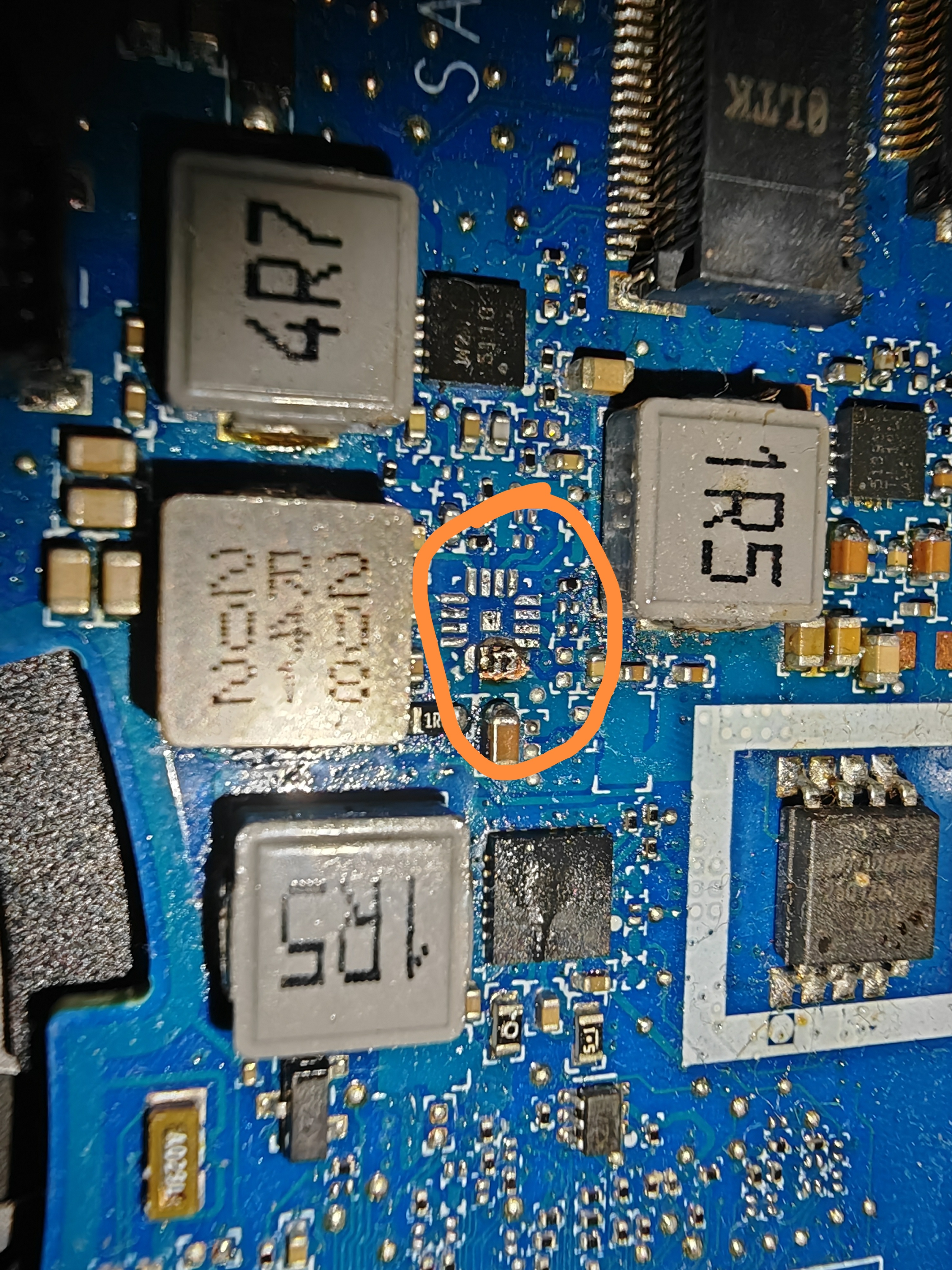

HP Omen 15-ek0049, DA0G3EMBCD0 Rev:D (Quanta G3EA / G3E?)

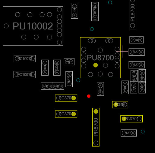

HP Omen DA0G3EMBCD0 G3EA Boardview doesn't seem to correspond with the layout of this board, even though it has the same part number. The area was badly burned but I thought there was a small component connected to the ground stub just above the capacitor. Perhaps that's just a test point and there really was no crispy component that came off when I cleaned up the area.

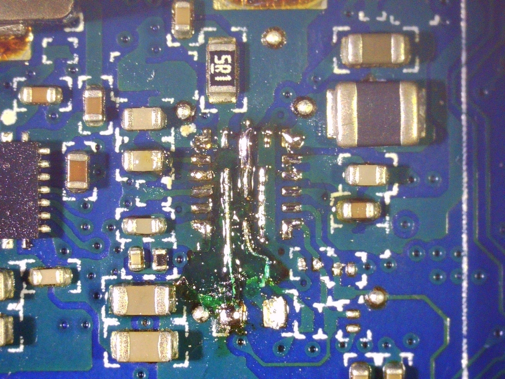

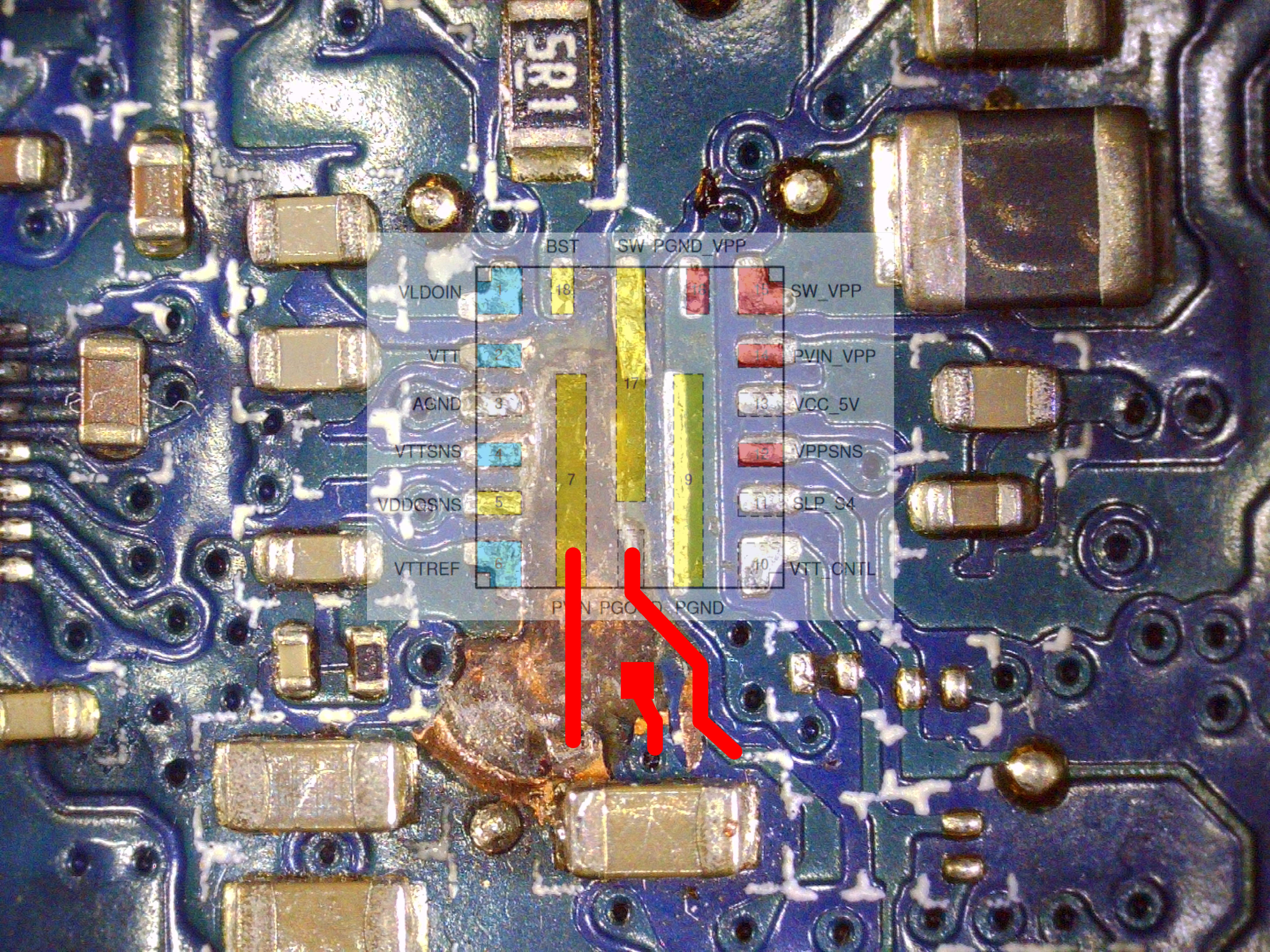

I just received some TPS65295 ICs so I'll install one with nothing attached to the stub and see if it works. I need to mask off the exposed ground plane in that area before replacing the missing tracks (red). I'll update the post to show what I find. Thanks again for your helpfulness.Comment

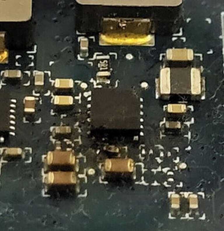

It that a common fault in this laptops? Have exactly the same burned chip/area. Does i have effect on the ITE8750E and 3.3V rail? 3.3V rail was shorted, the ITE getting hot, when in injected voltage. 3.3V Up again after removing the ITE. But still have to fix the burned 1.2V area.Comment
Hello TheChief79,It that a common fault in this laptops? Have exactly the same burned chip/area. Does i have effect on the ITE8750E and 3.3V rail? 3.3V rail was shorted, the ITE getting hot, when in injected voltage. 3.3V Up again after removing the ITE. But still have to fix the burned 1.2V area.
I don't know if it's a common fault -- this was only the first or second Omen I have worked on. It sounds like your ENE has a short. Fixing that burnt area is a nightmare, BTW, if it has burned off the top layer of the MB like in my case, exposing the ground layer just beneath the surface.Comment
Hello TheChief79,
Hi Larry,
yeah, mine too. Used some UV mask and still waiting for the replacement chips (ITE and TPS). But i wonder, what caused that burning.
What are the values for the big too caps? The right one is completely missing, the left on was blown.
And is there another component? Resistor or something? Or another small cap?
Maybe 3x 10uF and and 1x0.1uF caps accouring to the datasheet?

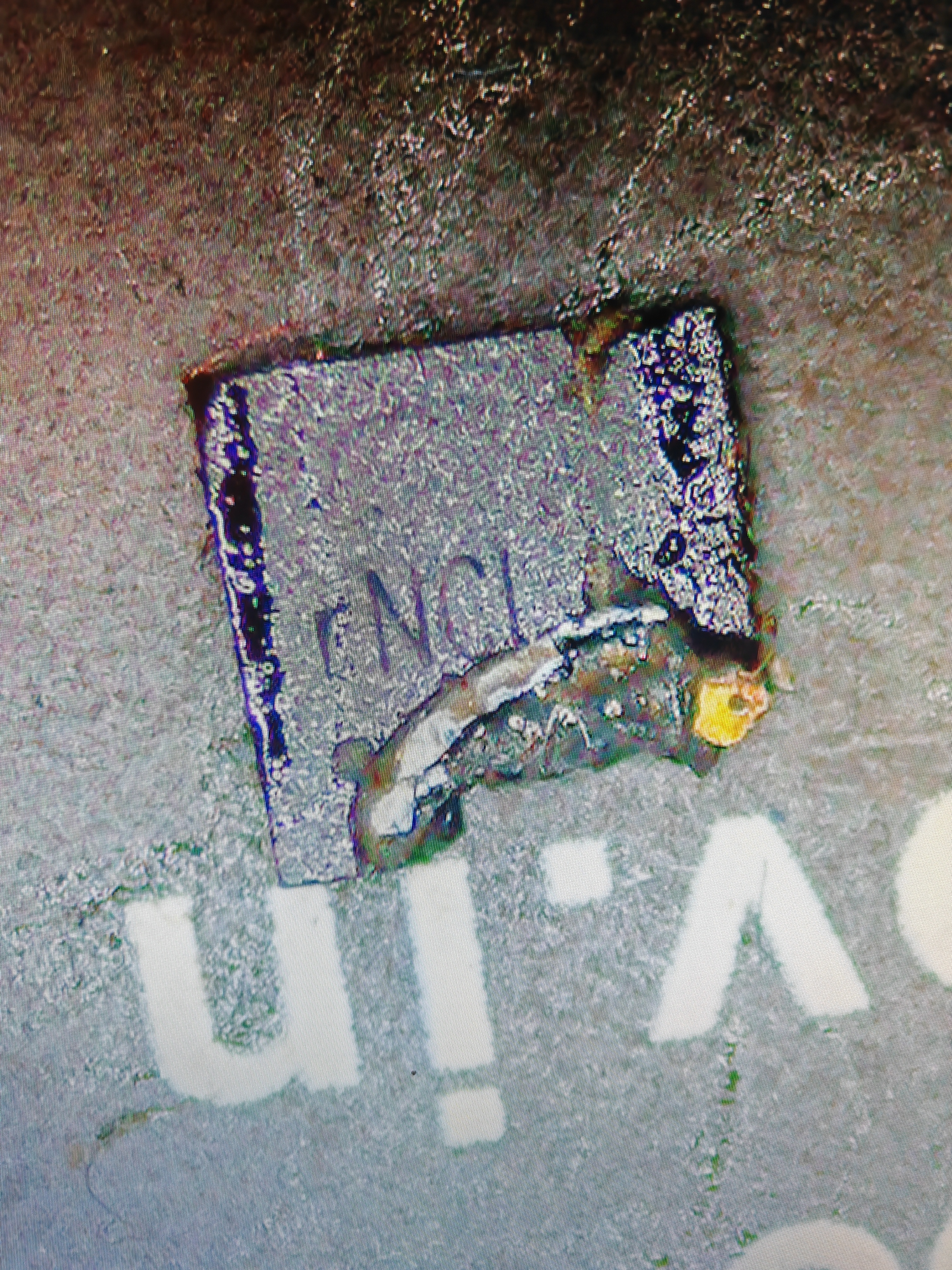

that chip is 51393P. closest datasheet is https://www.alldatasheet.com/datashe...TPS51396A.html
did yours burn out? i am suffering the same burnout as other posters in this thread (TPS51486, and most specifically the small capacitor just below it); and indeed under a thermal camera this 51393P chip does in fact get warm, but in my experience when these chips show warmth it is because of a short somewhere else and rarely in these chips themselves.Comment
Hm, cant be an 51393p. The chip on the board has only 16 pins, 51393 has 20 pins. Do u have a detailed picture of that area?Comment
sorry, was looking at it's southern neighbour marked 51393, the chip in question is marked rNCLA
