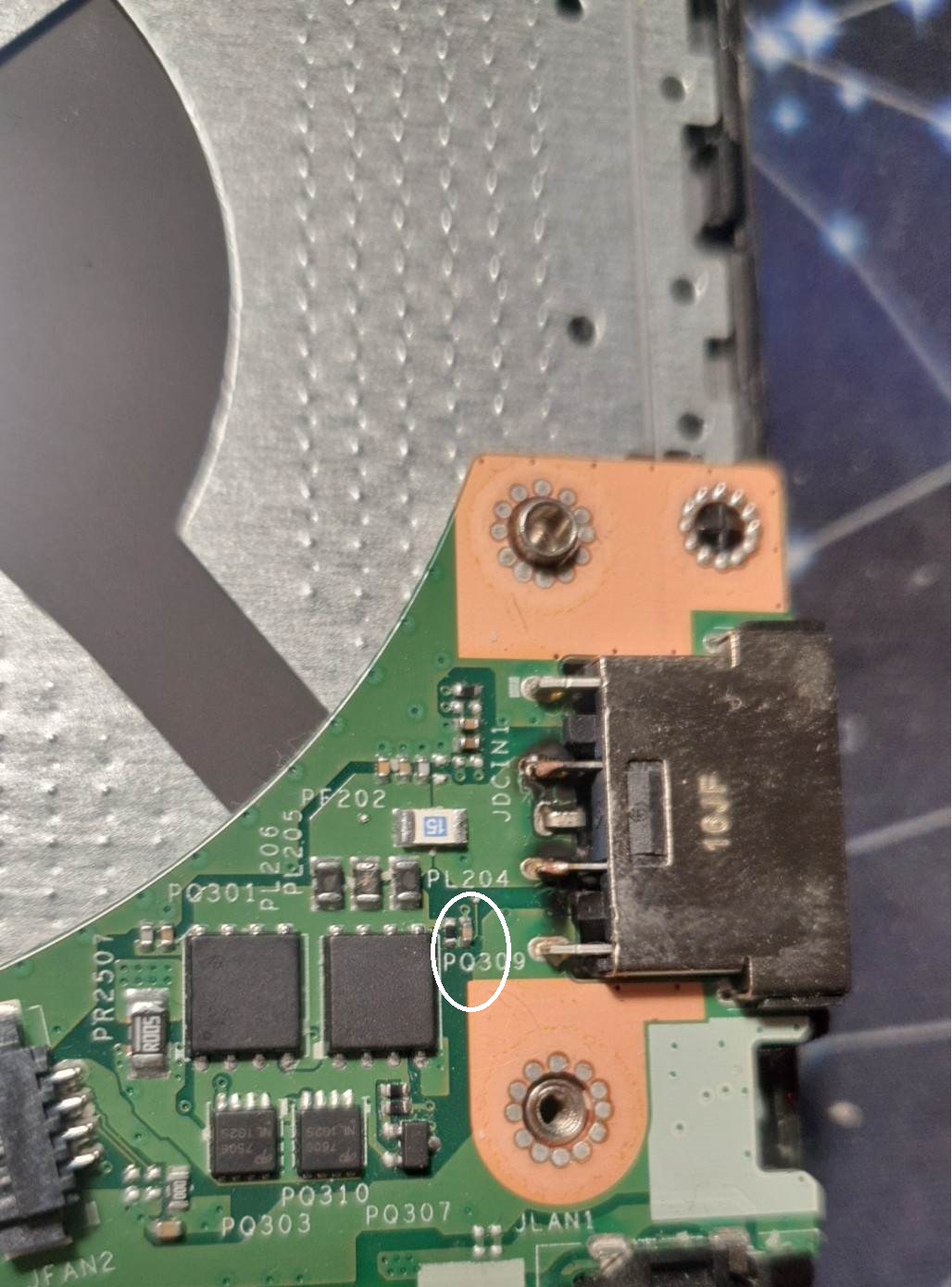

        big thanks for your schematic Lisa Su. Due to your help i was able to identify most of issues with my laptop. But i have rev 1a and nearby charging port (alredy removed, burned) i have lost cap (PC210 or PC9207) and probably resistor or Thinking CPTC thermistor(PH301). Thtats my guess based on your files(cause in it, there is no cap betwen PH301 and +19Vin), maybe do you have rev 1a schematic or boardview or simply know answer?

            Originally posted by 12mk
            Re: Lenovo Ideapad Gaming 3-15ACH6 LA-L171P schematic
            I know that comment is from february, but for someone else, maybe is helping.
            So, resistor that you circled in picture, is a 0 ohm resistor(like a fuse); my mainboard is working.

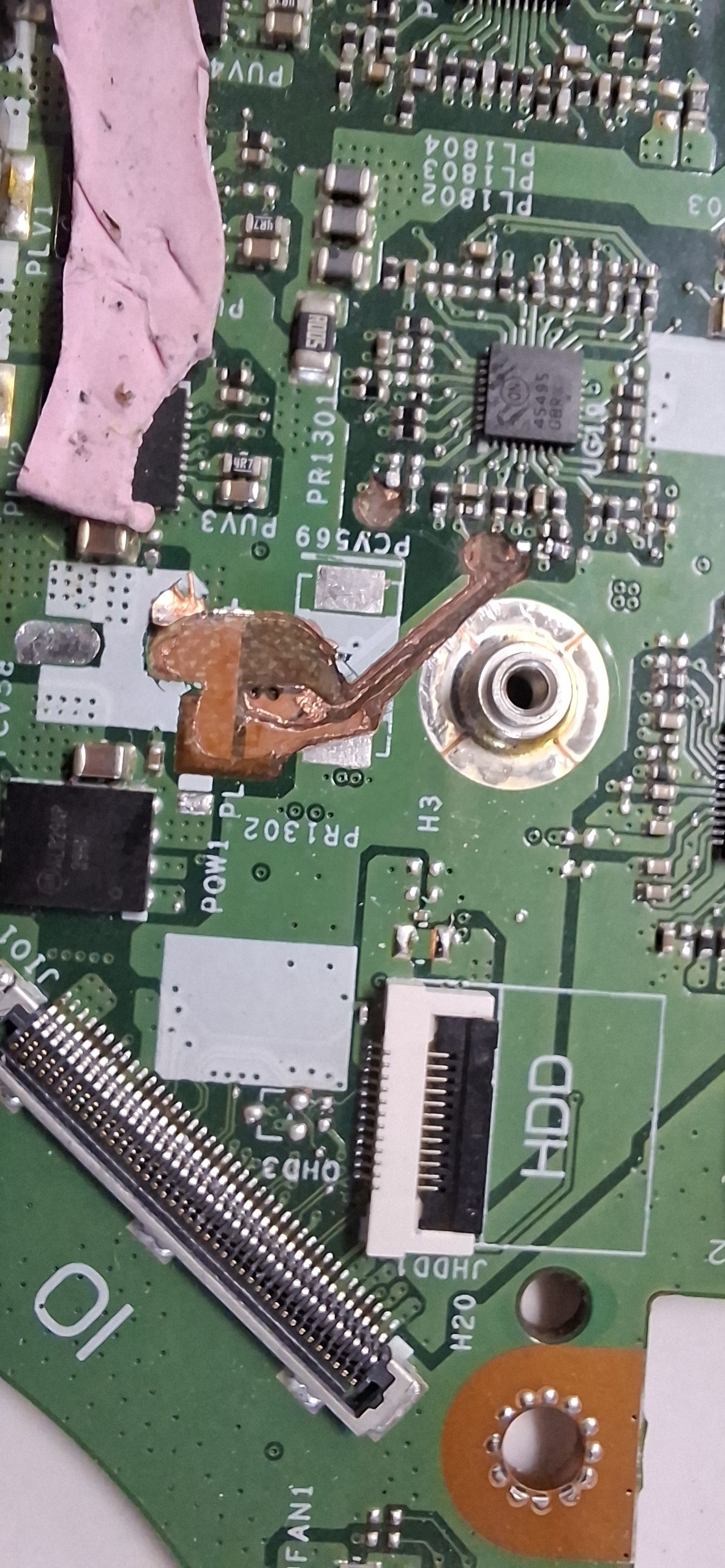

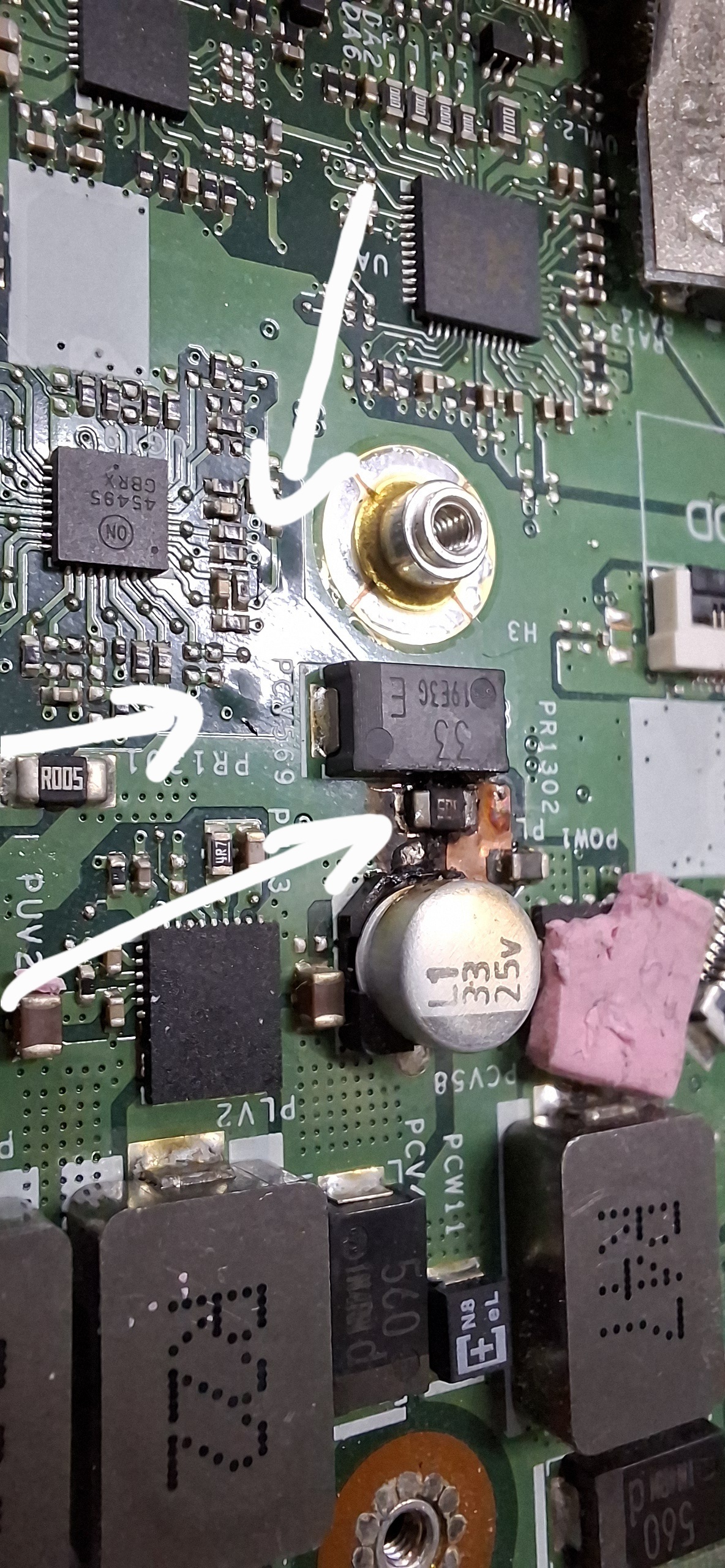

                                    I have a problem with my motherboard burning on the +19VB line under PL1802. After cleaning it, it turns out that several layers inside were burned and the line was broken. I'm having trouble identifying the line without boardview. Any help I can give is greatly appreciated.
