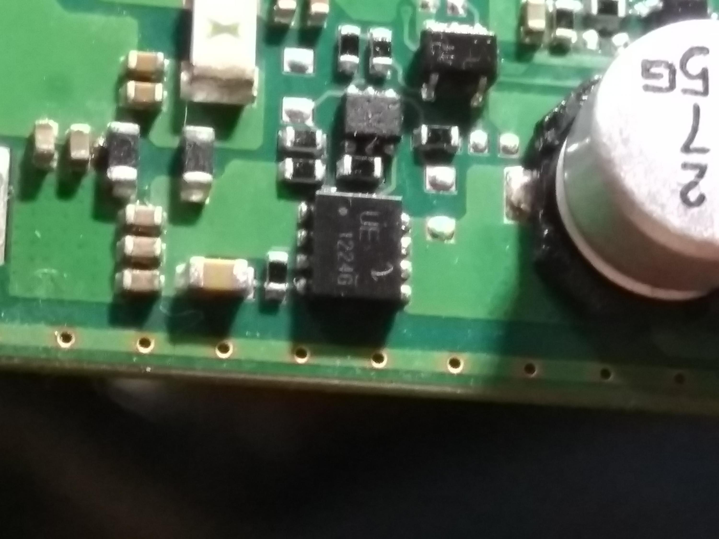

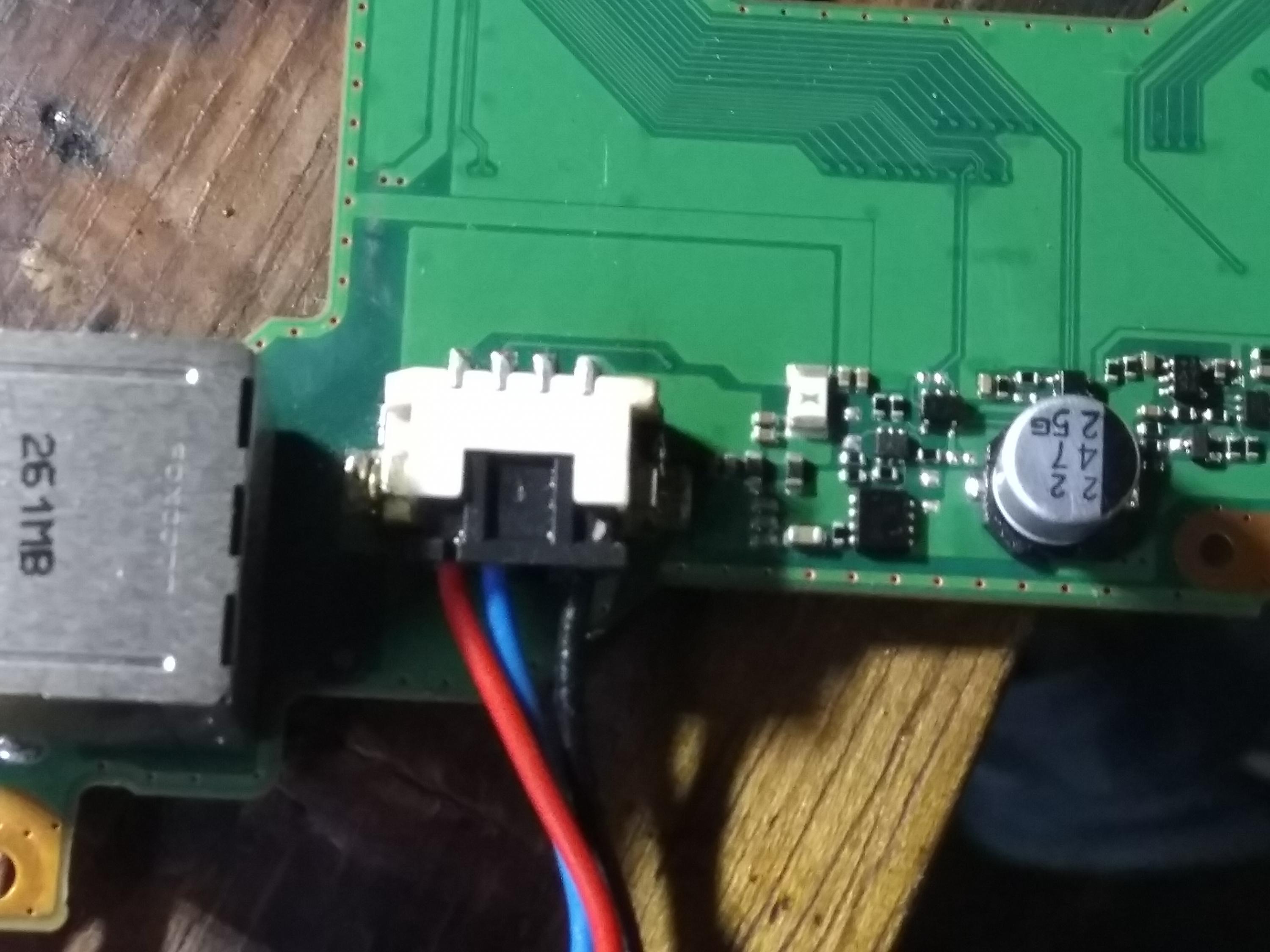

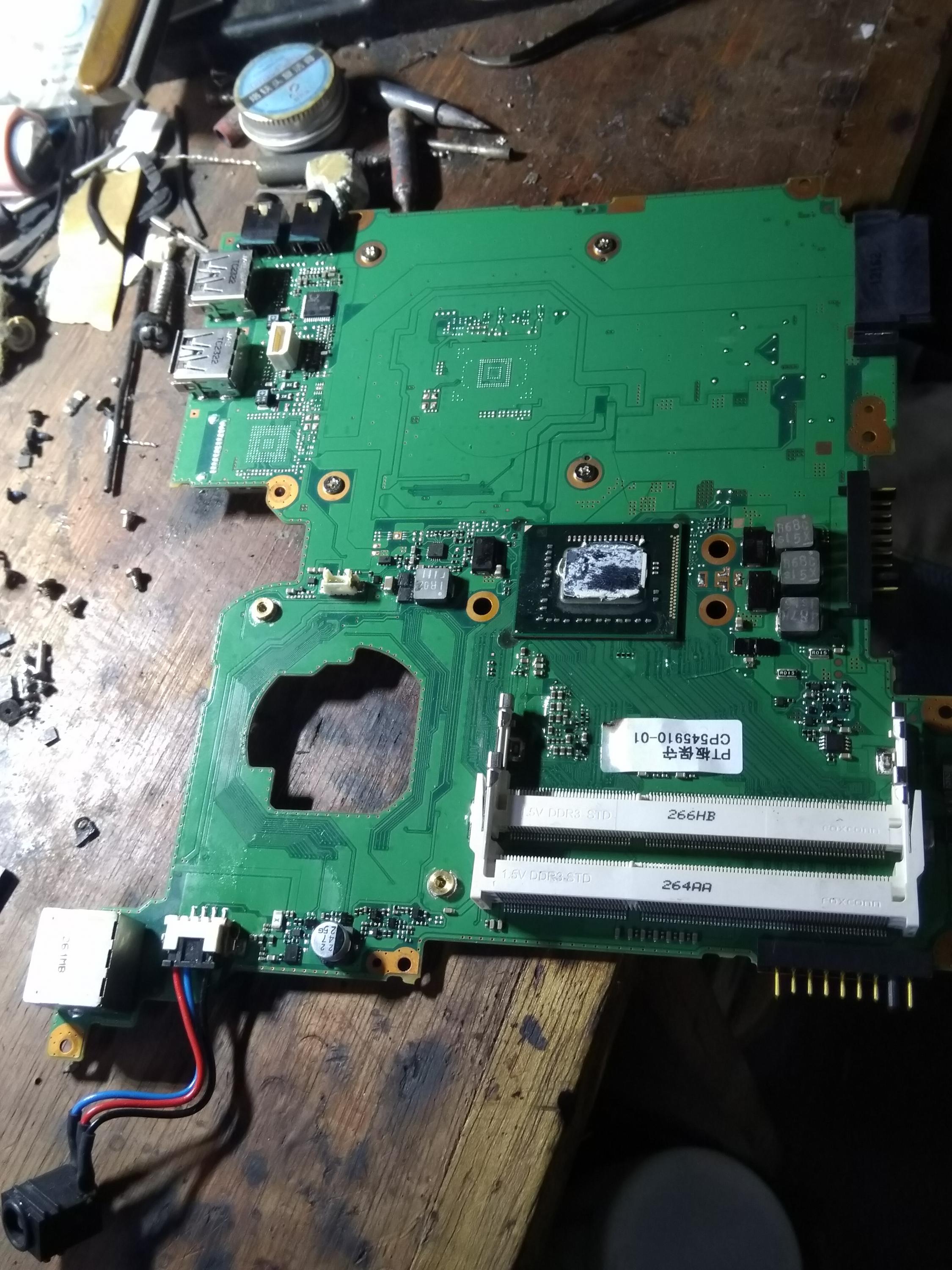

    The fujitsu laptop is shorted and i suspect a mosfet, because its heating up when injected in DC bench

    Which part is heating up ? The mosfet ? What are the markings on the mosfet ?
    Remove all power. Meter in resistance mode (2k scale is ok).
    Check the resistance for the following:
    source (1-2-3) & drain (5-6-7-8)
    source (1-2-3) & gate (4)
    gate (4) & drain (5-6-7-8)
    Checking for any low resistance readings. Post your measurements.

      The marking of the mosfet is UE 1224G, i cant find any details about it
      For the measurements
      source (1-2-3) & drain (5-6-7-8): 1.0m Ω
      source (1-2-3) & gate (4): 099.4k Ω
      gate (4) & drain (5-6-7-8): 1.1m Ω
      i only injected 3volts and 1amp skipping the fuse and that mosfet heats up

        change mosfet low resistance says itself.
