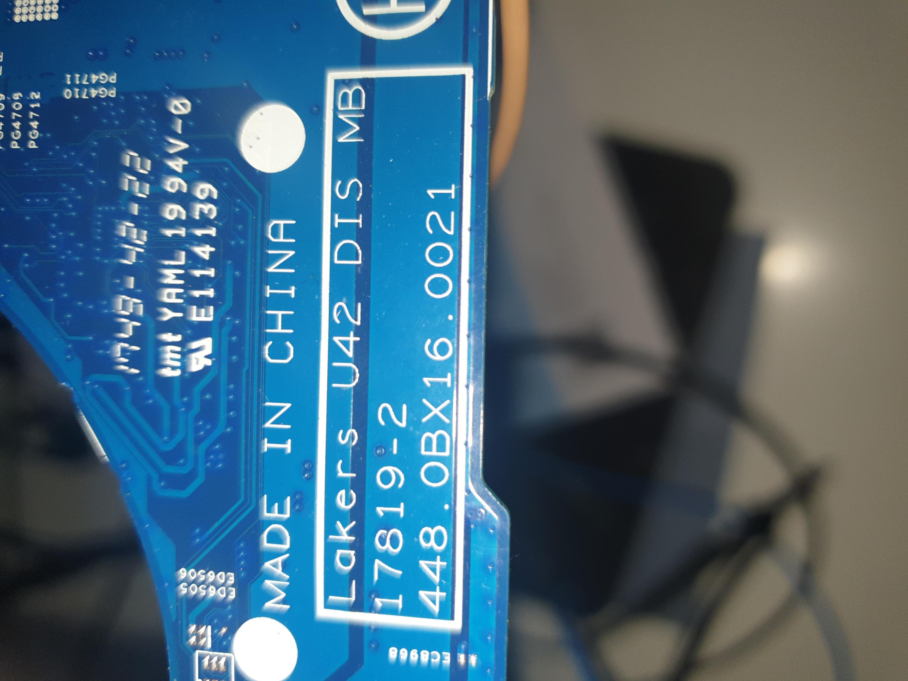

Looking for HP schematic 17819-2 HP 15-bp103nx
  • Antonynl
    • Apr 2021
    • 74
    • Nederland
    Looking for schematics 17819-2 for ENVY x360 -15-bp103nx
  • Antonynl
    • Apr 2021
    • 74
    • Nederland
    Re: Looking for HP schematic 17819-2 HP 15-bp103nx
    Still looking for the schematic.
    Is there may be a schematic of a previous version of this board that can be used as a starting point? This is an i7 8550.
    Thank you
      Just had one of these in today completely dead. Some notes for future ref.
      Charger section is nowhere near where DC jack connects (DCIN1). Current sense resistors are on the other side of the board below the GPU.
      PR4402 seems to be the main CSR for the system, PR4417 the CSR for the battery.
      Charger IC (PU4404) is BQ737, ACFET/RBFET are PU4406/4407 (AON7403), BATFET is PU4408 (AON7403). Charger FET's are PU4409/4410 (AON7410).
      PL4501 - +3.3V
      PL4502 - +5V
      PL4001 - 13V (Battery)
      PL5101 - 1.2V (RAM)
      PL5201 - 1.0V (PCH)
      PL5001 - 0.9V (System Agent?)
      PL4701/PL4702 - ~0.4V (Vcore)
      PL4801 - 0V (CPU graphics?)
      PL8601 - 0V (GPU)
      PL8501/8502 - 0V (GPU)
      So two faults on this one. Shorted main rail was PC5101. Replaced with a 22uf 0805 as a guess since it's decoupling the rail for 1.2V RAM supply (too much is better than too little). Then found PU4406 shorted as well. AON7403 seems a bit underrated to me for a laptop with discrete GPU and pulls 4.6 amps. Uprated this to an AON7405 which I had in stock.
