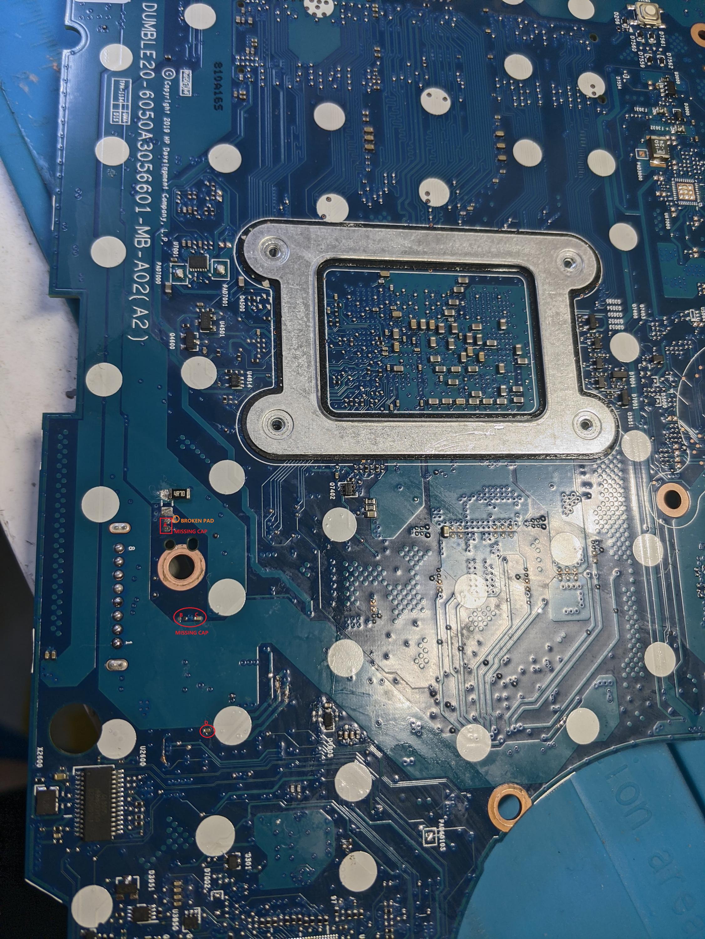

    HP 17-ca1035ca Schematic needed
    board print id: DUMBLE20-6050A3056601-MB-A02
    I got this water damage HP BOARD and need help find the missing cap and Orange pad corroded dont know where it should go
    Any similar schematic and boardview can be use?

    Re: HP 17-ca1035ca Schematic needed
    It's the 19V rail, Just take a wire & solder it to any close by 19v trackpad. Don't worry about the caps right now. You can easily match this size caps on any hp schematics, but I think its 10U 25V
