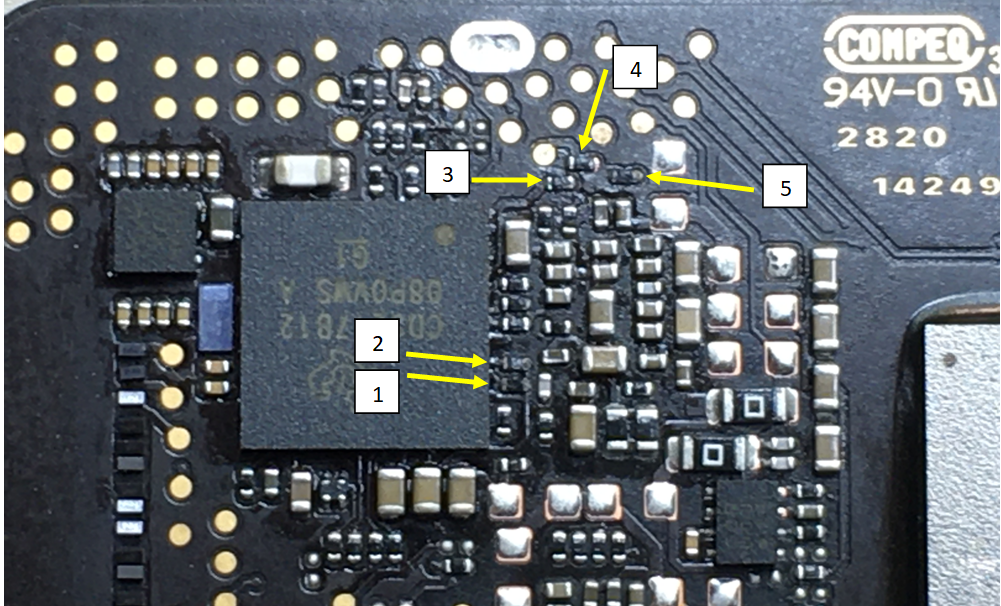

    A2179 820-01958a
    Can someone give me the values of the resistors marked by the arrows?
    Without the BRD it's complicated.
    Thank you in advance.
  • oustou
    • Jan 2016
    • 26
    • France
    Re: A2179 820-01958a
    Good evening everyone,
    I received an identical card, I was able to measure it:
    1_2: 1Mohms (Maybe I2C)
    3_4_5: 15ohms (SPI link)
    I hope it will be of use to others.
