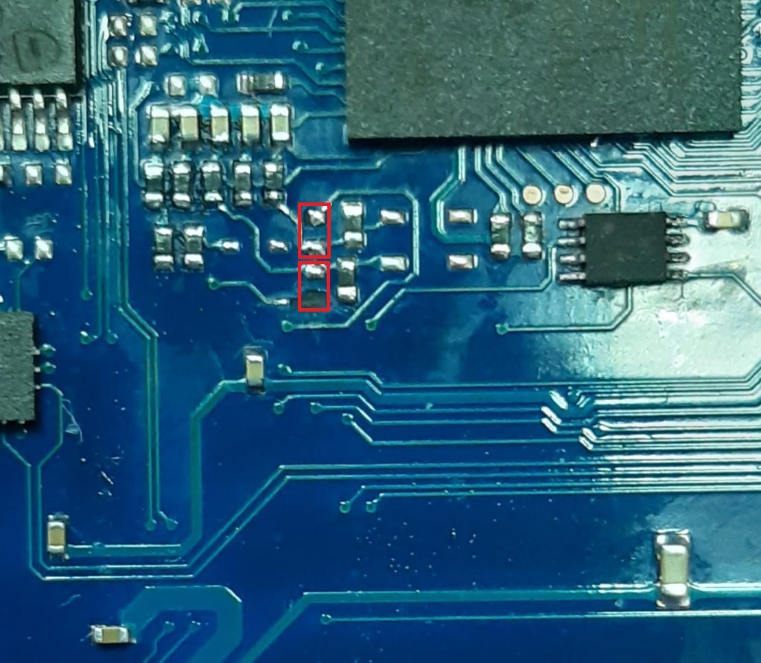

anyone know value of the 2 resistors marked red?
Toshiba Z40-A board code FAMXSY5 A3660A
no schematic or boardview
Thanks in advance

top-12k
bottom-100k
