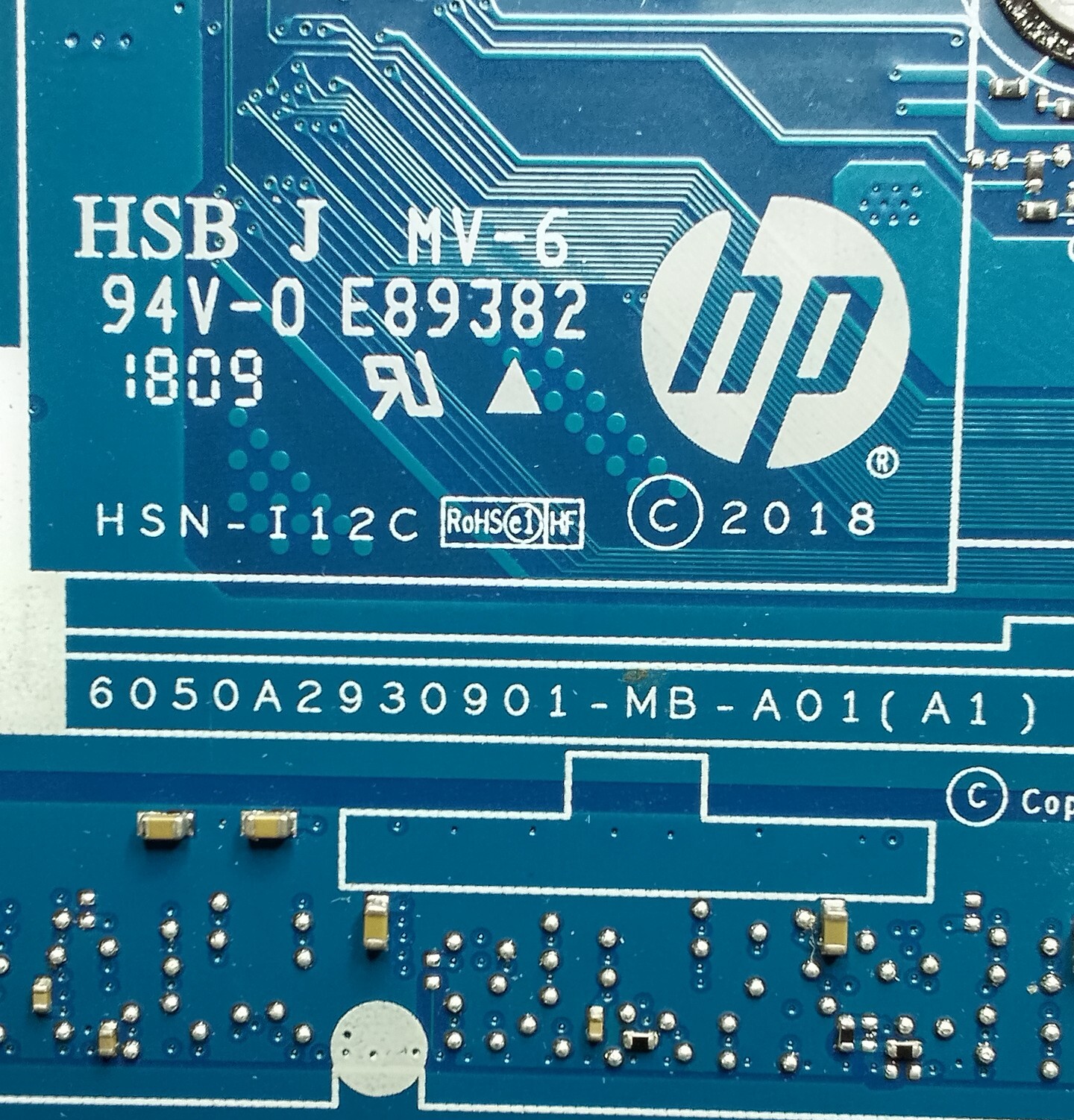

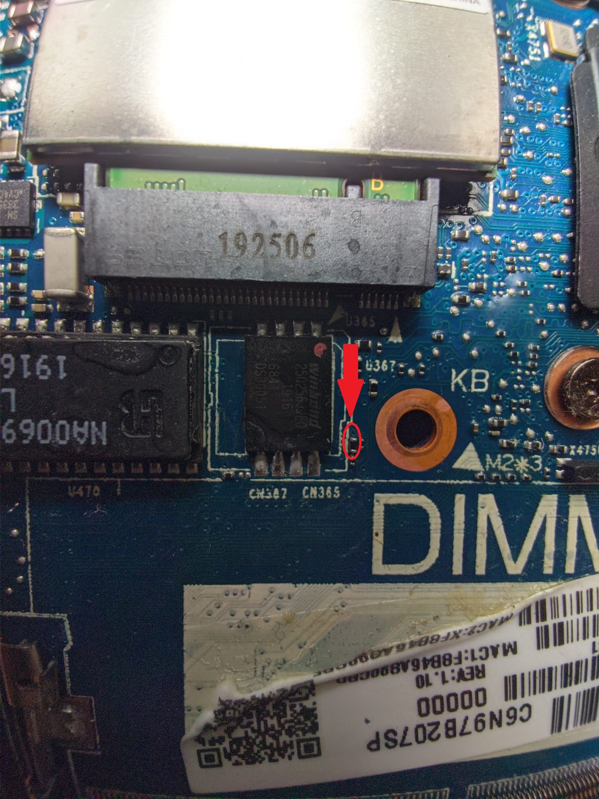

    Hi, I need schematic or boardview, I need to know what resistor to replace the one highlighted, when I soldered the bios chip back one resistor flew off, I tried replacing it with another one but the one I put is a little bit larger and now the laptop turns on for 3-4 seconds and turns off and on back again.
    MB version: 6050A2930901-MB-A01

    23 ohms ... without removing the resistance from the motherboard ... if it still helps you ...

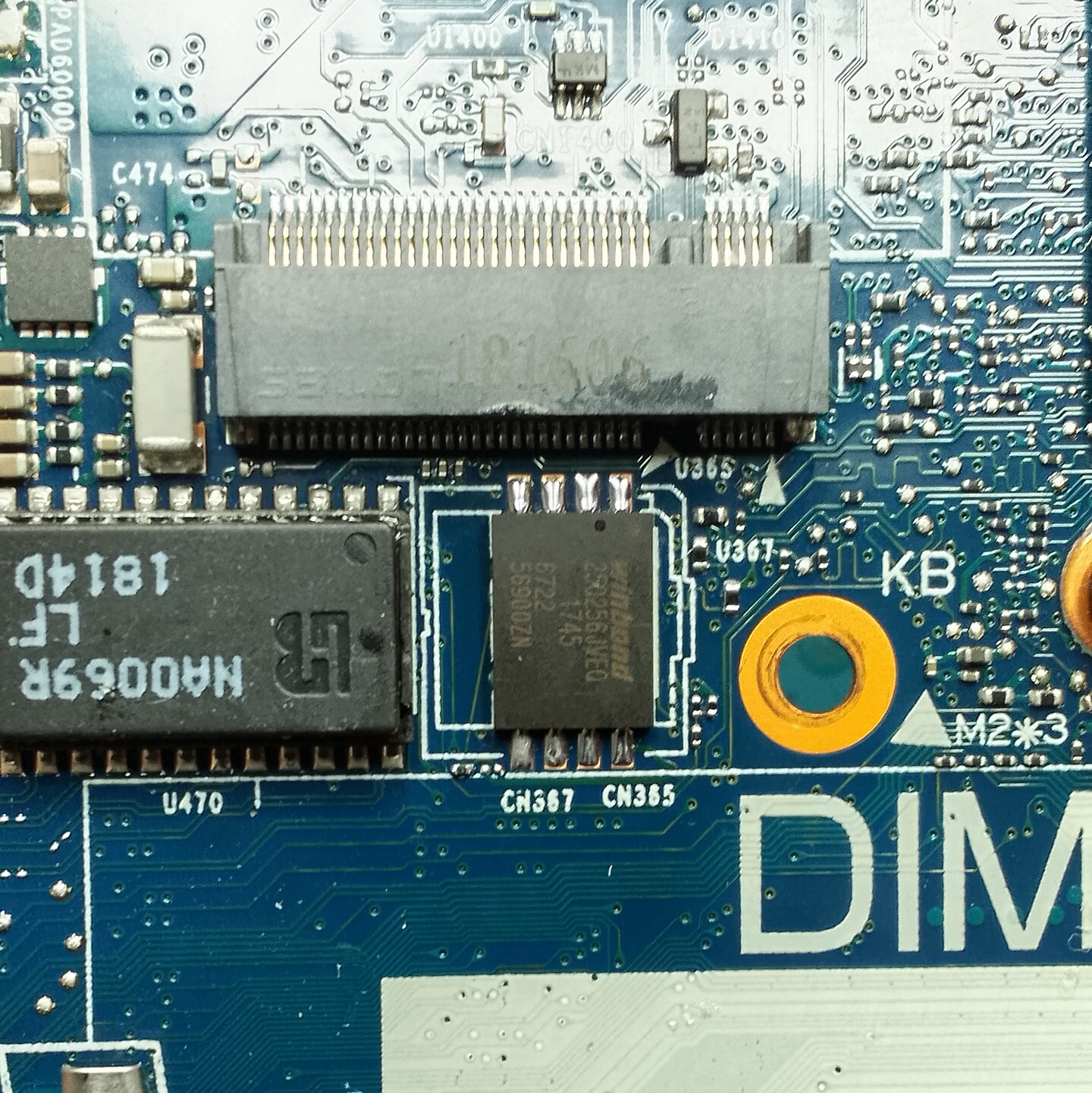

                Can anybody share me the value of bios pin no7 register near CN367
                • smadnan
                  • Oct 2018
                  • 14
                  • Pakistan
                  10 K ohms Both

                      resistor value is 15.5Ω.

                              Its 22ohm resistor
