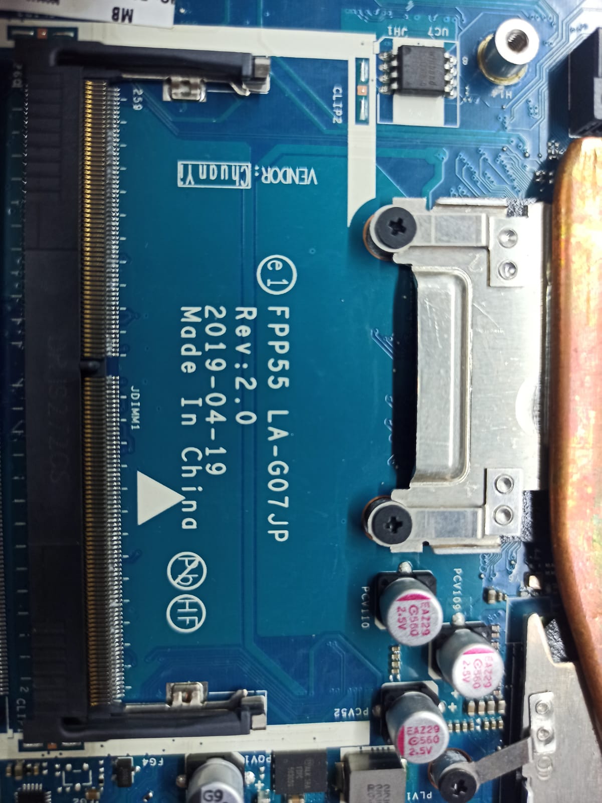

    LA-G07JP REV: 2.0 Schematic Need
    hi
    hp FPP55 LA-G07JP REV 2.0 Schematic/Board view need please help

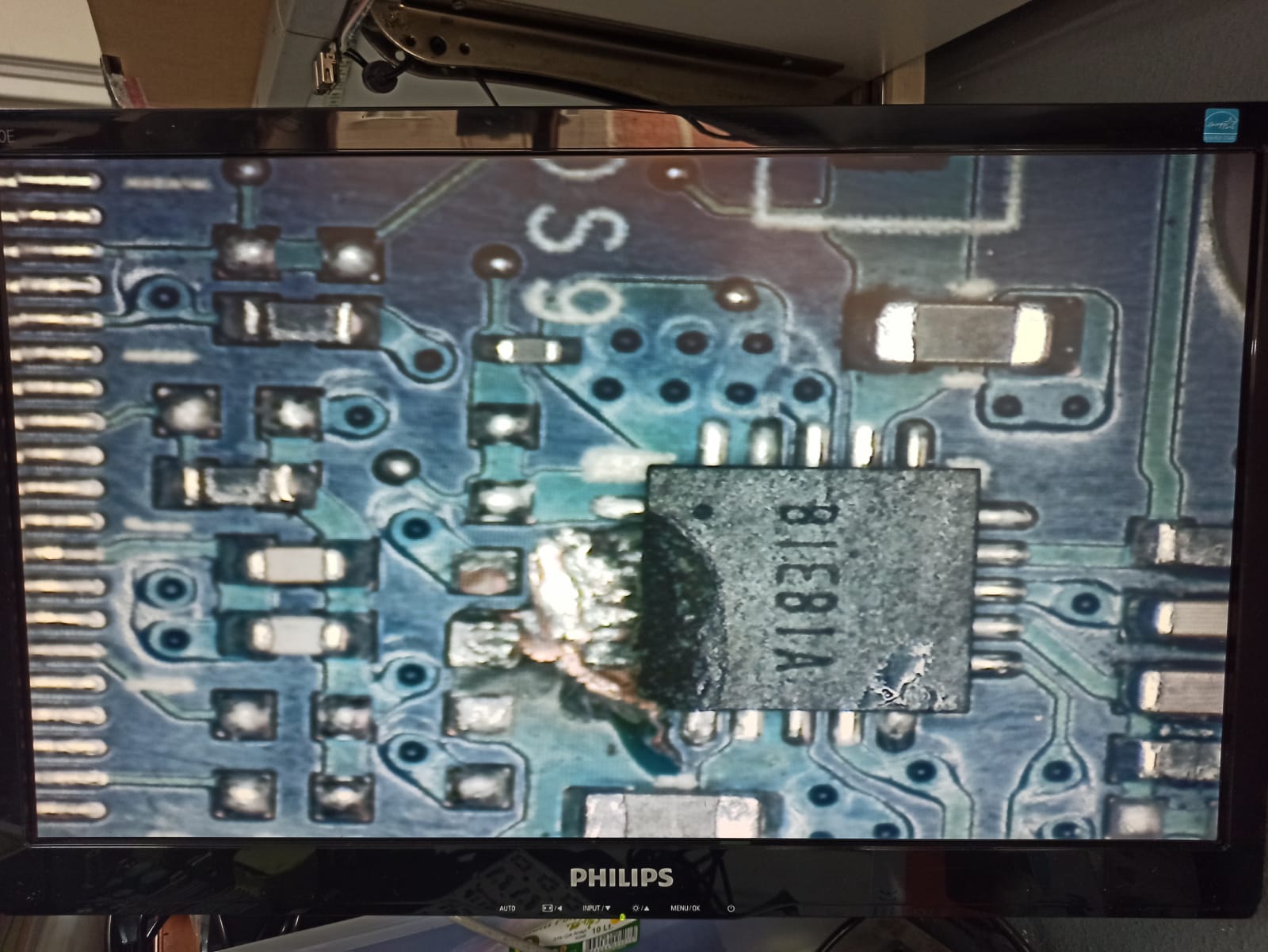

        Re: HP 15-db1052nt LA-G07JP schematic
        I have the same laptop, but didn't find schematics anywhere .
        Someone know what 8 pin IC in photo?

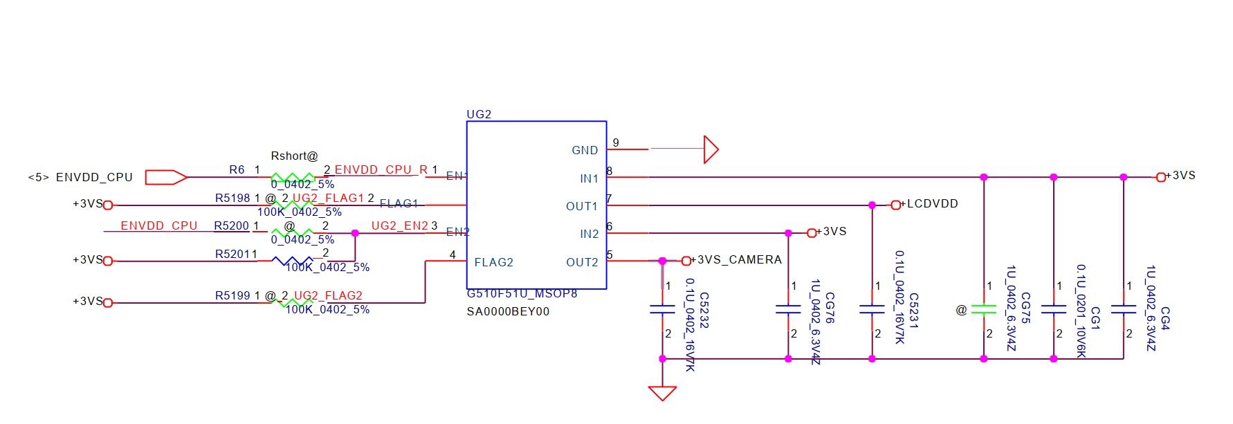

          It's some kind of power distribution switch/load switch with multiple output. I couldn't find a datasheet but got a reference circuit from another HP scematic.

                what ic is it?

                  https://www.badcaps.net/forum/showpo...1&postcount=12

                    schematic
                    ıc code :SY8286BRAC_QFN20_3X3

                      SY8286BRAC Datasheet - https://www.silergy.com/cn/download/...type=datasheet
