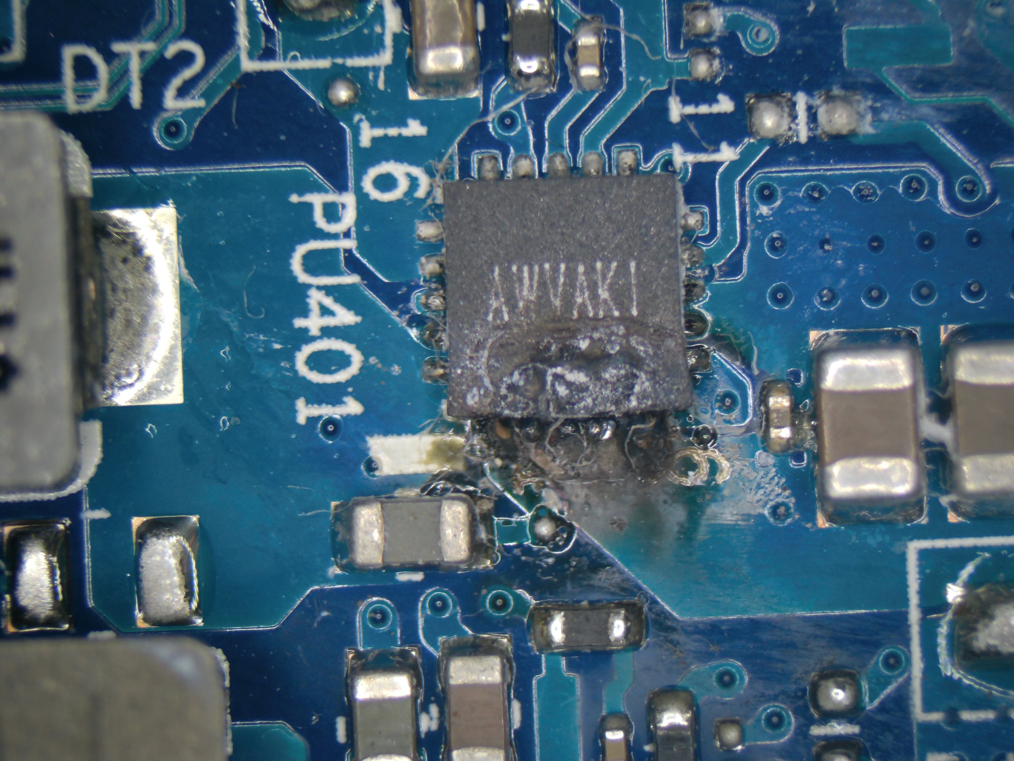

    I also need this schematic, PU401 is burned, marked with AWKAI.

      No schematic available yet.Post a good clear readable picture of PU401

        I downloaded the schematic for Lenovo Ideapad 330-14ISK, which is very similar to what I have, Lenovo Ideapad 330-14IKB although different board numbers. Looks to be a SY8286BRAC, a 6A, 23V step down regulator. It even had the same device numbers. Found it on ebay, well it will take a month to repair. Thank you for your concern.

          Yes,its AWV not AWK . SY8286BRAC
