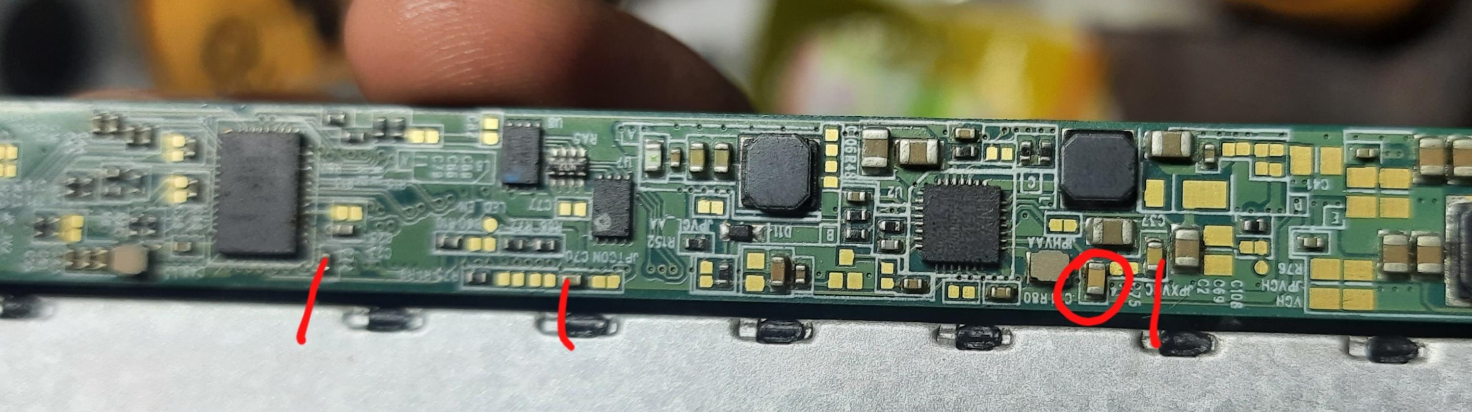

                I have the same MB with no Display and backlight, HDMI output is ok.

                    Re: Need Lenovo v330 Schematic
                    Problem solved by replacing shorted capacitor on tcon board.
                    Red marked caps are in parallel connection. Circle marked cap. Was full short.
