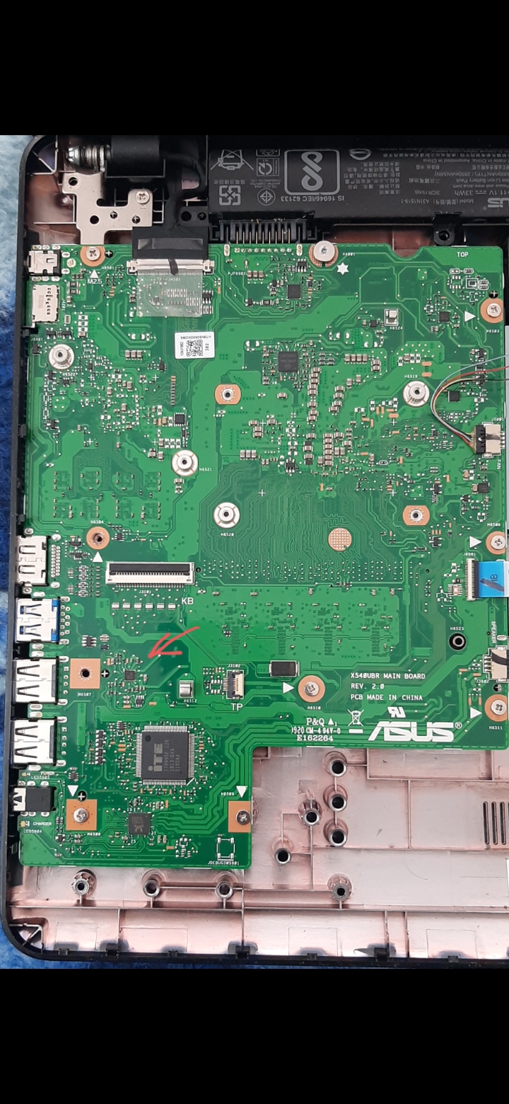

      Re: asus x540ubr schematics or board viewer please
      Hello friends, I need help. I need a schematic or board view of the Asus X540 UBR ver2.0 motherboard. Thank you

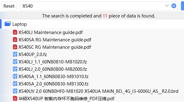

        See attached. Sharing all the Asus X540 boardview files from my database - perhaps one is close to yours.
            Board view was suitable for my work. Do you also have X540UBR ver2.0 a manual board repair service or block diagram?
              Will check after some more beauty rest.
              Which boardview file matched your logic board?
                O yeah
                X540UV 2.0
                  Sorry - have only the attached. Let me PM you.

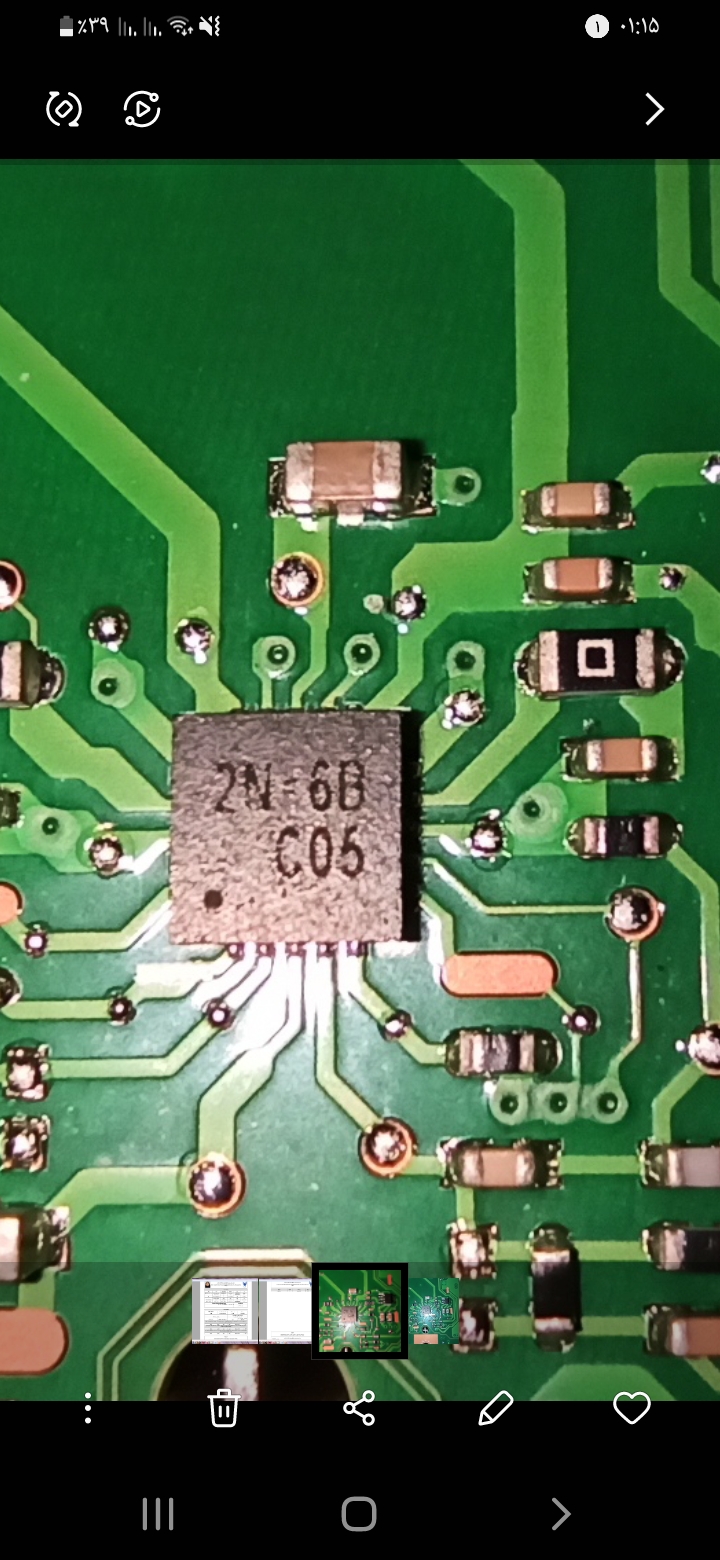

                        I removed all the additional equipment, including the hard disk, DVD burner, LCD monitor, etc., but this IC heats up according to the figure and draws a current of about 0.16.
                          The picture is too small to see the marking code on the chip..
                            2n6bc05
                              It will be Richtek part with '2N=' markings.
                              RT8249CGQW
                                Do you think this IC is burned out? Because I do not have the repair manual for this motherboard
                                  How hot does this chip get?
                                  The above datasheet has the pinout. With care, check the voltage of PGOOD pin and post the measurement here.
                                  Also check voltage of LDO3 and LDO5.
                                  Post the voltage of each.
                                  Do not short the pins of this IC.
