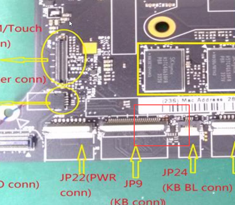

                        Need Lenovo Yoga 2 pro 13 NM-A074 boardview
                        Hello, I have Lenovo Yoga 2 pro 13 with i7 4500U processor and 8GB RAM. I do have the schematic KONA NM-A074.
                        The laptop is working fine with bluetooth keyboard and mouse, but not with attached ones. At the startup The backlit LED of keyboard is ON, but later is not working. I have tried all windows based setting and now looking for HW debug.
                        I am looking for boardview file for KONA NM-A074, as unable to find the resistor locations. Please share if any one have.
                        If any one resolved similar issue, suggest the way forward. Thanks.

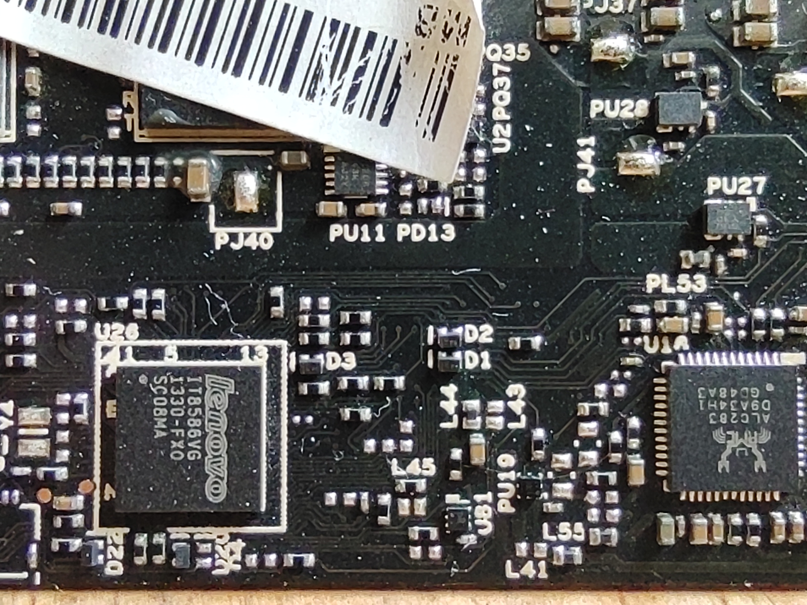

                                    Re: Lenovo Yoga 2 Pro Lenovo nm-a074 schematic and boardview
                                    Unable to locate it on the silk screens but check near the JP9 connector.
                                    To the right side - since the R313 mates with pin # 2, it should be close by.
                                    Otherwise, post clear and zoomed up pics of the JP9 connector and nearby parts.

                                      I have checked all the near by parts. I have tried to check continuity with PIN2 and surrounded components. None of them is show-up. The test pads near J9 connector show the connection. The other way I have tried to check the resistance between PIN2 and +3V on connector JP26 PIN15. No success. Any idea, which +3V rail might have connected?

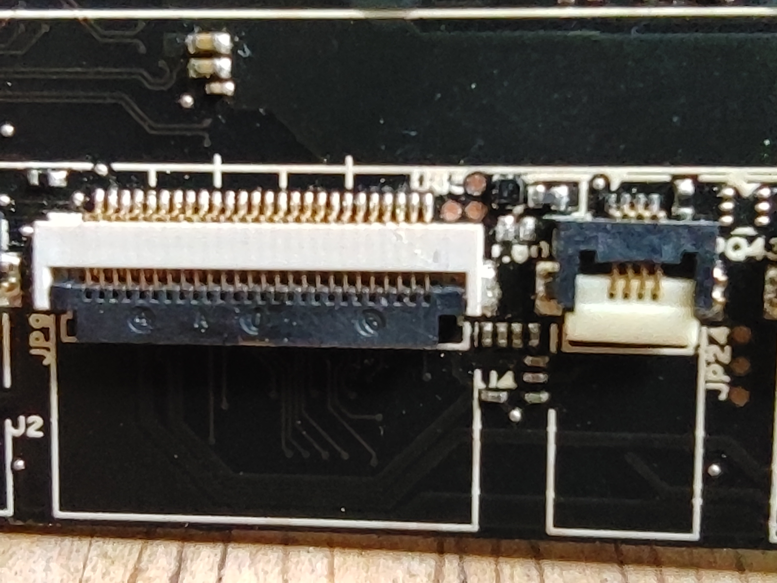

                                        #39
                                        ..post clear and zoomed up pics of the JP9 connector and nearby parts.

                                          #40
                                          Here are the closer look at J9 and the other side of the PCB at J9.
