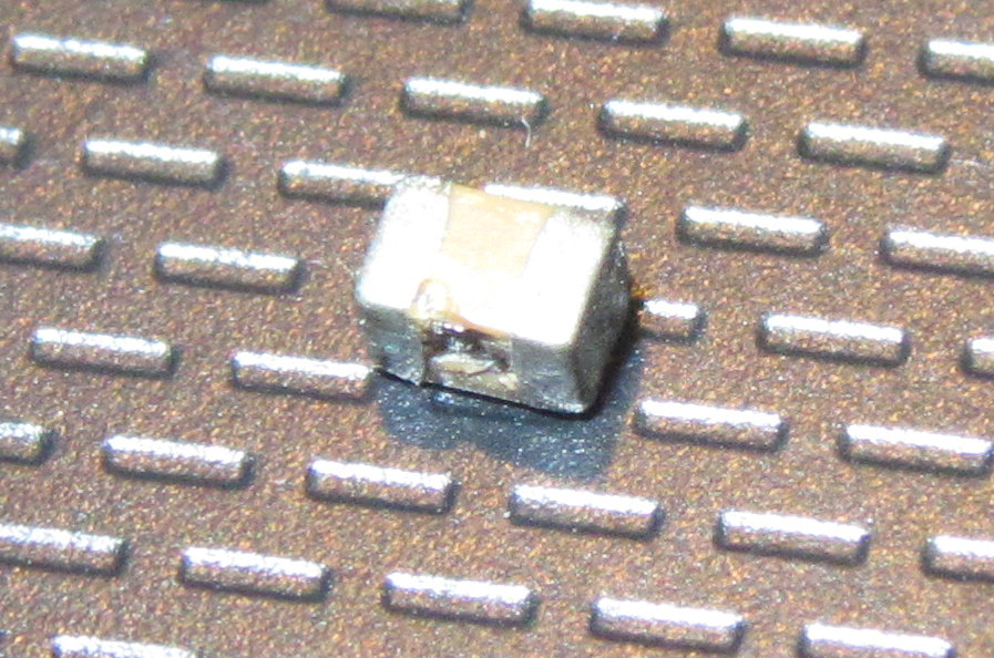

    Have the schematic for this board already, really could do with the boardview because many of the parts are not marked.

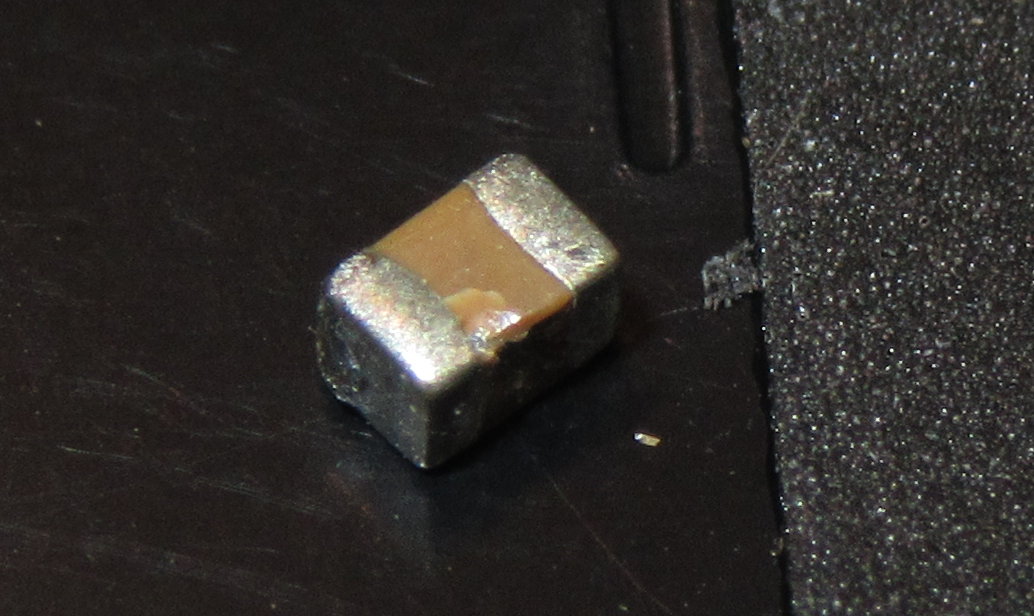

    Well it's all sorted out now, just took an extra hour of messing about in the wrong parts of the board (but close).
    Turns out it was a shorted out 0805 10uF PCB25 or 26 that's on the CHG_B+ net between inductor PLB01 and MOSFET PQB01 ( see sheet 41 of 52 on the schem ).
