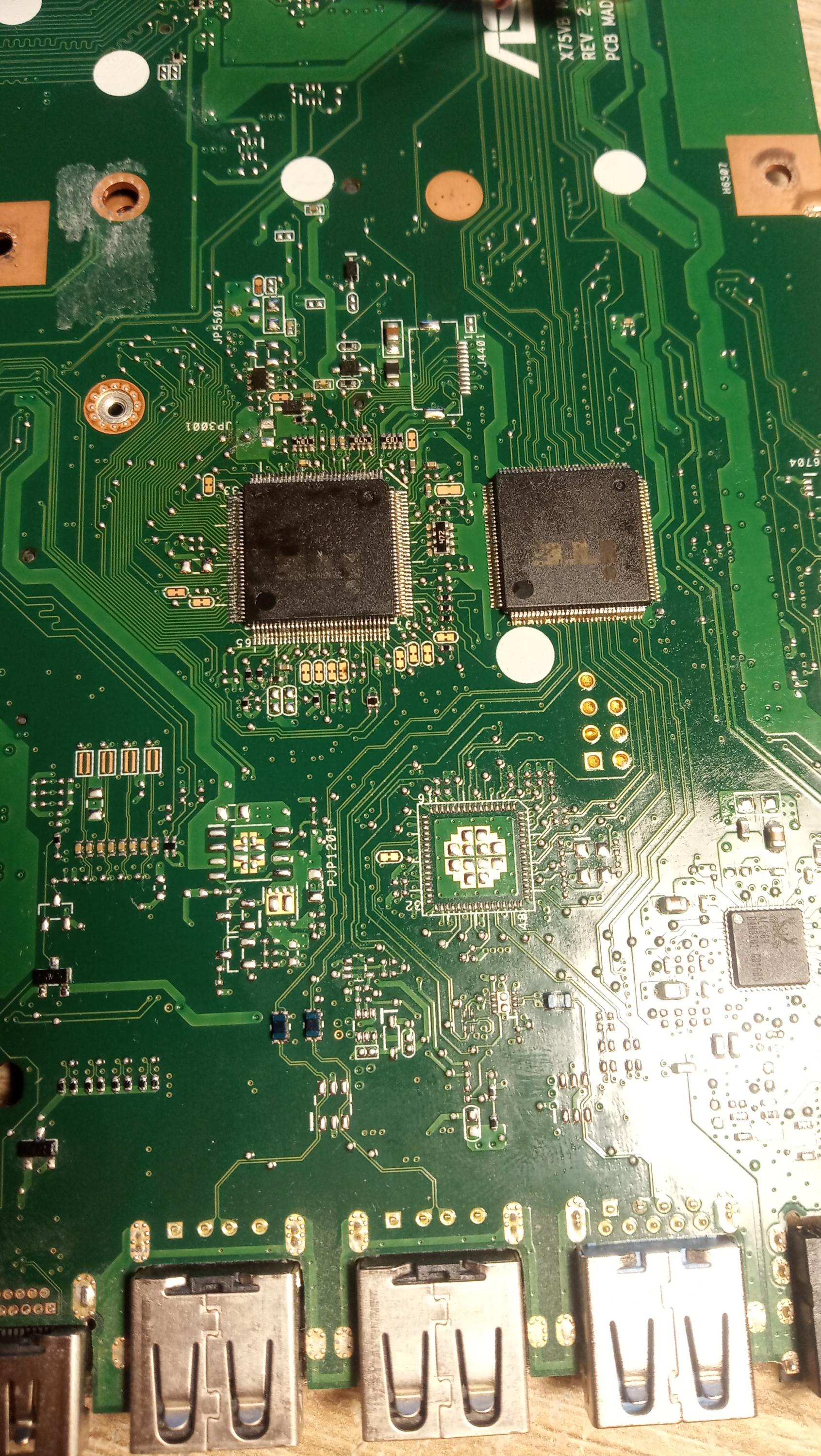

Asus x75vd schematics or boardview, power problems
    Re: Asus x75vd schematics or boardview, power problems
    anyone solved this?i have two boards with exact same problem...ITE chip is overheating when applied 3.3V from external power source...
      i replaced the chip from some HP laptop,the same chip,and again overheating...no shorts anywhere....i have FLIR camera,no heating anywhere else but on this ITE chip.
        Originally posted by ala_borbe View Post
        it was to much to me, send it to another workshop, thay fixed it, no idea what it was
        after it came back, it had bios password so i fixed bios, here is a working file
        tnx all for help
