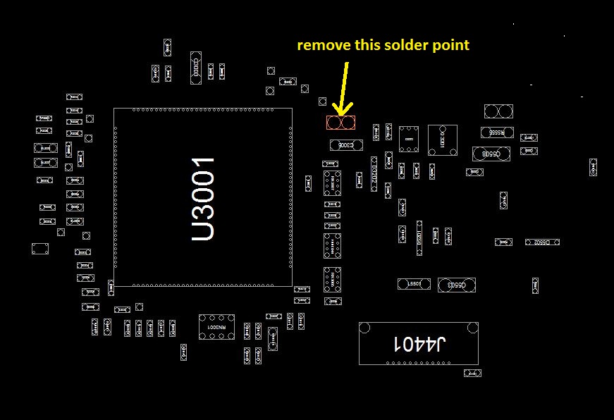

        hi, bro
        RT8206L getting very hot, so ldo voltage is short to ground, check if the ec is shorted,remove pj3001 to isolate kbc.

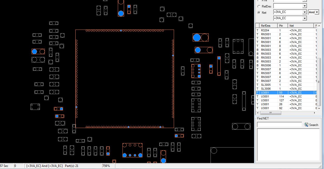

                I have the same problem, RT8206L getting very hot .
                i went cold when remove pj3001 ,
                +3VA_EC is shorted to ground .
                What can i do to continue diagnostic ?
                do i replace EC ?
                thank you

                  Originally posted by delphi_firebird
                  Hello ,
                  do i replace EC ?
                  thank you
                  Did you replace IC to cure short . I get the same fault RT8206L get hot until unsolder pj3001

                          Re: Asus x75vd schematics or boardview, power problems
                          remove jp3001 and check if the short remain
