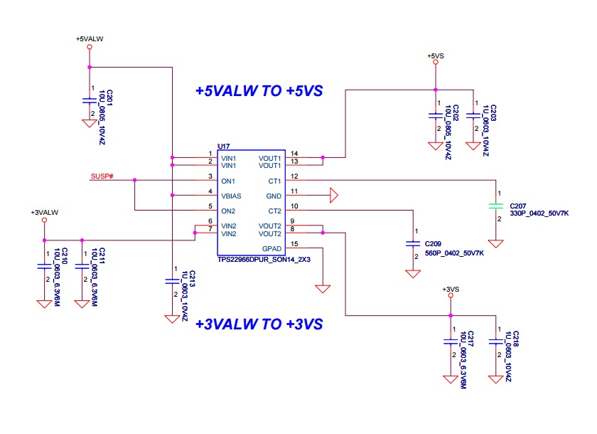

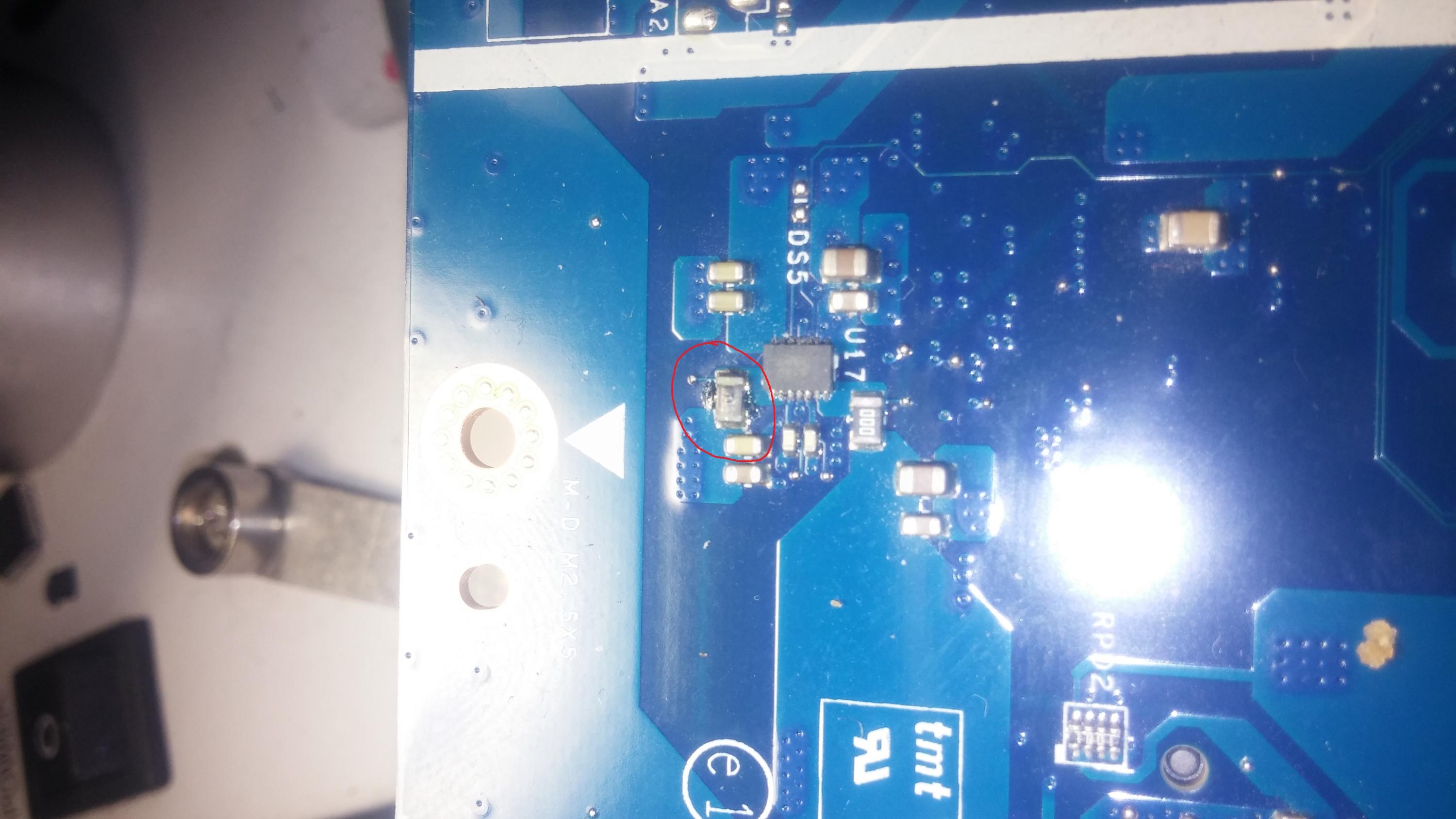

                    Re: need schematic of hp 15 la-a996p
                    Can you help find what is that burned??
                    Laptop not charging the battery but indicator moves ok.
                      Seems like a 0ohm resistor connected between U17's VOUT2 and +3VS, not on the schematics.
                        ok i replaced with 000 resistor.And i changed a mosfet below battery connector and worked. thanks
