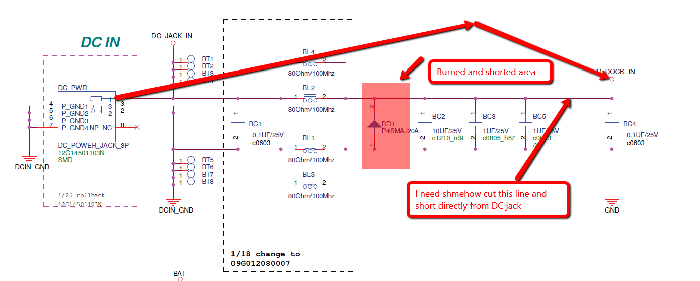

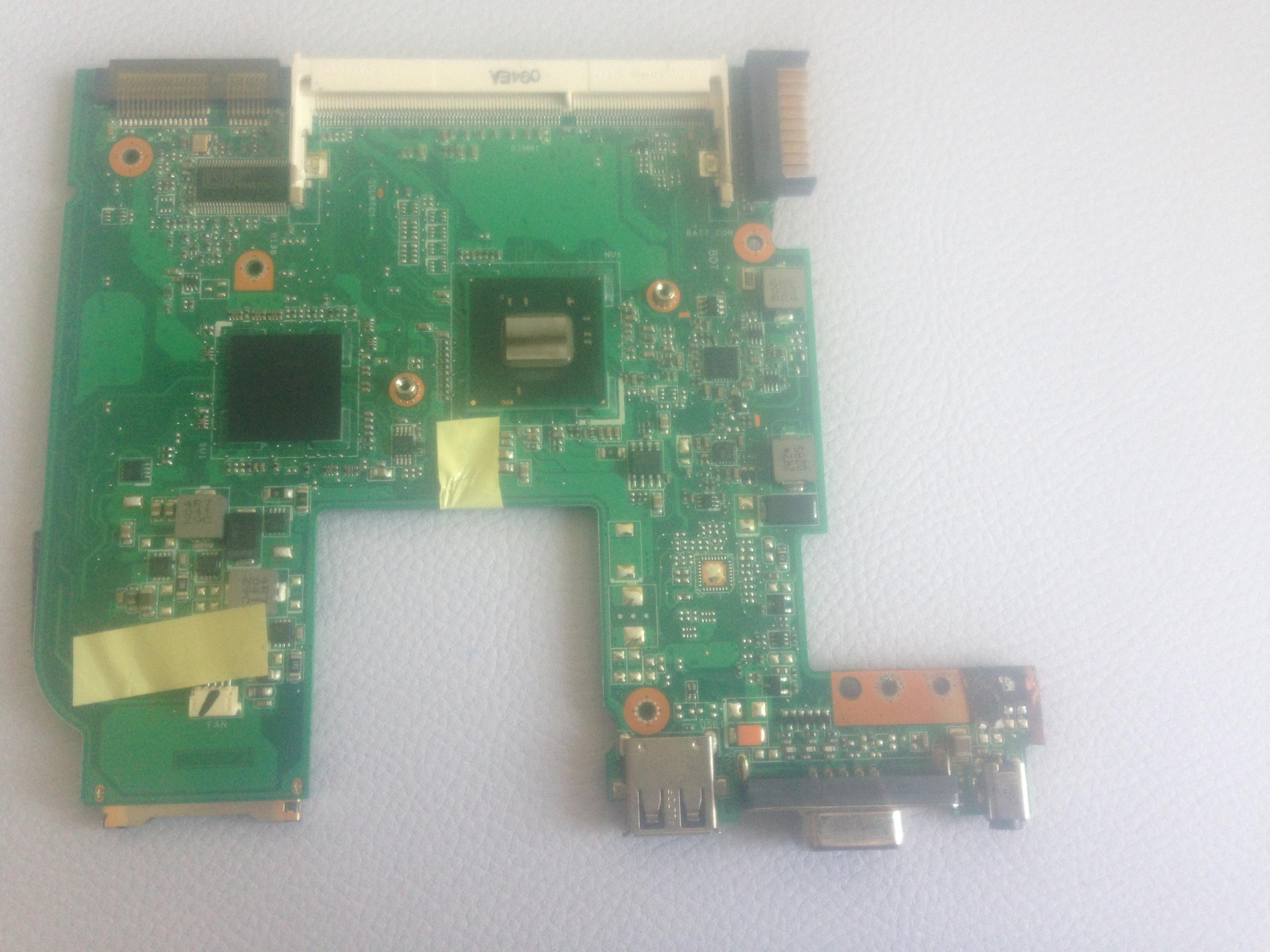

    Asus 1001PXD REV. 1.1. Schematic need
    Hello, i got this little notebook that was burned with defective adapter. I need schematic, please help i cannot find anywhere.

        Re: Asus 1001PXD REV. 1.1. Schematic need
        thank you but it is not the same. Problem is that i do not have letter marker of component on board.

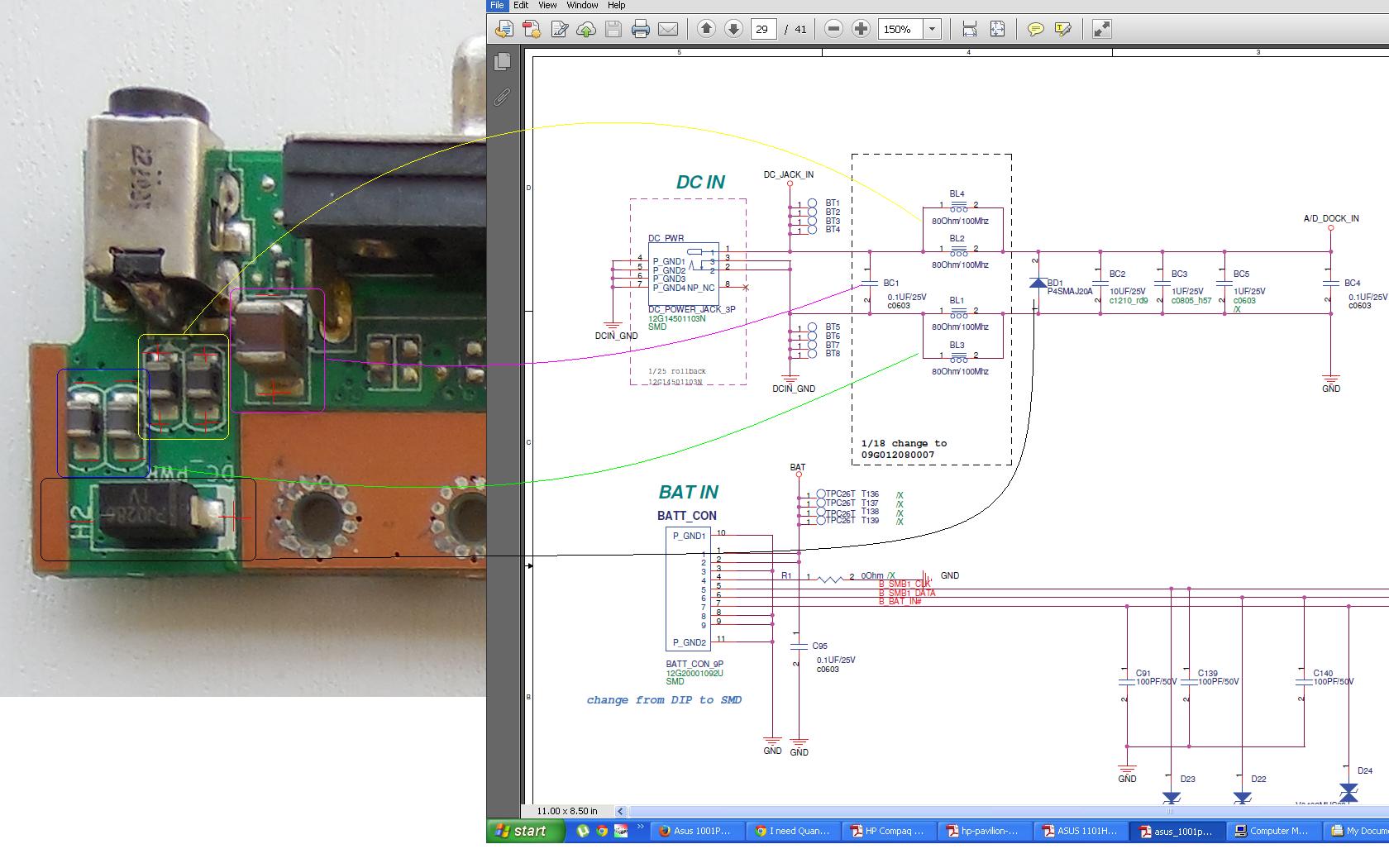

          yes it is the same...clean it well and check for short...a little help:
          Edit: Big capacitor is probably bc2 not bc1

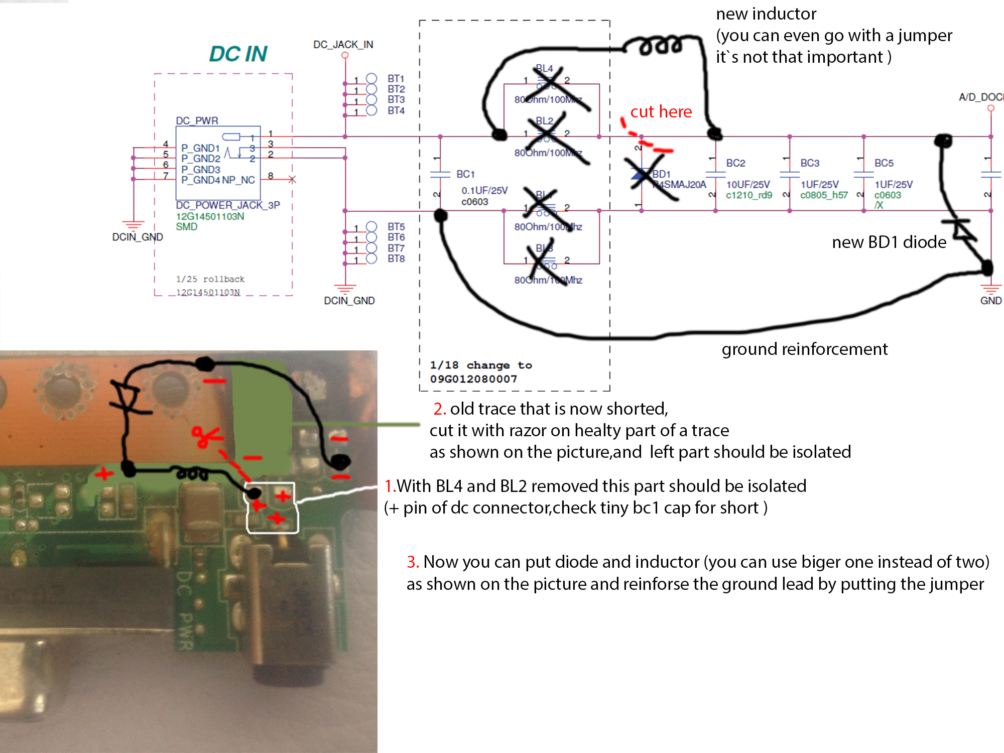

            thank you, i cannot isolate the short circuit that was caused by burning (layer has been shorted)
            How can i isolate the damaged area?
              i gave my best but i am awful at drawing on pc...check other side of board for any shorts after doing this :
                  thank you all, but i have problem with cutting PCB, i cut it but still i have shortage.
                  It is difficult to cut multi layer board.
                  Any other idea that do not need cut PCB, please.
                    You have to cut,use razor blade to make a light cut on a trace then peel it off a little bit ,just pull it away for a few mm untill there is no short...Its not that hard...Don`t go all the way trough pcb...Second level is usually ground so we want to avoid that...Also check another side of pcb behind burned diode...Check for short and make necessary cuts...
