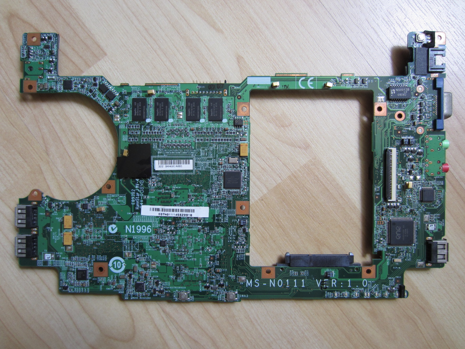

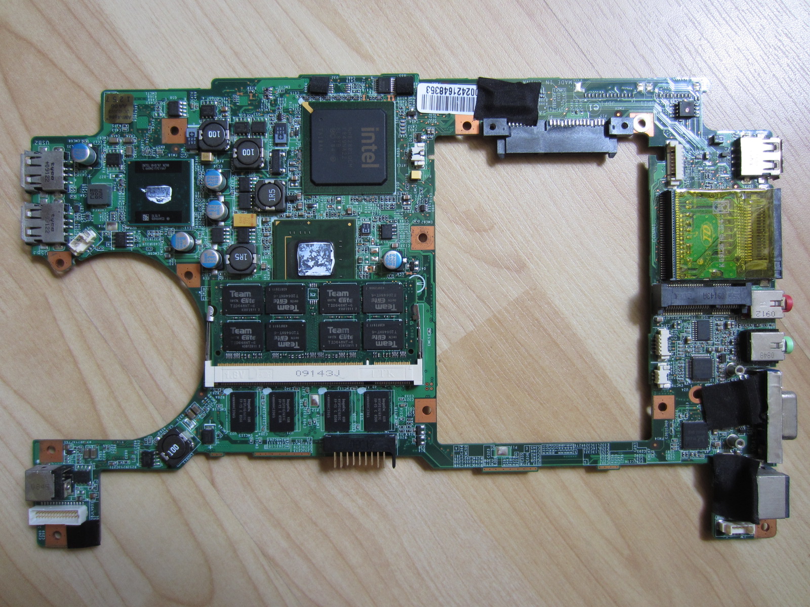

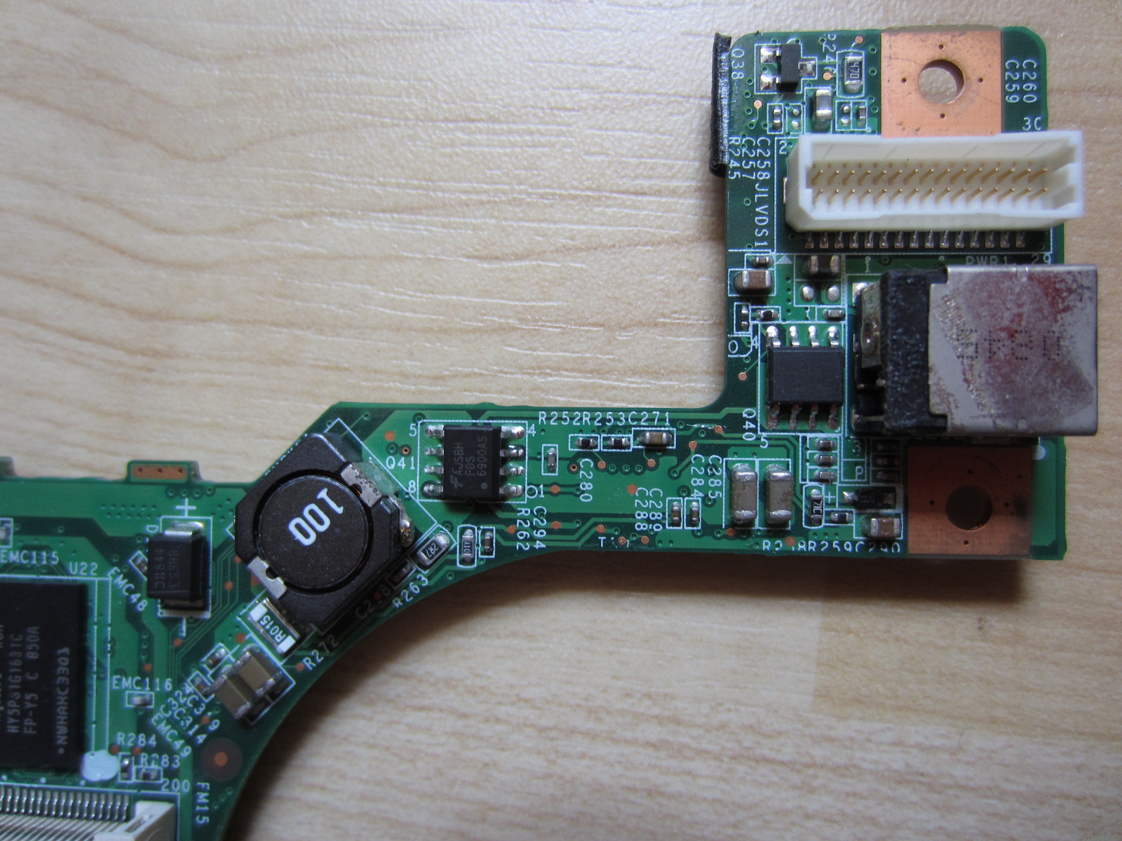

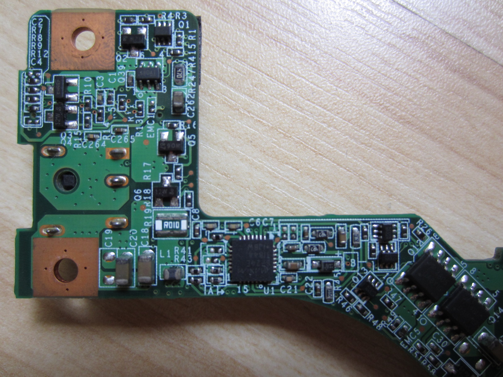

    I have a MSI U100 Plus notebook, after using it for like 30 mins it just black out.
    I can smell something burn coming from the netbook.
    It cannot be powered on now.
    Upon opening up the netbook, all components near the power jack seems ok to me.
    Using a meter to measure for short but none can be found.
    Measuring the voltage (20VDC) in at the power jack seems not stable. it fluctuate between 5 to 1 volts.
    The board area near to the power jack feel warm after 2 mins after plugging in.
    Mainboard model is MS-N0111 ver 1.0
    I have the schematics for this board model.
    I 'm lost as to how to continue to troubleshoot next.

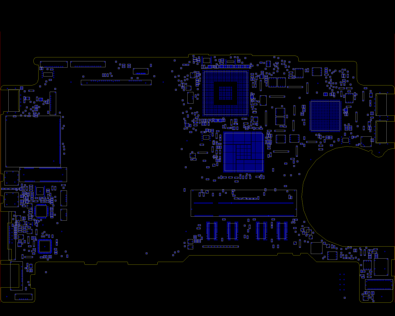

    Anybody have the boardview for this model?
    Anybody have this similar issue with me before can share how you resolve it.
    Thanks.
    Attached photos of board.

      The mosfet Q40 AO4413 feel hot, when the 20VDC plug in to the jack.
        Please post resistance between DC_IN+ and GND.

              Re: MSI U100 Plus No power after using for 30 mins.
                What could be faulty?
                How to test mosfet Q40 if it working good...
                        • Compute
                          Master
                          • Oct 2014
                          • 97
                          • Russia
                          i have
                          • Compute
                            Master
                            • Oct 2014
                            • 97
                            • Russia
                            MSI MS-N0111 Boardview
                            • Ramee
                              • Jul 2014
                              • 218
                              • Israel
                              Thanks compute!
