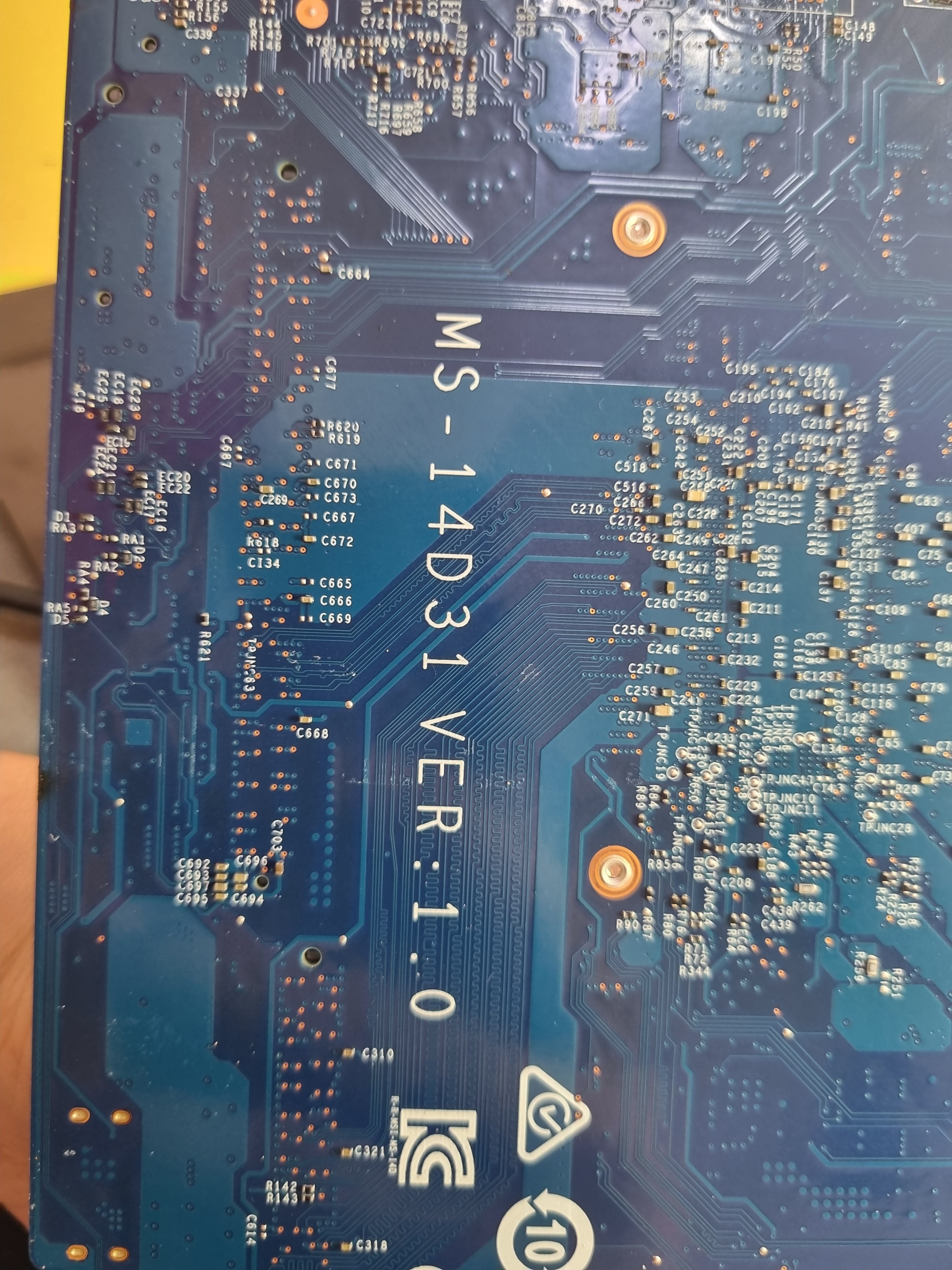

Request for the schematic of MSI MS-14D31 Ver 1.0
  • ngodatvd5
    • Jan 2021
    • 20
    • viet nam
    I am looking for the schematic or boardview for this motherboard or a motherboard using the same EC ENE 9548G. Thank you for your support.

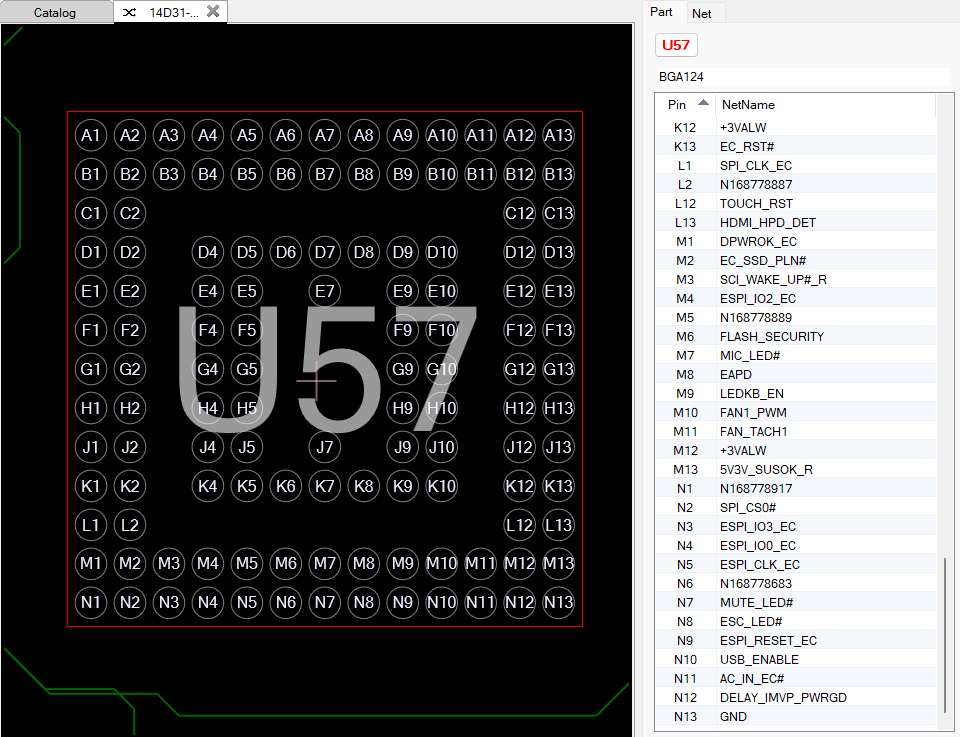

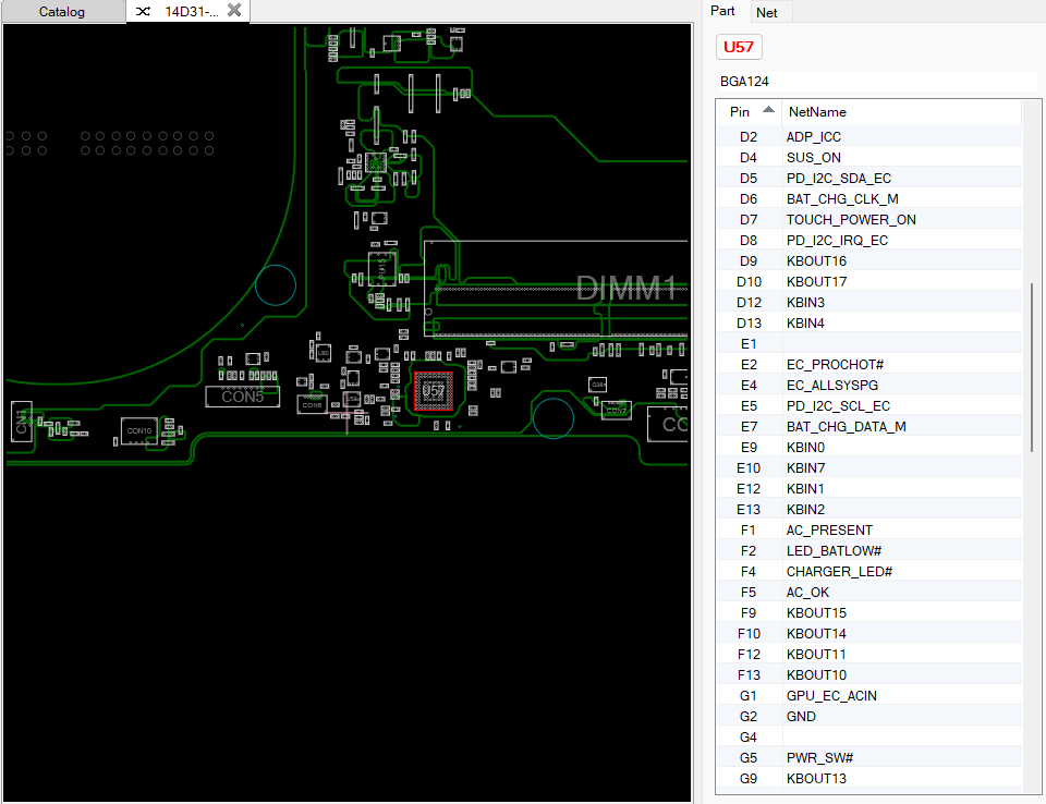

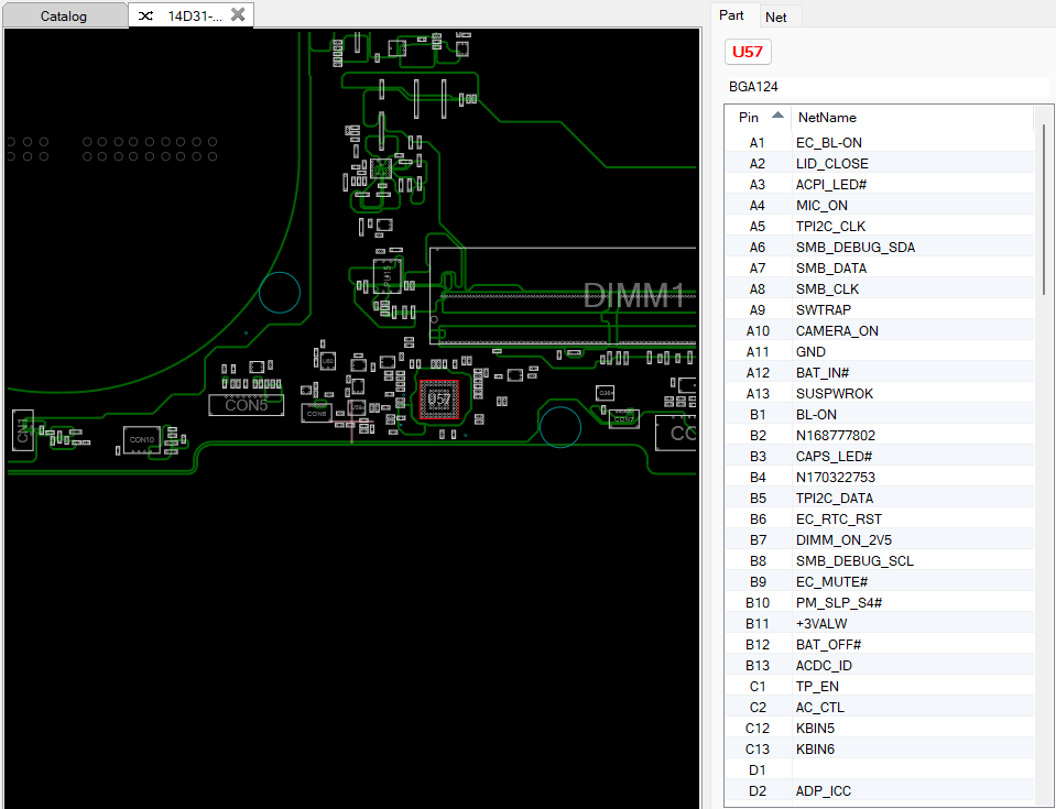

    U57 PENDING 2023/5/22 PROCUREMENT REQUEST,CHIP,I/O,ENE/KB9548G F,,VFBGA-124Pin,K/B CONTROLLER,HALOGEN FREE Click image for larger version
ID:	3545972 Click image for larger version
ID:	3545973 Click image for larger version
ID:	3545974 Click image for larger version
