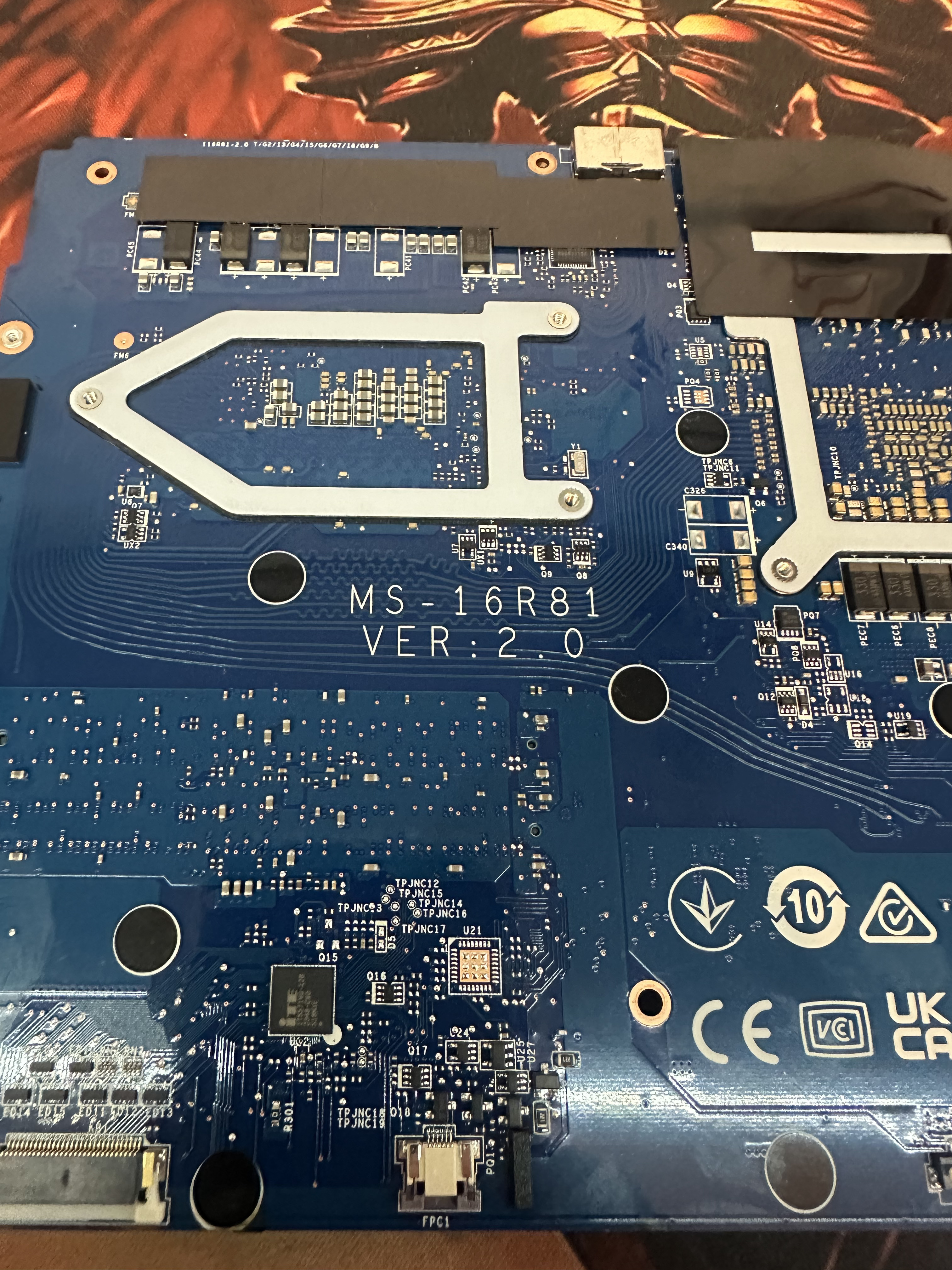

    Originally posted by madfreak

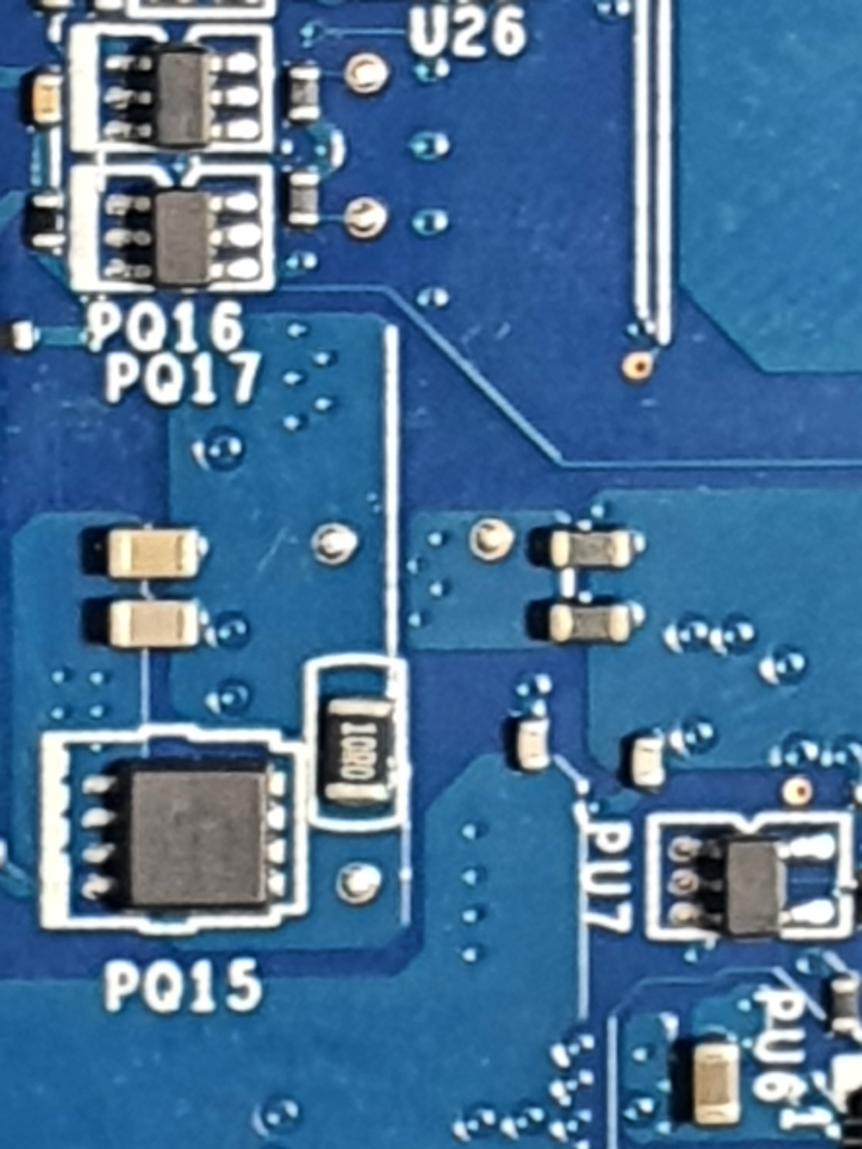

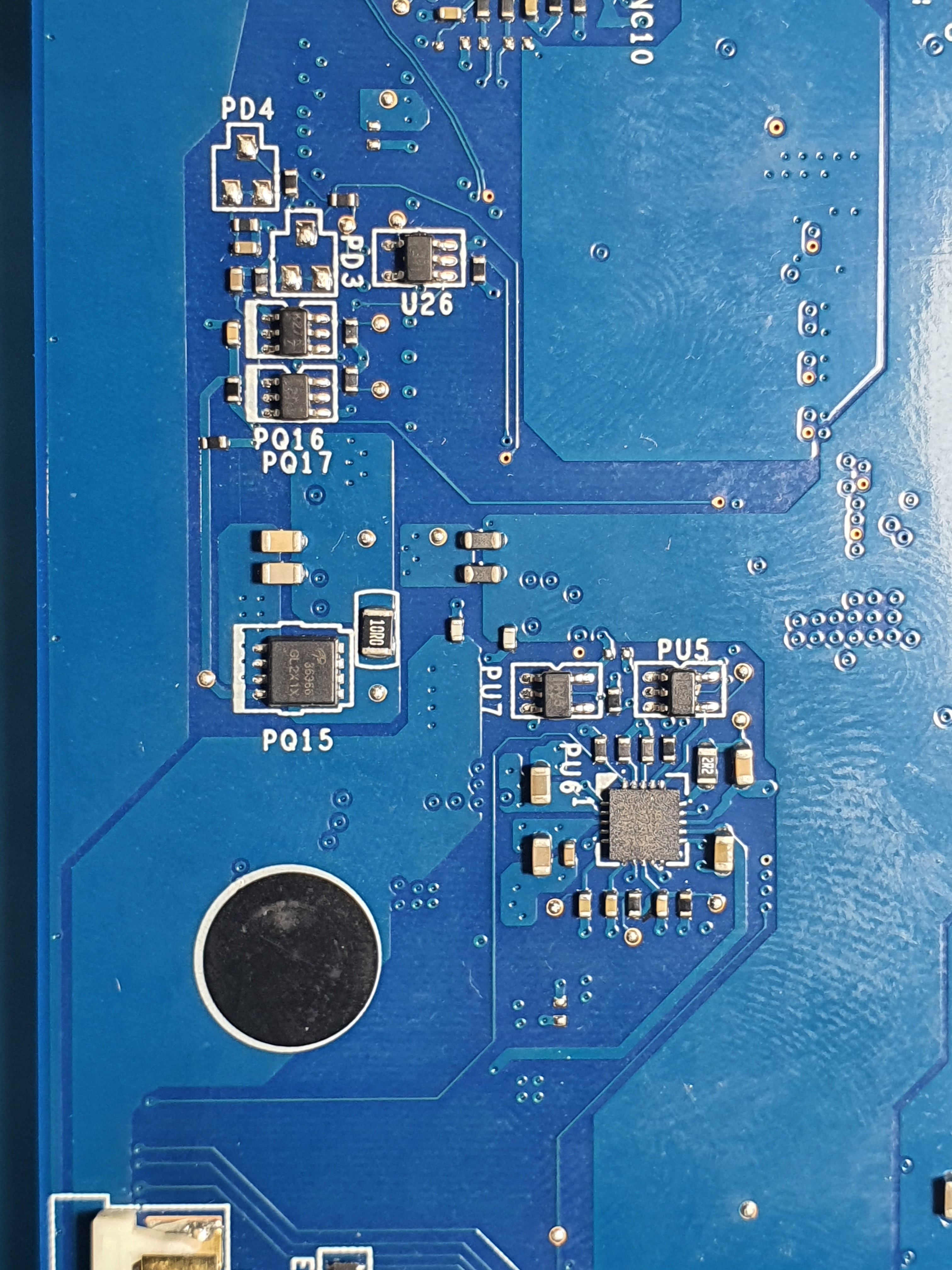

    Hello dear all friends. Can anyone please tell me what is a IC chip PU29 on MS-16R81 VER:2.0​ board it has BFCP marking on it ? I will be truly appreciated
    post pictures of both sides of the IC
    • madfreak
      • Aug 2012
      • 135
      • Poland
      BFCP ( PU29 ) ​ It is similar to BBBJ ( PU18 ) chip and it is close to that chip on that board. - I've marked it with a yellow arrow on last picture
        IC CONVERTOR,MPS/MP1613GTL-Z,SOT583-8pin,3A SYNCHRONOUS STEP-DOWN CONVERTER WITH SS & PG,HALOGEN FREE
        • madfreak
          • Aug 2012
          • 135
          • Poland
          So the BBBR, BBBJ is the same exact chip so as the a BFCP, and those three chips are MPS/MP1613GTL-Z​ ?

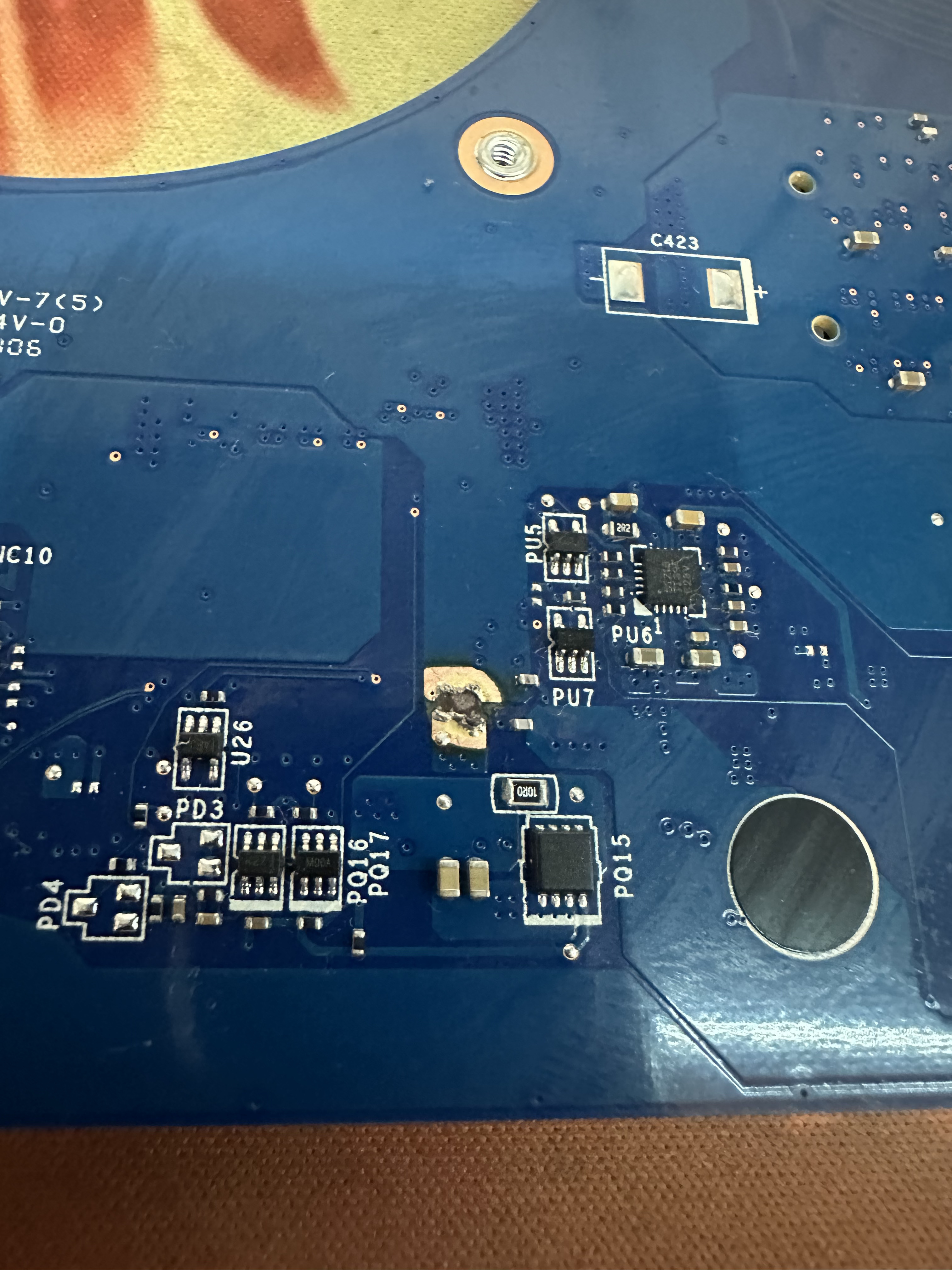

            noname2024 Please help. The marked places are vias, which are corroded by the liquid on the other side. I need to know what these signals are and where they lead to, so that I can eventually pull up a new line.
              try

                  Thanks to noname2024's help, I know that my processor is working and the values ​​are as follows

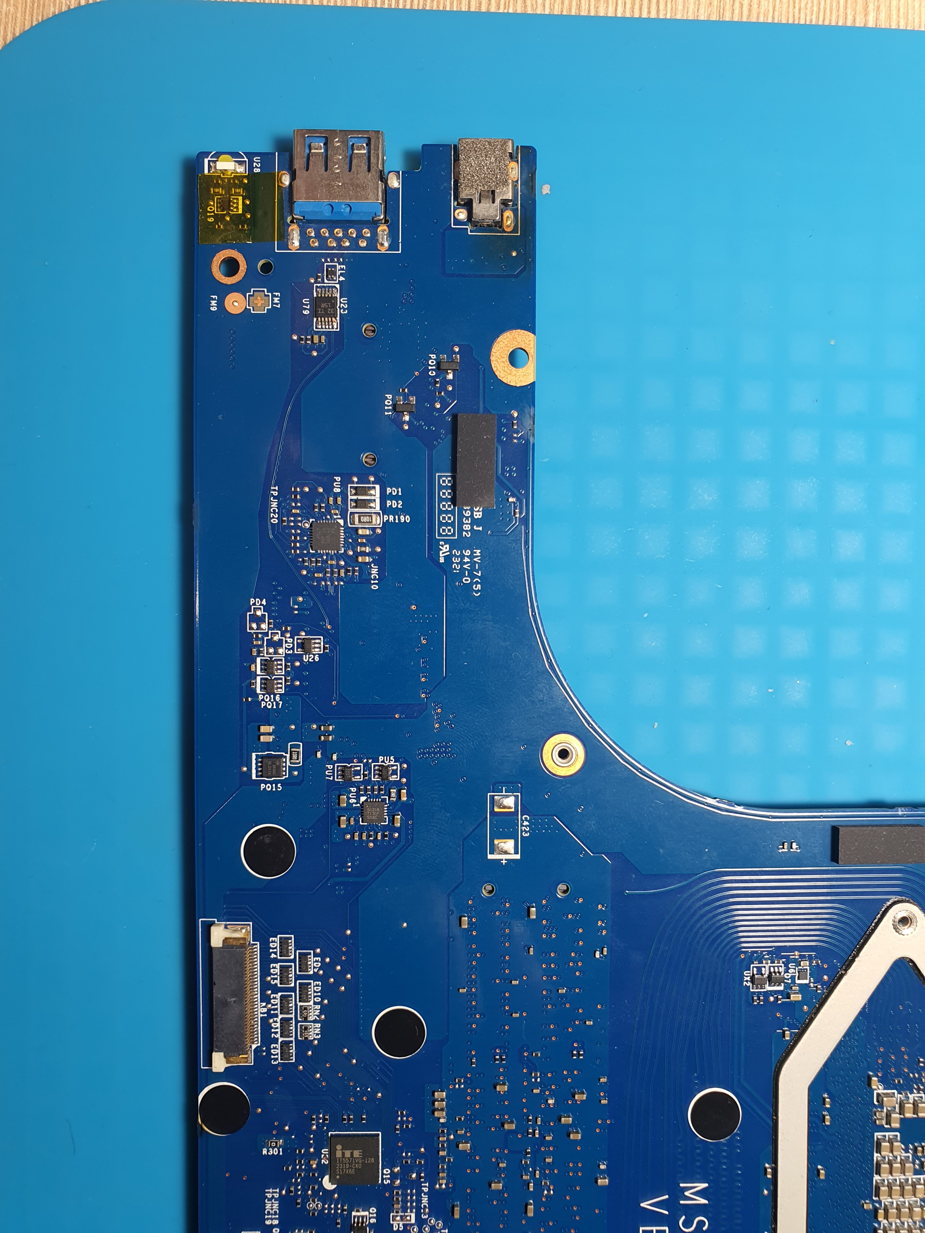

                    Hello all electronic technicians fellow mates ....
                    I have received parts from china and replaced damaged ones, and that chip BFCP is exactly MPS/MP1613GTL-Z so the BBBR is the same, i have received from china BBBN which is still the same chip.

                    Are perfectly fine, and the CPU is ok and survived a short circuit caused by a user when he tried to do a maintenance...but the RTX / graphic card did not survive it and is dead
                    Does anyone know if there is a motherboard modification ( sometimes there is a need to replace resistors ) on schematic to force LCD to display image from integrated GPU/intel rather than from RTX...because that laptop is working perfectly fine but on external monitor ...inbuilt lcd stays black

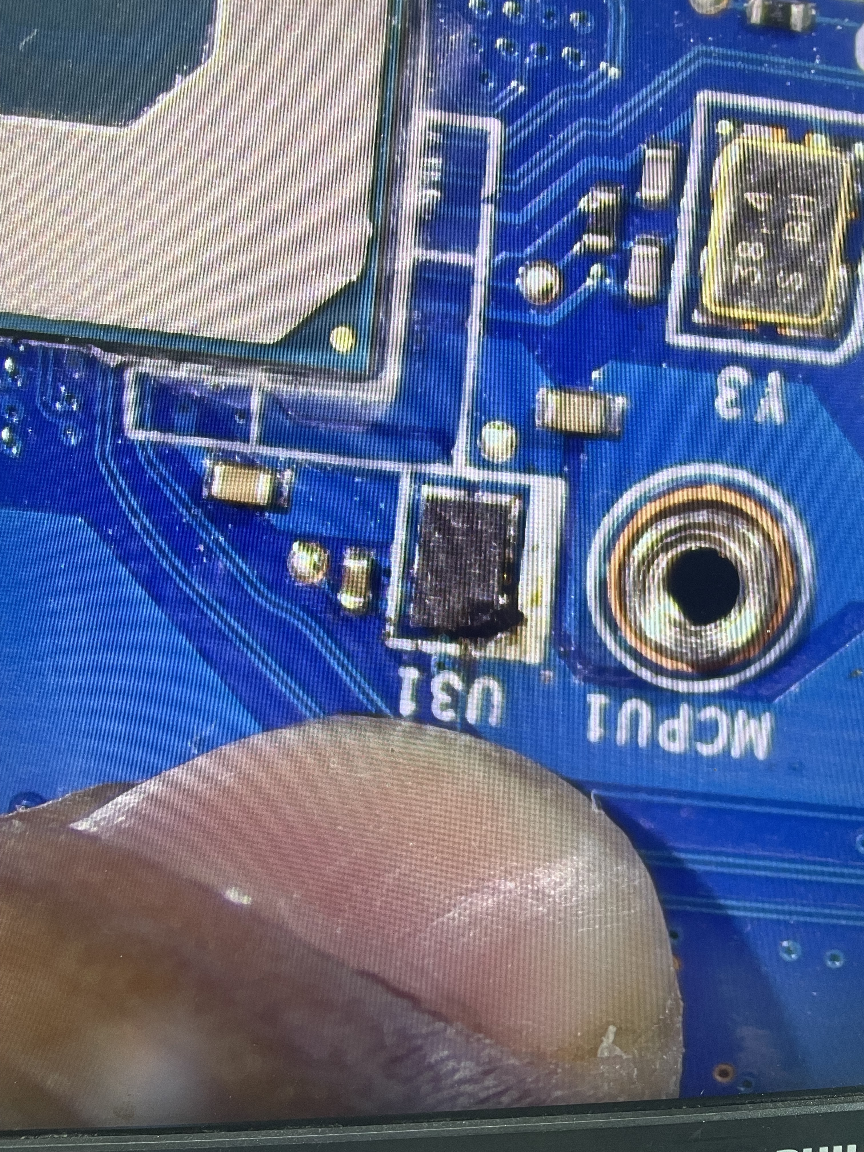

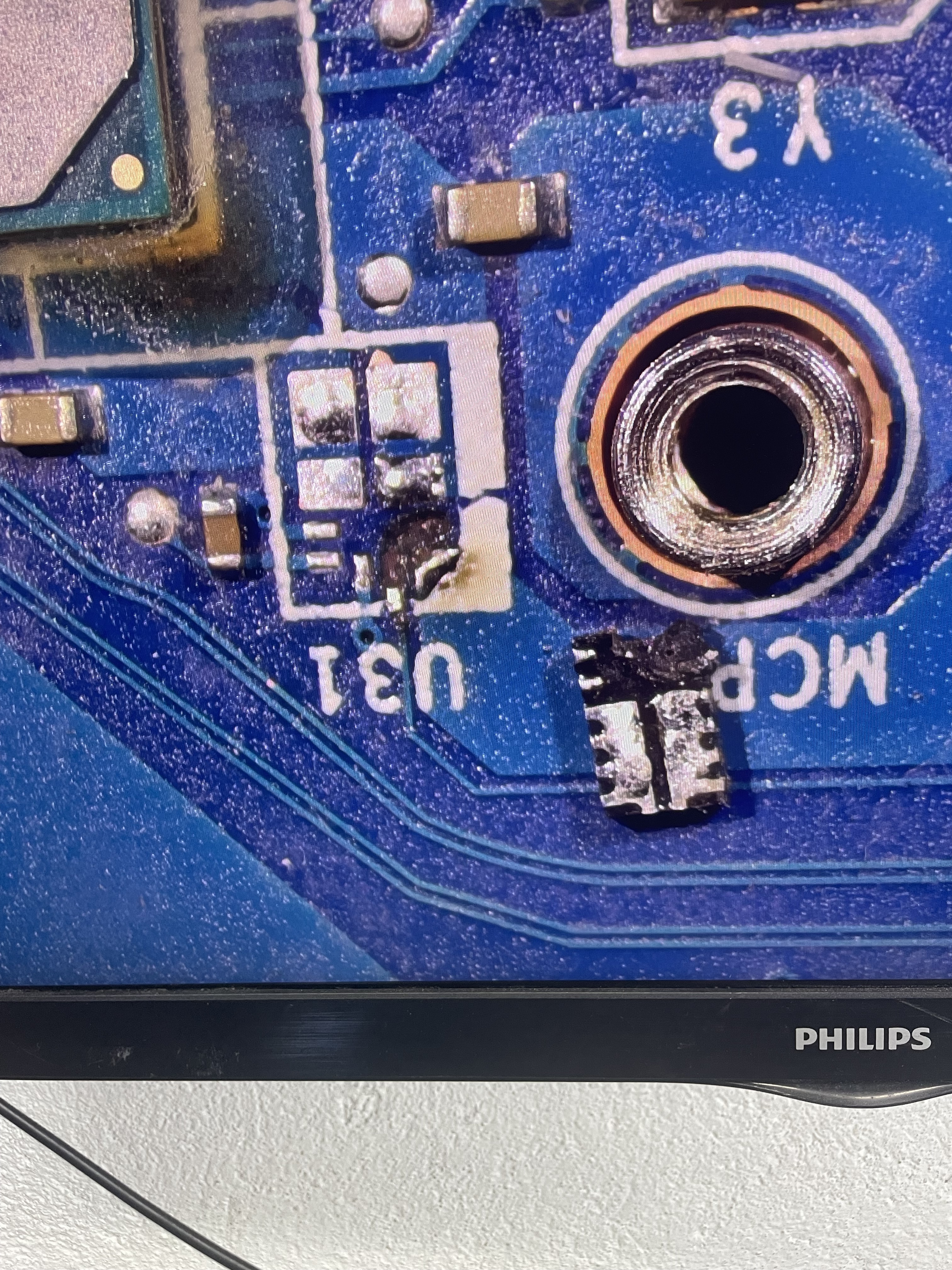

                      Hello friends I'm working on this MSI MS-16R81 V2.0 motherboard and I noticed that there is the U31 chip which shorts the +5 line. I removed it but I couldn't find its datasheet or the schematics of the card to replace the chip. Can anyone help me with the motherboard schematics , boardview or the chip datasheet? Thanks in advance.
                        • 22427
                        #31
                        From the BOM607 spreadsheet https://www.badcaps.net/forum/troubl...07#post3536607 ,it`s SLG5NT1757V

                          #32
                          You are right. Considering that I have already found 3 defective integrated circuits, all powered by the 5V rail, and even 2 faulty Drmos, I really need a boardview to see what other components are powering this 5V rail. I can't find a schematic or a boardview anywhere. I have another question related to these drmos. I have QD9619A on my board and I would like to replace them with SIC651CD but I don't know if they are a good replacement. Thanks.

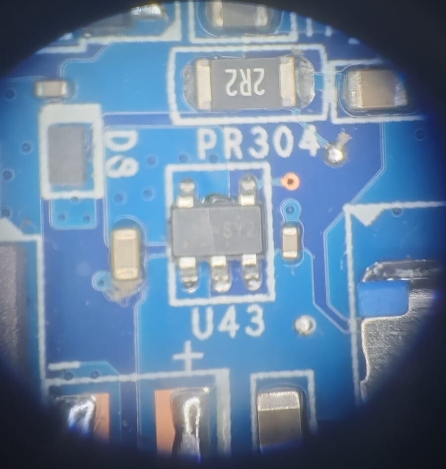

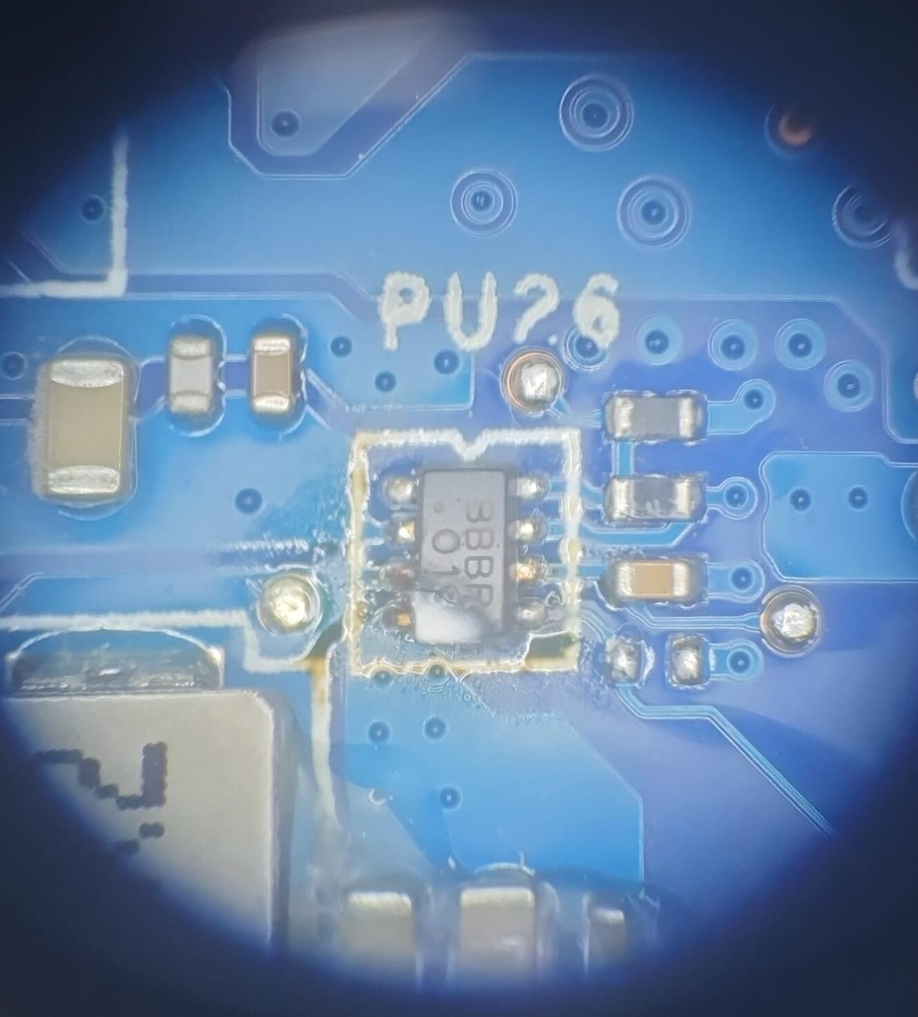

                            hi everyone. can anybody tell me what is PU26 and U43 in this mainboard, or please upload boardview if possible. thanks anyway
                              Read the BOM file, it lists all parts - https://www.badcaps.net/forum/troubl...07#post3536607
                              • yumbo_
                                • Jan 2023
                                • 2
                                • España
                                #35
                                Thanks a lot.

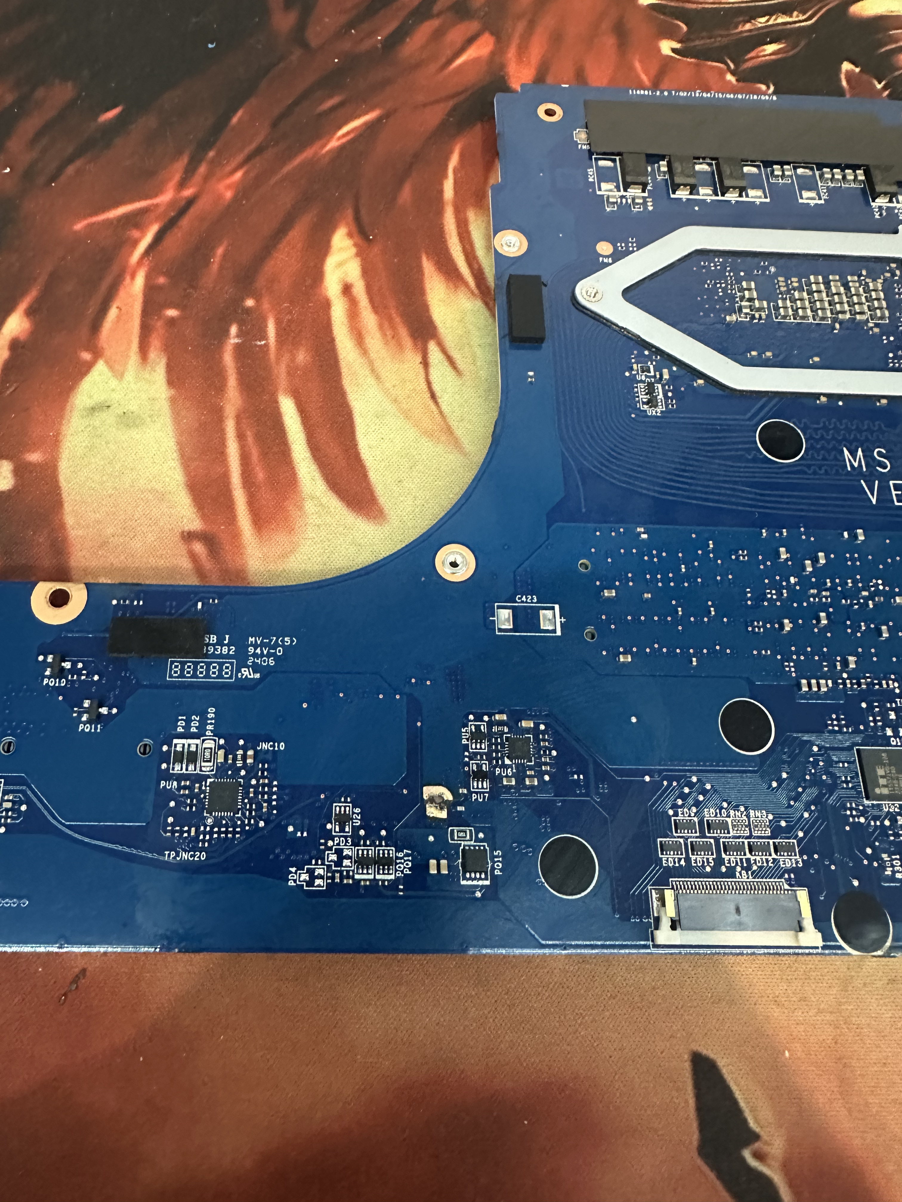

                                  Hi, can anyone help me with the ms-16r81 v2 motherboard. I cant find a boardview so im looking for a component that has blown on the display circuit. The part isnt silk screened and blown that bad that i cant recognise it. if anyone can tell me the component or has a photo of the underside of the board it would be much appreciated. Click image for larger version
ID:	3704192 Click image for larger version
ID:	3704193 Click image for larger version
                                    Hi, there are just two inductors. Have a nice day

                                          #40
                                          pu24
