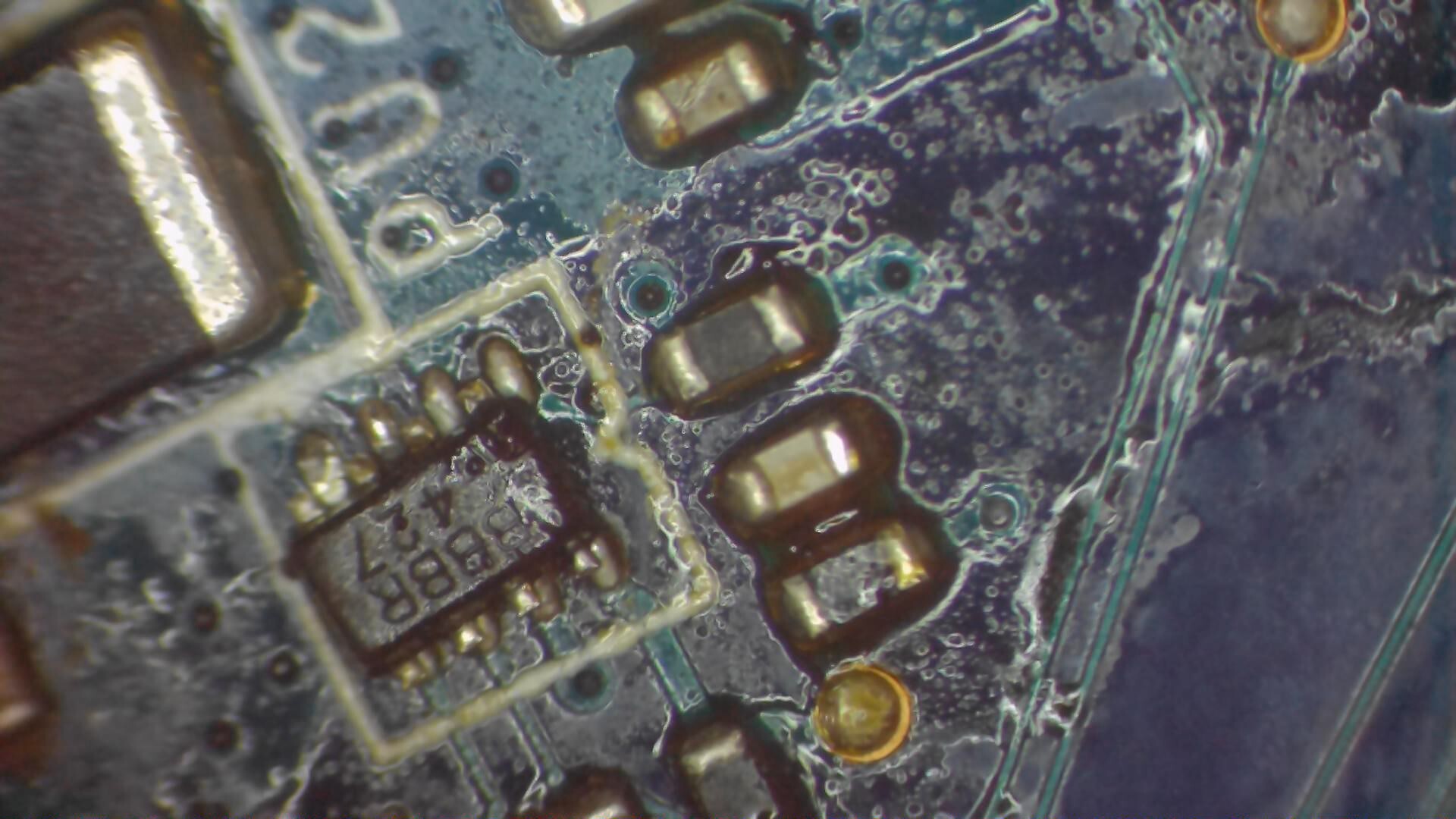

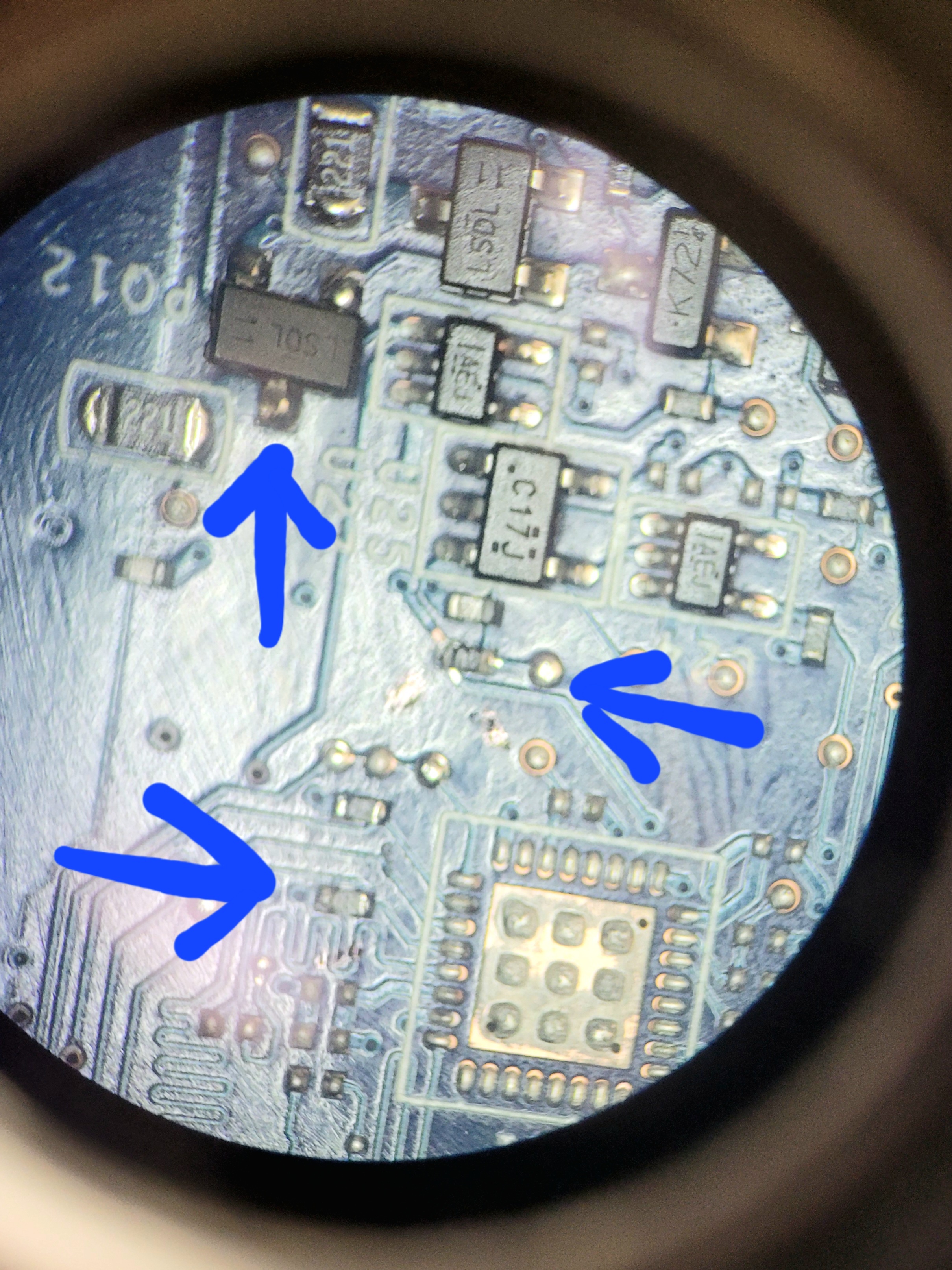

                            Hello i have exact the same motherboard MSI GF63 12UC-658GR MS-16R81 VER:2.0
                            ​ with liquid damage. CAN you also recognize please chip PQ12 with broken leg (LSDL 11) and two resistors. i have arrow on image
                            Thanks in advance

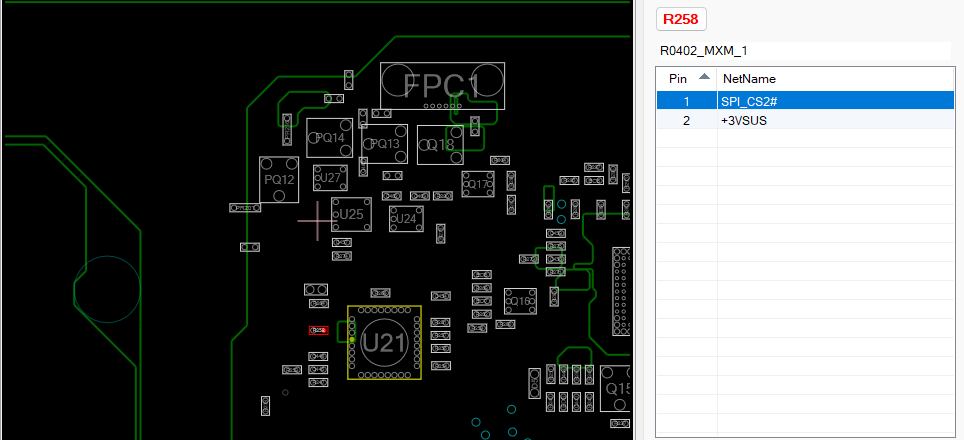

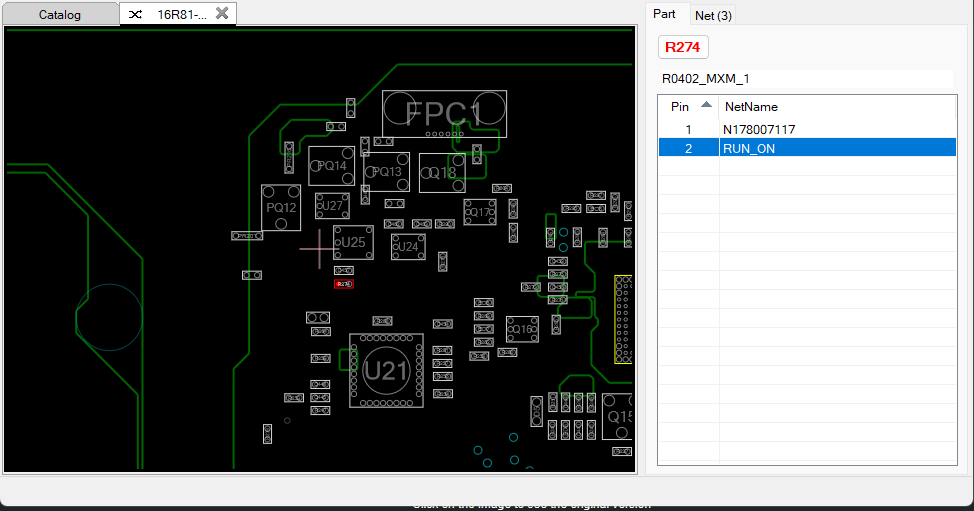

                              Thanks in advance
                              PQ12 ,DIS MOSFET-N,Sinopower/SM2304NSAC-TRG,SOT23-3pin,5.1A,30V,+/-20V,35mOhm(4.5V/5A)/25mOhm(10V/8A),1.3V,1.8V,2.5V,410pF,,4nC,,HALOGEN FREE- OR DIS MOSFET-N,ALPHA & OMEGA/AOSS32334C,SOT23-3pin,6.2A,30V,+/-20V,26mOhm(4.5V/5.5A)/20mOhm(10V/6.2A),1.3V,1.8V,2.3V,600pF,,12nC,20nC,HALOGEN FREE
                              R274 RESISTOR,68.1KOhm,1%,1/16W,0402,HALOGEN FREE
                              R258 RESISTOR,10KOhm,5%,1/16W,0402,HALOGEN FREE Click image for larger version
