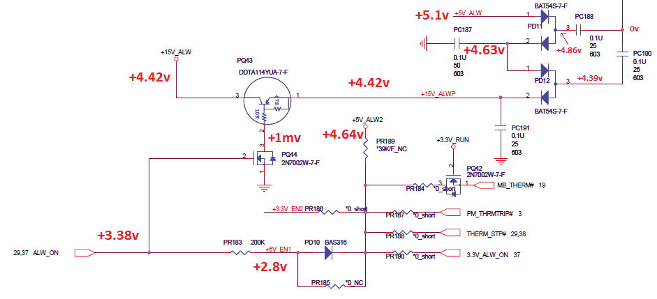

    +15v_alw is absent why? on page 46
    ICH_RSMRST+ is 0v goes to 3v when power button is pressed then again goes to 0v in 1/2 second
    SIO_SLP_S5# goes from 0v to 1v then again 0v
    please reply!

        After pressing power button several times. Motherboard turned on but the CPU fan was not spinning. CPU heatsink was getting hot. No display.

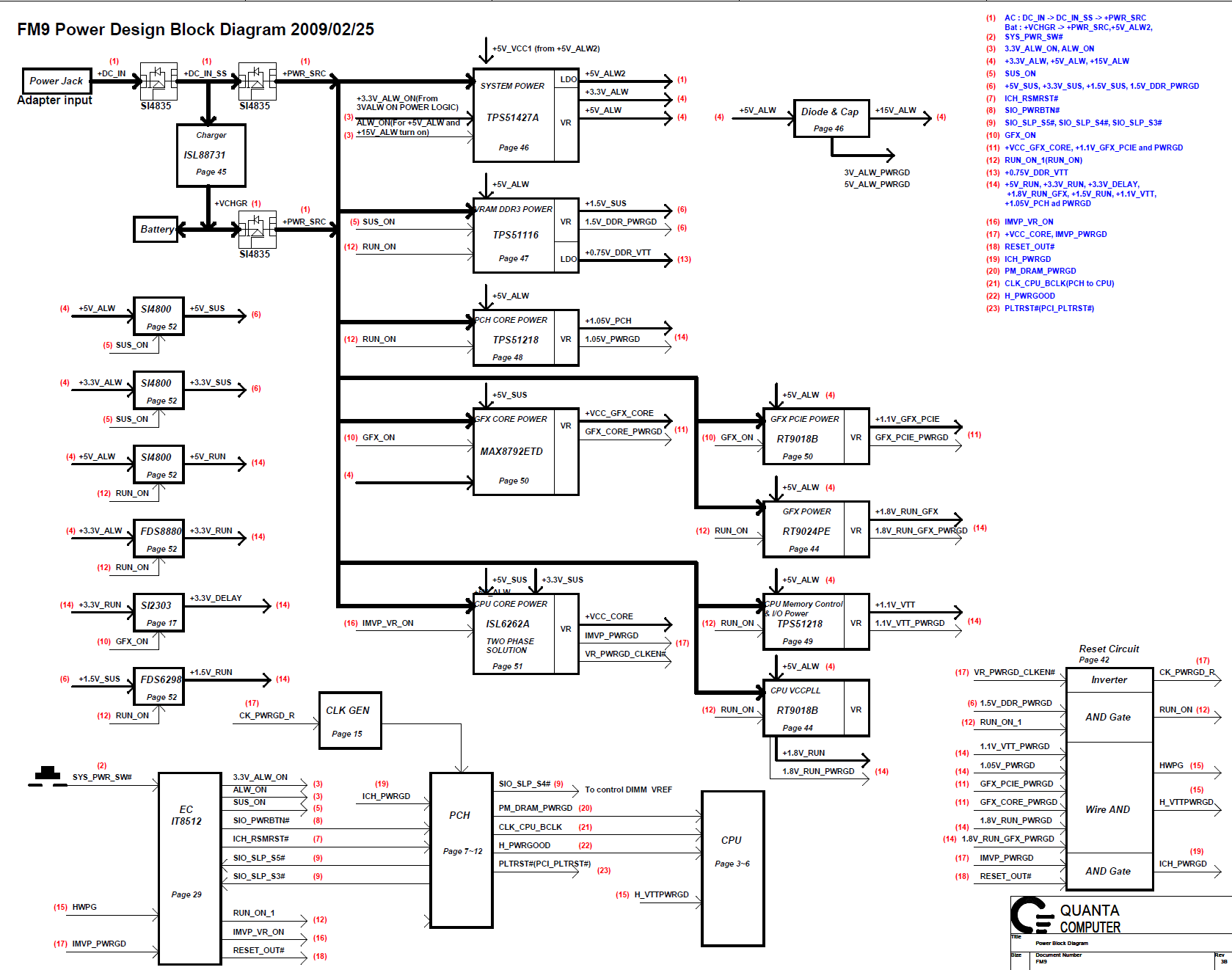

        +3.3v_alw-> coil PL9
        +5v_alw -> coil PL10
        +5v_alw2 ->TPS51427a LDO pin 7
        +15v_alw--is only 13.1v PQ43 page 46
        +3.3v RTC
        +5v_RUN -> PQ14
        +3.3_SUS -> PQ15
        +5v_SUS -> PQ17
        +3.3v_RUN -> PQ22
        +3.3v_DELAY -> R424 Page 17
        +1.5V_RUN -> PQ11
        ALL PRESENT
        RSMRST 3.3V ->ITE8502E pin 80
        i will check gfx voltage and CPU Voltage and post the results.

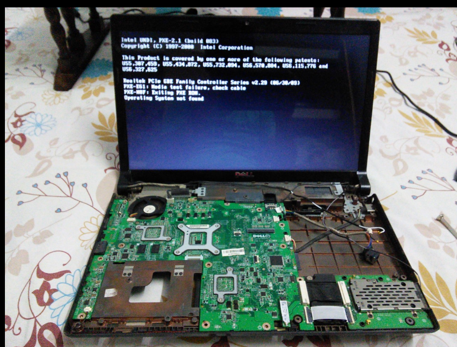

            Finally success
            laptop turned on with display and all features

                  Thank you for schematic of this laptop. I've managed to fix my laptop using it.
                  In my laptop the similar problem was related to faulty GPU temperature reading by ADM1032ARMZ-1 chip. It was blocking the laptop from start.
