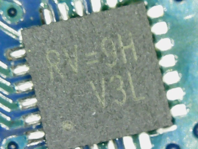

          this
            • 21889
            Originally posted by sibernetic
            this
            this ? ,are you asking for help in indentifying what it is
                      I couldn't find the name of the integrated circuit.

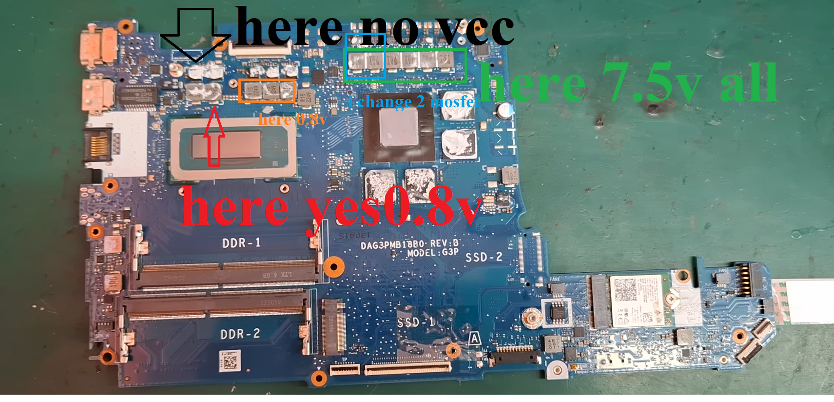

                          Hi, I have this motherboard. The problem is that two MOSFETs on the video card burned out due to water damage. When I replaced them, it worked, but then stopped working. I checked and one of the MOSFETs on the processor isn't active.
                          I'd like to know if it's the processor's integrated graphics.
                          The motherboard turns on but doesn't provide video. I've already reprogrammed the BIOS and it doesn't work. Any ideas?

                            Please check short circuit on deidcated gpu first, there should be 0.7 -1 volt instead 7.5 Volt. There must be problem with mosfet from gpu too, OR check all line 16Volt. I have similar problem with graphics card but haven't schematic. but laptop running normally on integrated card. First you must eliminate short circuit on main 16 volt circuit, then laptop should run on integrated, Thanks. Eventually if deidcated GPU is short then you have to remove all mosfet, cut off. rtx4060 have about 1.2 ohms normally(so it depend on your model gpu) if ohms is 0-0.5 ohms then it must be short. overall only thermal camera can help in next step.
