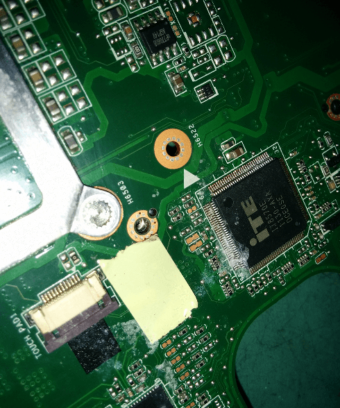

                Asus K42F schematic
                Please schematic for Asus K42F Rev. 3.3 Intel.
                I already have Rev. 1 which do not match with mainboard.
                • dspok
                  • Jan 2014
                  • 553
                  • Nepal
                  Re: Asus K42F
                  Ok, I solved it.
                  Problem was auto on, no display, no fan spin.
                  FAN Pin 1,2,3 grounded, so I changed ITE chip.

                      Re: Asus K42F
                      how could it be possible ? its not connected to ec, there is a fan controller ic before ec. ??
                      • dspok
                        • Jan 2014
                        • 553
                        • Nepal
                        Re: Asus K42F
                        First of all machine wasn't turning on.
                        I Cleaned ITE chip, now laptop was auto on if power jack is plugged.
                        Both FAN0_PWM FAN0_TACH were grounded.
