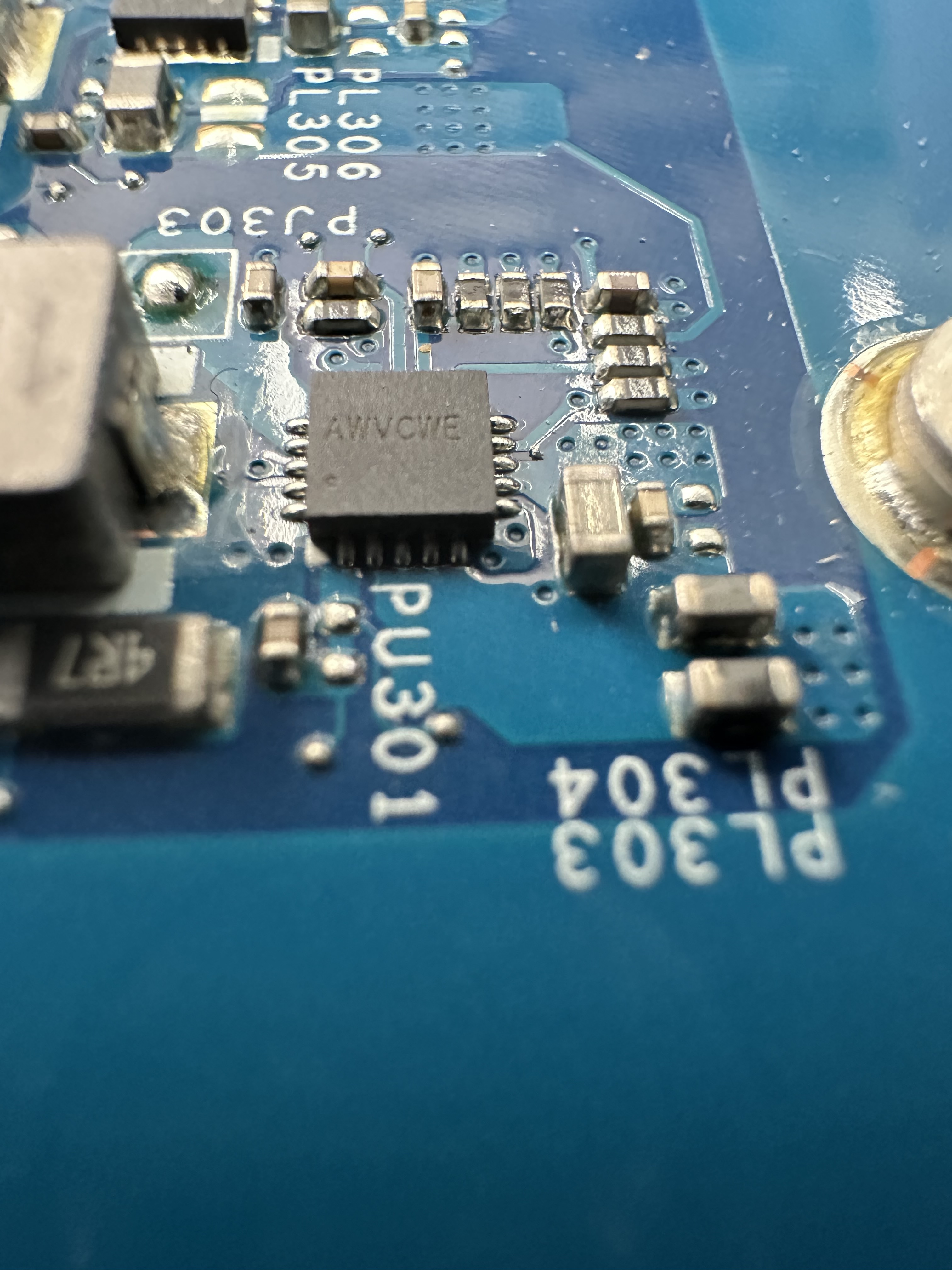

    I need HP 255 G8 (LA-L021P) schematic.
    Hi, I need schematic for this laptop. If there is boardview included would be much better. Thank you.
    The AWVCWE chip in the picture is damaged, can you tell me which chip to replace it with?

    • 21983
    Silergy https://www.badcaps.net/forum/troubl...ts#post1538202

      Hello, I am new here and I am looking for schematic of HP 255 G8 (LA-L021P) too. Friend of mine probably shorted some pins on eDP connector while changing LCD with connected battery. Since then the backlight does not work. There is no 19 V on eDP connector. It's thr only one I can find the pinout for.
      I am familiar with electronics but it's quite difficult to repair it without schematic. Any help will be appreciated.

          Probubly SY8286BRAC
