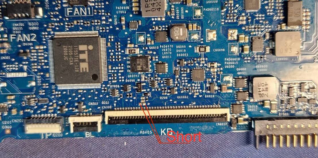

      I need help testing this board with or without a schematic. The power button is built into keyboard. How do I turn on this motherboard.
        short the two test point to start

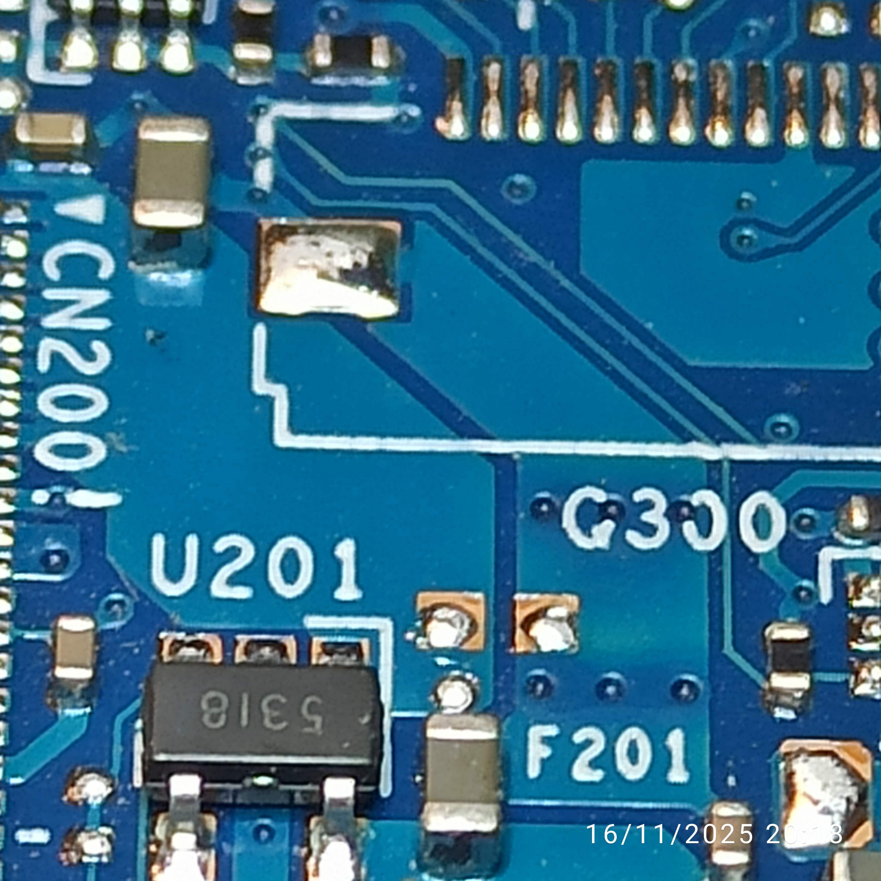

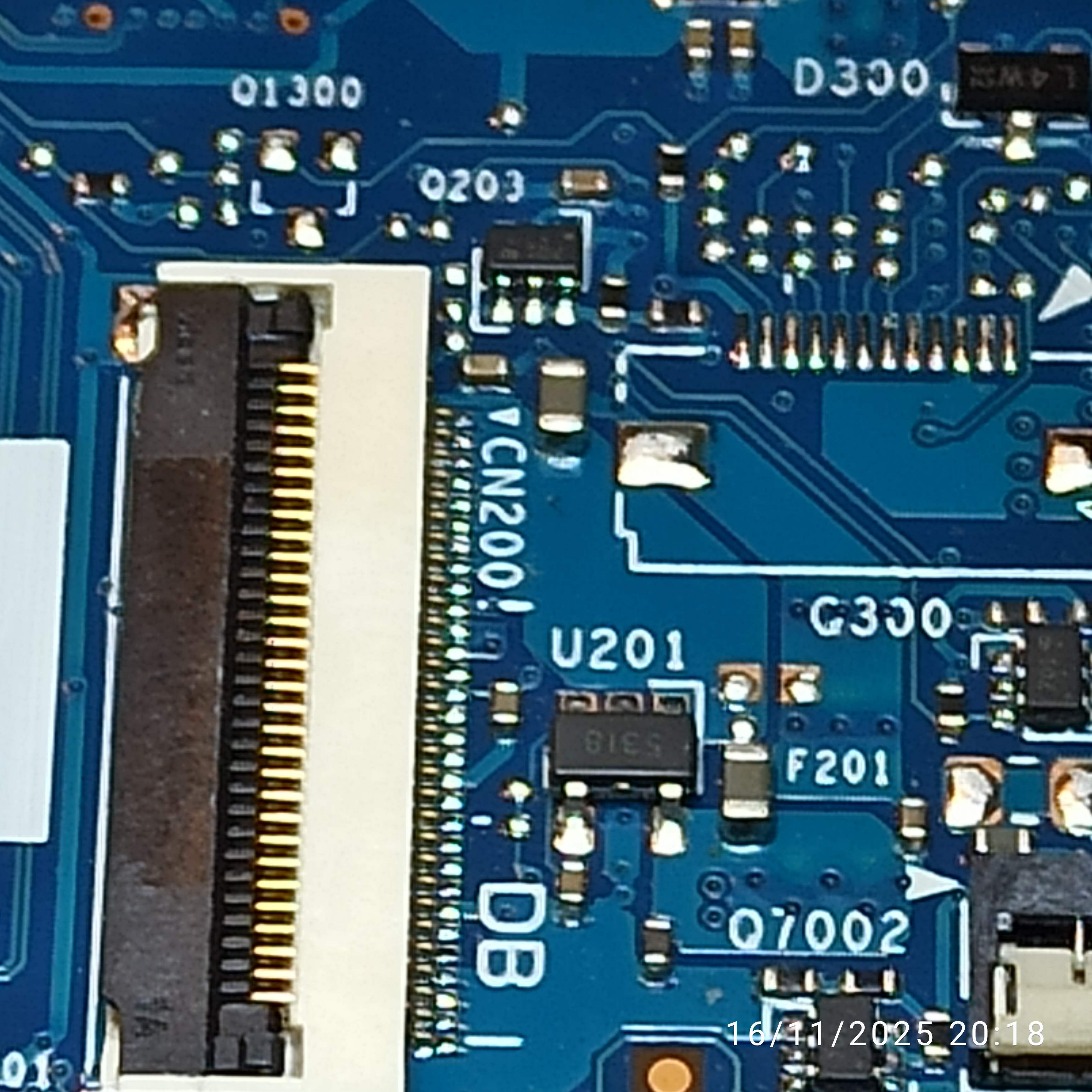

          A component on the motherboard has failed. The audio output and the right USB port no longer work. Can someone help me and tell me what the component is called?
          Mainboard: hp 17n 8L TGL
          Near the component is U201 Q300
