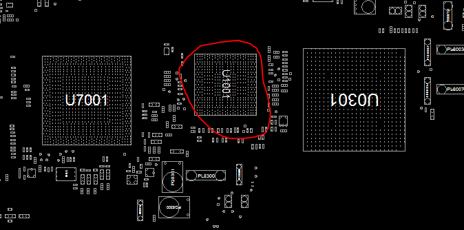

    i know its a old Thread but today i got a Asus x72D too.
    This Laptop boot up, the Powerlight is on and CPU get warm, but still do nothing more.
    Searching for Boardviews and Schematics, do got anyone?!

      Hy everybody,
      i got a BordView from the K72DR Rev 3.0. But actually i cant find any Failure.
      The CPU, GPU gets Warm. Battery is loading! No Display, no Backlights, no Beeps. The Southbridge is super hot.
      The Fan is just pulsed by the board with a 1 sec intervall.
      Schematics would be fine but i cant find any schematics for it.

        the problem usually is the amd chip near cpu, it's a common issue in this type of laptop.
        the chip if I remember well is the 215-0752007 rx881 or similar
        If this chip is the culprit, don't reballing or reflow but it needs to be replaced
        I have boardview for ver 2.0 and 3.0 , what version you need ?

          Hy, thanks for the answer.
          My Board Revision is 3.0
          Todaay i ordered a Boardview on en-manuals but they dont have any Schematics, this would be more Information for me.
          Did you mean the U1001 Chip under the Heatsink in the middle of GPU and CPU?
            Re: Need schematic ASUS motherboard K72DR
            Yes, the heatsink don't work properly because there is a piece of thermal silicon on the chip with time does not dissipate heat well
            If the chip is not damaged you can try to
            hold it down with two fingers and turn on your laptop, wait 20 sec, if is too hot use a piece of paper to protect your fingers.

              Hey jasko_jacker and all together,
              again thanks for the hint with the Northbridge. Today i have Reflowed the Northbridge with enought Flux and long patience, to wait till Northbridge chip was dancing, and here we go the Laptop works fine, i got LCD Backlight on, i got Fan spinning, i got HDD movings and windows starts up.
              Thanks very much!
              Greetings from Germany
              Daniel

                Good job,
                if I remember well, the lack of this chipset is the absence of temp sensor
                that cause this issue.
