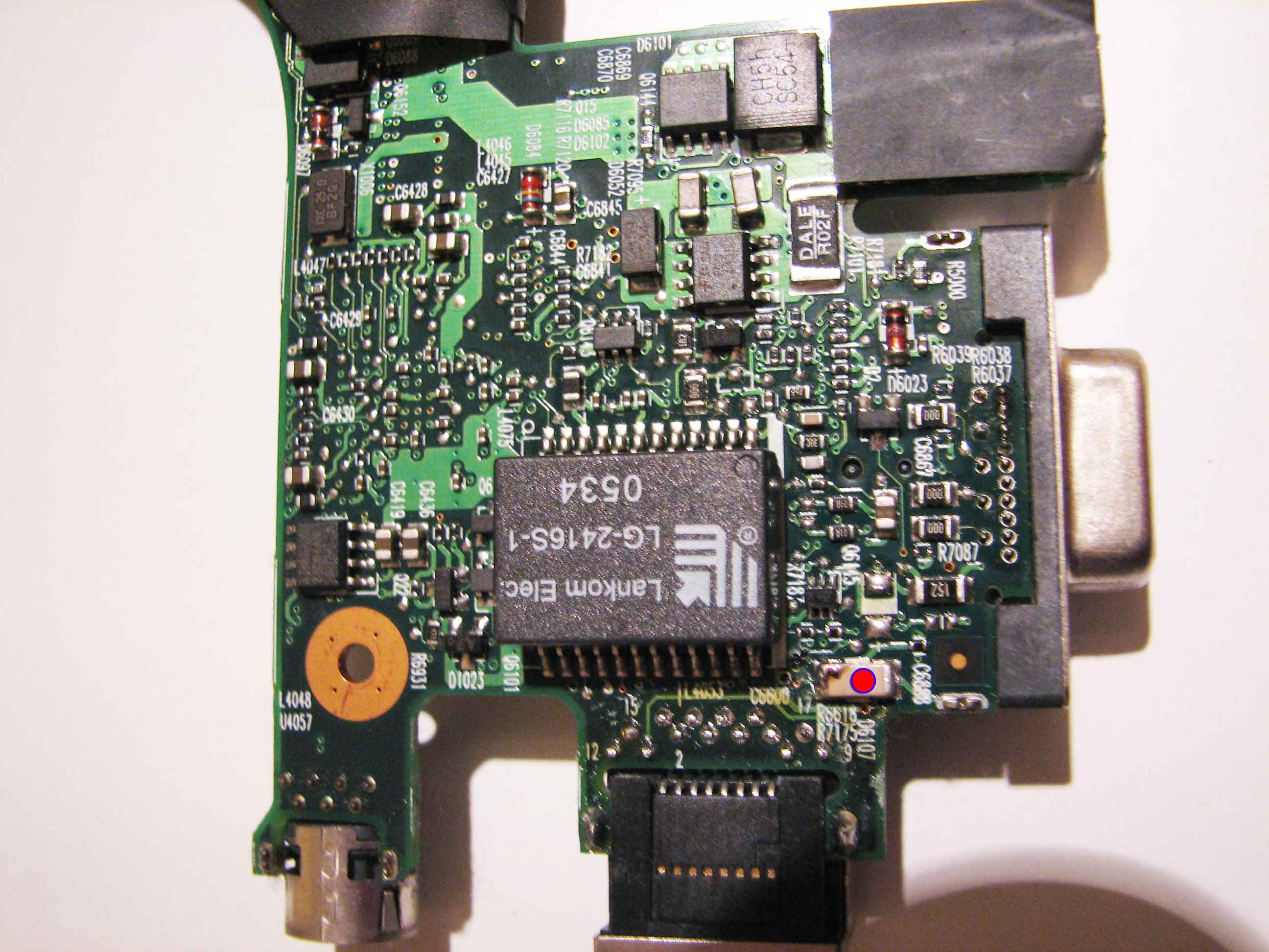

    Hi. I need a schematic diagram for this laptop, i think is for nx8220 equal (only GPU is diferent, x600 and x700)
    Thank you.

    not sure but this should be it
    Model: NX8220, NC8230, NC6230, NW8240, HP Compaq 6230 - 8230, Compaq Evo Notebook N410c
    Platforma: INVENTEC VAIL 1.0 build SI2
    Rev: AX2
    Info: 6050A0052301-MB-A03
    PartNo. (SPS): 382688-001

      in fact, I locate the error in the power supply assembly, one (is inpossible to locate which) element squeals like iiiiiiiiii, when led diode change from yelow to Green stop and start again, I record video, but is no squeal sound (to many disturbance from trafic etc.)
      I will post video in few min.

        I not find schematic diagram (i think is not exist) but I fix this laptop with reball ATI graphic chip.
        100% has some ball melted with another, and this cause weird iiiiiiiii squelals.
        So case closed, I do a lot of nx8220 and this is same board only ati chip is diferent, but has same defect.
        @ala borbe I see now you paste schematic. Thankyou (hvala lepa)
        Maybe I can use next time.
        Thank's again.
