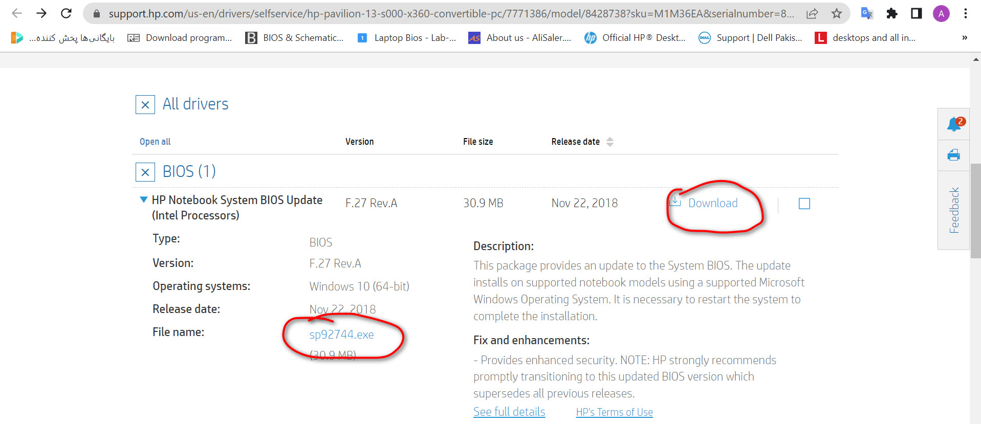

              Re: HP Pavilion 13-S FAUCHON-BDW MB 14259-2 BIOS
              Need help
              HP Pavilion x360 - 13-s060sa (ENERGY STAR)
              board code: FAUCHON-BDW MB 14259-2
              serial no: 8CG52617B7
              Problem is that, laptop is not detecting harddrive. and i think its due to bios issue. i want to change the bios but bios chip is WSON-8 PIN (25q64fv1g) and i dont have WSON-8 PIN ADAPTOR. i tried to take bios backup through sholding wires, but bios chip is not detected
              Is that problem may be due to bios ???
              Can anybody make bootable usb to ressolve bios problem
              Bcz in boot menu, usb is showing and booting but there is no hdd in boot menu, even i change hdd, and checked hdd dedection circut
              OR
              may i use SOP8 (200ML) bios chip instead of wson-8 chip???
              if it is possible then i need bin file for that model (even i dont have backup bios)

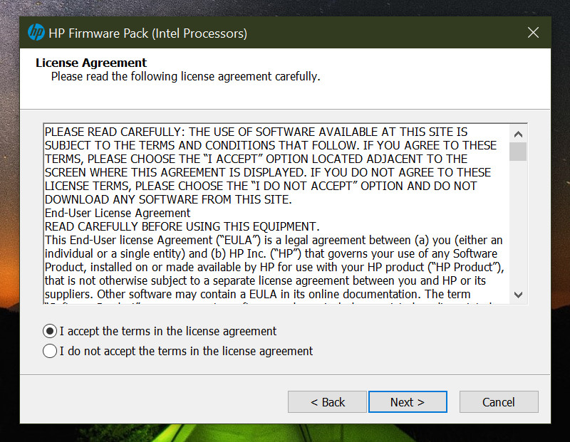

                The wires that you soldered must be as short as possible. Did you solder them to the extra pads ? .if there are some extra pads for a SOP8 chip you can use one instead of the WSON8.The WSON8 adapters are very cheap just a few dollars on aliexpress, a bit more expensive on amazon and ebay but if thats a buying option you`ll get it much quicker. It always saves time if you can make a good backup of the original bios, most of the non business HP`s have an Insyde bios, its easy to copy the DMI and windows key from the backup to a new virgin bios, and much better than struggling with nbdmifit/BCU.
                You can make a bios recovery flash drive easily, just go to HP support,enter the laptop serial number, get the bios update and run the exe, it will give 3 options, 1 of them is to make a recovery drive.

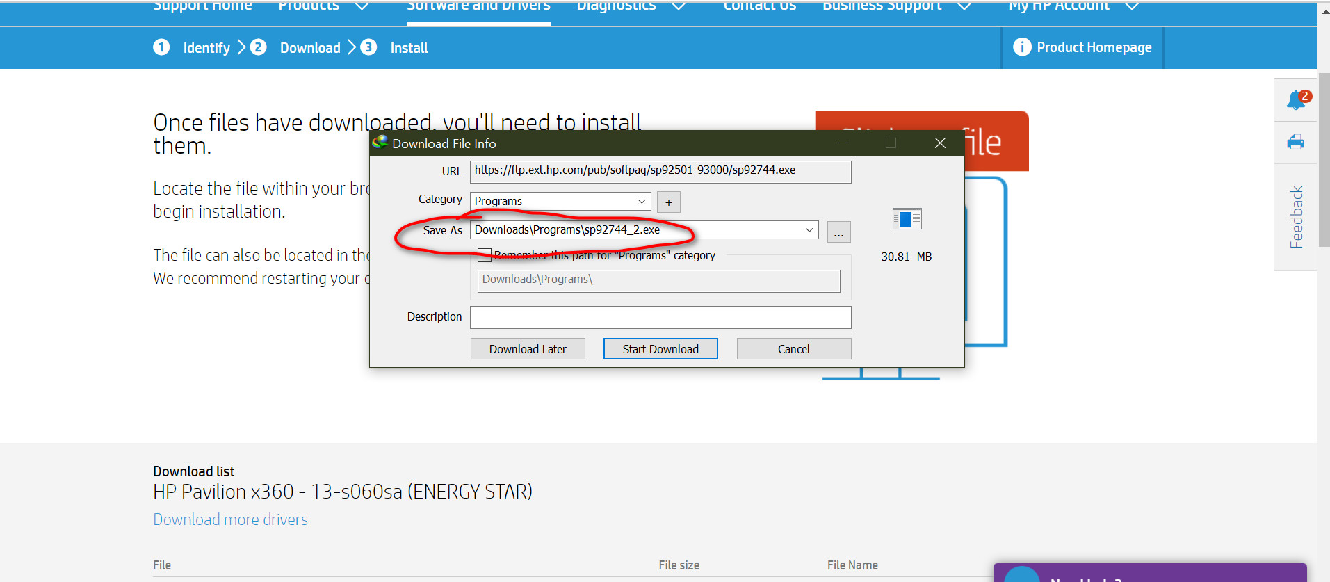

                  Thanks sir for quick response

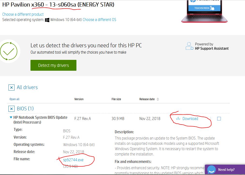

                  unfortunatly i didnt find bootable usb bios at hp site
                  https://support.hp.com/us-en/drivers...ber=8CG52617B7
                  can see it for me plz

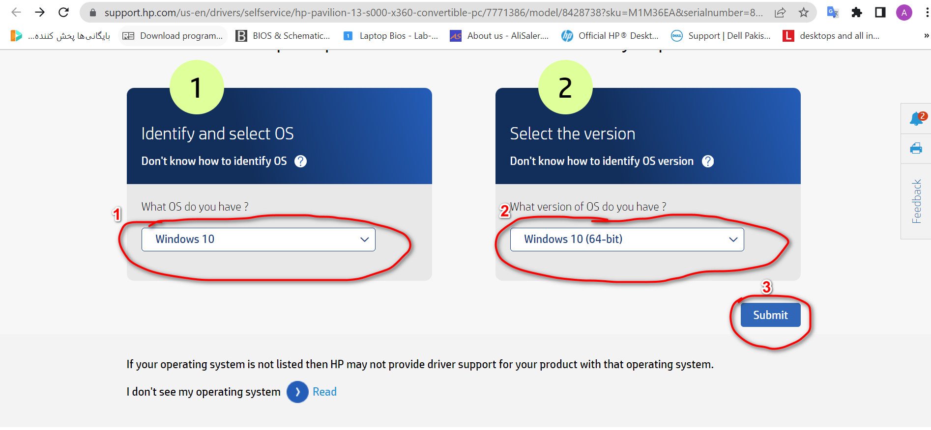

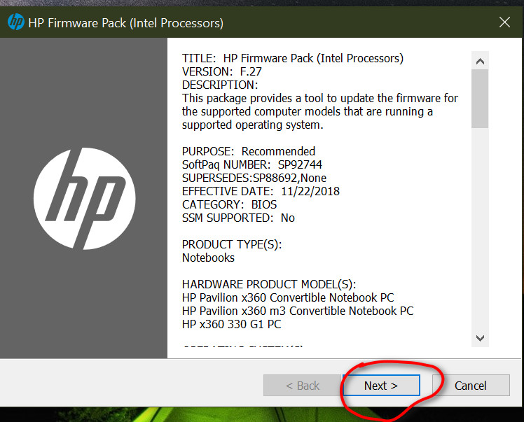

                      The link works ok for me.Choose win10 as the OS and 64bit.Expand the column on the left.Download and run the exe .If you`re running win 7 it will crash, use a machine with win8 or 10 and it will work.If you see an option to install an insyde driver you choose no, it will pop up a few times,just keep choosing no.You only need to install the driver if you`re flashing the bios to the same machine,it isn`t needed to extract the bios or make a recovery drive.
                      https://ftp.hp.com/pub/softpaq/sp925...00/sp92744.exe

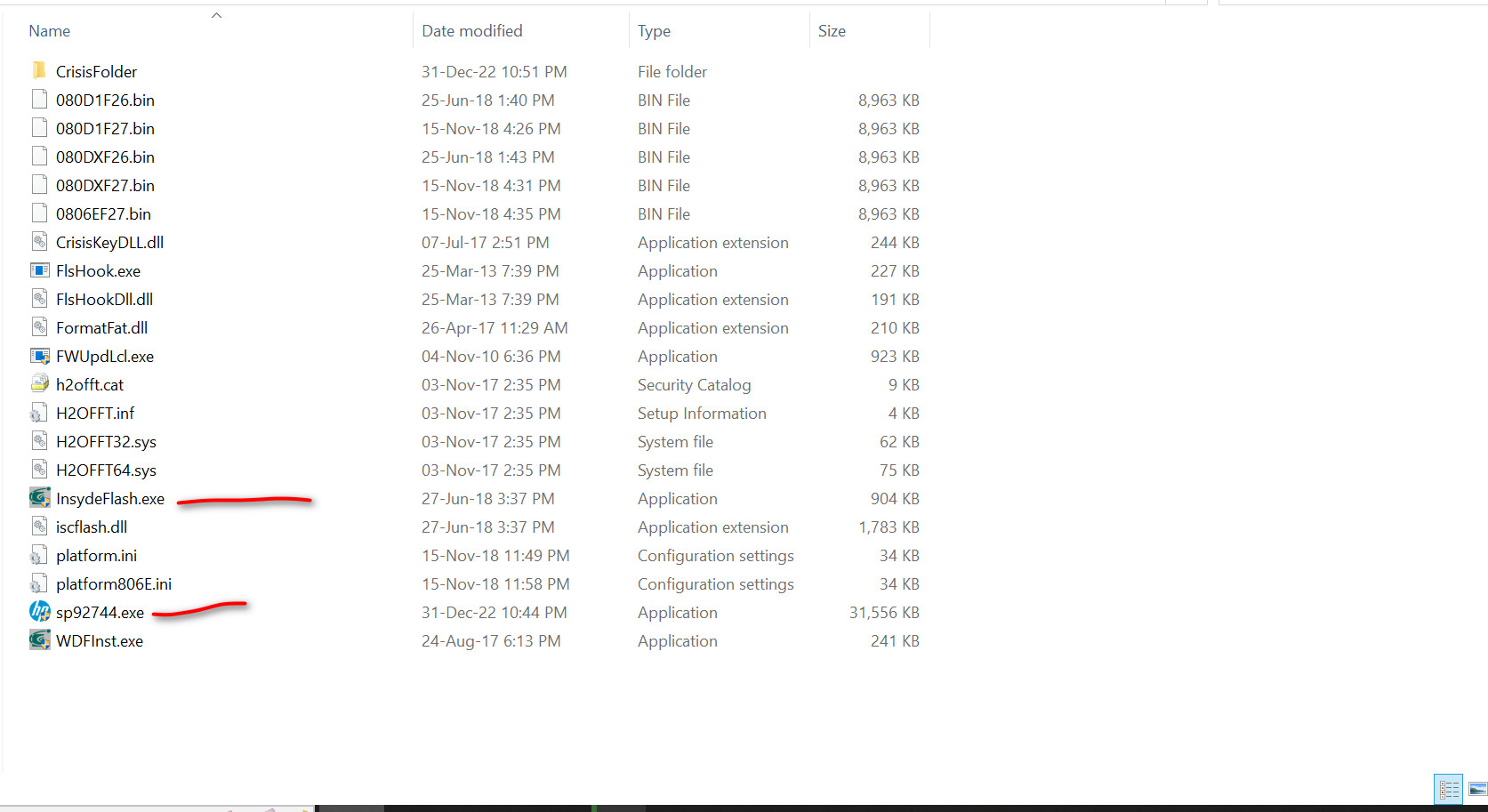

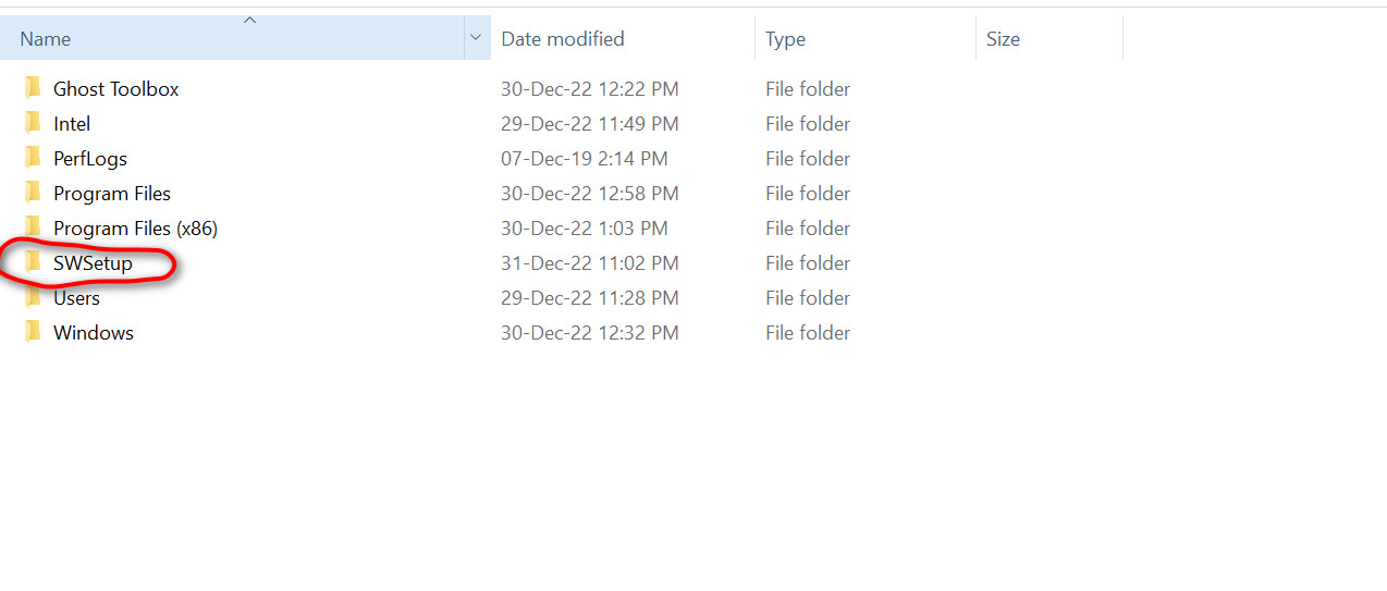

                        sir
                        i am using windows 10 64 bit

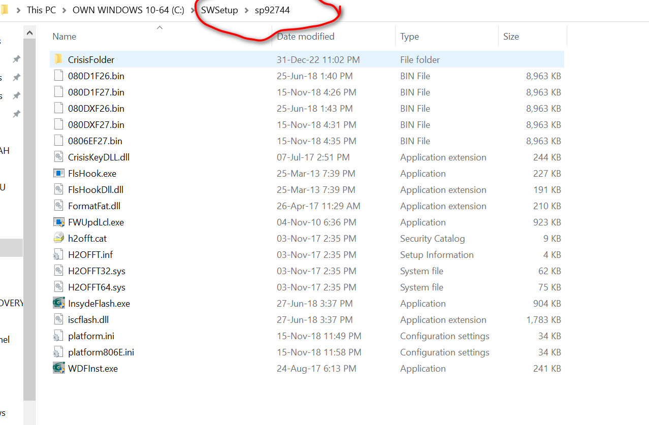

                        dowloaded sp92744 file already. extract it in a folder
                        But the question is that, how i can make bootable bios usb
                        i means before that for hp bios, i just download it and plung in empty usb, and runs the bios file, it asks ....... do u want to make bios usb or just extract it, but here bios files only extracted

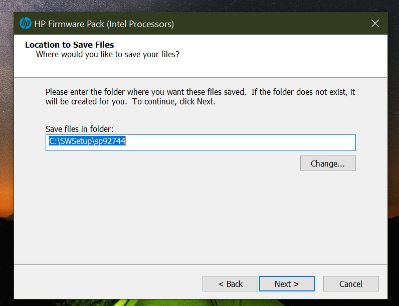

                          sir

                            Run sp92744.exe

                                      I tried 4 older bios versions on win 10 ,none of them gave the option to create a recovery drive,then i tried sp80460.exe on win 7 and it did give all of the 3 options
                                      sp80460 https://ftp.hp.com/pub/softpaq/sp800...00/sp80460.exe
