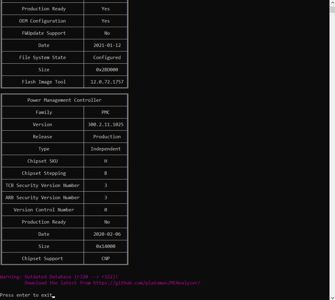

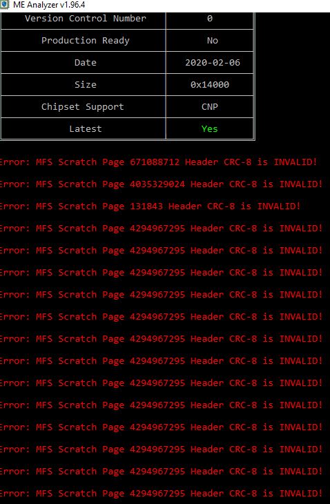

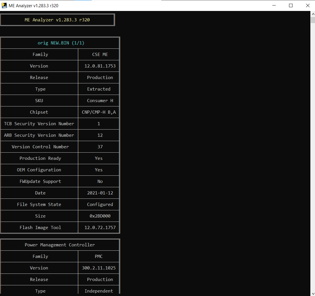

                      Re: Alienware m17_service tag 1NBQN42
                      Originally posted by Debric
                      Thanks @Vesko356. i'll try to flash this bios bin you gave.
                      by the way prior flashing, i did check thru ME analyzer.
                      this is what i observed...pls see pic... a lot of invalid errors.
                      do you thinks that is OK?
                      my orig backup does not have that one...
                          After I submit a file I should have checked it, and I always do, simply because I am a perfectionist by nature. You don't need to check my work further, or if you think you have more knowledge than me, you can make your own dump.
                          Your ME Analyzer version is old, hence the errors you see.
